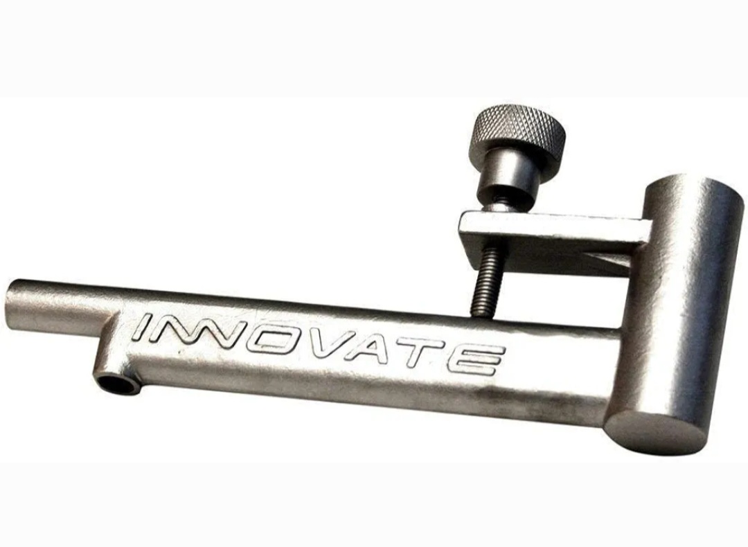

  28. '29 Gizmo
    Joined: Nov 6, 2022
    Posts: 1,182
    '29 Gizmo
    from UK
    Only if you have a multi-carb set up with isolated runners.
    On mine I don't use a bung you can get an adapter to clamp on the tail pipe..
    Sharpone likes this.
  29. G-son
    Joined: Dec 19, 2012
    Posts: 1,493
    G-son
    from Sweden
    I'm not sure I'd trust that adapter, it's sitting so close to the end it may get air from the exhaust end distorting the reading. Probably less of an issue at full throttle and high rpm than idle or cruising.
