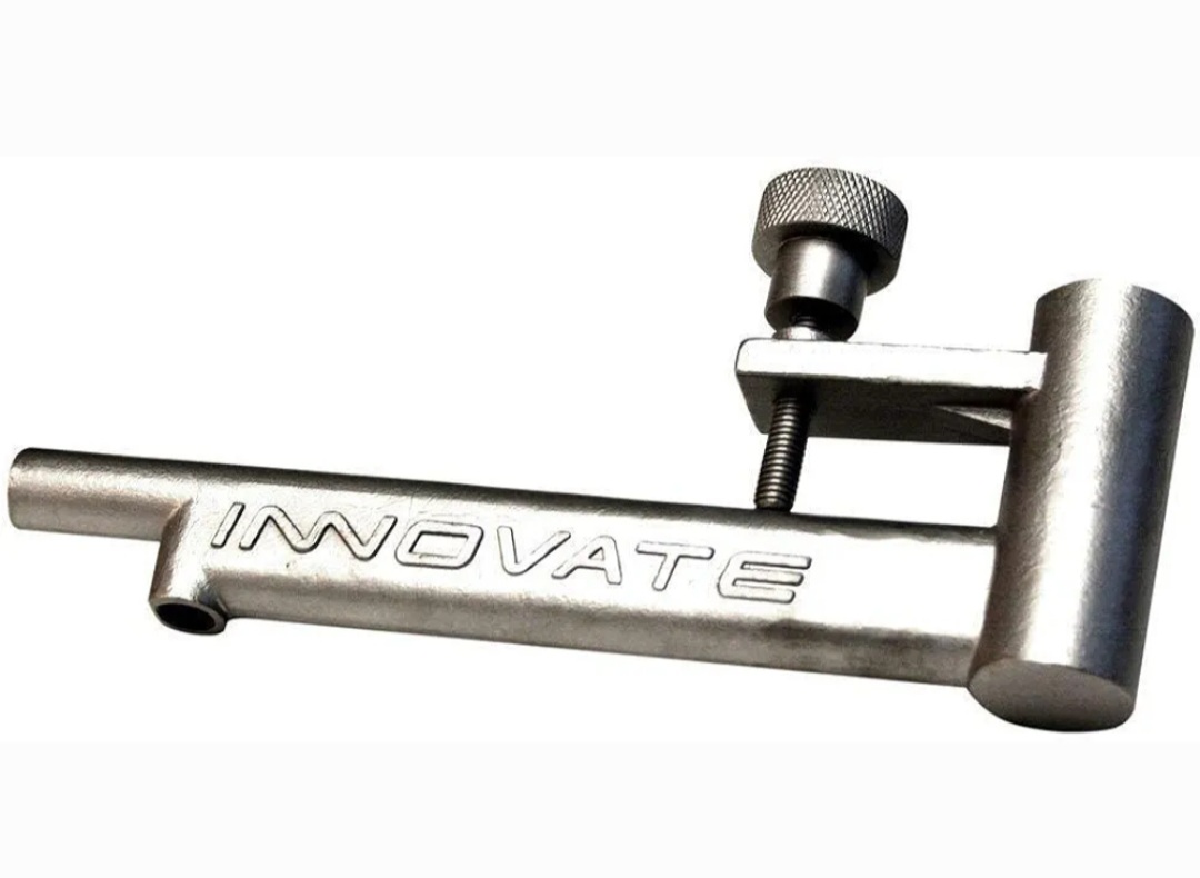

    I bought an AutoMeter that reads in actual numbers plus has the dancing wrap around LEDs to show lean/ok/rich graphically. It doesn’t fit the overall look I want for the car, so I didn’t want it permanently mounted. I got a single pod gauge mount from Amazon and a medium sized magnet from Harbor Freight and stuck it to the bottom of the dash. It’s useful for tuning and information, but also easily removed.

    I use that adapter, as well. After a while, you can kind of sense what the AF numbers are going to be based on the car's driveability, and the numbers on my meter seem to align with that (even when using the tailpipe adapter). Even if it's within a half a point, you're close enough for most of the driving a non-racer will do. Additionally, I know from experience that the adapter will hold up to being dragged down the freeway because the user didn't clamp it down tightly enough. :)

    Thank you, I like the tail pipe adapter idea allows use on several vehicles.

    Yep... been there. I have developed the process of lashing the cables to the fender to limit the amount of travel of a lose clamp.

    I've seen a lot of cars with leaks at their header/collector gaskets - and that screws the readings all up. This is particularly important if you are using the tailpipe mounting shown earlier. If you have any leaky "slip connectors" or joints - fix them before messing with an AFR meter.
