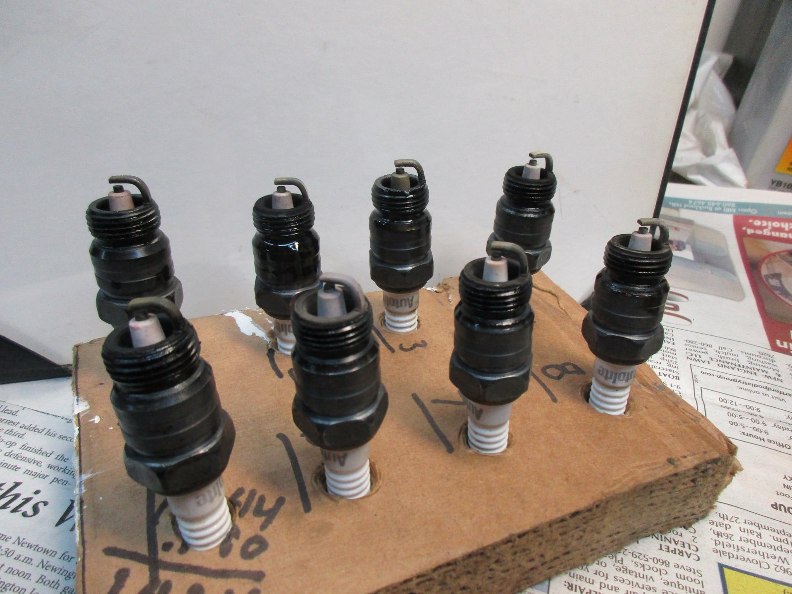

    No gauge is 100% accurate. 99% accuracy is 1% off. 1% off on the scale from 11-18:1 is a big deal. The scale is 8 whole numbers, and most gauges only displays whole and tenths. Add or subtract 1% (0.08:1) from the number that you see, ***uming that it was already rounded up or down for the display, and your number will be off. For example, if you were at 14.57, and you added a 1% error rate (0.08) it will round to 14.7 (14.57 + 0.08 = 14.65, rounds to 14.7). Take that reading and go the other way and the gauge could read 14.4. So, a 14.57 reading could display anywhere from 14.5 to 14.7 (14.57 - 0.08 = 14.49, rounds to 14.5).
    See if you can get idle to 14.5, and leave it there. I would not set lean-cruise past 16. Detonation begins well before you can hear it. If you can hear it, it is doing damage.

    Plug reading with modern fuel formulations does not relate well to fuel from the past.

    If the spark plugs are fouling then there is room for improvement. It might be that leaning out the idle some and fattening up the squirter or whatever will cancel each other out. One thing I noticed is a lot of people fixate on 14.7 or "stoich", and spend a lot of time trying to achieve that. It's too lean for acceleration and too rich for flat ground cruise and it may not idle well there either, so near as I can tell it really doesn't have much utility for tuning purposes.

    The idle air bleeds are 70 front and 39 rear on the stock carb, however I have removed the stock secondary metering plate and replaced it with the QFT 34-9 metering block which gives me 4 corner idle. At the same time I replaced the 39 rear idle air bleed with a 70 air bleed. This was done, after conferring with QFT tech, because every 4 corner idle carb I have seen runs the IABs with all 4 corners the same. This was all done before I started this tuning process. I have a range of air bleeds. They are the easiest thing to change on the carb. Certainly worth a try.
    The Quick Fuel carbs use an idle feed restrictor. It is a small jet at the top of the idle feed channel in the metering block. Stock size IFR for this 600 carb on the primary is a 31. This channel feeds the idle port and the transition slot. This restrictor greatly affects idle and the amount of turns out on the idle mix screws and thus the AFR on rpms up to about 2500 rpm. (Holley says 2000 rpm.) I know this to be true from my experimenting. I am down to 28 IFRs and my idle mix screws are out 1/2 turn from light seat with idle at 12.4:1 AFR. I can squeeze it down to about 3/8 turn and get 14 AFR, maybe a little better, but the transition suffers. If I go to larger than 28 IFRs I start to loose control at the idle mix screws. Too large and the IMS become non functional.
    This 600 comes with a pretty rich tune right out of the box. Initially, with this carb on a stock Goodwrench 350 I had no control at the idle mix screws. In an effort to gain control, I modified it with the metering block for 4 corner idle and to be able to lean out the IFRs front and rear. It worked great on the stock Goodwrench and gave me back control with the IMS out 1/2-5/8 turns out. Plug color was good. A little rich. Tan but not black. Then I rebuilt and modified the engine, (threw everything away except the block, crank, and carb) used the same carb, and installed the AFR and vac gauge. Everything new. Now I have black plugs.
    I just did a leak-down test and a compression test to make sure the engine is healthy. It just now has 2000 miles on it. #1 cylinder leaks at 3%. The rest are at 1-1/2% -2%. 180 PSI + or - 3PSI. The engine is pretty healthy.
    Okay. I think Plan A will be to change the IAB's from 70 to 74 at all 4 corners. Plan B: If that leans out the secondary, I may go to the 74s on the primary only. Plan C: Go back to 70 IAB, squeeze the IMS 's down to about 3/8 turn and put in a bigger shooter.
    I think what this thing really needs is a restrictor in the idle port to separate the trans slot from the idle port . I haven't read anything anywhere of anybody doing this though.
    I can testify to #6 being the leanest. I have 2 #6 melted pistons hanging on the wall of shame in my shop. One my fault. One my engine builders fault.
