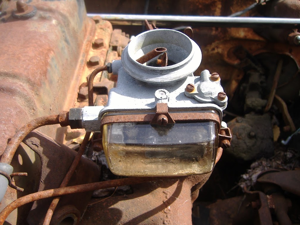

    I'd like to see some transparent Holley float bowls. Just to see what the heck goes on inside their at idle, wide open throttle.............be interesting.

    I bought this old Holley 1904 from a going-out-of-business junkyard seven years ago. It was on a '57 Ford, I believe...it just goes to show that Holley has tried it!
    AHotRod, earlymopar, loudbang and 2 others like this.
