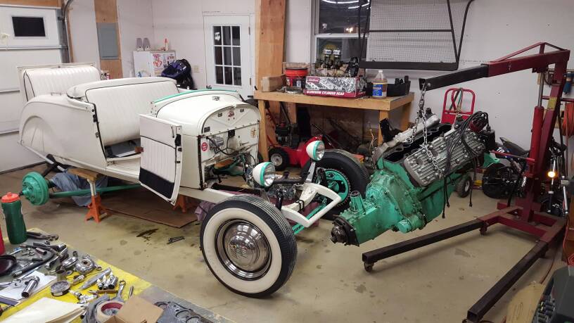

    Here's the 32 as it sits right now... second pic is the beginnings of the Carson top hanging on the wall.

    Very cool, you did great to hold onto it for all of these years. It looks very solid.

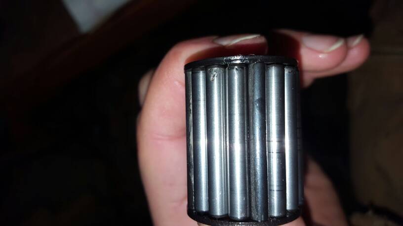

    Transmission is all apart. Looks really good. Need to shim it back up tight with new thrust washers all around and new bearings. Has .026 of play on the cluster instead of .005 to .017. Center roller bearing is roached. Ole man has been hearing a growl in second since I was 15...
    Time to dig into Mac van pelts site and figure out which part numbers I need. It's a side shift gear set.. 20170220_185712.jpg 20170220_185957.jpg

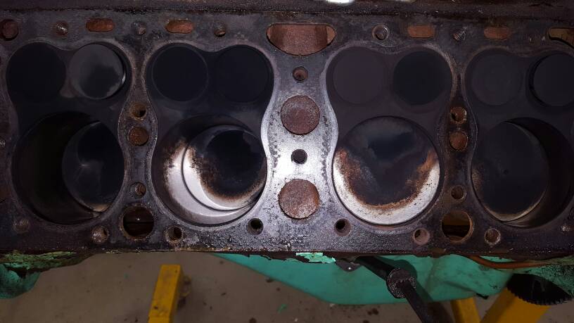

    Think I know why she pushed a little coolant. Heads were only at about 40ft/lbs... pulled them off and everything looks great except I'm leary of one thing... tell me what you think of the top of the pistons...
