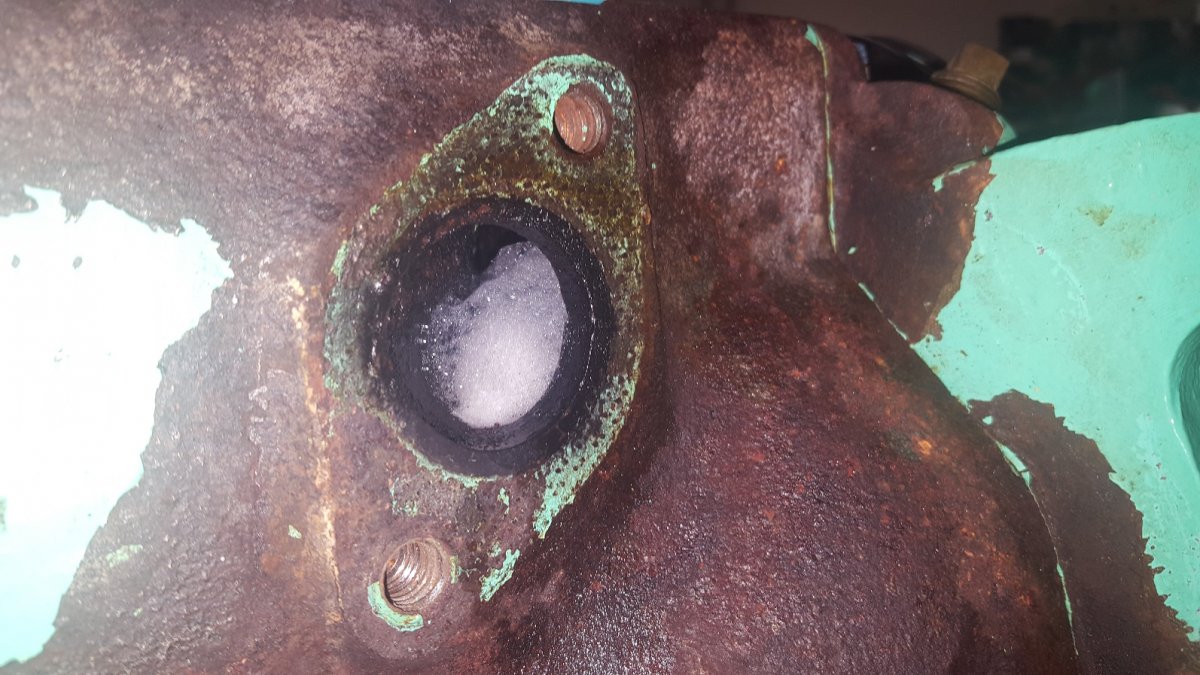

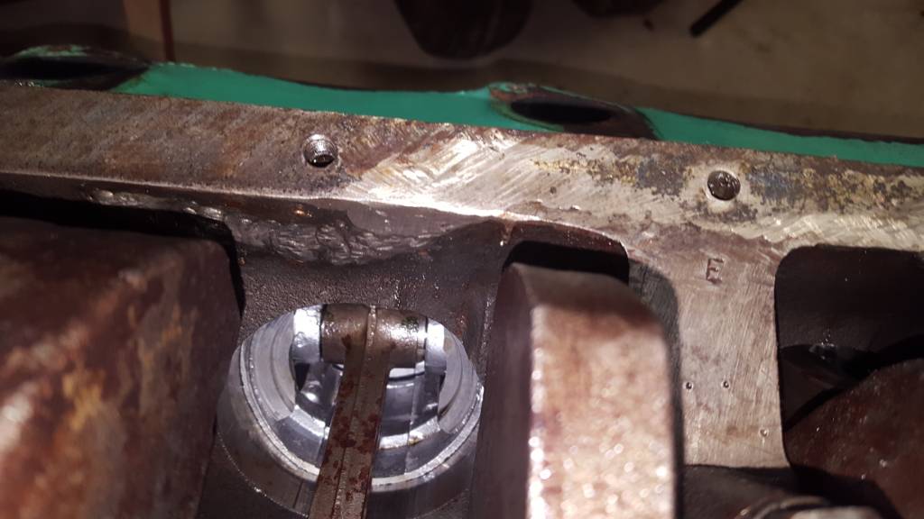

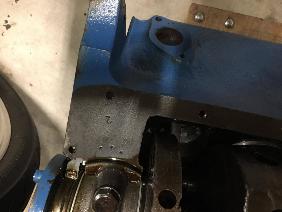

    Well things got interesting this morning. Work on the motor has been very slow. I got out to the garage to finish pulling it apart as far as I needed to reseal it. What a surprise I got when I pulled the pan off though. We bought this motor out of a car that was being restored then was sold to a hot fodder. It had been rebuilt and never fired so we took it apart cleaned the rat nest out of the oil pan and put it back together. When the pan came off today I found this! Neither my father, uncle nor I remember cracked and welded pan rails! There's 30 inches of weld in this motor and it has been running like a top for 25. Only thing I'm concerned with is I smelled coolant out of the exhaust every now and then. My radiator had no pressure because it had pinholes on the top tank. I found no evidence of a blown head gasket but I found an exhaust port on each side that had a very small amount of rust. Hoping it's not a crack in the ports showing up after 25 years that will get worse when I put a pressure cap on the distributor. years! 20170805_112456.jpg 20170805_112502.jpg [​IMG]

    The fact that it's been welded and been running amazes me. The amount of weld, uh, WOW!

    That's definitely nickel welding rod. The best way to weld cast iron. Conventional wisdom is that a pan rail crack is the kiss of death for a flathead. I think this disproves that notion !

    The welding looks pretty good, but it definitely explains the leakage that's been happening. 25 yrs. and more, should you worry now? Do you have a back-up block? Good Luck, this is a great little car!
    czuch likes this.
  6. I would strip the motor down and do a pressure check on it. Makes no sense to put it all back together and then find you have an issue. You've already got it this far - might as well go the rest of the way to be sure!
    PS: Welding up the pan rails was a very common thing back in the day. A good friend of mine that is 85+ years old said that they used to bring cars into the shop he worked at as a young man. They'd run the engine until it was hot, put it into the workbay, pull the pan (engine still in car), clean everything with solvent, grind out the cracks and he would weld them up with NiRod . . . with the engine still in the car. Said that they fixed a lot of freeze-cracked flatheads in this manner. Knowing Pete and his skills - I'm sure the story is true.

    Possible that there's a bit of porosity in all that weld somewhere and you're getting a little seepage that can be handled with the "dog turds" like GM used to put in every car coming off the ***embly line.
    But I agree, you need to pressure test it, and even though it means a new set of cam bearings afterwards, you need to vat the block because any of the stopleak fiber compounds work much better in a clean block.

    That is a good looking repair, I have seen lots of repairs like that on race car motors and if it's done right it is good to go. 25 years seems like it p***ed the good to go test. If you have washed down the cylinders a few times, a set of rings and bearings with a hone would be my play. Put it together, use the old radiator and run some good block sealer through it. Follow the directions which is usually run at running temp for 30 mins or something of that nature. Drain the water pull your old radiator and put the new one in. My money would be that your kiddo will be driving it with the same motor when he is 25.

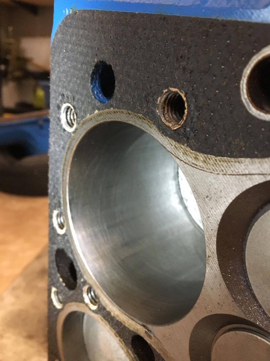

    well it turned out the guy I was trying to get to help me test the block just kept putting me off so I remembered my brother had a roll of foam rubber in his cellar and used made my own. using the edelbrock heads, stock pumps with the water outlets blocked with a rubber expansion plug. I added 10psi into the pipe hole in the head for the temp sender and sprayed some dawn into the exhaust ports. one port on each side had a nasty crack and foamed right up. junk block!
    It just so happened that I found a fresh rebuild without paperwork for sale right before I tested it. after it came back cracked I contacted the seller and now have a stock rebuilt 8ba in my possession. it's very similar to the motor I pulled out of the car. that motor was basically a stock rebuild with .030 pistons and we installed an isky 77b cam with stock valves and springs. this one is .040 over with the stock ford cam. wondering if it's even worth putting a bigger cam in?
    here's some shots of testing the old motor:

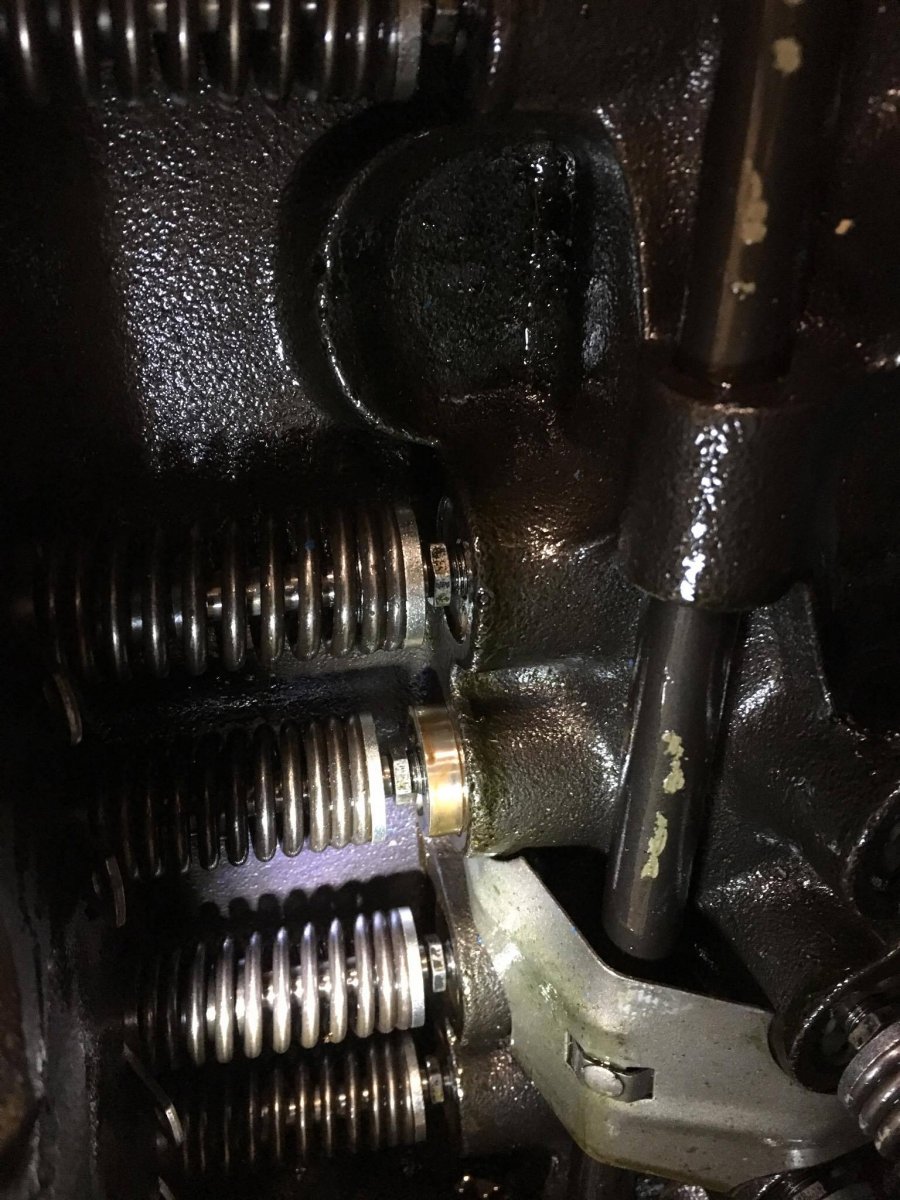

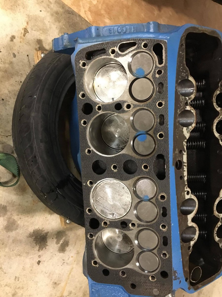

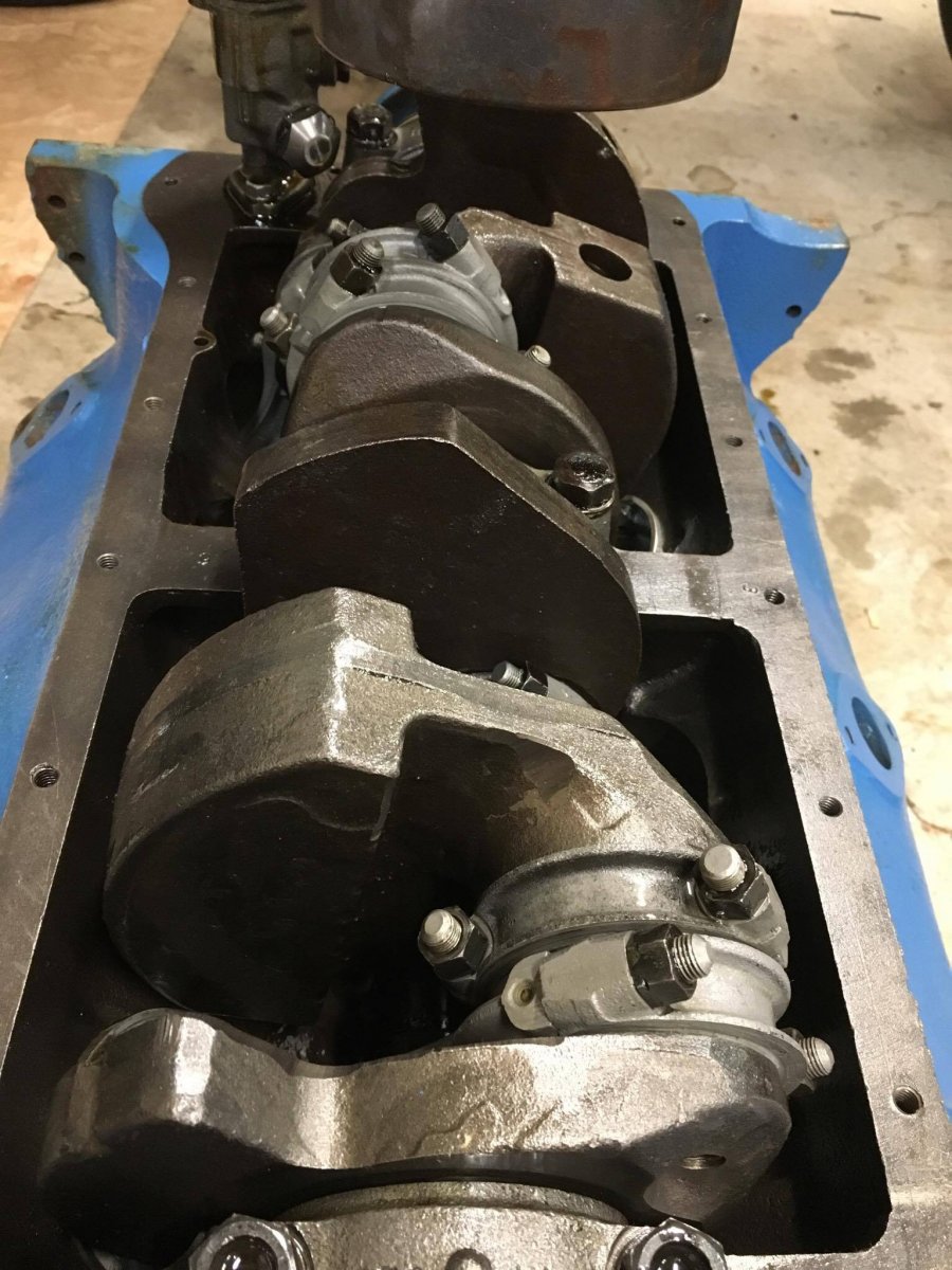

    and some pics of the new motor

    The new engine looks good, appears to have adjustable tappets in it also. If it were mine, I would install the cam in order to take full advantage of the dual carbs and the Edelbrock heads. Not too bad of a job since it's already opened up.

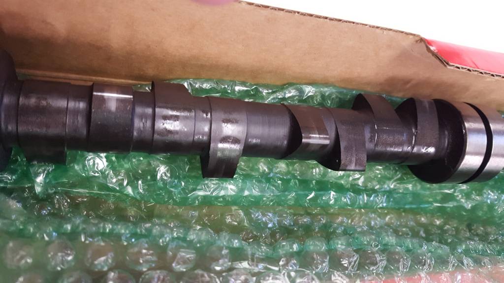

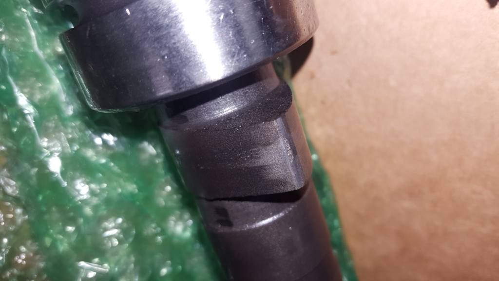

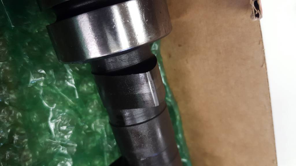

    Thanks for the response Dale. I also have an isky max one that only has break in time but one of the lobes is slightly pitted? Thoughts on that? [​IMG][​IMG][​IMG]

  20. I wouldn't run it - the top of the lobe is breaking down - for what reason, hard to tell. Don't know if it was oil starved, wasn't hardened correctly, bad lifter, ??? My guess is that it will continue what has already been started - so why put it into your new engine.
