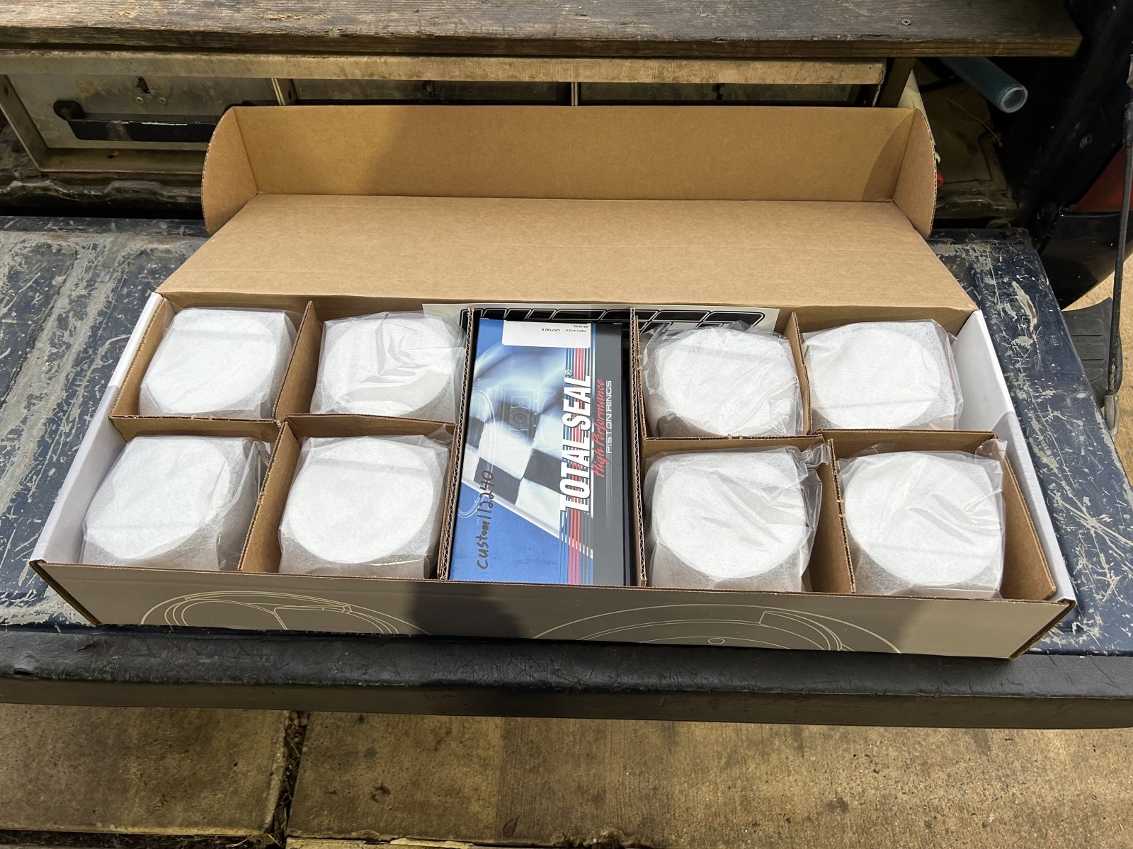

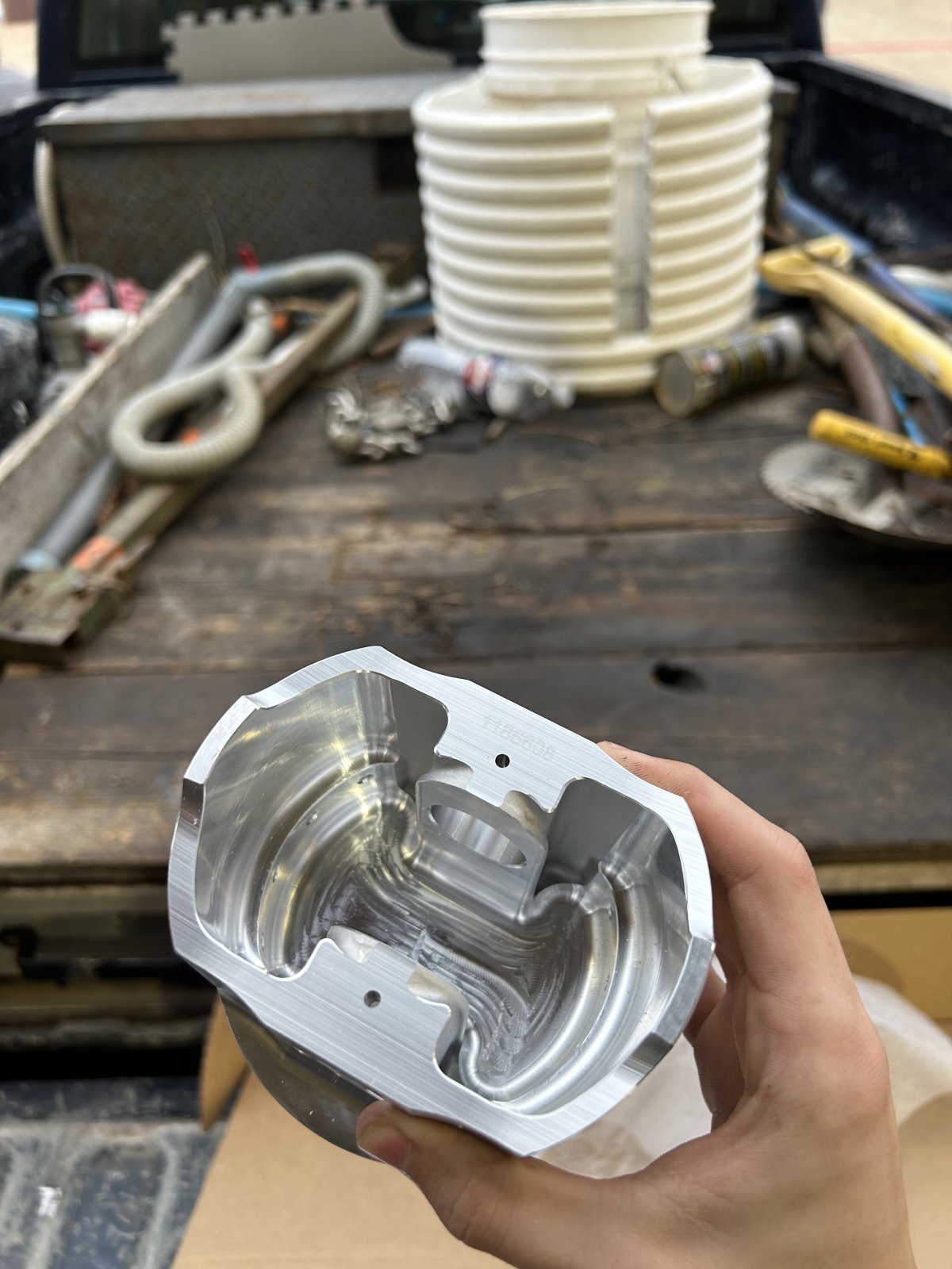

    Not your everyday day build here. 410 Edsel MEL engine. Been waiting on pistons since May from wiesco. To their knowledge they have never made any 410 pistons. Some 430s. Maybe only a couple thousand of these old engines left. The 410 only came in the big body Edsel Corsair and citation. Their is after market knock offs but they are flat tops. Kills the compression. The 410 is a wedge motor.
    Some still confuse the 410 with the late 60s FE. They are not the same engine at all. 410 was a one year, 1958 only engine. Tenth smaller bore than the 430 engines.

    They are expensive to build. But I would just blow the money on something else. Heavy torque monsters. Block is off to get bored.

    they made just 8 for me. It was almost 1500 for them and rings, but they did it. And gave me 2 free stickers lol

  9. NoelC
    Joined: Mar 21, 2018
    Posts: 667
    NoelC
    Wow.

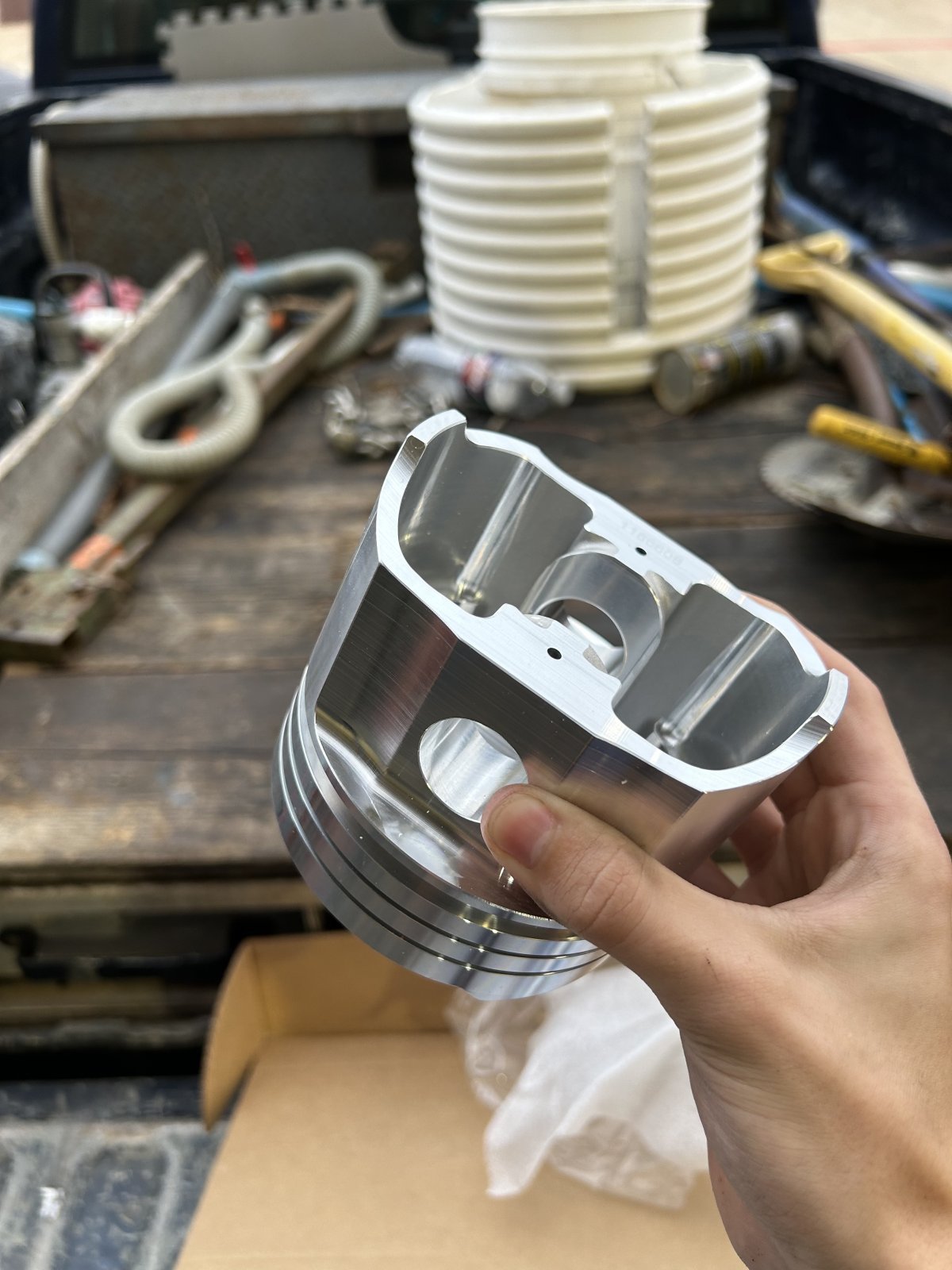

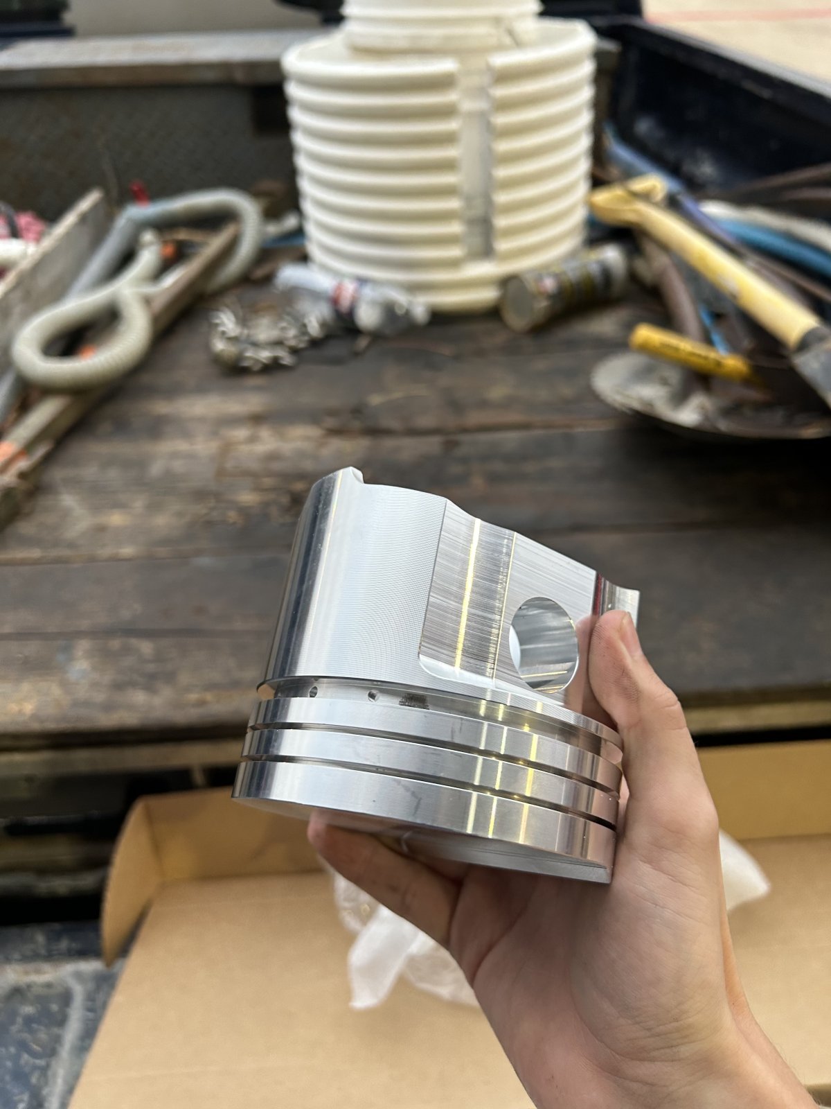

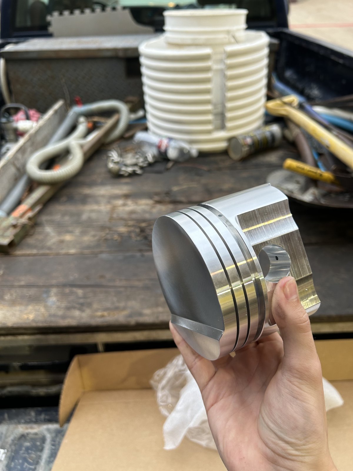

    What's not to like, and I did. I liked it. The picture, the shine of freshly cut aluminum.
    I even checked out the web site. Pretty cool stuff.
    I'm not saying I'm sold on a $700 dollar set of SBC pistons or would cut the bigger $1500 cheque you did, but that's a quality looking slug.
    I'm no piston expert, I'm a believer in technology and modern manufacturing. What you need to do is show the rest of the assembly. A couple more angles on that piston.

    To put that price in perspective, a friend had one broken piston in a late model German car and the only source for a new one, the dealer, wanted $600+ for it. And it's ugly.
    Those MEL pistons are real nice.

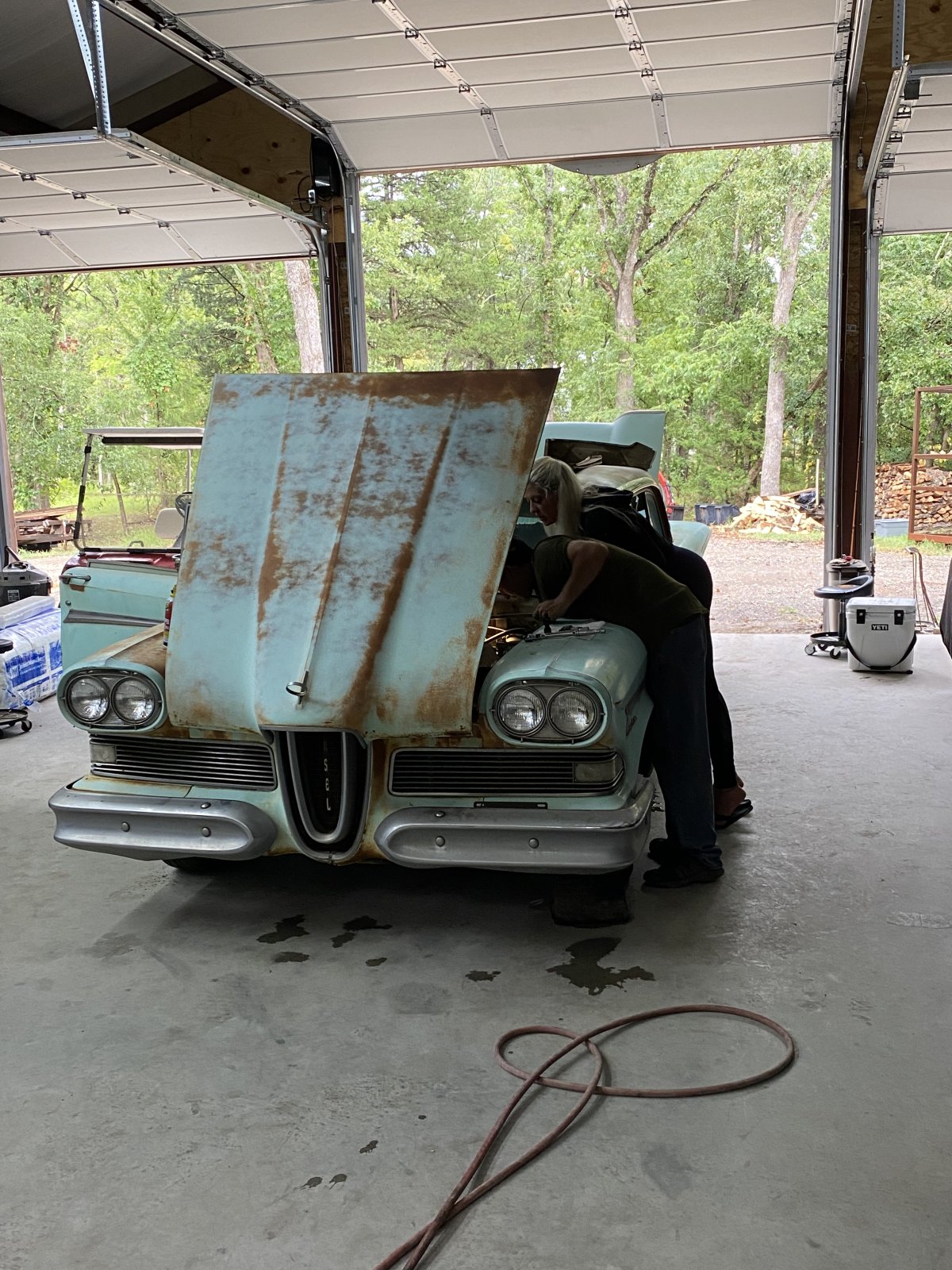

    going into my sons 58 Edsel. His first car. He enjoys working and learning on these old cars. So I figured I better support that and keep him out of trouble.
  20. I have wondered if there was a generic line of pistons somewhere. List the sizes in a catalog system, bore, skirt style, pin height, etc. Just a thought.

    I had to mail them two pistons. So they could copy them.

    The uniqueness is at the top of the piston, due to the fact that the heads are milled flat with no combustion chamber. The wedge-shaped combustion chamber is accomplished by simply milling the block at a 10° angle.
    This necessitates machining the top of the piston as shown in the picture posted.
    There are "generic" flat top pistons available, but they cause a loss of compression and don't take best advantage of the early swirl technology for a good burn.
    Looks like Dustin found a way ($) to convince Weisco to make them correctly.
