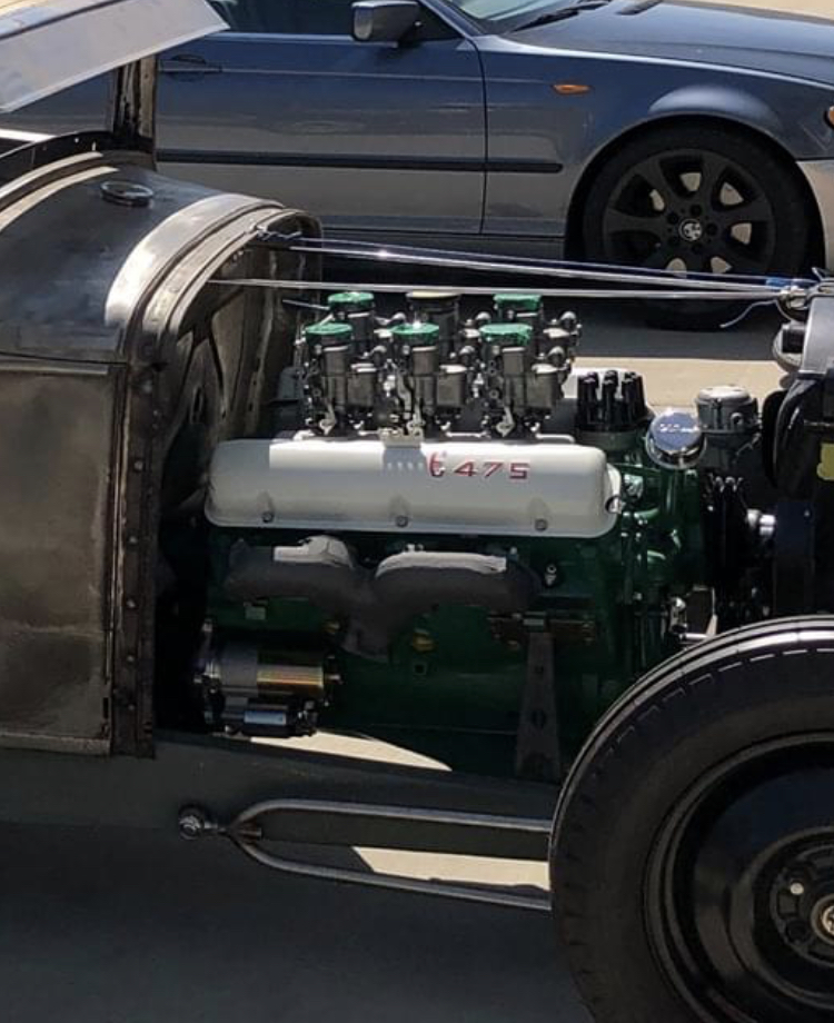

    They are pretty cool motors but not much stuff available for them. My brother has one in a A coupe he’s been building for several years. I can’t remember the specifics on the engine, but they used some type of piston from another application instead of having customs made. It’s also got a stroker crank and uses big block Chevy rods. The engine was used briefly around 1960 in one of my Dads early FED’s and just sat for 30 years in a corner of our parents garage next to the Ardun where we grew up.

  7. I think he was referring to the deck surface of the block. Only two small coolant passages at the front and back. Lots of solid surface between and around the bores. And only four head bolts around each cylinder. I'd guess the block and heads for these engines are even heavier than they look!

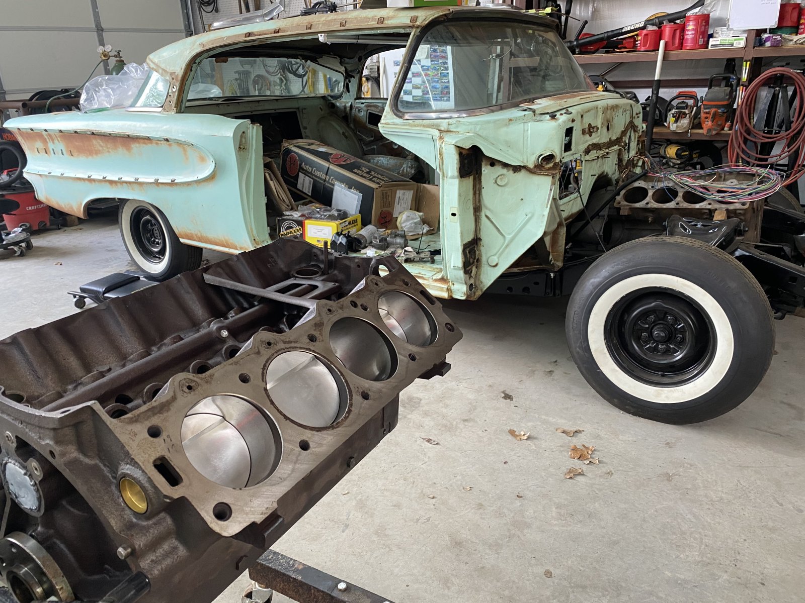

    Got her home and on the stand. I’ll probably just stare at it the rest of the evening while drinking beer lol. A few more pics. One of the old girl just waiting for an engine. She hasn’t ran since mid 80s at best. Maybe longer. Last registration on plates was 63.
    And the official weight of short block is 344.4 including the 1.5lb chain.

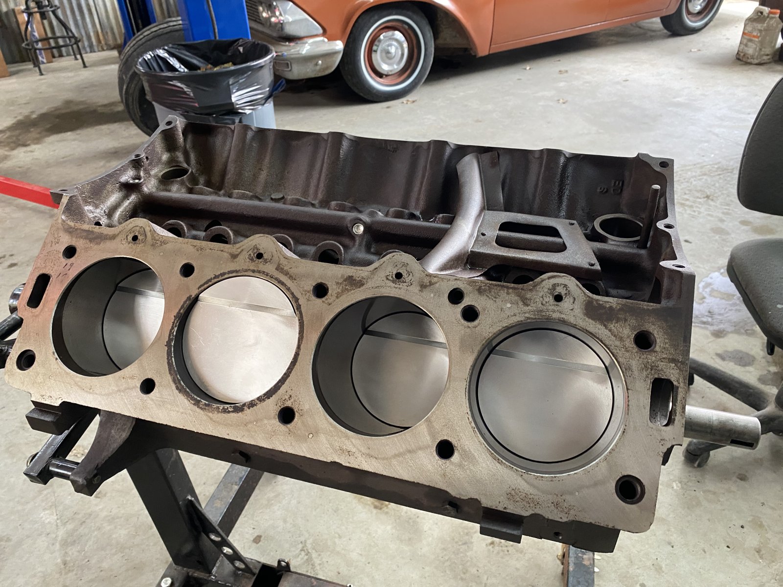

    Rather unique power steering pump on the crank snout. What is the flange for in the valley attached to the bank to bank casting? With all that piston above the pin a pretty tight skirt clearance used? Since the piston is fully machined [and nice!] is it from a generic forging or billet?

    on the edsels they used an external power steering pump. Not like the Lincoln 430s. If I remember correctly the piece of tin your talking about in the valley, was used by Ford, they tried to keep the sludge down. It diverted cold air from hitting all the hot oil

    I guess I got some pics confused. Didn't realize it is sheet metal. 1st and 2nd pic post 42.

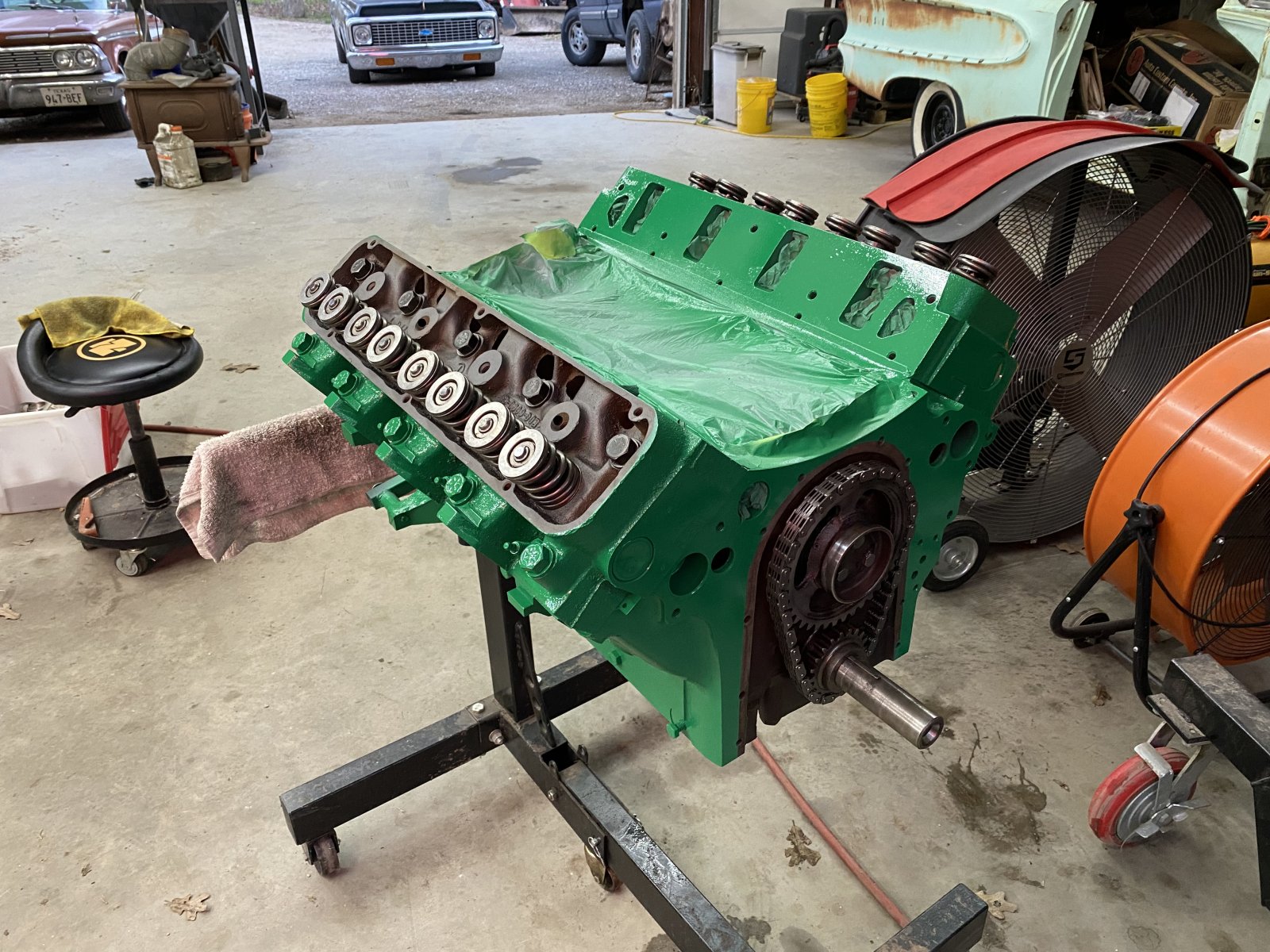

    You best get it cleaned and sealed up as I can see it already flash rusting..........
