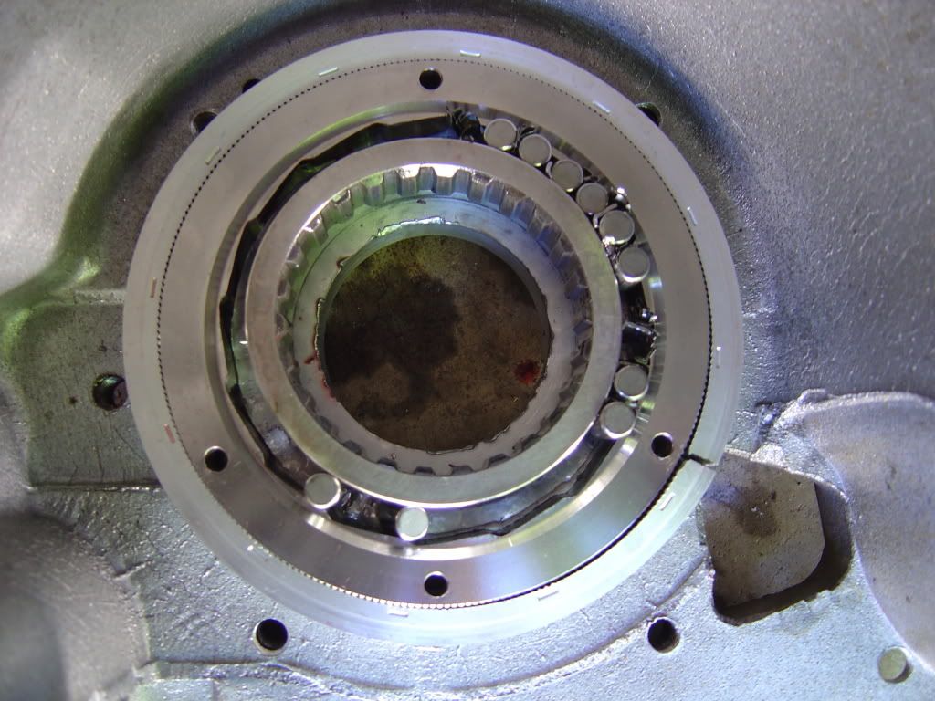

  13. Don Moyer
    Joined: Jun 2, 2005
    Posts: 3,882
    Don Moyer
    Just a quick update, trans guy called with the bad news. The transmission case busted in the back. I had to scramble and find another AMC 727. Lucily my buddy Mark D had one. I dropped it off today at the trans shop. Good news is the carnage in the trans is localized and the clutches and drums all look good. No problems with the Griner brake, and Tom (trans guy) feels that the convertor should be fine also! Hoping to have the trans back by middle of next week.

  25. Don Moyer
    Joined: Jun 2, 2005
    Posts: 3,882
    Don Moyer
    Got all the parts back on Friday evening. Here are a couple pics of the transmission damage.
  26. Don Moyer
    Joined: Jun 2, 2005
    Posts: 3,882
    Don Moyer
    The junk case!

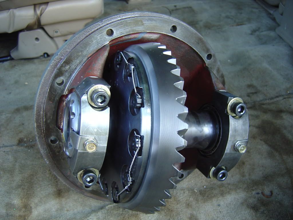

  27. Don Moyer
    Joined: Jun 2, 2005
    Posts: 3,882
    Don Moyer
    Here is the pig with new Mark Williams caps and gears.
  28. Don Moyer
    Joined: Jun 2, 2005
    Posts: 3,882
    Don Moyer
    here is the olds pontiac housing with back brace. I don't really like the look for the car, but I also don't want to keep twisting stuff.
