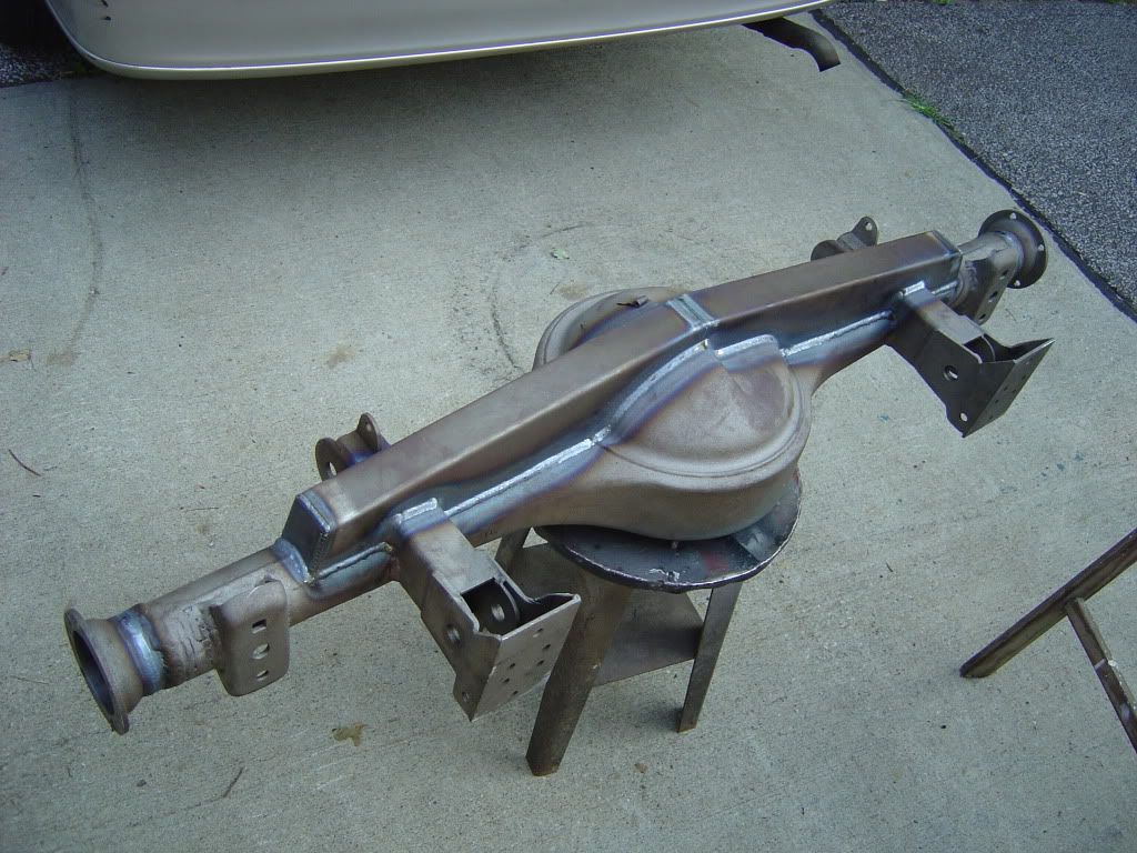

    Everything is in. Had a little drama with the yoke on the rear. Had to use the original for now. Drove the car up and down the drive way a couple times. Noticed a wierd noise, one of the zoomies was busted, so did a quick weld on that. Car is loaded ready for the G***er Nationals in Marion this weekend!

    Can you say "weldment ****"? I would get it chromed even if I had to sell my spleen.

    Unfortunatly, there is another update. I made a nice easy p*** friday mourning. Then went around, got back and the staging lanes and let it have it! All was well till around 100mph. Got a wierd vibration. Didn't go away all the way through the end of the quarter. Got back to the pits and jacked it up and looked at the u-joint. With all the messing around with it, I thought maybe I didn't get it in right? It all looked good but maybe....no next p*** did it again. The car was where it usually was, 11.02 at 117. somthing but still had the vibration. Curtis (Ernest's helper) thought that the drivers side wheel looked like it was woobling, but that was at the starting line? MCR never is a good starting line, and this time was no exception. So I just figured he saw the slick wash boarding....So after the 3rd p*** I took and put the car up on jack stands and put it in second gear. Sure enough it was moving around pretty good on the drivers side. So I took off the wheels and drums and started the car again. You could see the run out in the axle flange! Not good. I called Mark Williams to see what they would think, should I keep running or call it for the weenend. First off, they said they never have seen a flange bent. Next, no worry about the flange breaking off. So after I got off the phone I started to look closer. There is a spacer collar between the bearing and the axle flange. Not sure why that is not part of the machining of the axle, but it is very loose, both sides. I figure that can't be good, so I call back. Yep, not good. Supposed to be tight. So that finished the weekend for me. On a side note, the G***er Nationals was small and the vibe was not too good. Not alot of guys making p***es. Maybe the heat? Then the owner of the track really f---ed things up by running a bracket race today and cancelling it for tomorrow! I feel for the people that traveled to see or participate for this event. They didn't even tell Ernest! It won't be back there for sure!

    Great action shots and of the aftermath:eek:. Those Pontiac/Olds rear ends are really stout and 800 p***es is amazing. Sounds like you have your rear end
    rebuild figured out but sometimes the parts are hard to find. Fabcraft Metalworks out of Texas usually have everything needed for the 9.3" rearends if you or your rear end guy don't already know of them. (fabcraftmetalworks.com) .Think they actually may have a Willys of their own! Good luck on the rebuild!
