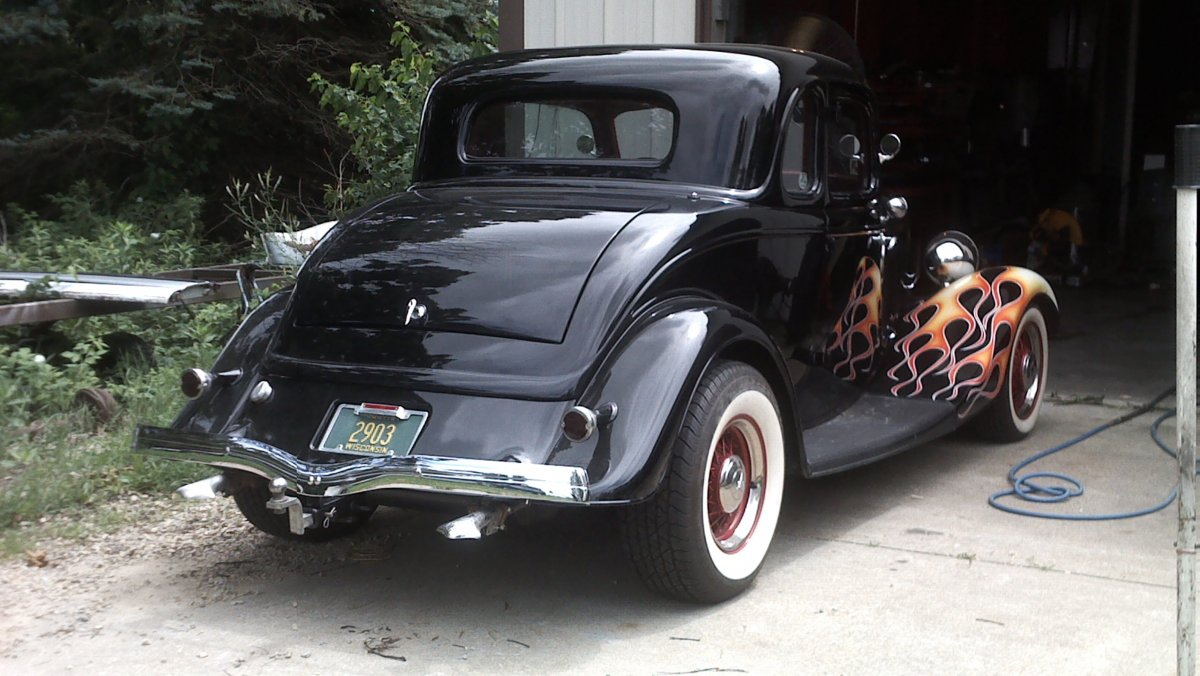

    Wool pads make my nose itch! lol But seriously I have used foam pads for over 25 years and The results are always award wining. This paint job is now 13 years old in this picture. Larry SUNP0083 (1).JPG SUNP0074 (1).JPG
