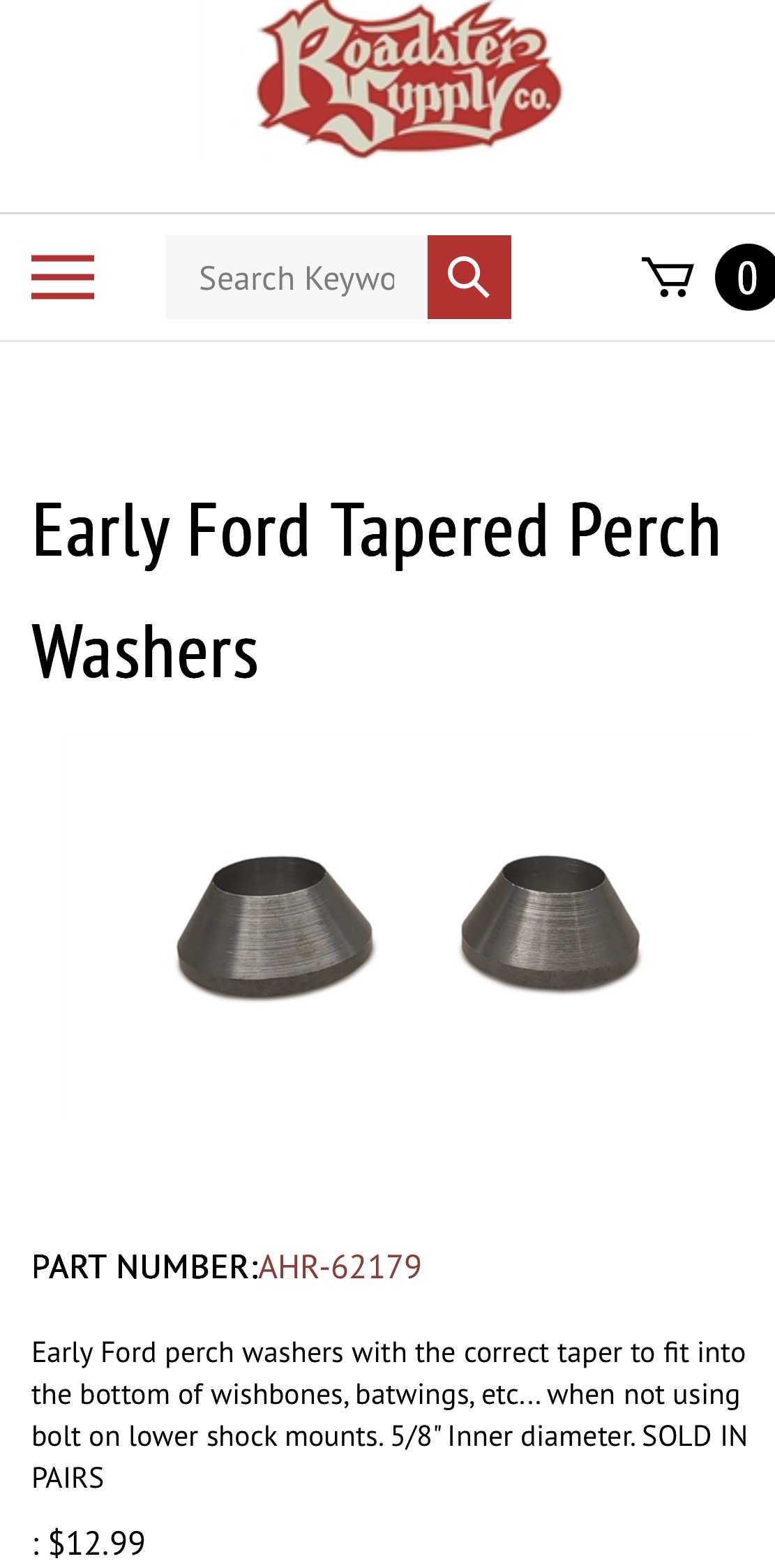

    Seems crazy that an outfit like SoCal wouldn’t supply the correct nuts with the 60* taper, but nuts are available from some suppliers and also there is this solution from Roadster Supply.
    Either way this is gonna be like what the monkey said when he pissed in the cash register- “This is gonna run into money.” :(

    True, but it would be nice if a vendor offered an option for those needing the tapered castle nuts. For a few extra bucks offer the nuts, or at least the tapered washers with the kits.

  10. Actually I am helping a newbie try and sort out a recently purchased 36 Coupe that has a spring perch conversion. The original reason for the taper cone is it is an expansion and centering location thingie. For the same reason a lug nut is tapered. If using only a cone and not a taper nut, when removing the nut, the cone keeps the thingie centered. The taper, when bolted down will crimp in and enclose on the bolt shank. So much some times you have to use a hammer to jar the cone to pop out and release. That is a diagonal load on the joint. A bolt and flat nut only make a one dimension compression. If the bolt in the hole is not a perfect, the bolt, even though tight and locked, will walk back and forth in the hole. Springs shift load back and forth with every shift in weight.
    Who in his right mind would use a ny-clad locking nut in this place ? Tapered castle nut and cotter pin. Or the taper cone and a castle nut with cotter pin.

    That picture of the tapered cones reminded me of beating on truck axles to get the centering cones on the studs to pop loose.
