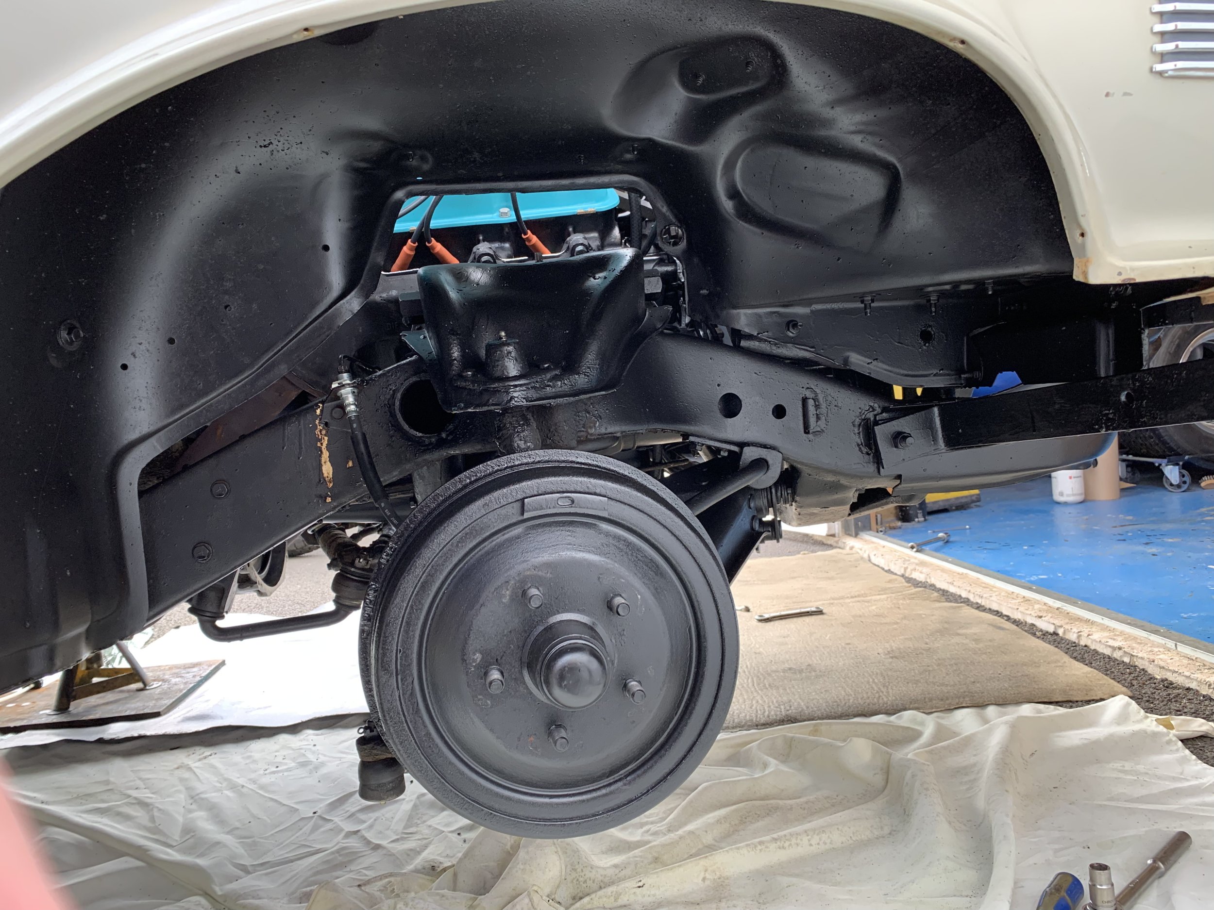

    I've done my last 3 builds using Rustoleum gloss black and it's held up great for my cars. I do the whole under body, and frames also. One car has 14 years on it, and many thousands of miles and it's almost like new underneath still.
