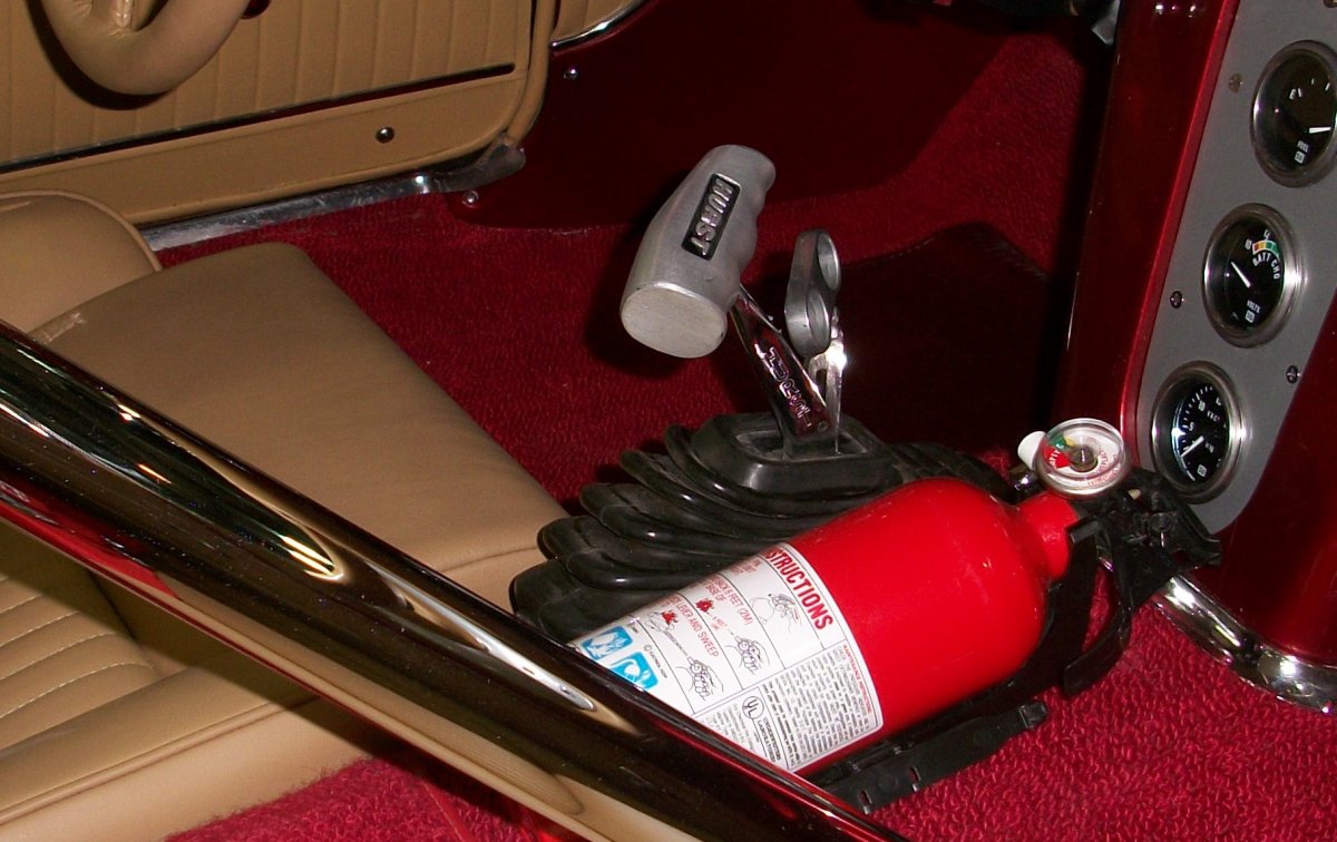

    It is a tough crowd for sure. I have manual shifted and automatic shifted cars and there is good and bad with each I suppose. Here is the shifter I run in my avatar car with a T400-it is a Hurst V-Matic. It is gated and in performance mode or whatever you want to call it is ratcheted. As automatic shifters go I like it. I was not a fan of the box it sits on so I made a bracket for it and buried it in the tunnel so only the flat plate and boot sits above the carpet. If I had another 400 I would go the same route.
