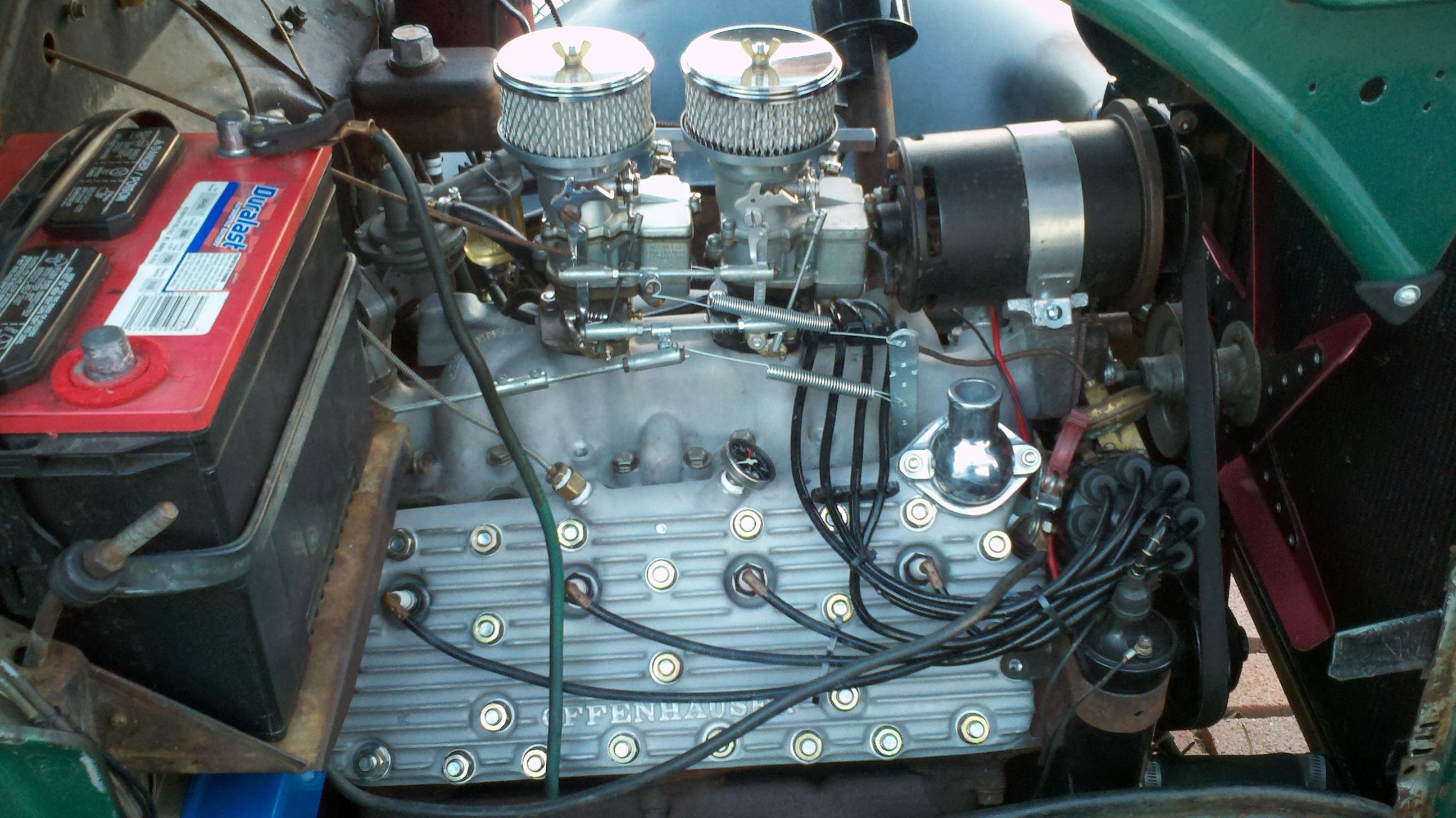

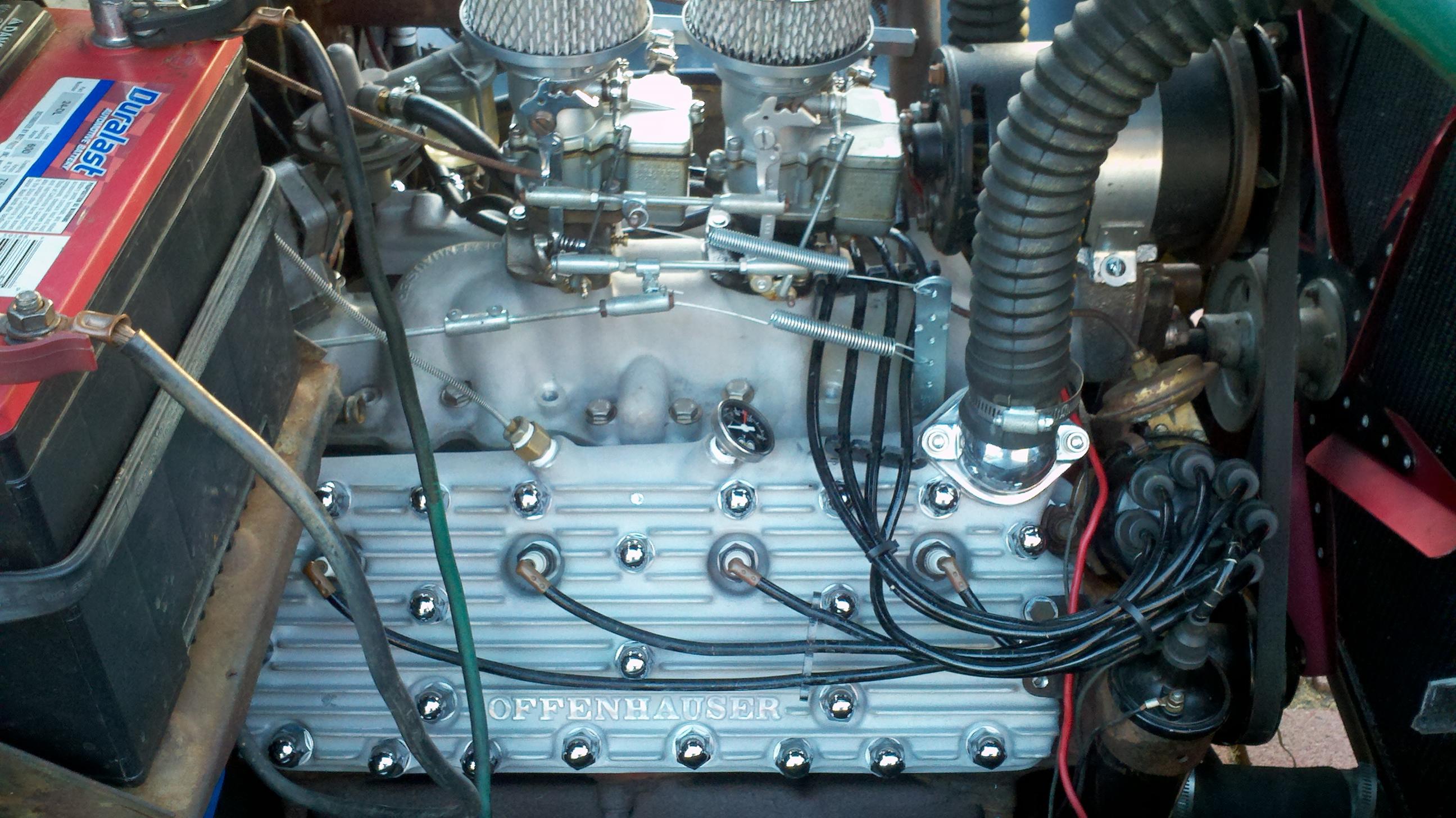

    Well, the Offenhauser heads are installed (about time huh?). No leaks from studs so far. Just going to run the engine a few more times and go thru the re-torque proceedures. This is my very first head replacement. It has taken the better of three days from start to finish. Word of caution though. The Speedway studs sold in their catalog kit are too short for the Offy! I have a few of the nuts that did not go flush or beyond the end of the studs as I had expected. Next time/build I will def use the ARP studs.

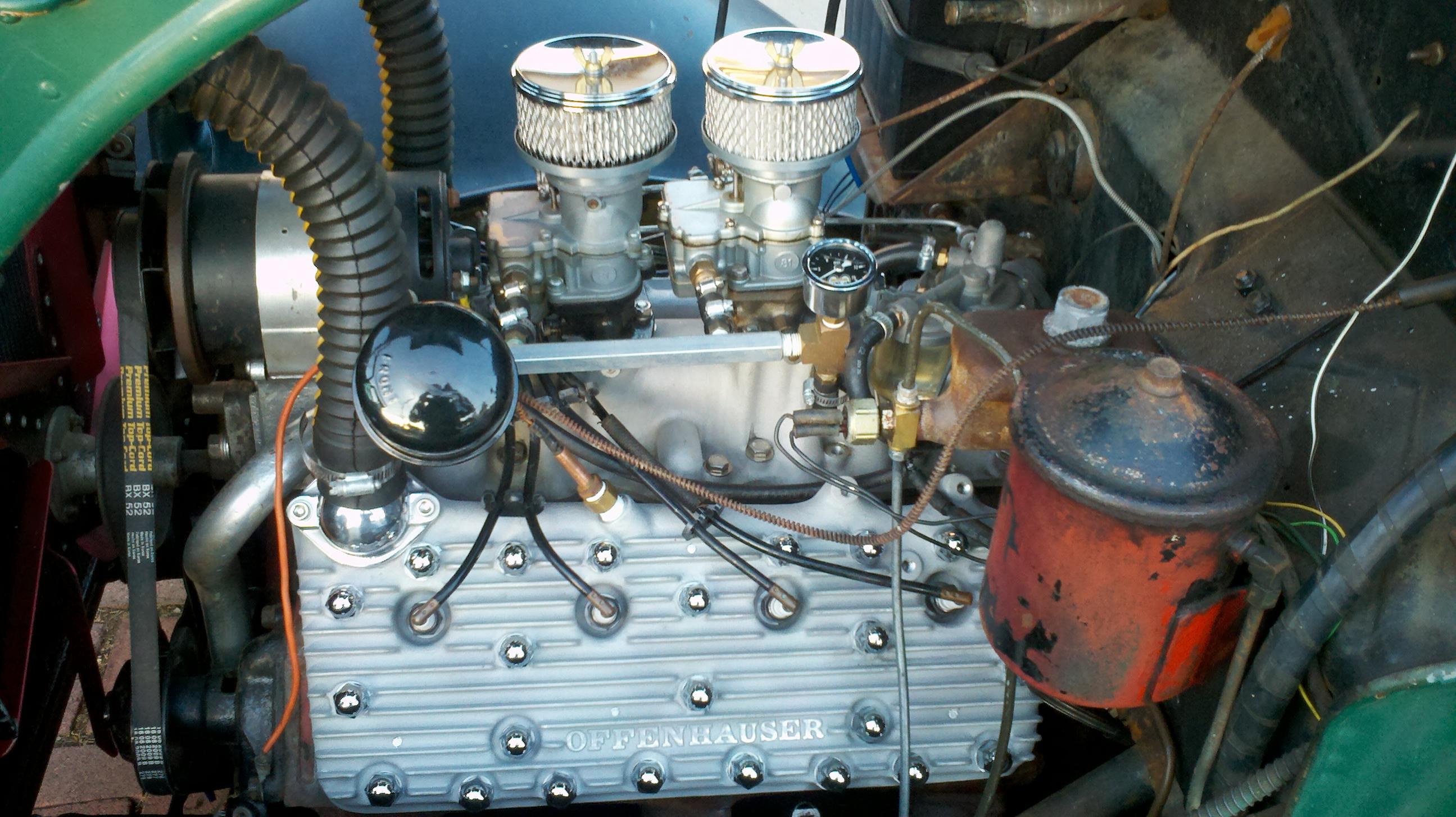

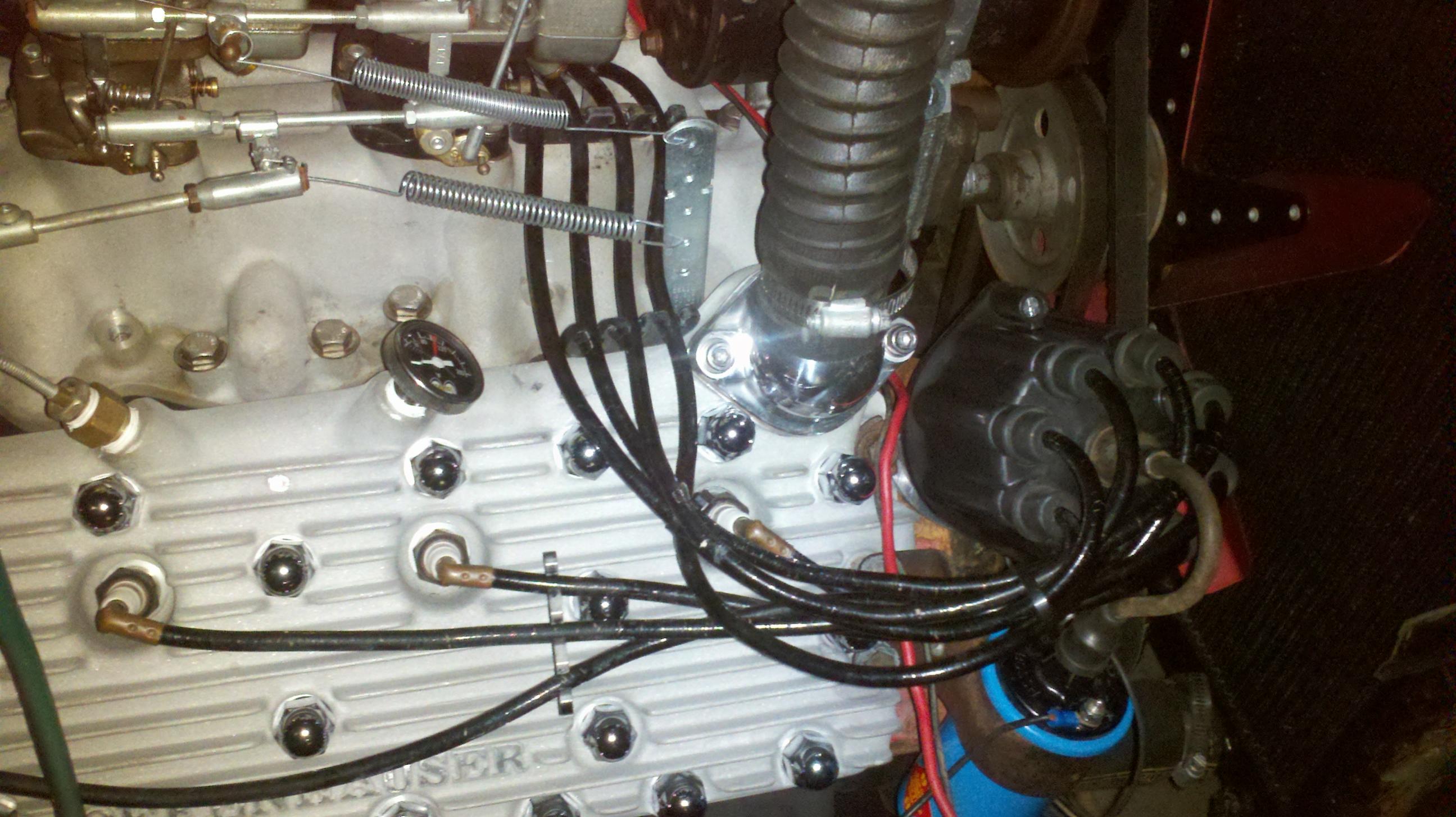

    Here are additional pics of my 8BA with the acorn nuts installed. Just ordered a Bubba Distributor today too. I will report the difference in performance soon.

    Just saw your thread today and thought I would ad my 2c. I am not sure why you chose studs vs bolts but a word of caution on both, especially studs. Anytime you have unlike metals in contact as in your aluminum heads and steel studs a coating of antiseize is a very good idea. Even using it you may run into a problem of getting those head off in the future if you need to. Aluminum heads (or aluminum in general) will tend to "grow" around those steel studs. Getting them to come loose later very often can be a real problem. I prefer head bolts for that reason. They seem to have a bit more clearance to begin with and once they are all out the head is easily removed. With studs once all the nuts are off you still need to pry the head loose from the block and the studs hopefully having all of them letting loose and sliding the head up and off. I also have found that using a gasket sealer on the threads of bolts or studs will get rid of any water leakage that can sometimes occur, especially on aluminum heads that tend to swell and shrink more than their cast iron counterparts. Same goes for intakes etc. but they tend to not seem to suffer the same problems as much probably due to less heat compared to the heads. What you did looks great though. I have an 8BA going together soon, just got the early edelbrock 3 duece intake all polished and the engine came with same head you used. My other flathead is an 8CM mercury that I am running the canadian aluminum heads. Those along with a two duece intake are all polished and look totally killer. Soon to be re-installed in my duece roadster. Dave
