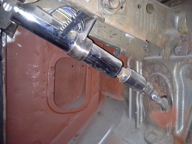

    seb fontana
    from ct
    I used a basic Ididit column. Basic, chevy type turn signal switch and plug. Had an issue getting steering wheel on, don't remember why, almost 30 yrs ago, has worked fine but I didn't like that the wires from switch to plug were allowed to rub on the steering shaft. Don't know how long it would have taken to wear through the insulation so I installed a shield. A little pricy yes even in '94. Pic should enlarge. 51 New Pics 005.jpg

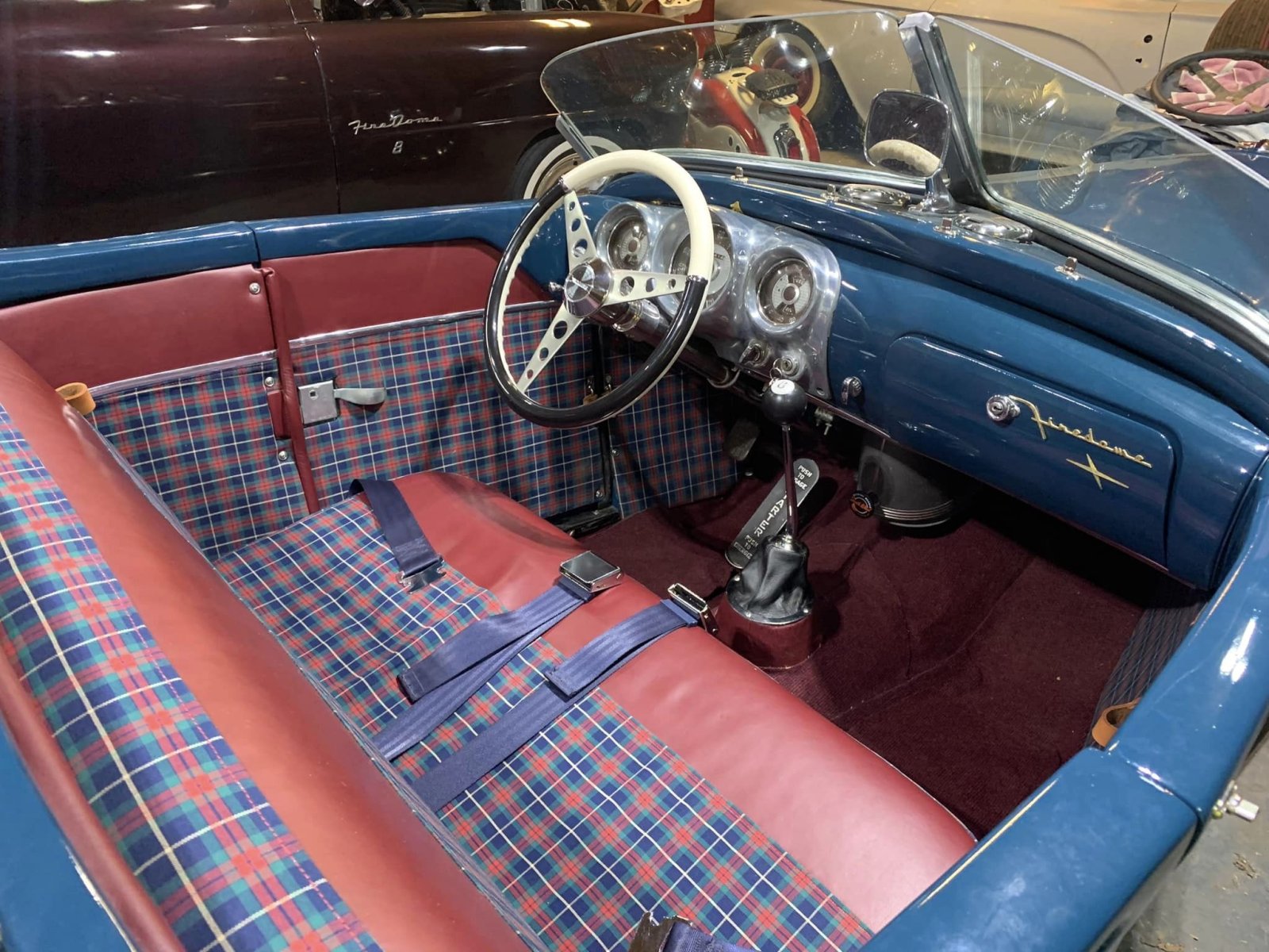

    Posts: 1,908
    vtx1800
    I'd tend to use something out of a 50's or 60's car/truck. When I did my roadster I used a 58 Pontiac column/turn signal switch etc but since the bottom was so bulky I modified it was a late 50's Studebaker column, and used the neural safety switch that came with it. I ended up with a column shift automatic, turn signals and the neutral safety switch. IMG_5335.JPG
