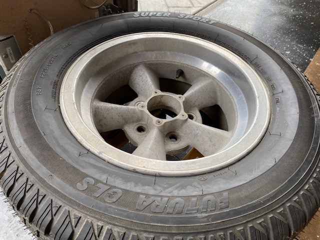

    I just sold a set of 14" AR TT's that were on my PU when I bought it. The tires are 20 years old but have never seen the street, just paint rollers their entire lives. Still have nubs on the tread surface!
    I told the guy that bought them that I ought to put a knife through each sidewall, but I left that for him to decide. No cracks, but I wouldn't run 'em.
