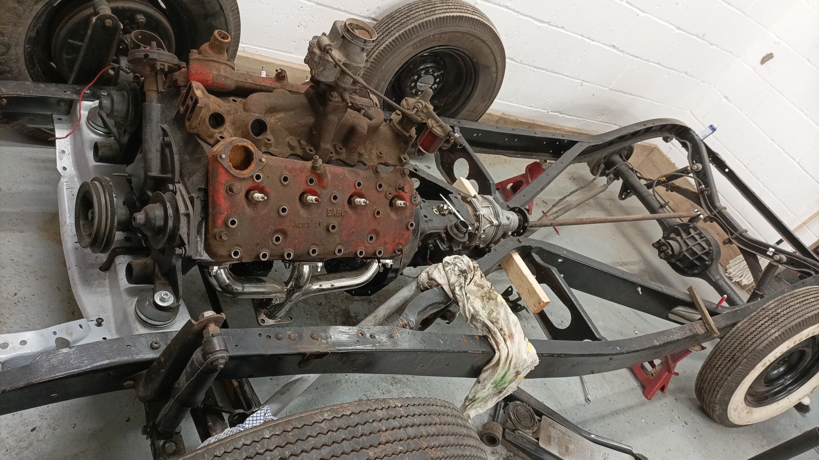

    so, found a 8cm flathead and a english ford gearbox alredy set up for a flatty,
    was a 53 engine and had the
    wrong pumps - not 51
    wrong pan - 3 rib
    stuck distributor
    stock carb
    stock intake
    3 7/4 crank
    8cm ford heads
    twin pulleys
    no starter
    heads off
    wrong flywheel
    wrong clutch
    so put up a wanted advert for
    390 holley
    4 barra intake
    short hi torque starter
    aftermarket electrastical dizzy
    4'' crankshaft
    s10 tremec t5
    flathead to t5 adaptor and clutch
    sanderson headers
    - would you beleive, someone done took it oot a running driving car to fit a sbc, ??
    hmm
    mercury heads
    nice
    merc cvrank
    all done with fuel in the bowls
    so anyplops, before i run it
    just got a fuel pressure regulator
    - question
    what psi does the 390 want to see? 6 ilb?
    want to buy a 1310 outy clip th350 chevby s10 slip yoke
    can you assure me please that gm is 26 spline and ford 25 ?
    do i need a long slip yoke in that tail or does it not matter
    also, its elastic speedo - is the hall effect pickup the same item as the later
    ones
    do they come with a tail.
    oh and lastly, there is no oil filtration at all on this, is that bad?

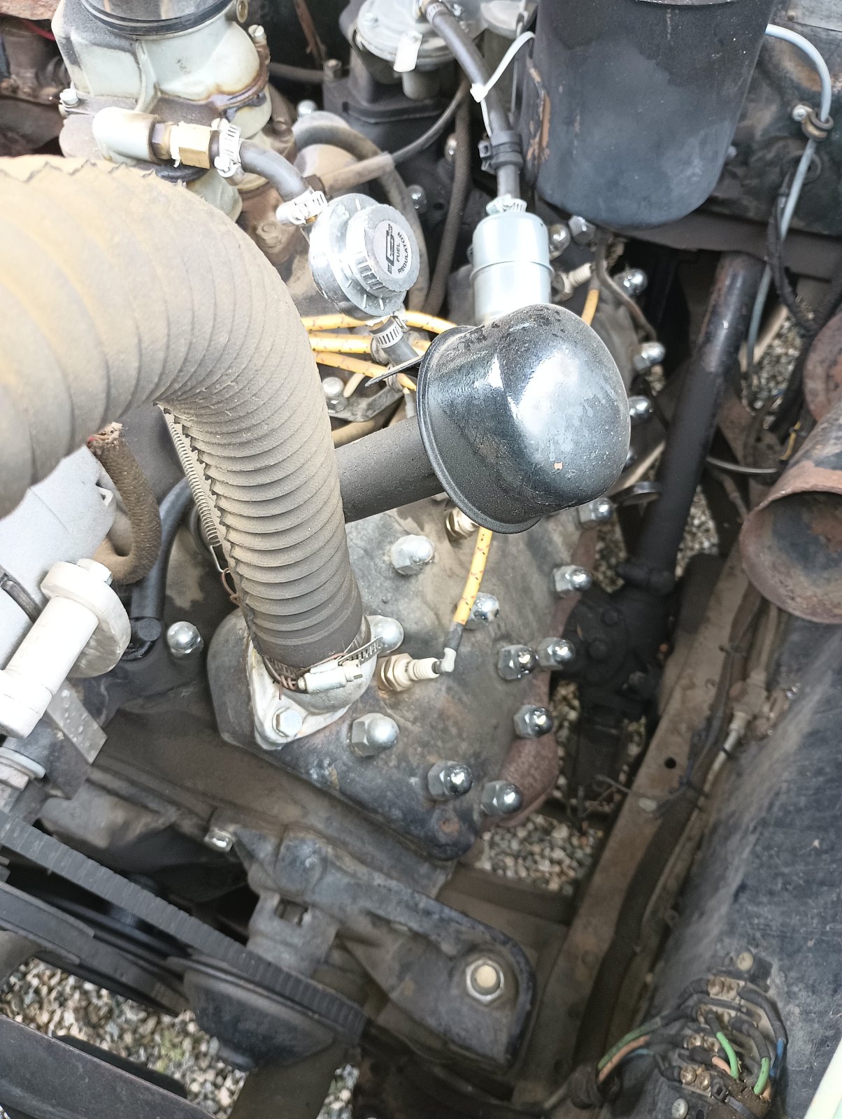

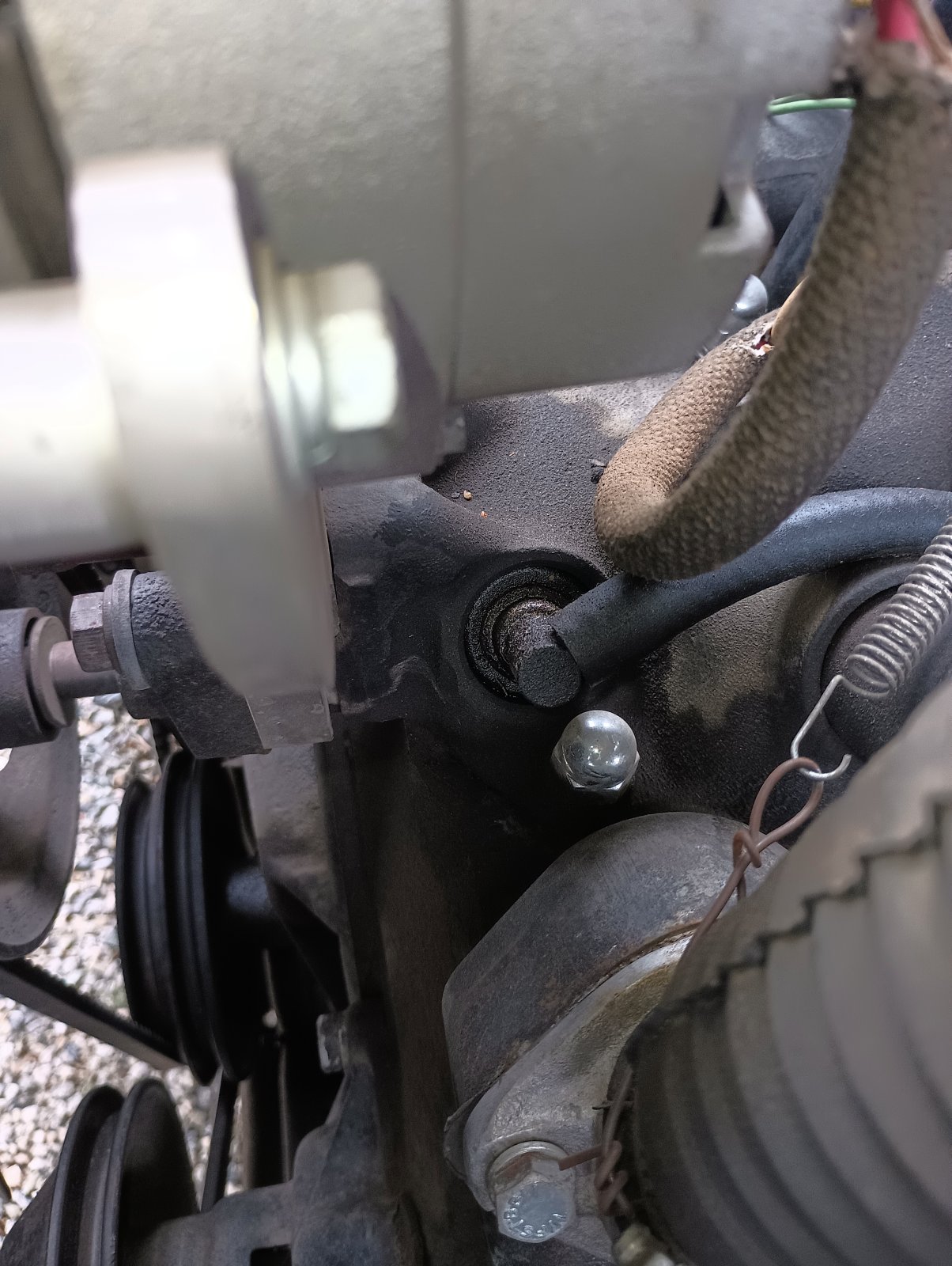

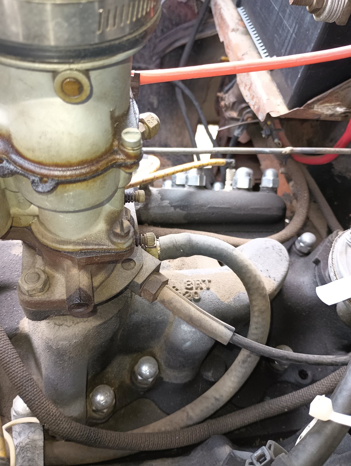

    Pretty straight forward on an 8ba. Remove the road draft tube and insert a grommet that a PCV valve fits into. Use a valve from an engine that is about the same cubic inch displacement as your flathead. I used one from a 231 Buick. Run a hose from the valve to the vacuum port on the manifold and call it a day. pcv1.jpg pcv2.jpg pcv3.jpg

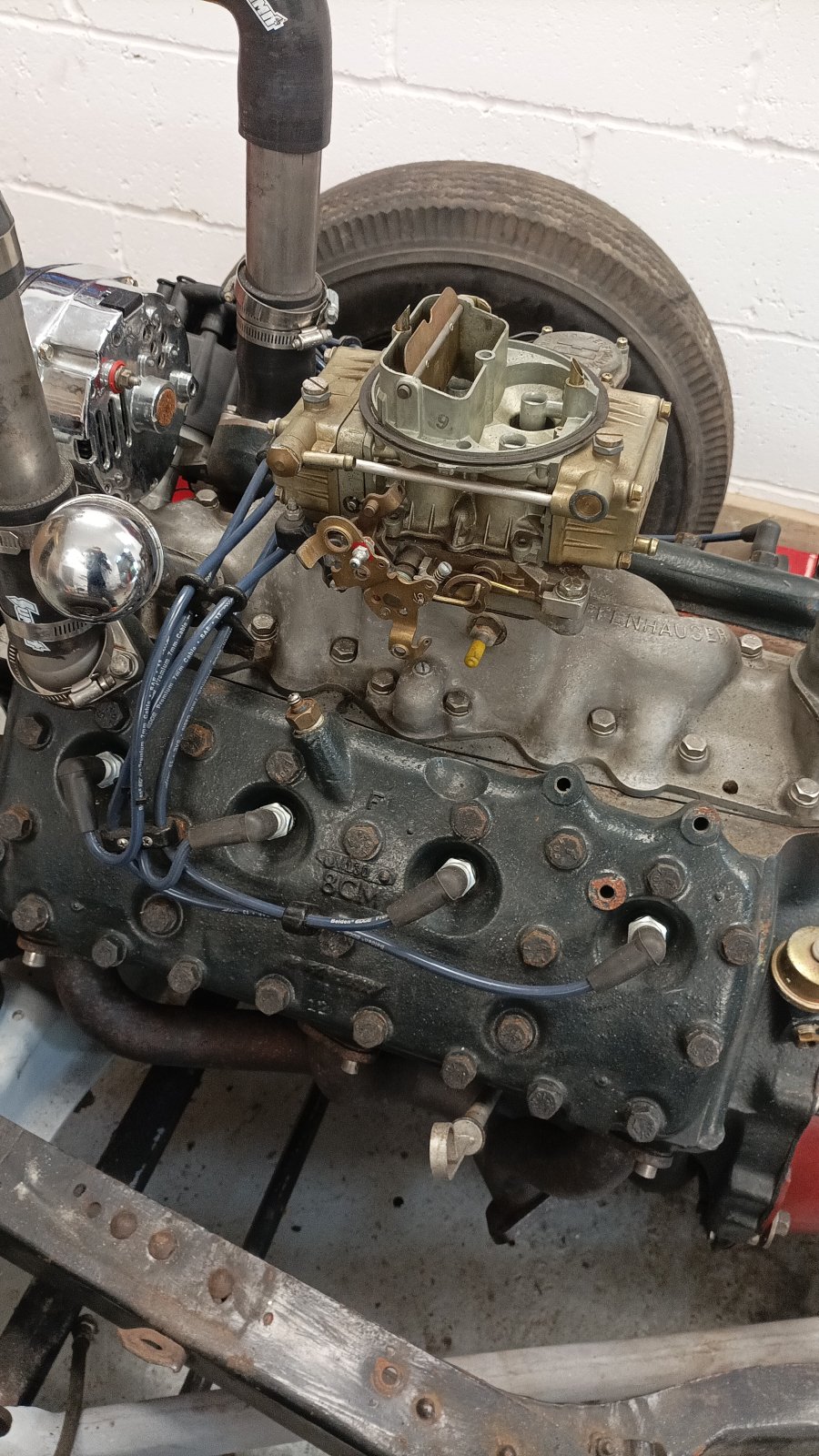

    My 390 fuel pressure is set at 3 1/2 psi on my 8BA.
    You didn't say what car you're working on but, in a 40 Ford the 390 accelerator linkage
    works best with IMG_2845.JPG IMG_2845.JPG carburetor installed backwards so carb linkage is on passenger side.

    theis is going to be right hand drive, i have the stock rhd go pedal and rods
    maybe it will work
    -the thing came with a hydraulic clutch set up
    but i think it maybe easier as it has a chevy fork to go cable and use the stock clutch pedal to pull
    again there 'might' have been a go to clutch cable for length lhd, hmmm

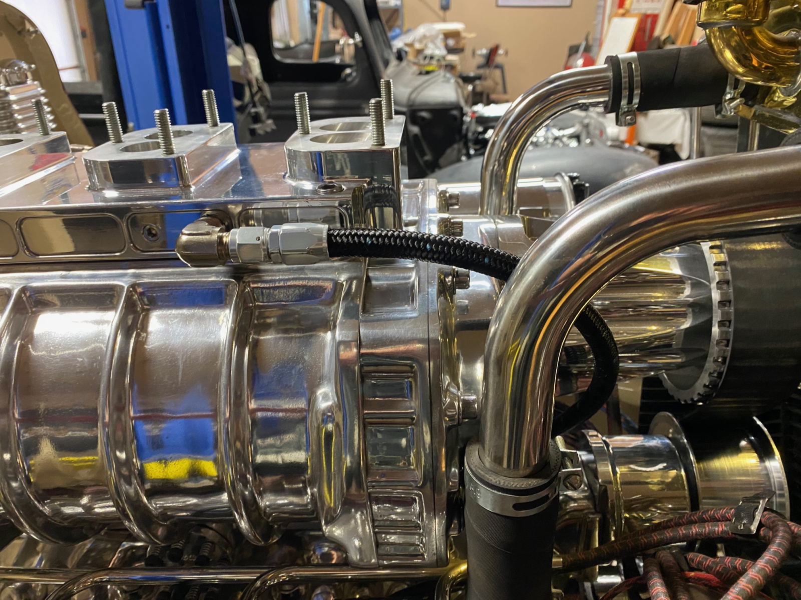

    As @51504bat posted, it is easy on an 8BA that still has the internal pipe under the intake manifold for the raod draft tube. I bought a PCV off the Ford barn that was made to fit the intake draft tube. The hard part was a vacuum source on my application. I took it from above my blower in the carb base.
    The air enters through a breather on the rear of the intake manifold. Prior to this I had oil dripping from the bottom of my pan and that all too familiar flathead stink. After install, no leaks at all and no smells other than 92 octane in the morning.
