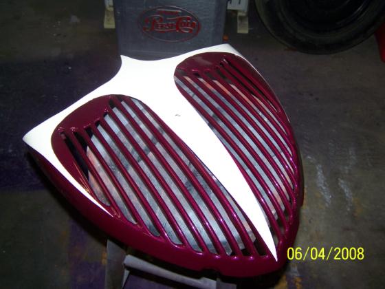

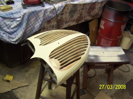

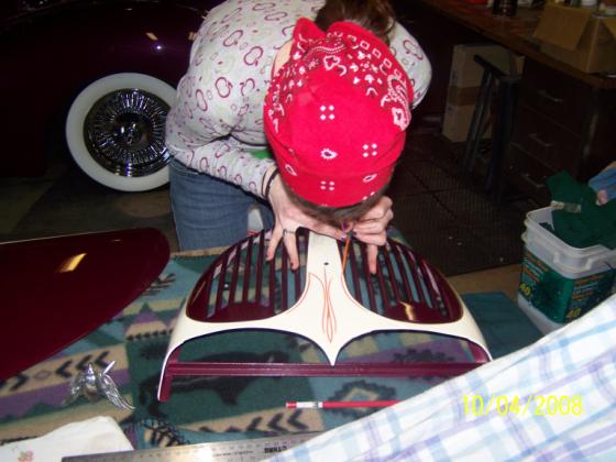

    100_0892.jpg es mine 39 hood sides hot rod Jen striped it

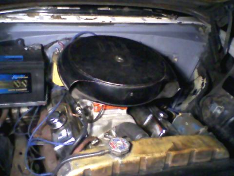

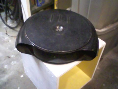

    The picture is a poor cel phone one of the first mock up, the final version will be about 3" lower than shown. The air cleaner that I have in progress is a early 50's oil bath, 16" in diameter and 5 " high, origin unknown, that has been gutted. The top has had the innards removed leaving a lip to cover the top edge of a paper element filter. The interior has been gutted and the bottom removed. The new bottom is the bottom part of the original 66 Riv air cleaner. That unit drops the filter base at least 2" below the top flange of the carb so when installed you will not be able to see the carb from the side. Will be using a filter that is 3 1/2" high inside. Because of the molded shape of the bottom of the Riv air cleaner all linkage and lines have clearance.
    Canuck
  9. LoneSpar
    Joined: Oct 21, 2010
    Posts: 250
    LoneSpar
    from Pacific NW
    That is really a good idea!!
  10. Racrdad
    Joined: Jul 27, 2007
    Posts: 1,208
    Racrdad
    Now thats unique! very cool!

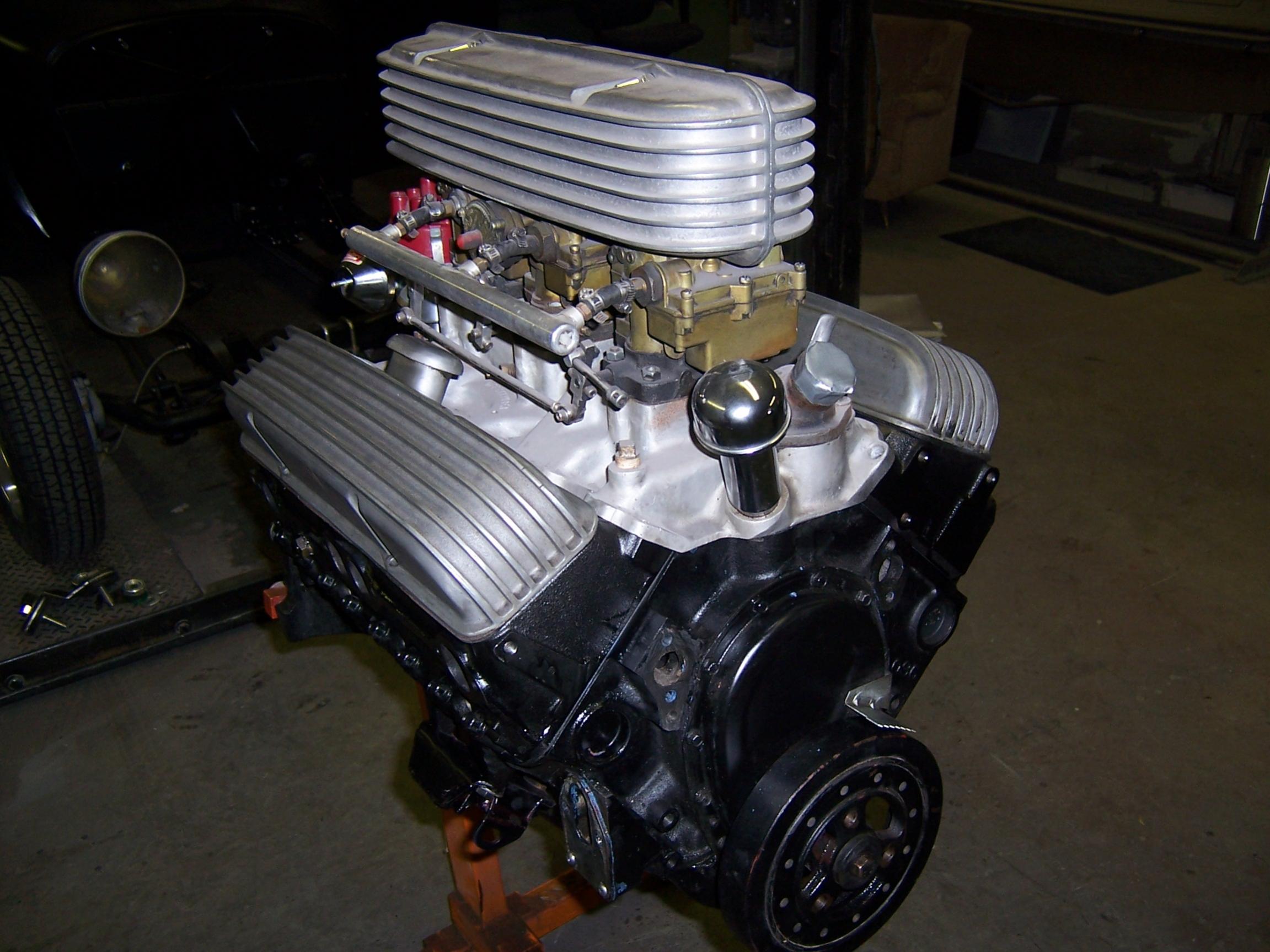

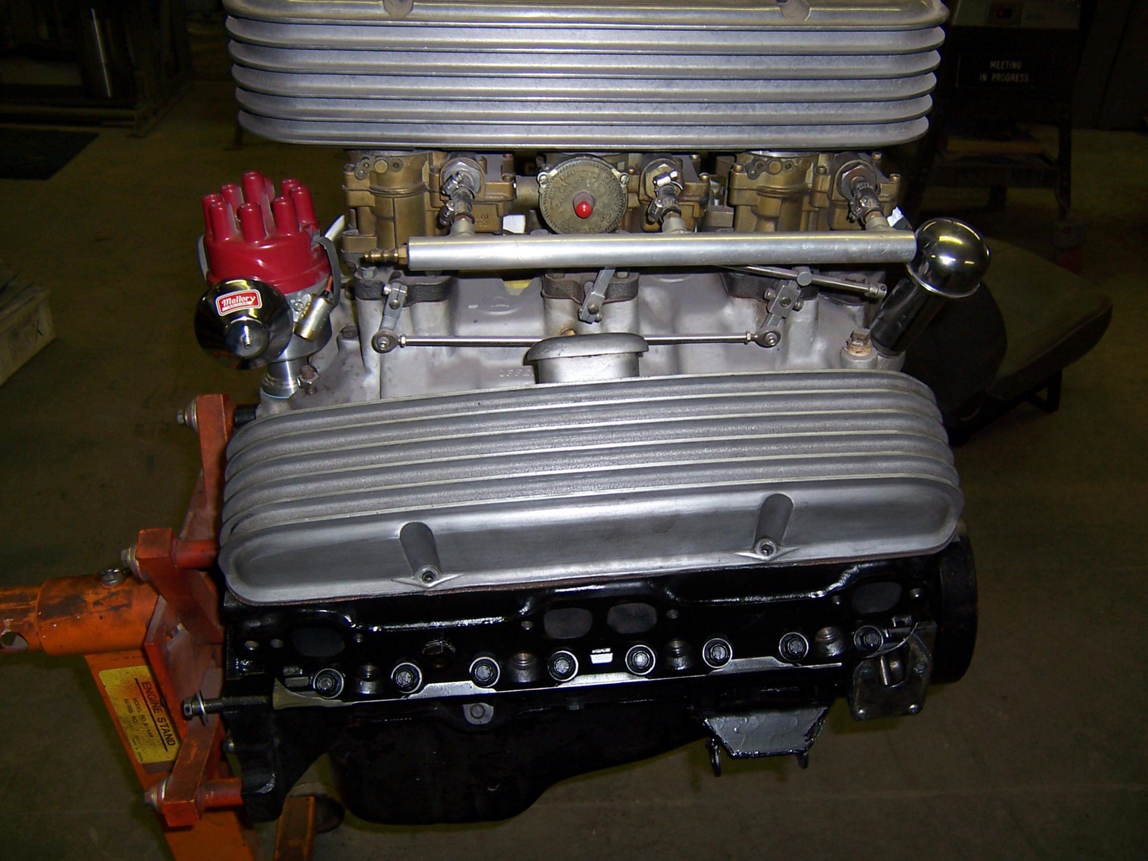

    Here's What I made For My tri power it matches my valve cover's:)
  28. LoneSpar
    Posts: 250
    LoneSpar
    from Pacific NW
    That Looks Great!!!!!
