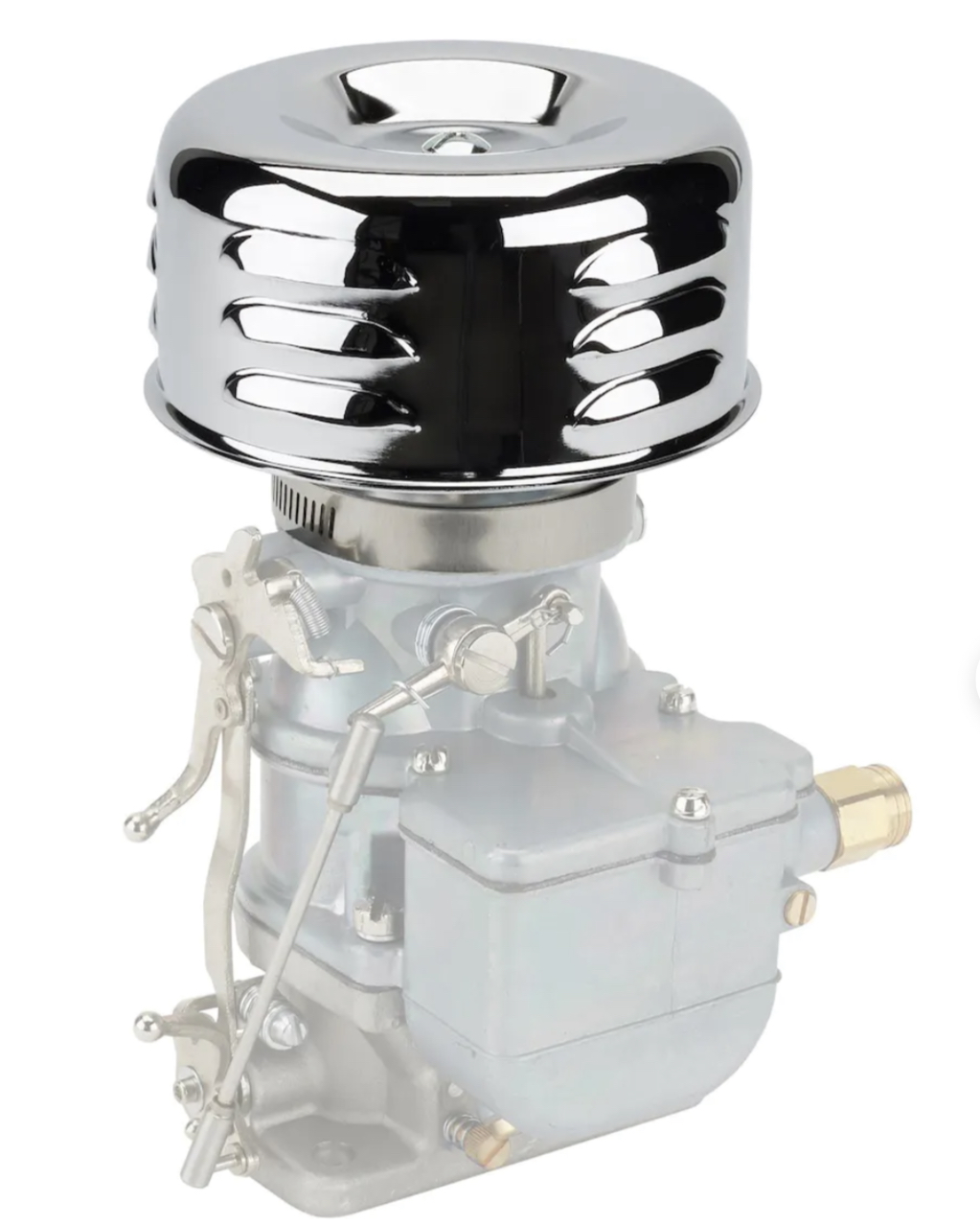

    There are a bunch of cheap air cleaners out there. Most, not all , will restrict air flow to the point of making the carb run rich. The ones that come to mind are the speedway louvered units

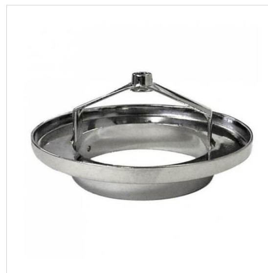

    When we raced the 348 Impala, we always took off the air cleaner. Relatively no dust in the air and going for a blast of 14 seconds in the ¼ mile was fast for us. So, the with the air cleaner off, everyone’s stock cars sounded like a bunch of hissing snakes. To keep the "no air cleaner" look and performance, we tried to keep them off of the three carbs. But, there was too much stuff floating around in normal daily driving, everywhere, so it necessitated an air cleaner of some sort.
    The chrome cap version was ok, but was a little restrictive. No filter element at the time. Then someone came up with a chrome flat top with a wing nut to securely hold down the air filter element on the three carbs, individually. Similar to Item A
    upload_2023-4-15_3-56-40.png Item A

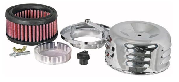

    I borrowed the three air filter caps from my friend’s 57 Chevy, for the 348 motor and it worked fine. But, they were his pride and joy look. So, I was again, in the search. Since I liked the three chromed cap look without a filter element, if it were around back then with the look and filter elements, it would have been the one. See item B below.
    upload_2023-4-15_3-58-11.png Item B with some air circulation...
    But, the flat top version with the exposed filter was my choice. They look good, and a filter inside was as good as they were. Not K&N quality, but good. we just needed the extra money to buy those three caps/filters...

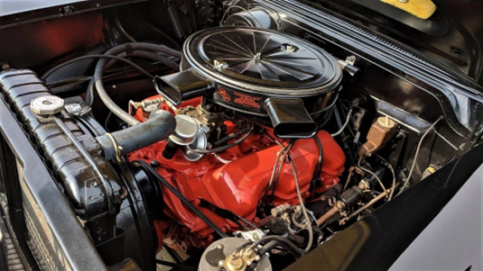

    upload_2023-4-15_4-0-57.png stock 348 - 280 hp motor and air cleaner with interior filter element...
    But, as money and time goes, the best air cleaner for my application of three carburetors was the stock air cleaner. We timed the difference in no air filter/cleaner versus the full stock cleaner. There was so little difference that it was not worth it to keep it off when driving all over So Cal. Now, I had money to spend on chroming the top lid, the valve covers and add some Moon Breathers on each cover.

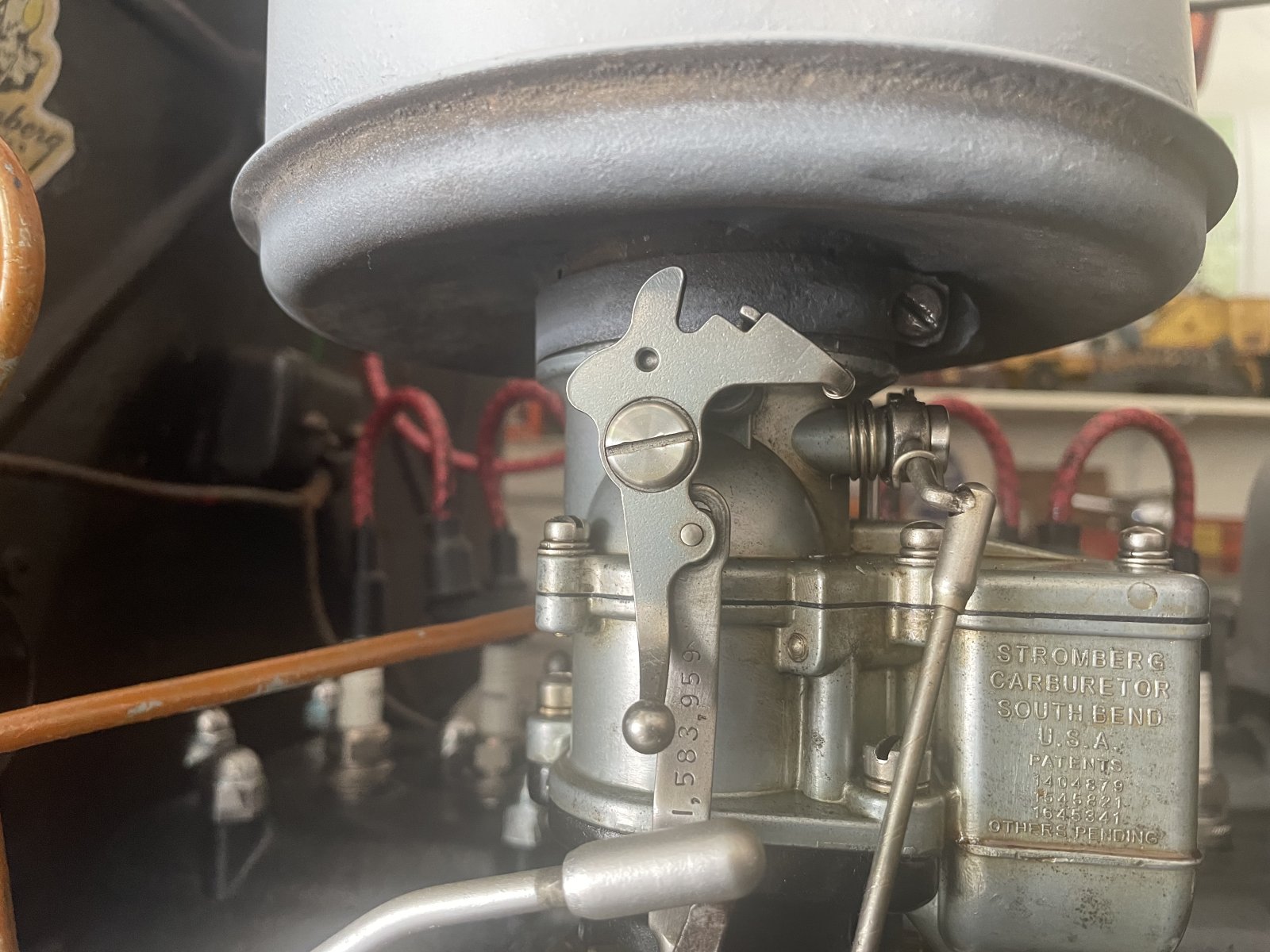

    A cl***ic look is late a forties Chevy dry element air cleaner. They are built for one barrels but could easily be made to fit a two.
    I have one on my 230 flathead dodge motor. D79D6A34-EDB6-4E5A-A82C-9D1516C93E6E.jpeg

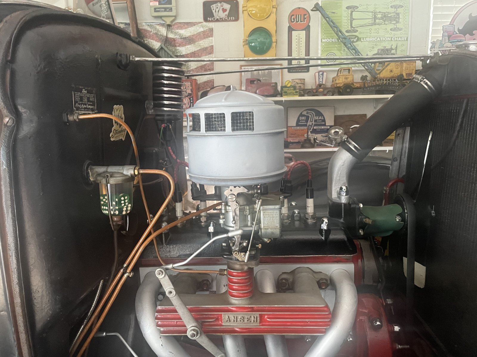

    I’m using a 36 Ford dry element filter.

    i like the factory ford on there. very much what im lookin for. would you be able to show me how it clamps to the carb

    All should fit over the carburetor neck and include a clamp to tighten down.

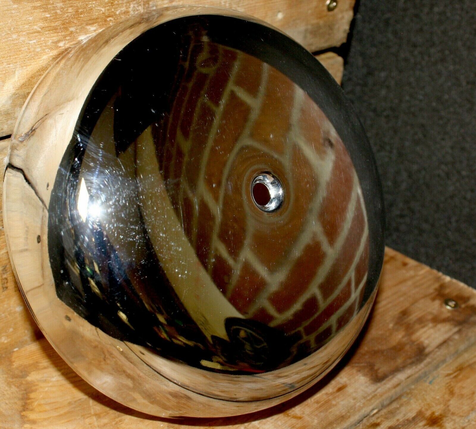

    I've eyeballed the older chrome Harley V twin air cleaners figuring that they could be adapted to work on a single one or two barrel carb pretty easy. I picked up a round cover for one at a swap meet a few years ago for 5.00 or so . It's out in a box in the shed so for show and tell is this Super dixie 7 inch air cleaner cover off Ebay for 20 bucks,. eBay item number:144563841101
    Dig out one of those too little air cleaners for a 97 that we all seem to have in the stash box because they were cheap at a swapmeet and take the base off.
    Buy a 6 inch od, 4 inch ID 2 inch tall air cleaner element for a lawn tractor and then dig out that s**** sheet of 1/8 aluminum sheet that you had left from another project and mark off a 6 inch circle and dig out the hole saw that lets you set that "base plate" down over the base off the little air cleaner and you have a different but not spendy aircleaner and if the top comes used out of a swap meet it is pre aged. Super dixie air filter for harley.jpg Screenshot (1452).png upload_2023-4-17_12-40-39.png
