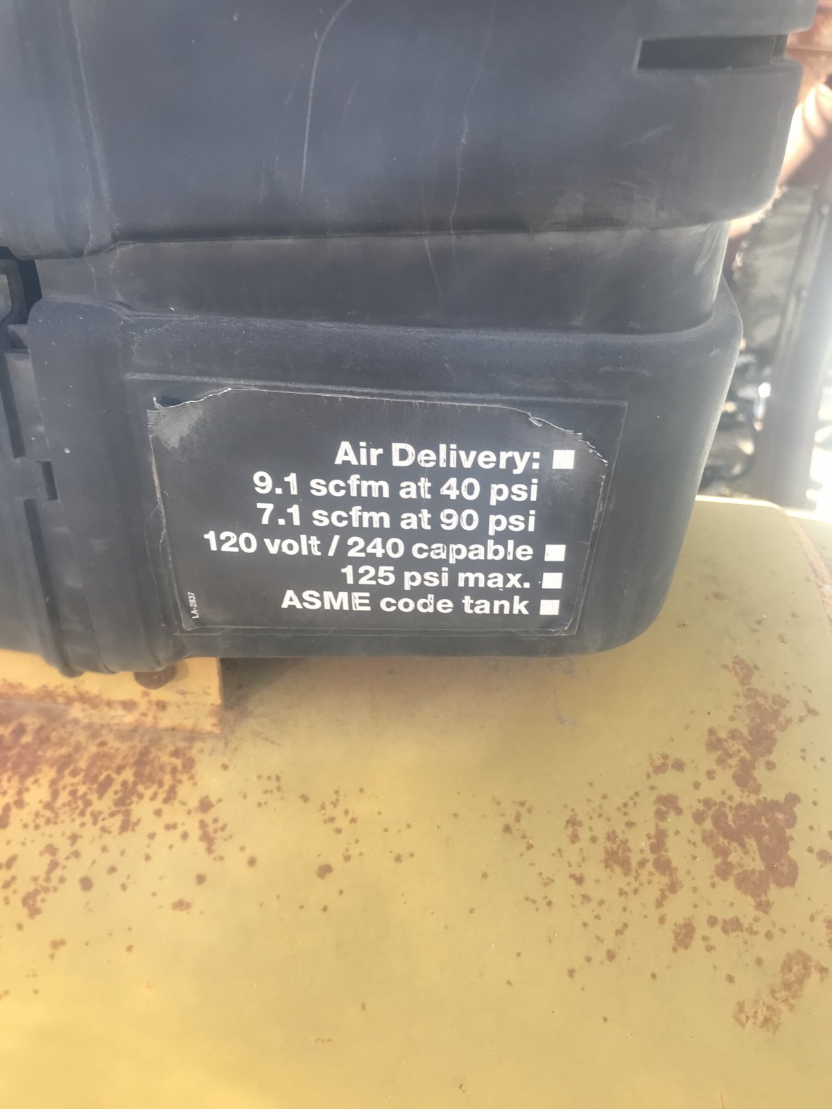

    image.jpg I say the above between beers waiting for my 5hp 25 gallon compressor to catch of with my air drill;)

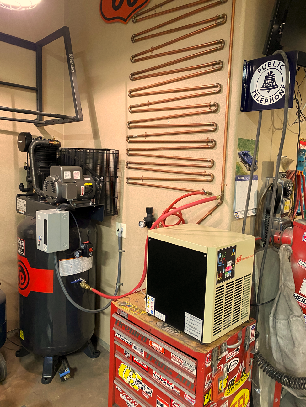

    If I was the OP, I would wait for a good used minimum 5HP cast iron 2-stage with an 80 gal tank. Outfitted properly it will serve the purpose well for a hobbyist shop for blasting/painting or any other air requirements.
    My current compressor has been in place since 1984. It is as recommended above a cast iron 5hp 2 stage 80 gal with a centrifugal unloader. I took the time to run new copper line from the air compressor. The compressor is outside the garage in an insulated, sound reducing enclosure, on the shaded north side. It's mounted on rubber isolation pads. The tank has a timed self draining valve for removing water. It just drains into a pan. I used a length of rubber through the wall of the garage to eliminate any vibrational effects.
    I do a lot of sand/abrasive blasting in an outside structure and do all my own painting. When not in use, I do not store air in the tank, therefore it is drained. I achieved zero moisture in two separate airlines.
    One line has a filter, regulator combo and is water free for air tools, the other is oil and moisture free using a Motor Guard Submicronic Filtration Unit, desiccant water separator, an aft particulate filter and a regulator, specifically for blasting/painting.
    I used the higher priced 'type L' 3/4" copper which is a lot heavier. There are 4 upright runs with water traps at the bottom. I have not gotten so much as a drop past the second upright. This was built on the bench and then put in place. A lot of soldering that took a few hours to complete but well worth the cost and effort.
    There is nothing worse than having a spray gun spit out water or clog blasting equipment with moisture. This solved that problem. Works great! I have been a professional painter for more than 50 years and now that I am retired applied what I learned during that time to outfit my home hobby system at a reasonable cost without too much effort. It serves the purpose for my home shop.
    I use a homemade pressure blaster I made from a 60lb propane tank. I made a gun that uses different size ceramic nozzles and is out fitted with a separate airline for additional air assist delivering the media.
    In the copper water drop pic below, the compressor is in the enclosure on the other side of the wall. The bathroom fan draws air from the climate controlled garage into the enclosure. The water drops are manually operated.
    When blasting I have never run out of air, blasting with usually 90 PSI. It builds up enough volume while I am refilling the blaster tank, so I never run out of air.
    I blast in an outdoor converted gazebo with a pressurized fresh air supplied hood.
