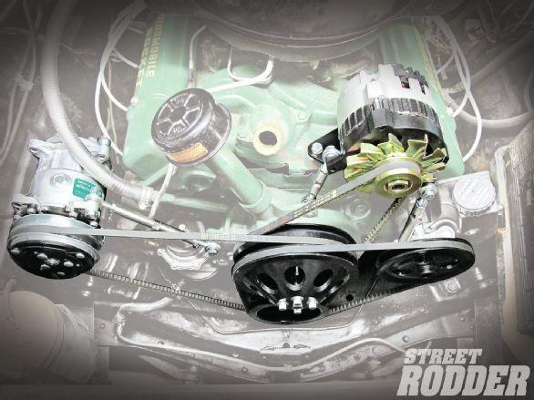

    Not a hemi but I’m in the process of installing an ac compressor on a 303 olds and will be going this route using adjustable tensioning rods from Amazon . Pretty clean and simple.

    Is this a particular kit for the mounting of these accessories? This is really clean routing for a full accessory drive on an early Olds. I'd be very interesting in hearing/seeing more about this.

    Not a kit, just saw the picture online and it made sense so I purchased the tensioning rods from Amazon. They come in different lengths and are strong as heck. I just got them in the mail today and plan on running an 8 1/2” one in the front like the picture and a 2 1/2” one attached to a small bracket on the front head bolt. I think it should work?
