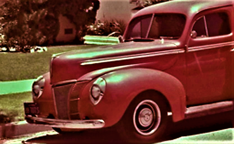

    We had a 327 powered 40 Ford Sedan Delivery. It came with an old York compressor. The cold air was a good unit for the times and was very cold inside the back cave, too. It worked well in the warm So Cal arena. But, eventually, began to lose its “cold” power. So, refilling took a couple of freon cans. That lasted the whole Summer, but as fall began, the hoses were old and needed replacing as leaks kill the whole process. (Remember, we bought it as a finished car, but, it turned out to be a "project car.")
    At this time period of hot rod building, the old York vertical compressor units were the mainstays of A/C for custom installations. No rotary units as yet and no Vintage Air Company. When the rotary units came out, the York units were old hand and not the first choice of custom installations.
    But, leaks do happen. Usually a couple of cans would charge it enough to get the cold back inside. Like burning oil, it was as an ongoing process and a repair from an A/C repair shop took place.
    Jnaki
    That was our first A/C unit and it worked so well that driving the sedan delivery for my wife was number 1 and she always had first choice. Either that or a funky 62 Corvair… that made the choice simple.
    Currently, all of our daily drivers have A/C and with the new tech, almost problem free. If a repair is necessary, the dealer or A/C repair shop has all of the tools and “stuff” to get it right. New hoses, parts, etc. Yes, a hot rod guy should know what goes on the motor or in the motor compartment, But, sometimes, it is easier to just let some other professional take care of the problem.
    Despite having an old York compressor, the 1940 Ford Sedan Delivery 327 powered with A/C was a pure gift for the both of us. We eventually had to replace some seals in the vertical unit, new hoses and a leaky fitting. But, those early A/C units were usually from GM junkers in s****yards, so, who knows how it was taken care of in the build or from original owner(s)
    I usually got stuck driving the Corvair… what a choice in comparisons… But, a happy wife… and that direction, lasts forever. YRMV
