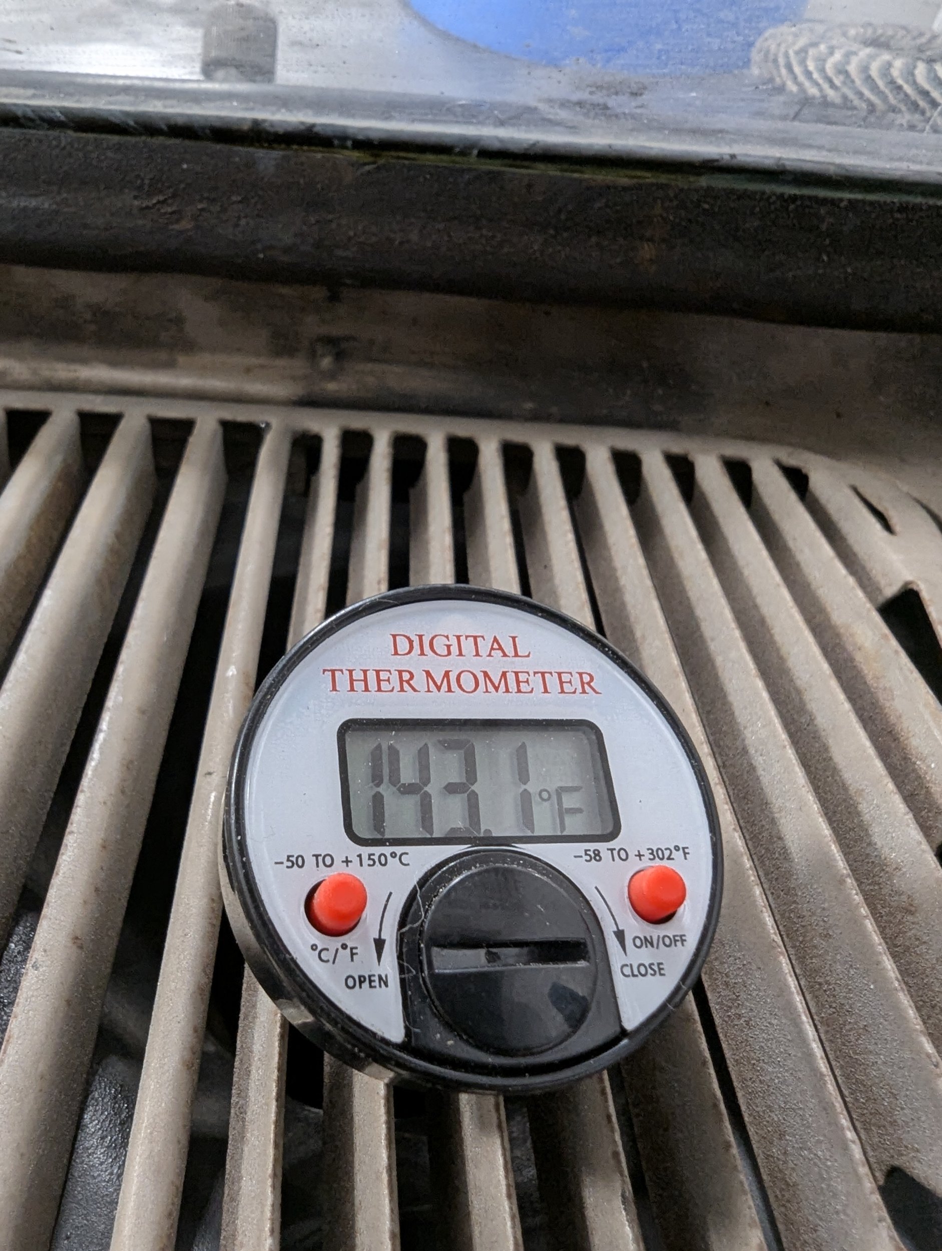

    gimpyshotrods
    The VA Gen V, with the big fan, in my Falcon.
    A 99.8º range, all in a 72ºF shop.
    deuceman32 likes this.
