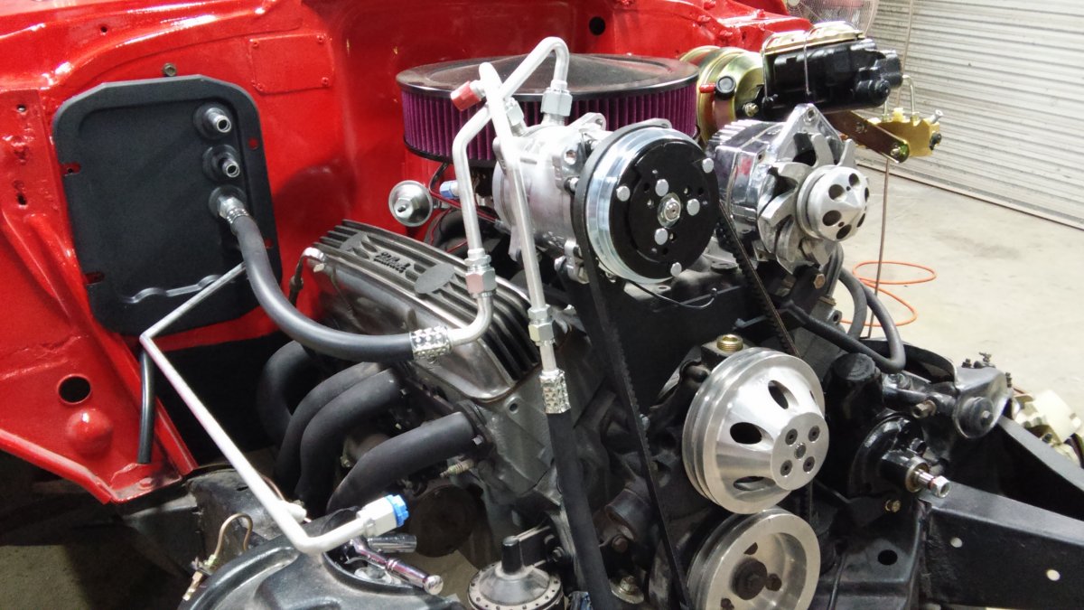

    Adding an electric fan helps at idle or in slow traffic to keep the ****pit cool. At least down in the Florida summers it did. 2015-04-22 20.11.41.jpg

    I have seen a lot of different A/C units in old hot rods. Before Vintage Air came to be popular, there were home set ups that worked well. (utilizing GM parts and hose kits for our 327 motor and others.) There were a lot of installers that did all kinds of A/C units. When the rotary compressor motors came out, the installs were much easier to set up and made the motor compartments much cleaner.
    In your photo/install, would it be possible to move or rotate the compressor motor to a lower area out of sight? Or at least , if not, rotate the compressor so those lines come from underneath to connect. In some of our old A/C compressors, it was possible to move or rotate the actual compressor as much as it could for clearance, as long as the belts aligned correctly. The hoses did not hinder the sight of the motor or valve covers. So, it looked like a much cleaner installation.
    Sorry, if this was a preliminary set up photo and the final install moved the hoses lower or somewhere else. If so, could we see the final installation photos? Thanks...

    southcross2631
    Finished product. The customer didn't want to pay enough for me to hide everything. One bracket for A/C compressor and Alt. Clean enough for the customer. 2015-09-17 12.54.59.jpg 2015-09-09 11.15.21.jpg
