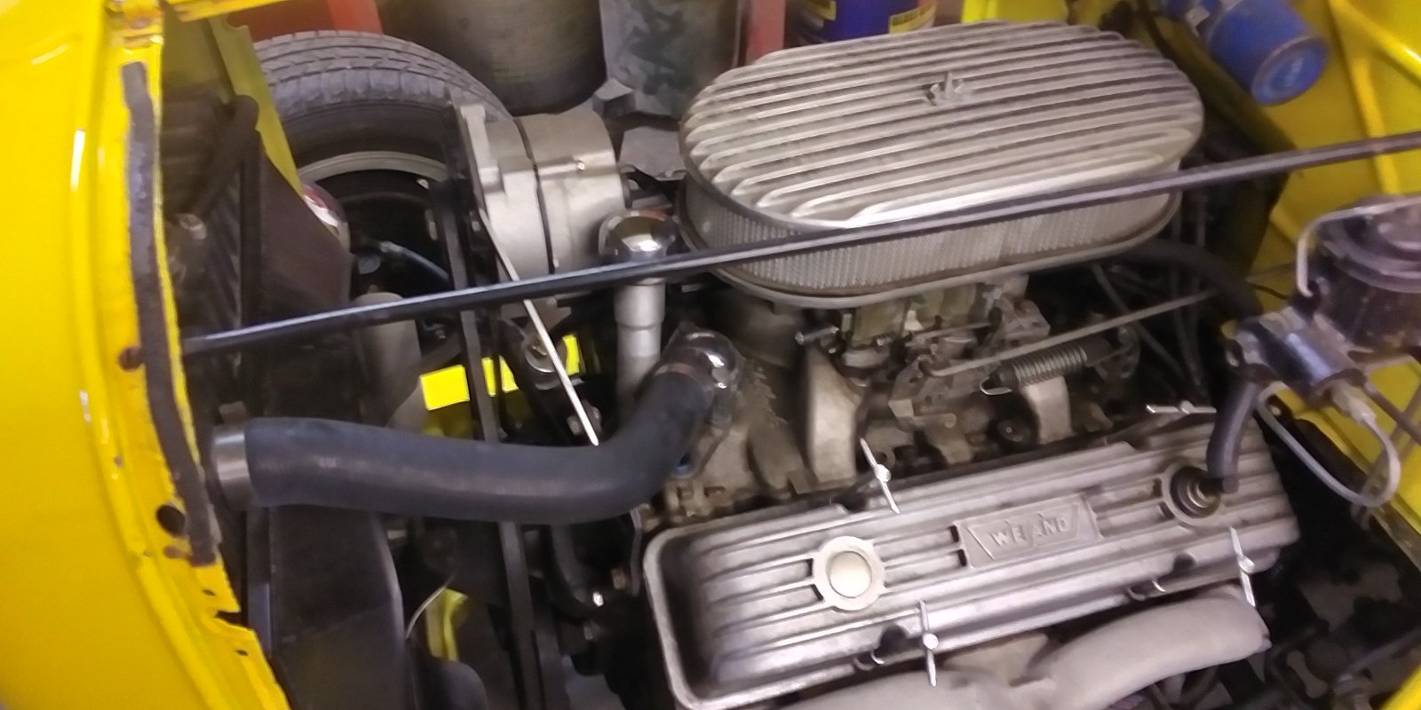

    [​IMG]I have one of these Speedway air filters looking for a Wix or equal, element, having problems trying to locate one, anyone have any luck with this ? Thanks in advance.

    I use a Napa 2099. That is a round filter, I carefully bend it into an oval. Works for me

    Hi Dan,
    According to their web site:
    • Dimensions: 11-7/8"L x 8-1/4"W x 3"H

  8. I didn't find anything in stock form as it's an odd size. There is oval filters out there in regular brands but they are either a smaller or bigger oval. I think @RMR&C has the right idea if you want off the shelf.
    These are the closest, but not exact:
    Summit SUM-G280E and SUM-G284E2
    K&N E-3505
    Mr Gasket 6405G
