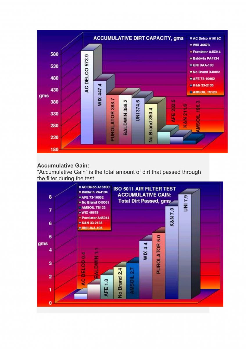

    Yeah, this is good info and it points out how poorly the oiled foam type filters perform in actually filtering dirt. Not only that, but the "advantage" they have in flowing air is very limited for a short time, until they start to collect some particulate matter, at which point they perform substantially worse than a good paper filter. I have to say I'm surprised at how poorly the Amsoil filter performs, that's bad. I knew the F&N filters are ****, but I didn't know that Amsoil filters are so bad. Good info, thanks for posting. I'm filing a copy of that for future use.

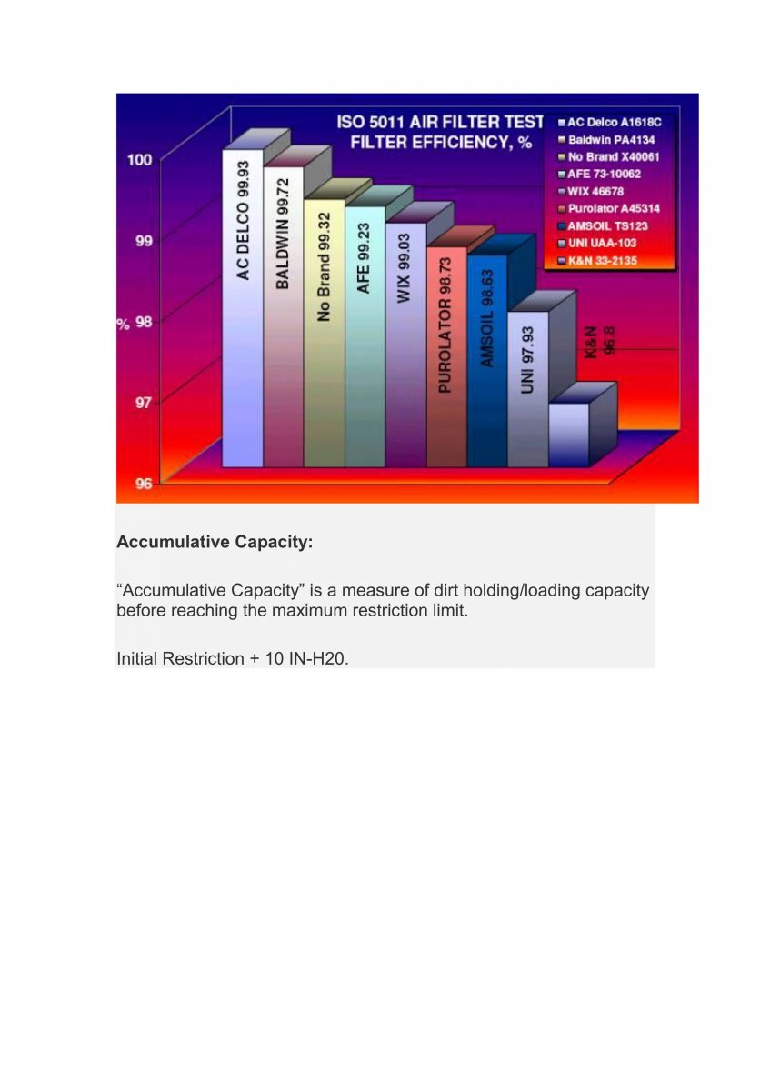

    Good story, but keep in mind that a lot of the graphs do not start at zero, so can give misleading impressions.
    For instance at first glance the first graph might seem to indicate that the K&N filter has only a fourth of the efficiency as the AC filter, whereas it really is about 96% as efficient as the AC.

    Not really, the K&N filter had an efficiency rating of 96.8%, the AC Delco had a rating of 99.93%. To put that in perspective, out of 10000 particles the AC filer removed 9993 of the particles, 7 particles p***ed throu; the K&N removed 9680, & 320 particles p***ed through. That's quite a difference between them.

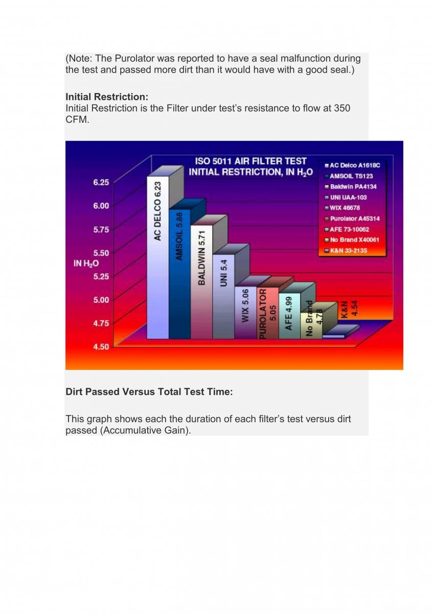

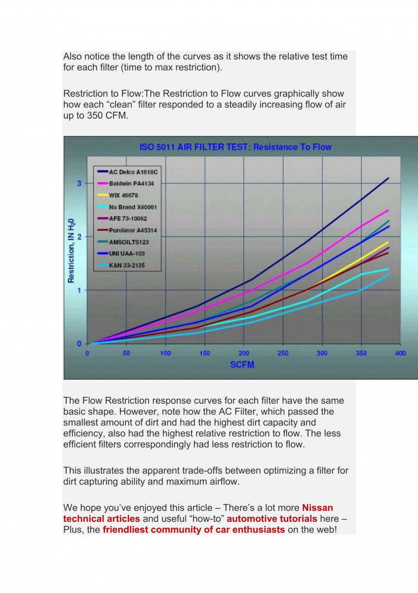

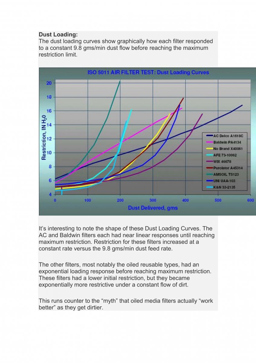

    Doesn't it say the AC Delco is the most restrictive to air flow, traps the most dirt, therefore being even more restrictive to air flow ??? My engines like to breathe man, they need air.

    Most restrictive to start with, but as they start to collect particulate matter the AC continues to flow while the oiled foam types close up and become more restrictive. Look at the chart on page 9.

    For the members that can't work out a PDF :)
    Filter Performance 2_01.jpg Filter Performance 2_02.jpg Filter Performance 2_03.jpg Filter Performance 2_04.jpg Filter Performance 2_05.jpg Filter Performance 2_06.jpg Filter Performance 2_07.jpg Filter Performance 2_08.jpg Filter Performance 2_09.jpg Filter Performance 2_10.jpg

    So what have you heard from oiled foam air filter companies have changed things to make them work better? The problem is with the technology itself, oiled foam. It is less effective as a media for filtering than paper media.
    I've been around cars for quite some time, not as long as a lot oguys around here, but since the 70's anyway, Fram has ALWAYS had a bad reputation since then. I don't know when they were considered the top, but not in my days.
    Actually, oil companies DO NOT change their formulations every year or two, that is false. The cost to have your formulated oil licensed by the API is extraordinary, >$1M each. Companies reformulate to meet new specifications that come around every few years, when the auto companies desire improvements in the oil to address new engine technologies. This is mostly driven by federal pollution legislation. And the results are increasing performance requirements, not reduced. The only issue with reduced performance comes from a forced reduction in ZDDP because of concerns with catalytic converter poisoning. In all other areas each new specification pushes the boundaries of oil performance, so oils are far more advanced then they were. Nobody reformulates their product to reduce the performance, you can't do that, because of the API licensing requirements. Your "well known and proven fact" is ********.
    I never implied any filter would, I just said oiled foam air cleaners do not perform as well as standard paper or cellulose media filters. They don't filter dirt as well, and they don't flow air as well once they start, you know, actually FILTERING the air, once they start ac***ulating particulate matter the flow performance drops off fast. So they are really only giving that benefit when clean, and overall they allow much more dirt into the engine.
