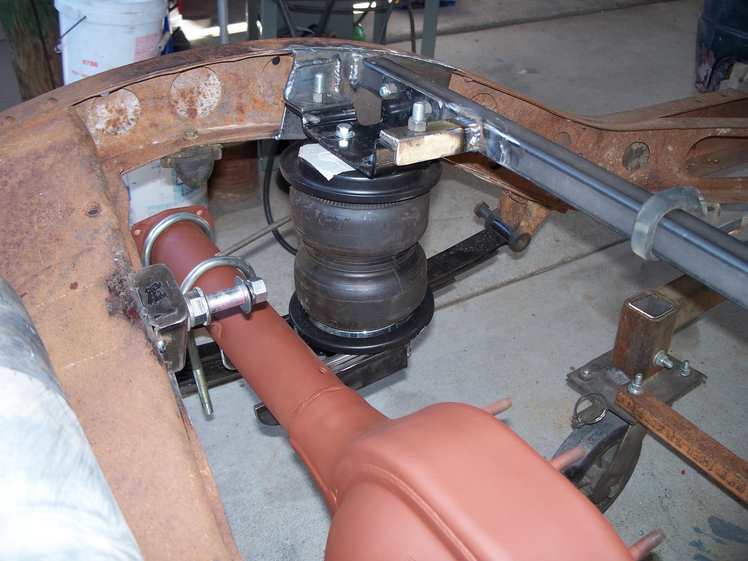

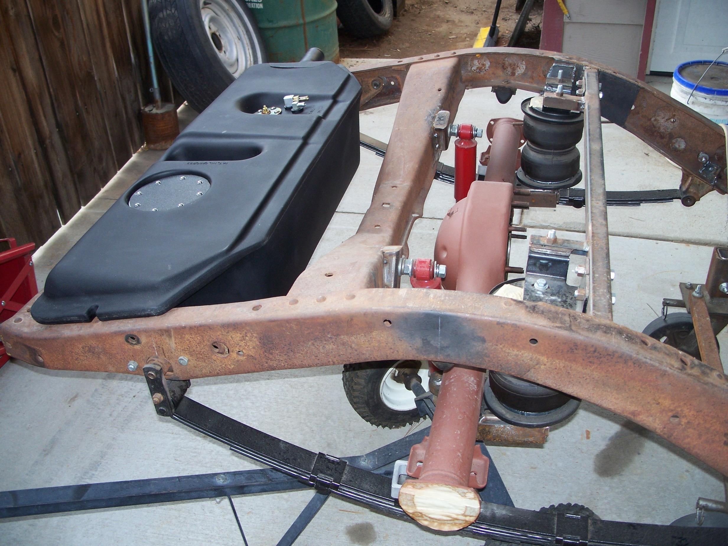

    You can easily mount the bag brackets to the inside or outside (space permitting) of the notch then run your bag to the axle in that location.. Or you can build a bridge off of the notch and get axle brackets for the bags and go that route.. Here are pics of a 67 I am building.. Not Leaf but the same concept will work..
