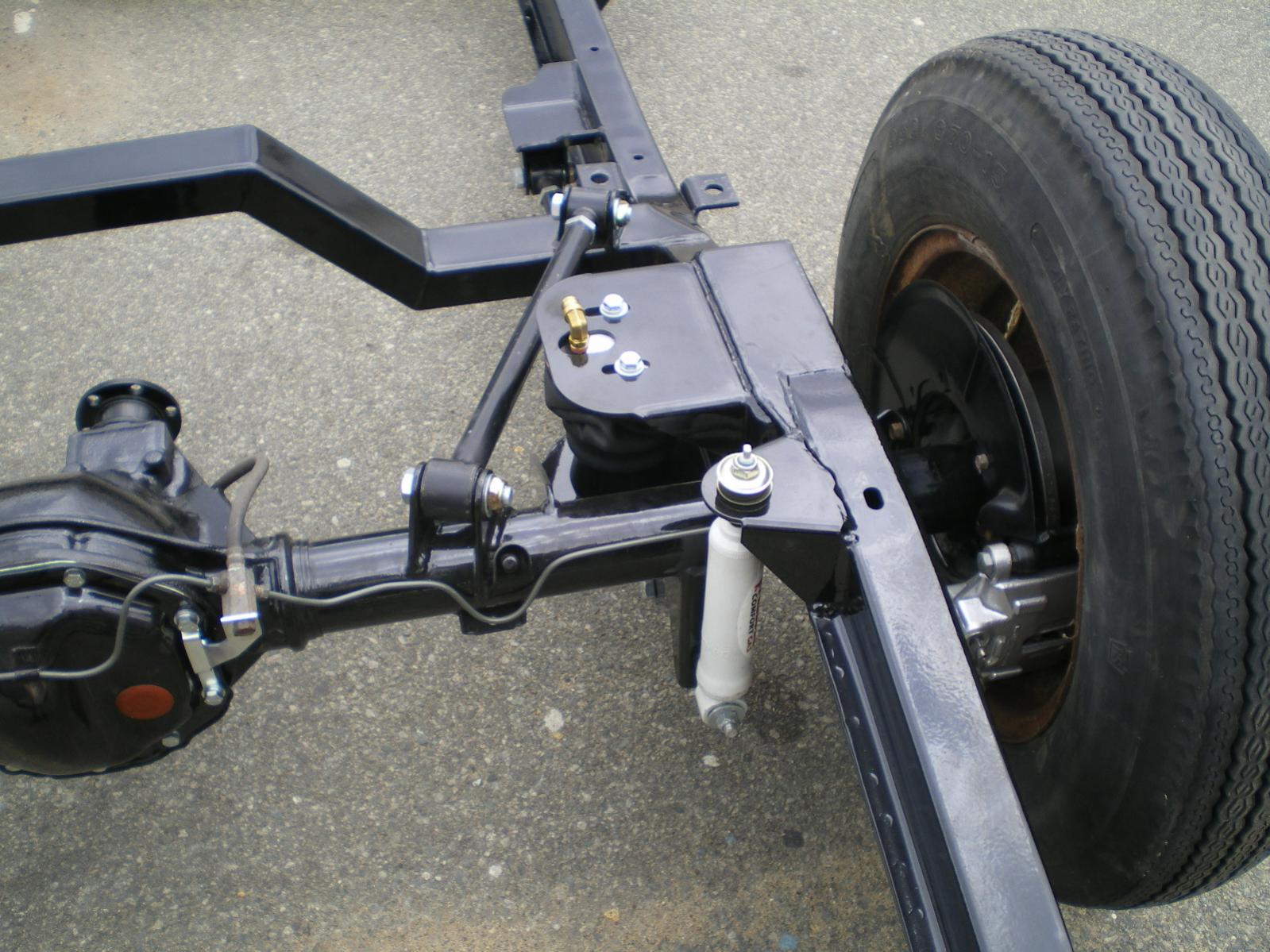

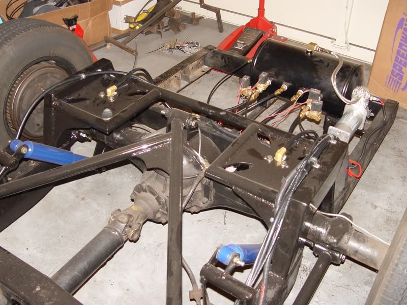

    Heres my notch and bag install on my 53 dodge pickup
    heres a picture of the tank and compressor mounted (before i mounted the 2nd compressor and cleaned up the wiring)
    heres it all finished

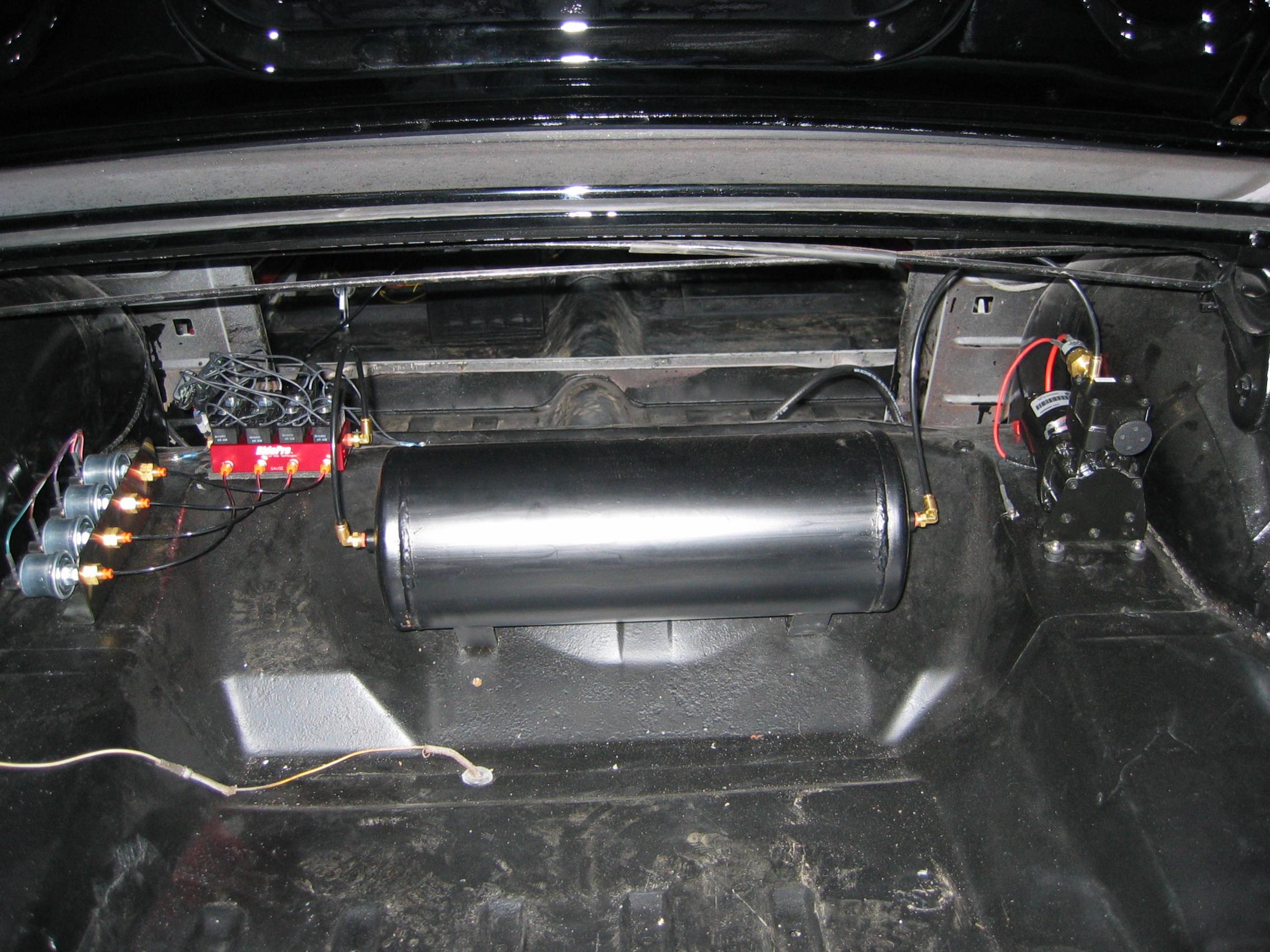

    My tank and solenoid placement: 1" x 1" square tube welded on the top of the tank with nut-serts to mount the solenoids, the compressor sits on a rubber mounted plate spaced off the uneven floor.
    Control panel: used ash tray door with a wide double hinge on one side and a magnet to keep it closed.

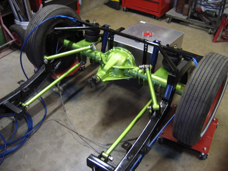

    I used Firestone tapered sleeve bags at the rear of my 51 Chevy, and 6in Slam Specialties up front on the Jag suspension. Put a couple of 2x3 box-section cross members to support the triangulated 4-link control arms. It's not super low, but low enough for me. Haven't hooked up the compressors or tank yet.

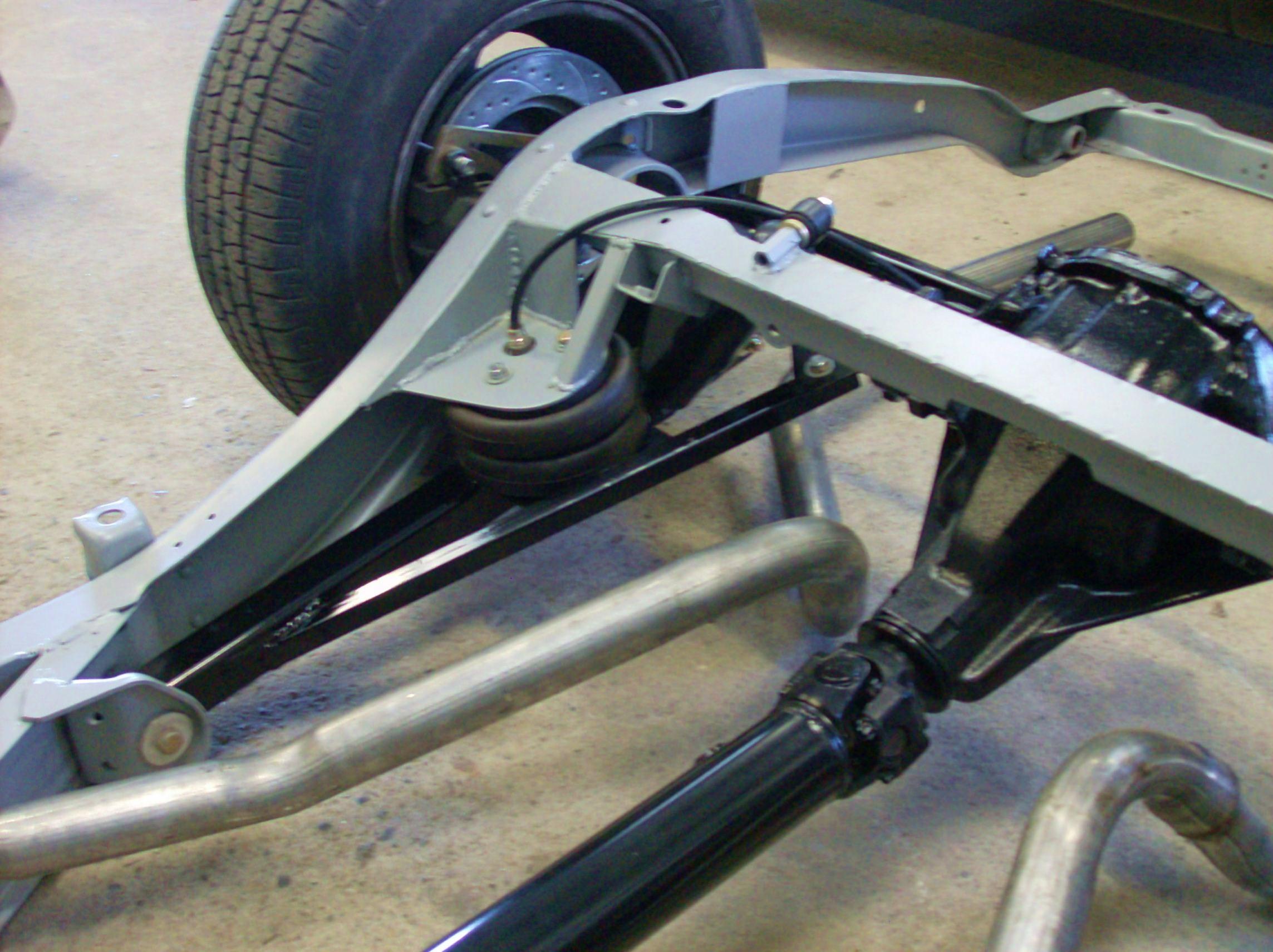

    i asked on another air thread before and never got an answer, so ill try again.
    how does this rear set up work?
    i dont see how it would ever flex enough, though the solid mounts at the rear end and a urthane bushing on the front.i t seems like a bad binding issue is in the making here.

    It is a vertical ladder bar with a urathane bushing that pivot in the front only and is mounted ridged to the axle. Simulare to a drag race car
    I have been using this degine for about 15 years now with excellent results especialy when the car has some real hp. This desgine clears most stock floor pan better than any 4 bar setup. We also set our pinon angle at -2 deg at max ride heigth so when its lowered all the way the neg pinon angle increases to about -6 deg which results in alot more drive shaft clearnce than a 4 bar set up can. Resulting in No need to rework the drive shaft tunnel for clearnce.
    This 50's olds frame required 0 floor or trunk pan mods to lay frame
