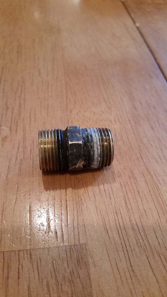

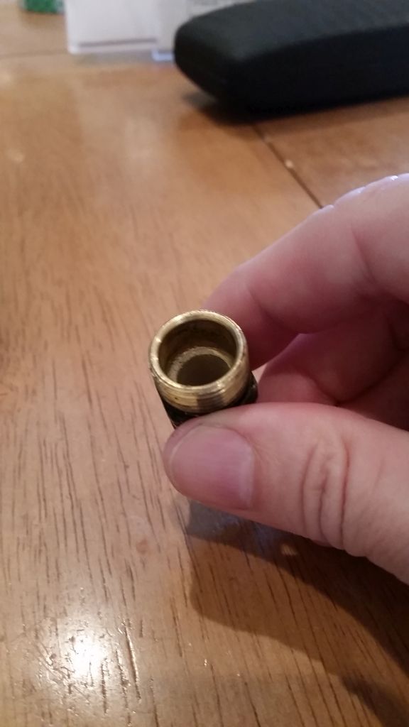

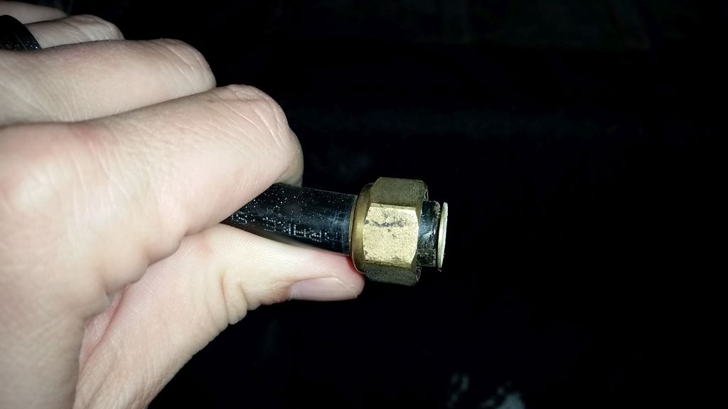

    The corrosion was pretty heavy between the br*** fittings and the aluminum manifold, so I thought I'd replace all the fittings with stainless while I was in there. I thought the whole system was NPT, but unfortunately the air line sleeves are not. The air line has a flare insert and a sleeve that tightens over it, like a brake line. I ***ume this is probably a standard air line setup but I don't know for sure.
    The old 3/8" br*** hex coupler (which got badly chewed up due to being locked into place so tightly by corrosion) has some kind of straight thread on the air line side (the manifold side is NPT), and it looks like there is a shoulder inside which mates against the face of the flared insert. I thought maybe that side was NPT's straight-threaded cousin NPS, but the sleeve threads don't capture NPT threads and as far as I know, NPS and NPT are supposed to be thread-compatible (the difference is in seating). Also, that shoulder inside makes me think it's something else entirely.
    So the three $64,000 questions are:
    Is this a standard coupler?
    Is there a name for it?
    Anybody know where to find them in stainless?
    Thanks again everyone.

    Looks like the compression fittings they sell at Home Depot. Used those a few times on air set ups.
    I'd look into push to connect fittings. Those are the easiest to work with and if a line blows or leaks, super easy to repair.

    See if you can locate a parker fitting store nearby, i have done quite a few air ride installs and always used the parker push to connect fittings, great quality fitting

    Those look like standard DOT air line fittings available at any truck parts supplier including many auto parts stores.
    https://www.imperialsupplies.com/pdf/Section_G.pdf
    Many people think that br*** fittings don't require sealant on the threads but most DOT fittings come with a silicone sealer on the threads. If fittings without sealer are used, they tend to leak and are often over tightened to try to stop the leak. The sealer also prevents the fittings from galling and locking into the threads. The inserts that go inside the plastic tubing to prevent it collapsing under the ferrule come in 2 different types. One is pressed into the fitting to make ***embly faster but they need to be wiggled to come out. The other has a flat end and makes dis***embly much easier.
