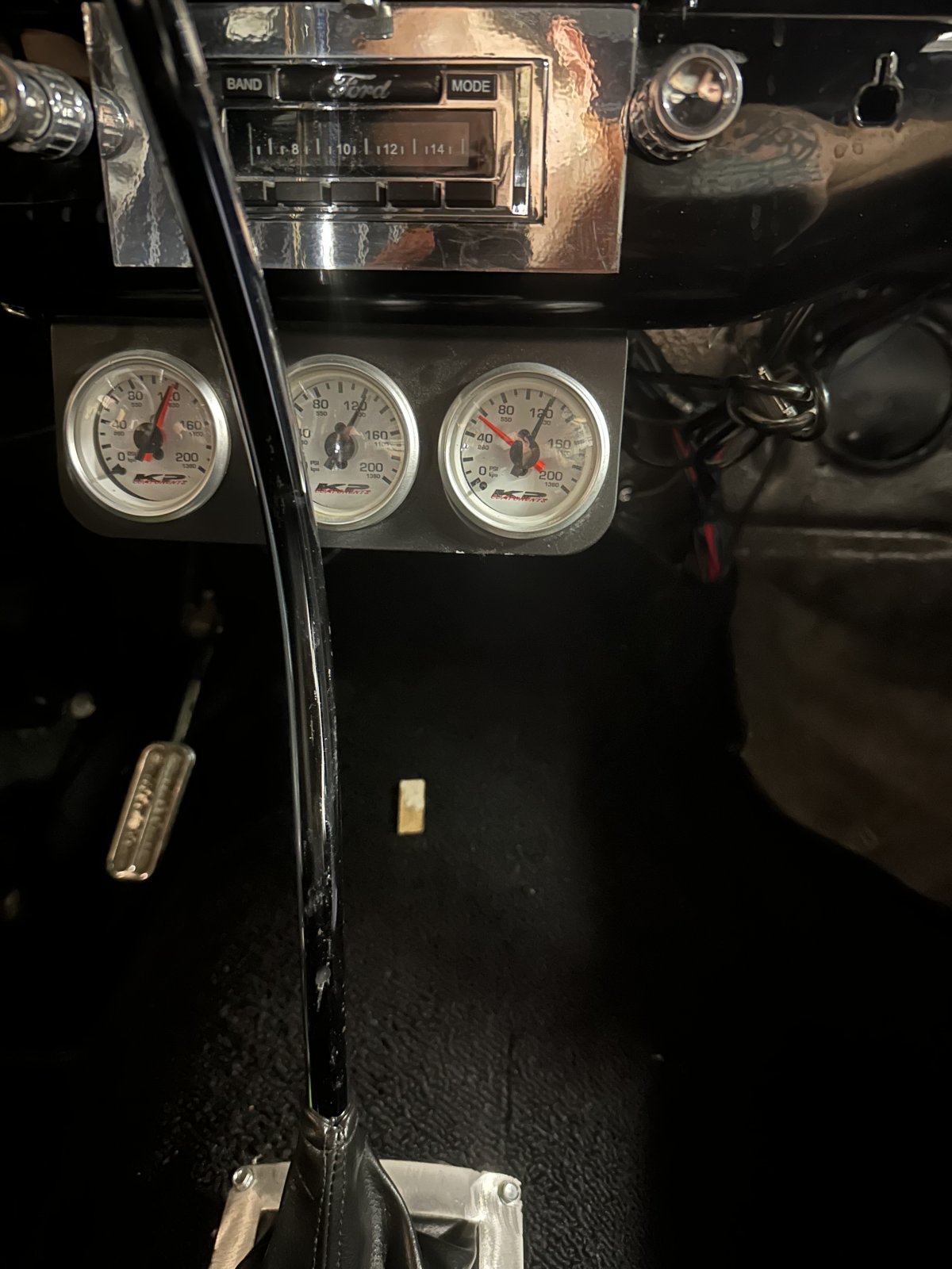

    Hi all, on my 1950 ford shoebox I bought it with several issues I’ve been fixing little by little.
    It has airbags on the front and rear, an Accuair VU4 manifold, and manual toggle switches along with a gauge for the tank, dual gauge for the front and dual gauge for the rear.
    I have a few issues I can’t resolve:
    1. When I fill the tank and then fill the front both sides inflate to about the same pressure about 140 psi or so at full. For the rear one side inflates about 20 psi more than the other. Oddly enough the side that I think has lower psi is higher by half an inch but I may need to carefully verify it’s that side that sits higher. Am I likely seeing this issue because I have one toggle switch for both sides of the rear? Since it has the vu-4 manifold I would have thought both sides would equalize during filling…
    2. At fully filled the front goes up quite a lot and the rear goes up a fair bit but sits a good amount lower than the front.. is that likely due to the limited travel from the type of airbags selected for the rear or maybe a very deep c-notch?
    3. I’ve found a bunch of leaks at the gauges and the manifold and coming off the tank which I fixed except for one. Somewhere the side in the rear with a lower psi reading has a leak.. about 10 psi drop in an hour. I sprayed with soapy water at connections going underneath and around the airbag but couldn’t find a leak. I can’t quite see the fitting going right into the airbag too well because of the floor/cnotch but maybe it’s there! I hear a faint tick tock noise like a clock and it sounds near the airbag but hard to confirm…. I used a hose and couldn’t hear exactly where it was coming from. There is a small leak for that side/rear off the manifold but it looks very tiny when I sprayed it. I’m going to fix it at the manifold and reevaluate how much psi I lose per hour but I suspect the leak is also elsewhere most likely at the airbag connection where I can’t see. Is that a common place for leaks?
    4. Is it good for me to keep the car at 0 psi… fully deflated when parked in my garage for long periods?

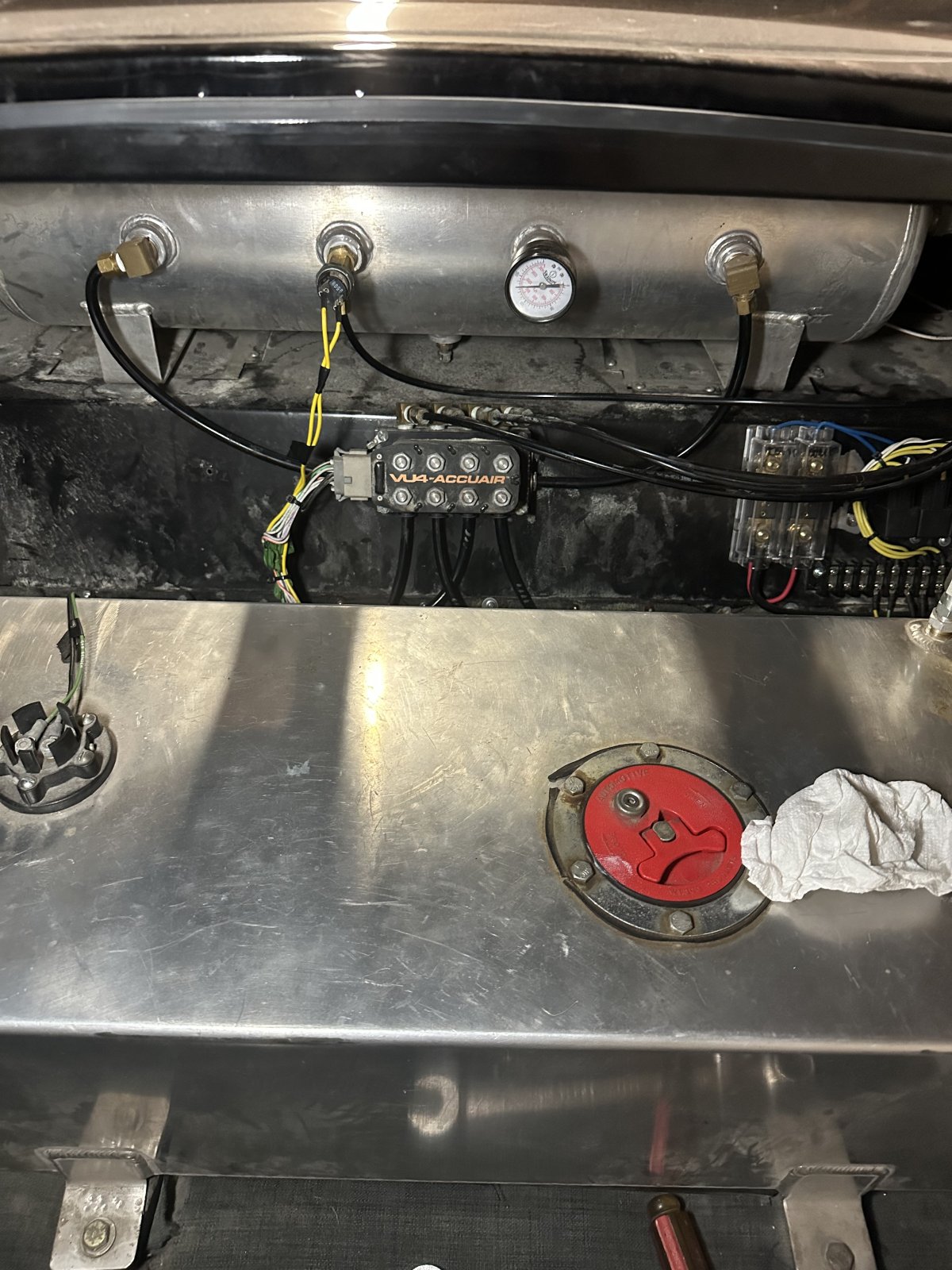

    I found the source of my leak in the rear. It looks like the connection at the airbag. I'm ***uming this would be a royal nightmare to fix without taking the airbag out and it looks like there is a notch where the airbag sits so I can take it out with the fitting on there. Does anyone else see the same thing? I wonder if I can disconnect at the quick disconnect joint (where plastic line feeds in) once the line is de-pressurized and take the br*** components and airbag out together and work on it outside the car. Is taking the airbag out a hard task? I have the car on jackstands on the rear. That was a pain in of itself along with taking out the small rectangular covers at the top of the c-notch to locate the leak!
    Here are some photos:
    Also, at the same time I have some small leaks in the Accuair VU4 manifold in the poppet connection (or whatever those things are called). I tried taking the plastic lines out cutting them a 1/4 inch or so and putting them back in but I still have some small leaks so I may need to buy a rebuild kit. If the airbag fitting/connection fix is a pain part of me says to just put this all back together and deal with it later. I tend to keep the bags deflated when parked and don't plan on being anywhere for long duration where I would need to be at ride height, nor would I be going far any time soon (or probably ever)... I'm getting antsy to drive this car find a woman to date and stop burning so much time in my garage by myself. I drove this thing once to the DMV in late March since I got it and that was it and I've been working on so many other odds and ends from things that were put together incorrectly. I didn't expect to encounter so many headaches... that's what I get for having too high expectations for what I paid and not seeing it in person before buying it....
    I still can't understand with just two switches (one for the two front, one for the two back) why the non-leaking side inflates 20 psi higher than the leaking side. The leak does seem small but I would think it would equalize when I keep holding the fill switch open even after there is no more air flowing from the manifold to both bags. I would have thought the pressures would read the same even just for a short while until the side that leaks drops in pressure. For the front there is one switch and they both read pretty close to each other when filled all the way.

    That valve block has four separate valves in it.
    They are not connected to each other on the bag side.
    If you have a single switch for the front or rear, that switch logic controls two valves.

    Go back to Boyle's law. All things equal, and ***uming you're comfortably between maximum compression and maximum extention, the only factor determining the pressure in a bag is the load on it. The leak at one of the rear bags is preventing it from holding the same pressure as the other rear bag, but that isn't all that is happening. The other bag is also carrying more of the weight of the rear of the car as a result of this. Of course it is going to show a higher pressure.
  6. Ned Ludd
    Joined: May 15, 2009
    Posts: 5,517
    Ned Ludd
    In other words, pressure can equalize only while both the valves controlled by the switch are open.

    Yea I noticed that manifold has four different valves and a single switch is controlling two valves. I thought if I hold the rear switch open and the two valves in the manifold are open the air could flow through the tank and equalize pressure on both sides... ***uming I'm holding the switch open for a long time for it to do that after both sides are filled. I tried this with the car on jackstands so the airbags are not supporting the car weight and it still didn't equalize. It could be the small leak is not allowing it to do that as Ned pointed out.

  13. An airbag setup is almost always a custom, one-of-a-kind installation. There's no way anyone can predict how much effort it can take to remove or replace a particular component because that will vary from case to case depending on what the original builder did.
    Your airbag system is older and has a lot of time and miles on the clock. And as you're finding out, it has a good amount of deferred maintenance issues. The questions that you are asking are going to be best answered by yourself or whoever else is going to tackle each issue one at a time. If a particular airline has a leak, it's probably time to replace and/or upgrade it end to end, from fitting to fitting. The hard part of the system is done. changing out all the airlines with new, fresh lines and fittings is small potatoes. I'm not saying every fitting will be easy to get at. You just have to do whatever it takes to get at 'em.
    The gauges are also "older" and may or may not be reading consistent with each other. But that may be a moot point anyway because adjusting each corner of the vehicle to the same air pressure is the wrong way. Adjusting the height (stance) of each corner of the vehicle will tell you how much and how different the pressure each needs.
    You may want to re-engineer that back axle so you can adjust each side separately so it's not sharing a single switch.
