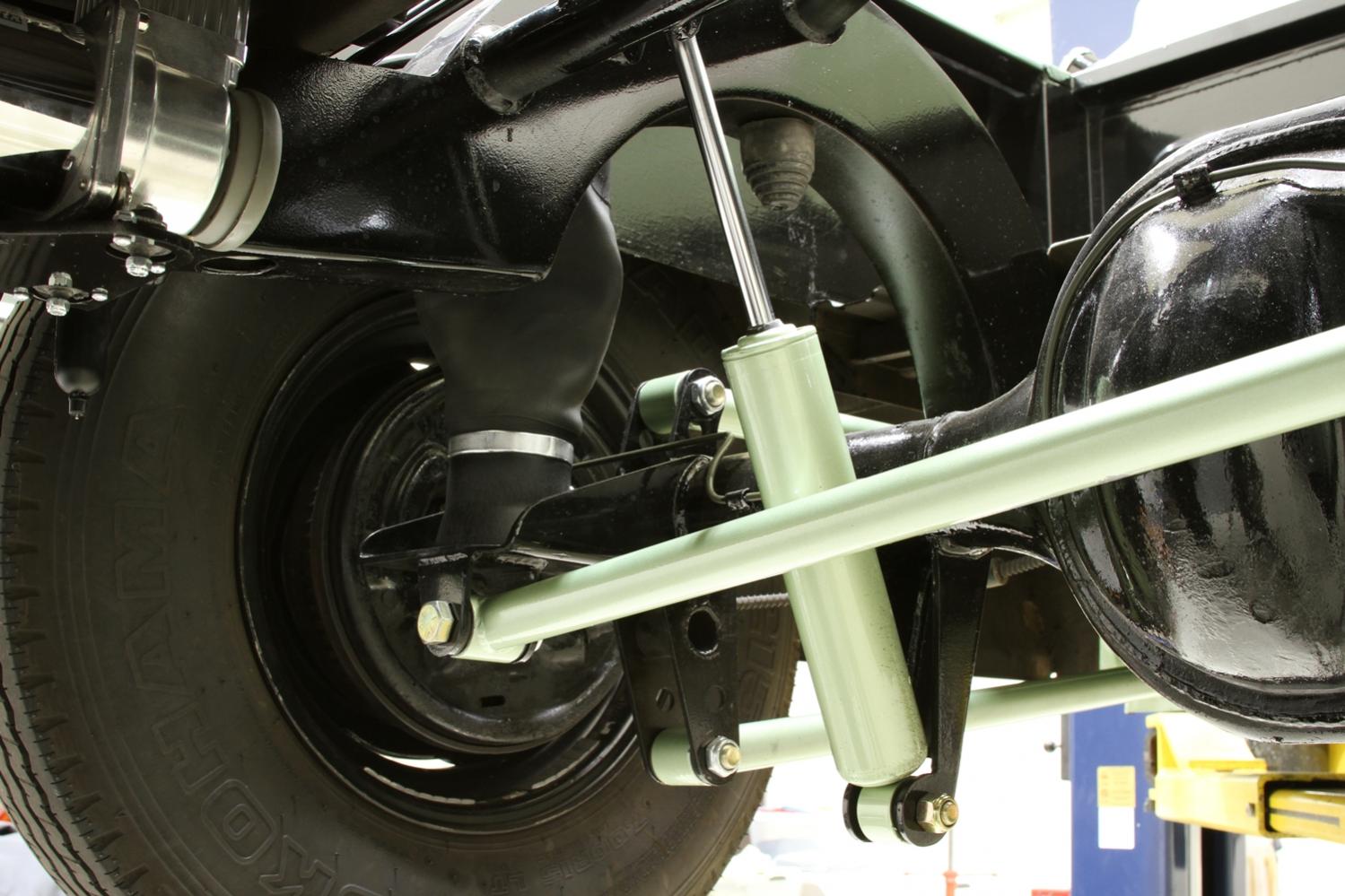

    Sorry it's taken so long to get more pictures up. The truck made it to GNRS without a hitch. I've been back at home and driving it a bunch. It rides incredibly! I got it up on the lift to check everything out, and everything looks good. The airbags aren't rubbing, and all the height sensors are exactly as I left them. On the way home on Sunday it ended up raining pretty hard. With the way I mounted the ECU and the valves I gave them a good weather test!:D Even though it's all electronic, I didn't have one issue! I cleaned everything up while it was on the lift and took some pictures of how I mounted everything. I got a pair of AccuAir's new compressor mounts too. They have an isolator at each corner and take away almost all the noise and vibration that the compressors usually cause!
    Now I'm gonna work on building a cover for the notch in the bed. I wanna make it match the shape of the inner fenders. Wish me luck!

  22. Looks sweet man. Where did you get those clamps that you use for the height sensors? seems like the perfect way to mount them.

    You can get them here. http://www.mcmaster.com/#shaft-collars/=b596sy I had to machine a flat spot and drill and tap them.
