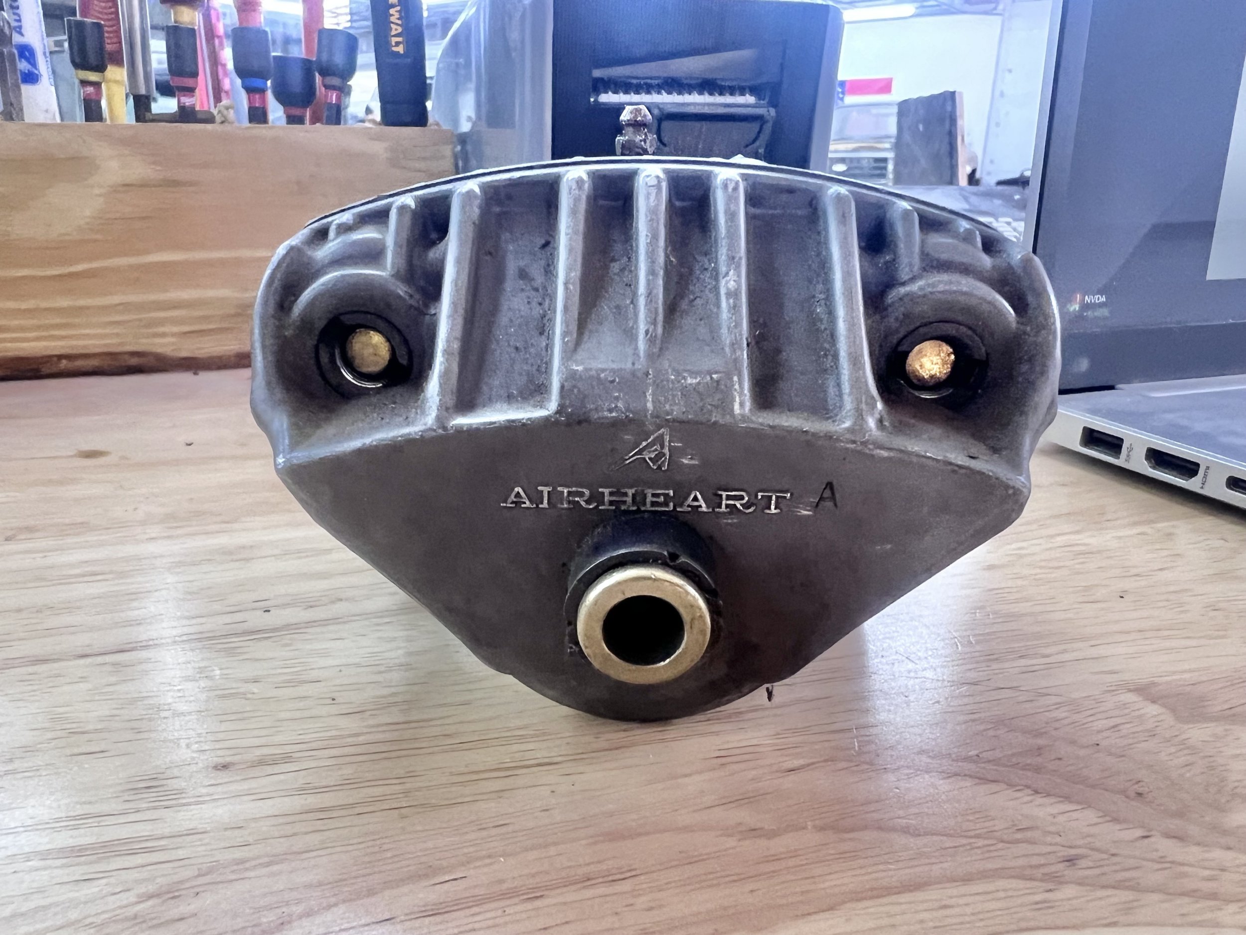

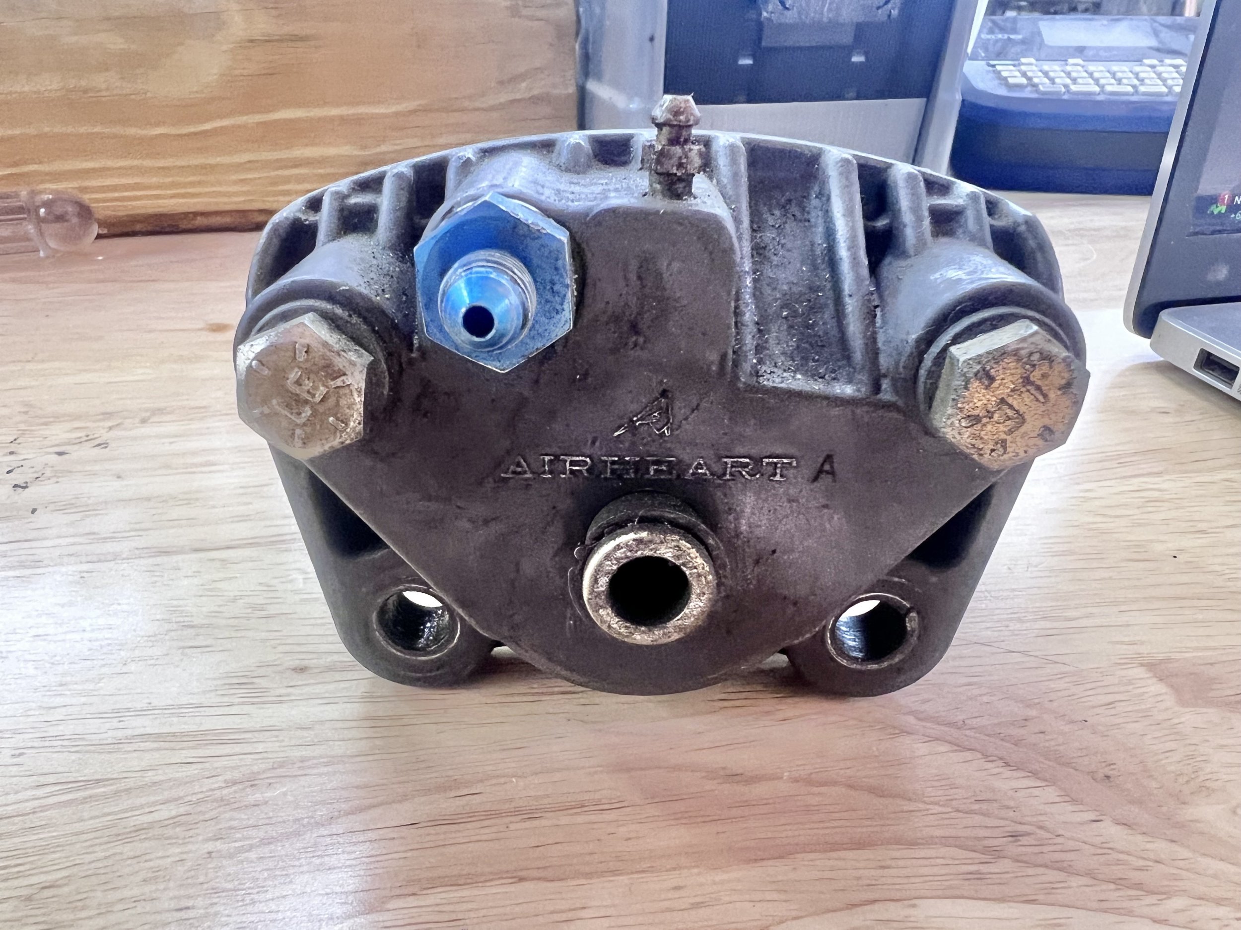

    Can anyone identify this caliper and if a repair kit or parts are available? "AIRHEART A" They are on a Pro-Stock Drag Car from the mid 70's

    Original Airheart parts are made of unobtanium but you can source the o-rings from any good supply house. Naturally you will want to be sure they are compatible with your brake fluid. Speedway Motors has brake pucks for those.

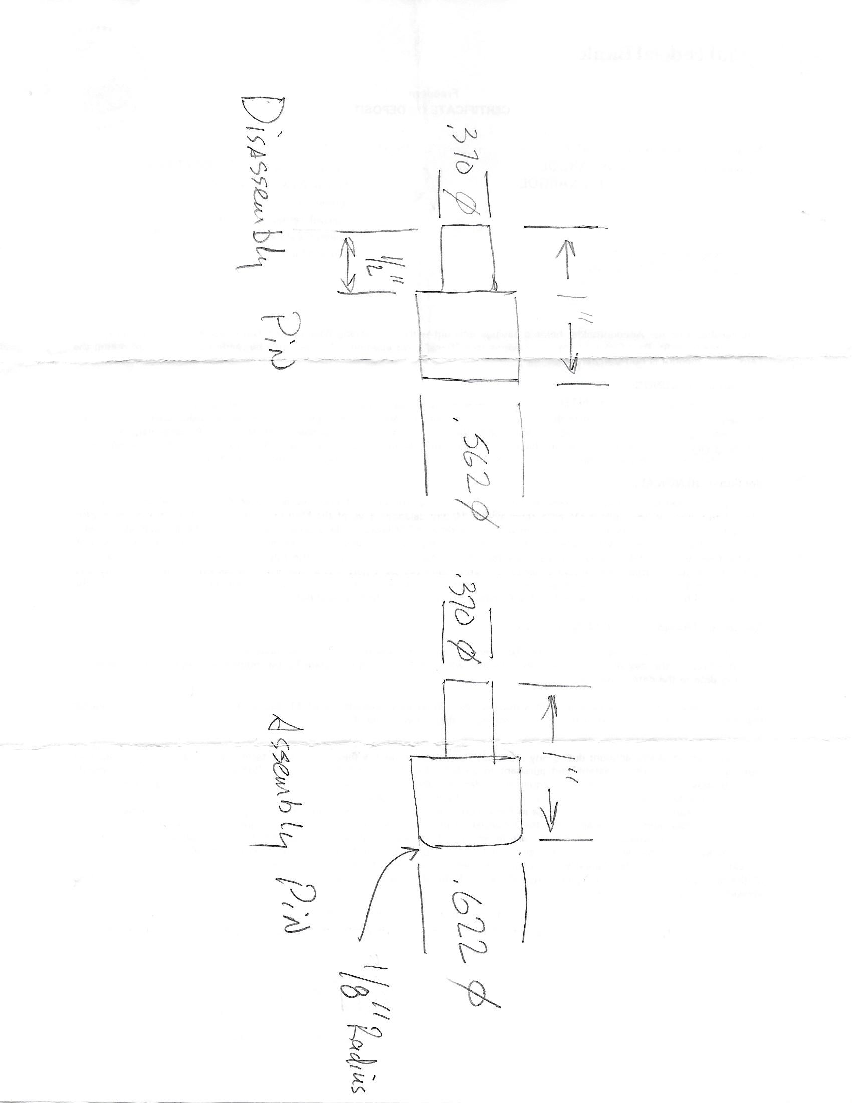

    I’m on my way out but I’ll scan and post a sketch later of two helpful tools for rebuilding those.

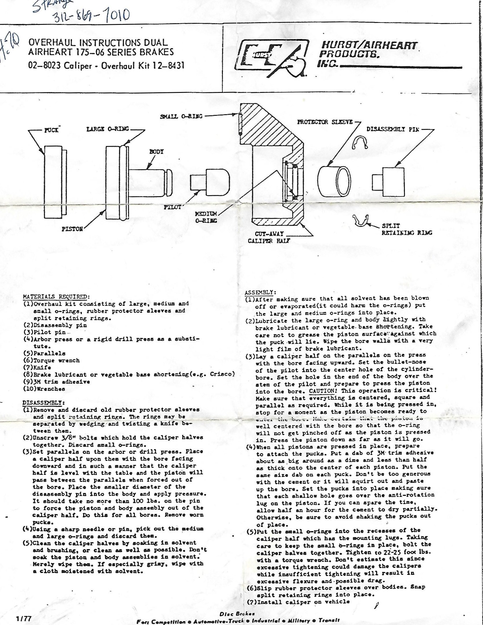

    Here are the Airheart instructions and also dimensions for the dis***embly/***embly tools-
    The protector sleeves referenced shown on the diagram could be the hardest of all to find, I've made new ones from correctly sized rubber, and even silicone tubing. I guess their function is to keep dust and dirt from entering the caliper halves and fouling the o-rings.
