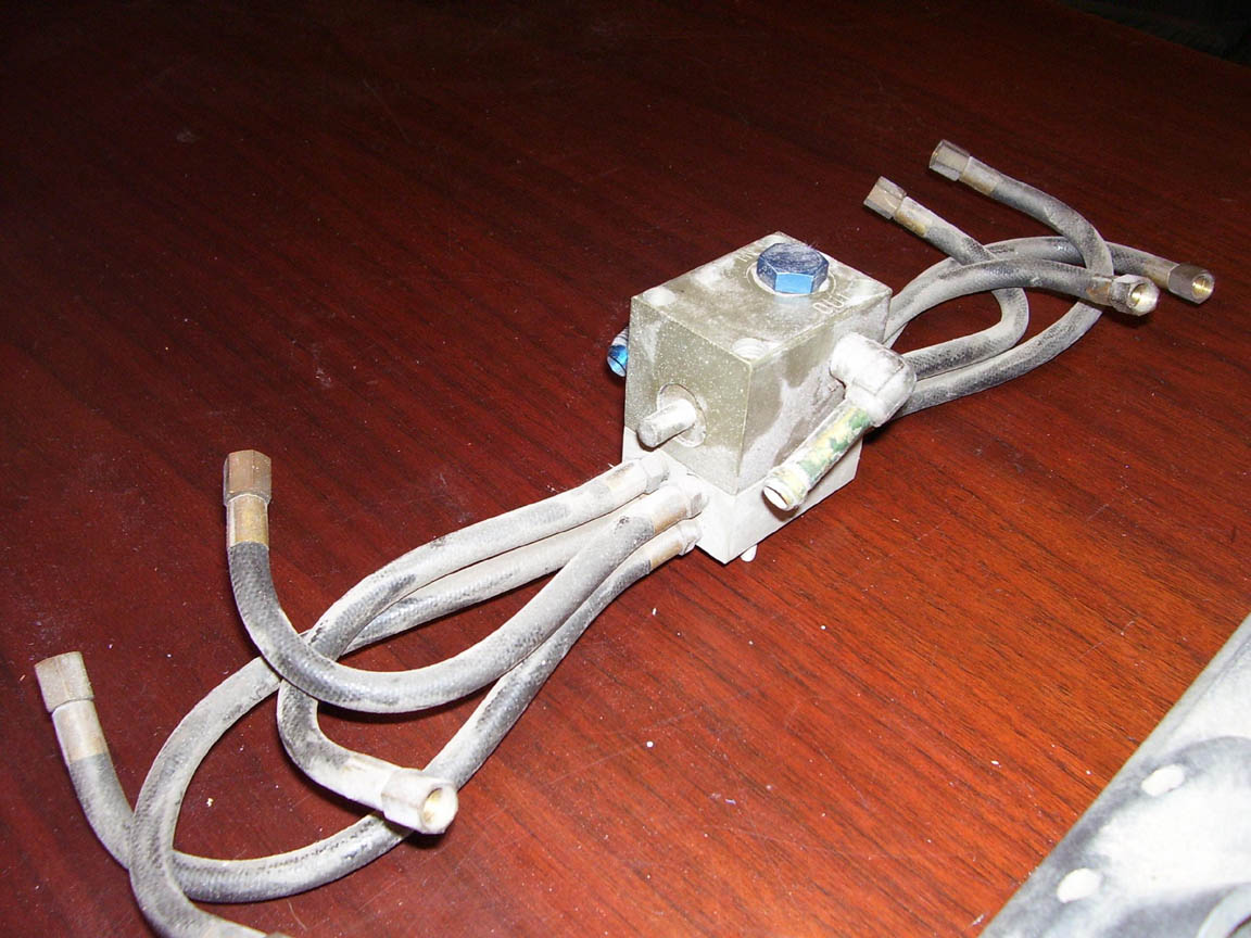

    I bought some old parts and in the mix was a home made MFI system. This system was made for an in-line 4 motorcycle that was using methanol. Nothing is marked except the pump which has ALGON on it. It looks nothing like any of the pictures I have seen on this site.
    Does anyone have a manual that could help ID the pump? Are parts available anywhere for them (seals)?

    Some are not simple O-rings. I'll see if I can post some pictures of the pump and the seals.

    I believe your correct on the seals. If you look at the seal in question, there is a step in it. I think the seals that were in it were not compatible with methanol and they swelled into shape and took a set.
    Front cover:
    Some of the parts for the pump:
    One of the seals in question:
