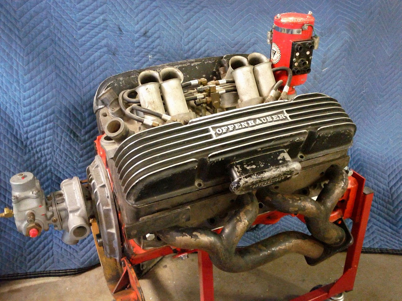

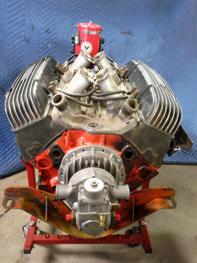

    My Algon injection manifold, timing cover, water pump & fuel pump bolted up to a Small Block Chevy. -Andy

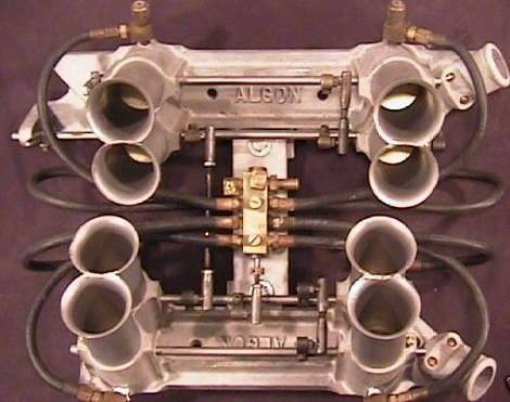

    Recently acquired.

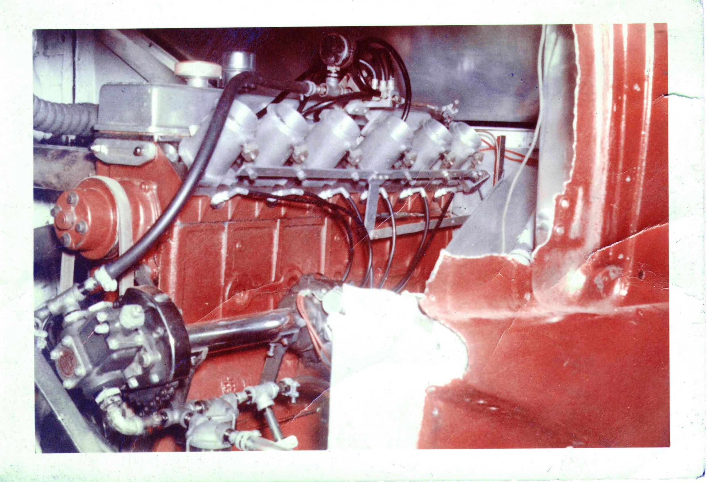

    Hopefully these photo's may either answer or cause more questions. I used an Algon system on a inline GMC 302 with a twelve port head years ago. It was a good system and the factory folks were always very supportive of the user of their product. SoCal Speed Shop may still have some old Algon information.

    Rich Fox,
    I had an Algon Injected 12 port GMC 302 in a '37 Chevy that was gutted out to lighten it. The setup was simple, easy to understand and very dependable. My engine used a Howard flat tappet cam with mushroom lifters and later I switched to a Chet Herbert Roller setup which wasn't cheap but it sure made a difference in the elapsed times. Al Gonsales was a prince of a man and sure had some good ideas. He poured his heart into this facet of fuel management an delivery. He sure is missed today.

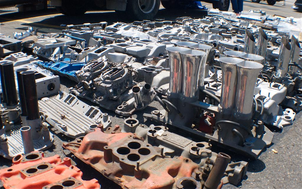

    Picked one up at Turkey Run years ago for early Pontiac. Modified it to fit late Pontiac 455, and have been converting to electronic using a spider injection system from a Vortec Chevrolet. Not high on my priority list, so it's been a long time project. Might finish it and use it some day in my Model "A" Tudor.

    Joined: Mar 21, 2007
    Posts: 130
    34andy
    from WA
    That's a nice setup! What engine does it fit?
    -Andy
    kidcampbell71 likes this.
  25. Boldsmobile
    Joined: Dec 30, 2009
    Posts: 53
    Boldsmobile
    from W.Mass
    "modern" Oldsmobile Big Blocks. 400,425,455
    Plan on using it on a 1965 425 A block.

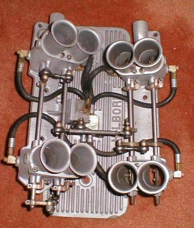

    Can an Algon base be rebuilt with Hilborn hardware ?
