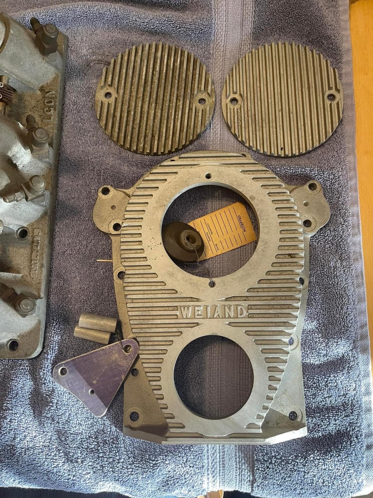

  1. Any ideas on what to adapt for a pump? I am sure it will not be easy to find an Algon and another fuel injection company went bust.
    I need to through this but want to get some ideas. I appreciate the insight.
