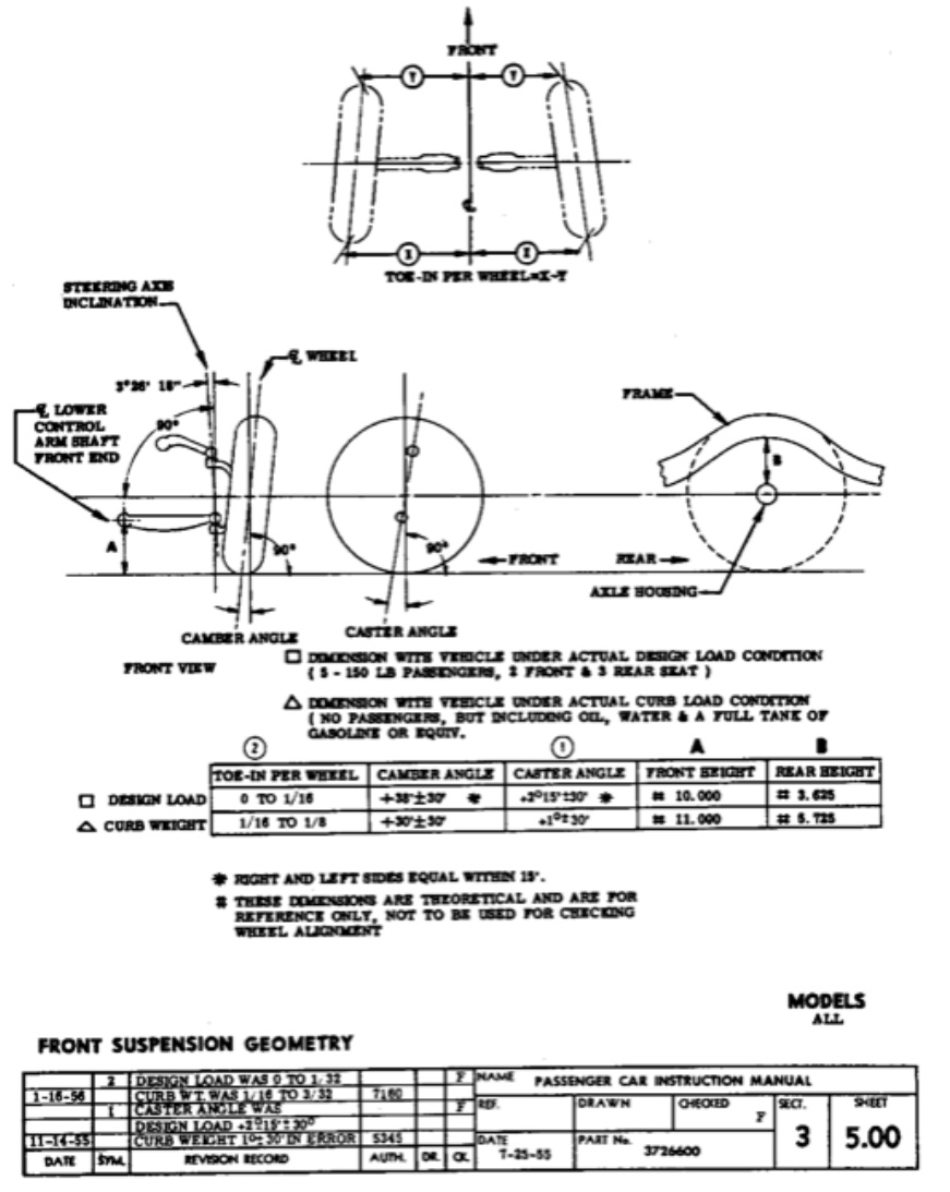

  1. I had the front end aligned on my 55 Nomad. Someone asked my what the toe in was set to. I answered 1/8 inch. The person who asked the question said to me…”was that 1/8 inch per side?”.
    Is that how it is referred to, as per side…?
    Or is the 1/8 inch number really 1/16 per side for a total of 1/8 inch overall…?

    1/8" total.
    twenty8 and guthriesmith like this.
  3. So, it would be a 1/16 per side…?

    I did front end work for several years and you never think of it per side. You usually do adust the side that is off the most when you center the steering wheel and check the toe in the first time.
    On the other hand your friend wasn't totally wrong, read out from the new high zoot front end alignment machines do show left and right toe in/out on the reading, It is just that older mechanics don't think of it as being separate sides toe in wise, Remember that straight axle cars and even most 4x4 solid axle trucks only have one tie rod with two ends and you only have one adjustment.
    Caster and camber are per side get the car to drive good on the roads it gets driven on without wearing the tires, Usually 1/4 degree more positive camber in the driver's side wheel to compensate for road crown. On and independent front end caster is usually set to factory specs or what the front end mechanic decides works best for that model from past experience. Sometimes you may not put more than factory spec in a toddle around town never does road trips car but will put different settings in a car like your Nomad that is probably going to see a decent amount of highway driving.
