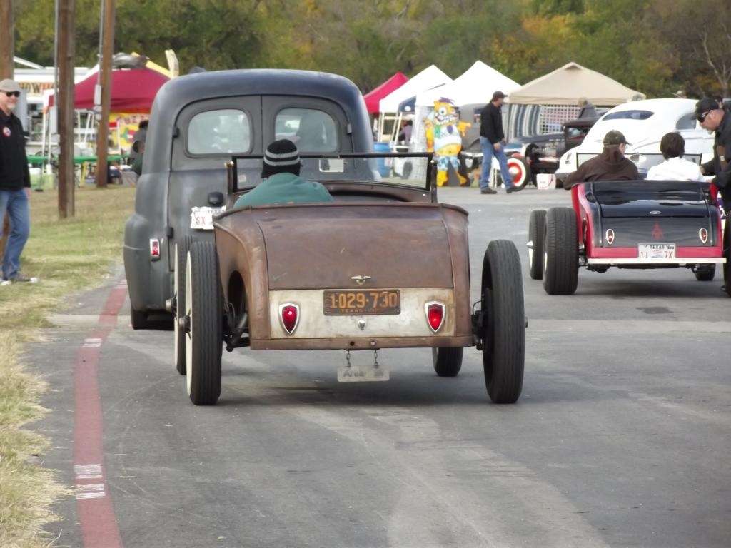

    Heres mine..

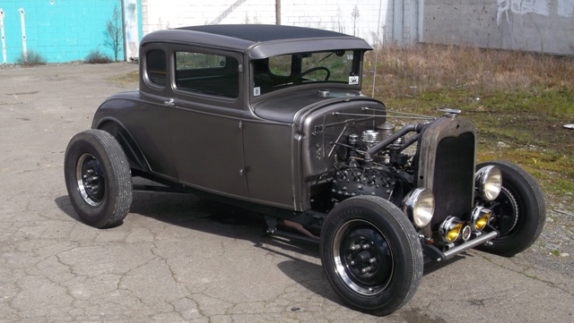

    Okay - I'll play.....
    Here's my AV8.
    '30 coupe still using the original cowl tank; 59a flattie with twin 97's on an old Fenton; '39 trans; '40 rear; '40 wheels & firestones; '40 brakes; A steering box. No plastic, no billet, no T5, no electric fuel pump, no alternator, no electric fan (no fan at all actually) - and no mufflers! :cool:

    I used the stock A steering box (upgraded with shorty pitman arm & needle roller kit) and A column etc.
    I lowered and moved the box back 1.5" and down a tad. This cleared the rear LH header pipe. Put in a column drop extension and shortened the column nearly 4" and fit a '40 steering wheel. With the stightly lower seat height (for roof chop head clearance) the driving position is real comfy. FYI I moved the front crossmember forward 1.5" for more room from Rad to firewall. ;)

    ...that is traditional enough for me!! great coupe...

    Nice coupe, Im trying very hard to find something non traditional about it..and trying and trying..... A HA! found it, your exhaust pipe is made from Japaneese metal, so its not traditional :)

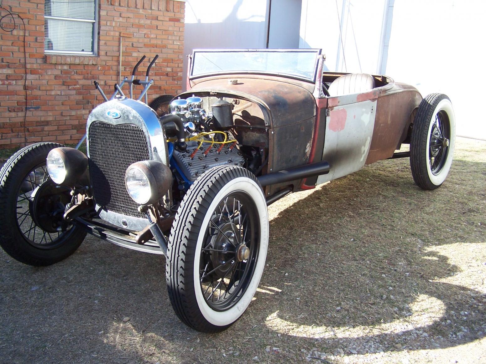

    I have one question, new to this AV8, will a V8 60 HP. bolt in a stock model A?. with just a rad. change. Looking for the easyest route. thanks for any info. Jack.
  27. nitrobrother
    Joined: Dec 24, 2004
    Posts: 4,379
    nitrobrother
    Yup, that'll do. Really dig the color.

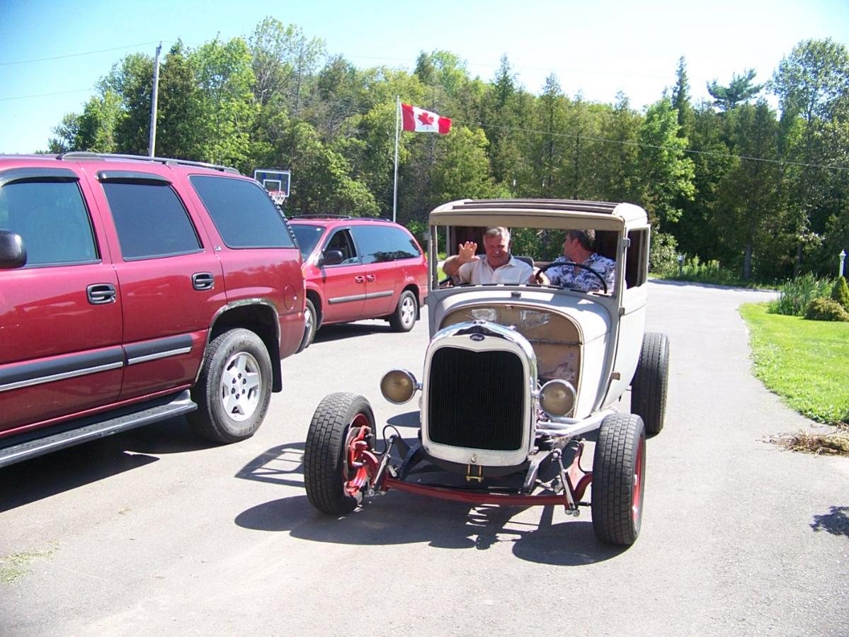

    My dad and myself taking first test run. He remembers riding in this very A in 1955. Pretty cool.

    Oh no! Busted! :( The headers from Sacramento Vintage Ford were probably made in China too! OMG they'll have to go :eek:....
