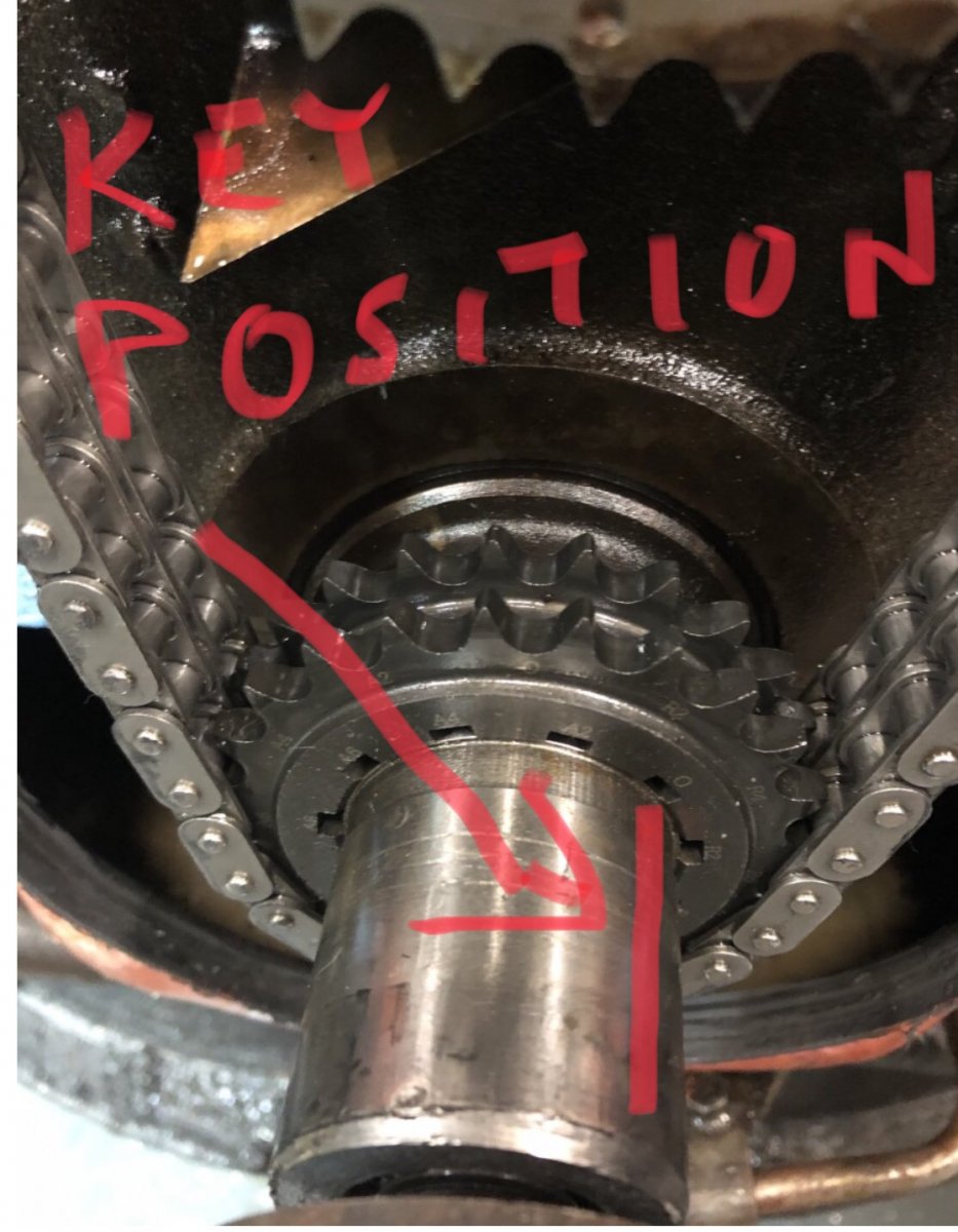

    Today we tore down the front of this 318, and we have a verdict; timing chain installed improperly. To his credit, it was an honest mistake, he used the wrong set of marks, those being the ones on the edge of the gear rather than the one on the keyway. Here you can see the dot on the cam gear at the top of the picture, and you can see the "0" on the crank gear are lined up at the 6:00 and 12:00 position. But you can also see that the "0" on the key slot is like 3 teeth off to the side. Nevertheless, the cam is installed WAY off, and that's the culprit. Tchain.jpg

    B3E8A64D-380A-4EB4-AFF9-EC9272232023.jpeg That picture shows the gears timed correctly.
    The key in the crank should always be pointed to #1 deck at tdc.
    The gears are exactly correct, but the crank key should be in the zero slot. I don’t even see a key way.
  14. Exactly ^^^^
    There’s a set of markings on the teeth and a set of markings on the key way. With #1 at TDC Select the Advanced/retard or Zero on crank gear key way markings Then line up the corresponding timing marks at the teeth. R4, R2, O A2 A4 etc
    That BIG red line should be where the crank key way is and corresponding with the clear “0” zero mark on the crank gear.

  16. I’d like to see where the crank key is with those gear markings lined up.

  18. Probably got the crank turned to 6 and 12,,,,,can’t see the key way.

    Well let’s say he’s got that key in R4 maybe.
    He’s just 4 teeth off on that crank then- or 60* crank degrees off.

    I didn't get a shot of it before it got pulled off but it was on R4, out of sight of the picture. At that point we can just say it was wayyyy TF off and start over. I'm going to do a leak down test tonight to see if these exhaust valves are bent, which I'm fairly certain they are, but one can always hope.
