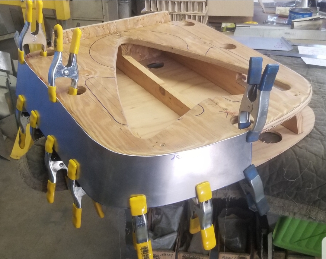

  3. I attached both sides (not shown) with clamps, getting things ready, so I can weld up the top.

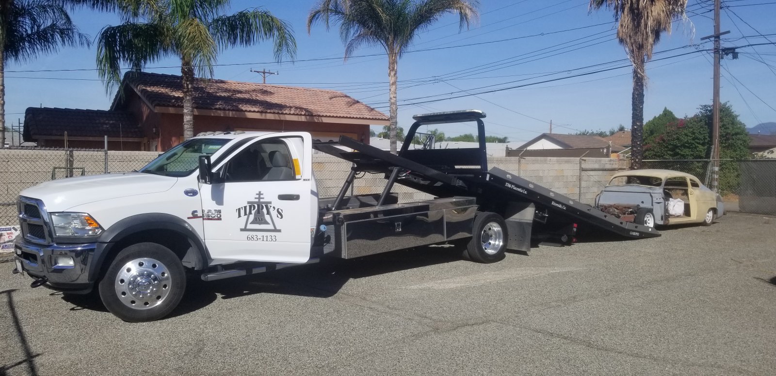

  4. Moved the car from my place, over to Norm's shop. The goal is to have this thing ready for paint, by the end of the year. Being inside definitely, makes that doable.
    I never knew tow truck beds, folded like that.

  5. Now to make a couple fixtures, to hold the bottom to the upper side pieces

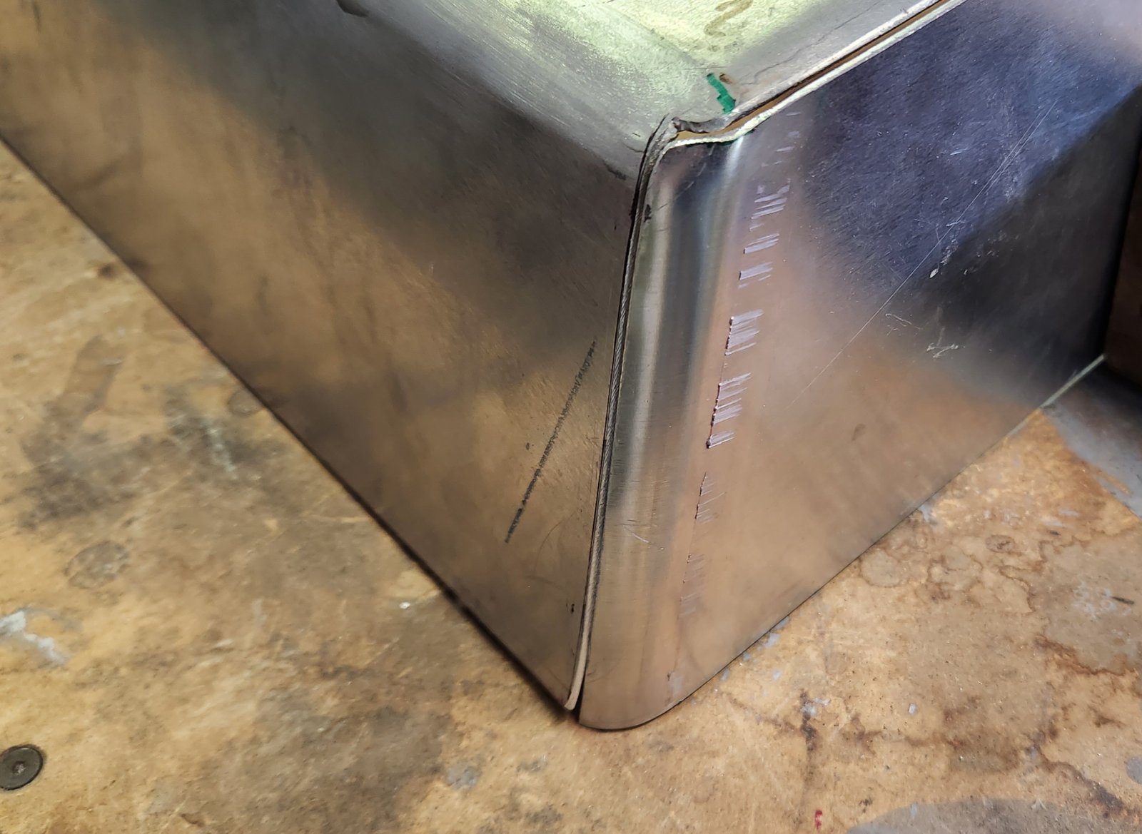

  6. Melted the two corners together

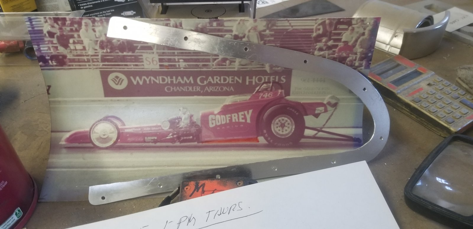

  8. Godfrey's piece is coming right along..
    brEad and Stan Back like this.

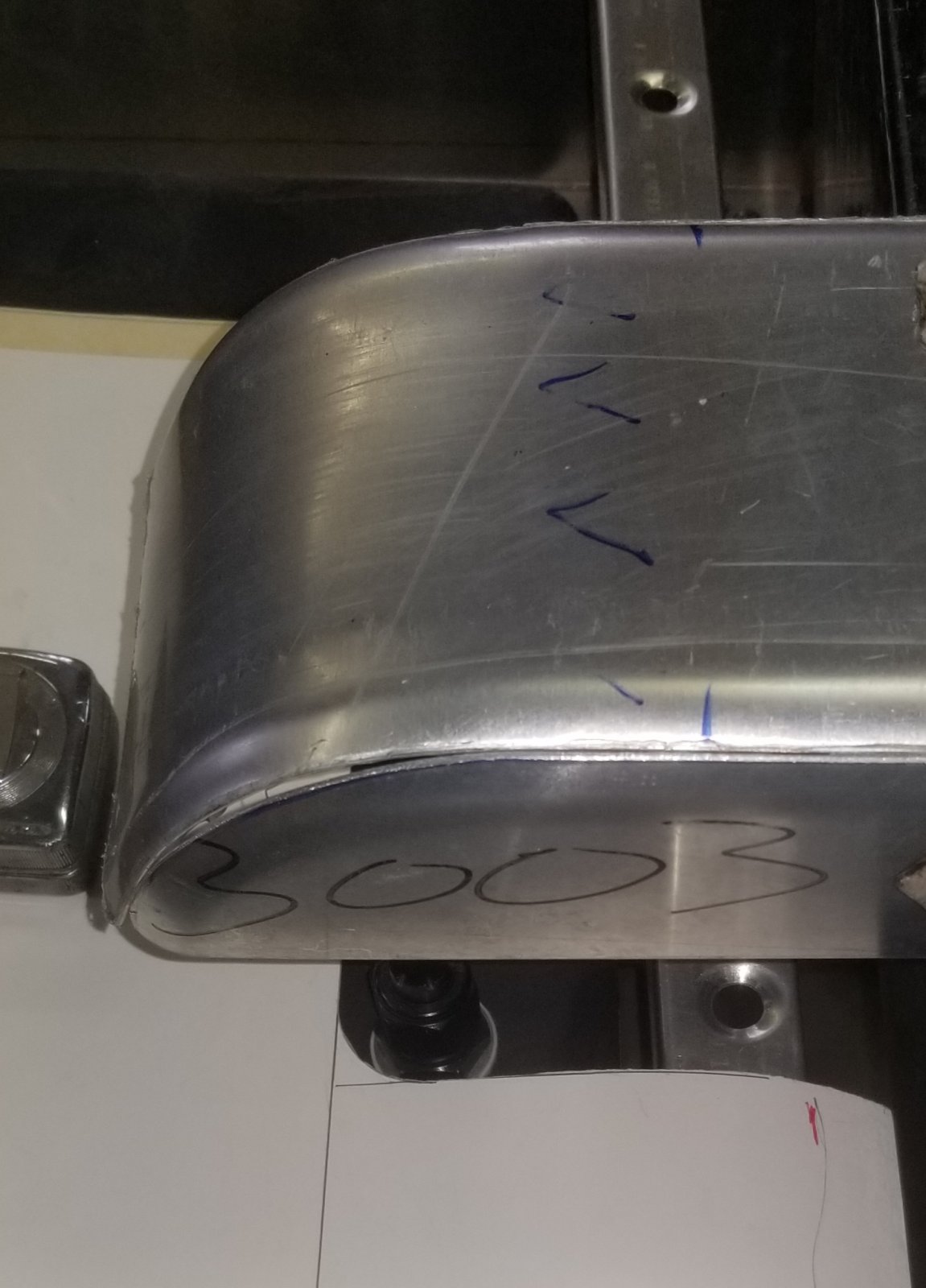

  11. I'm getting good.. at making things that don't fit, the first time around. But with that, I'm going to change the design. Norm's welds on the right, mine are on the left.
    Excuse that funky yellow shadow on Norm's part.

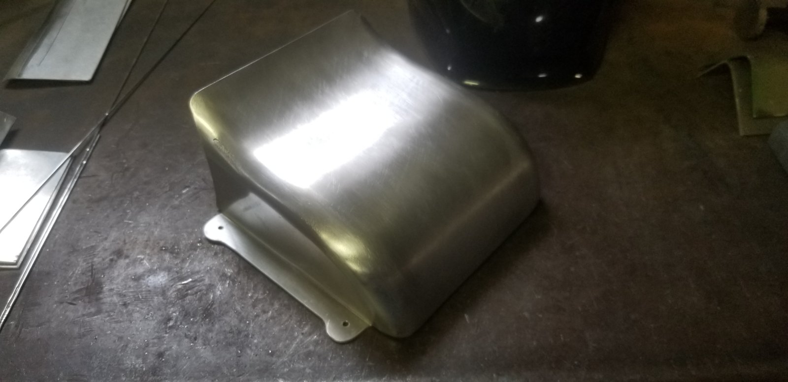

  13. Norm asked me to put some time into this piece for his roadster, when I came to a stopping point on the 50Merc. It'll attach to the tonneau cover and hide the fittings on the tank.
    The first one I made, didn't fit. So I started over, and changed the design to resemble the 26-7 turtle deck. Not sure I like how it curls up and wonder if I shouldn't have done it without. Norm likes it, so we'll see, I suppose

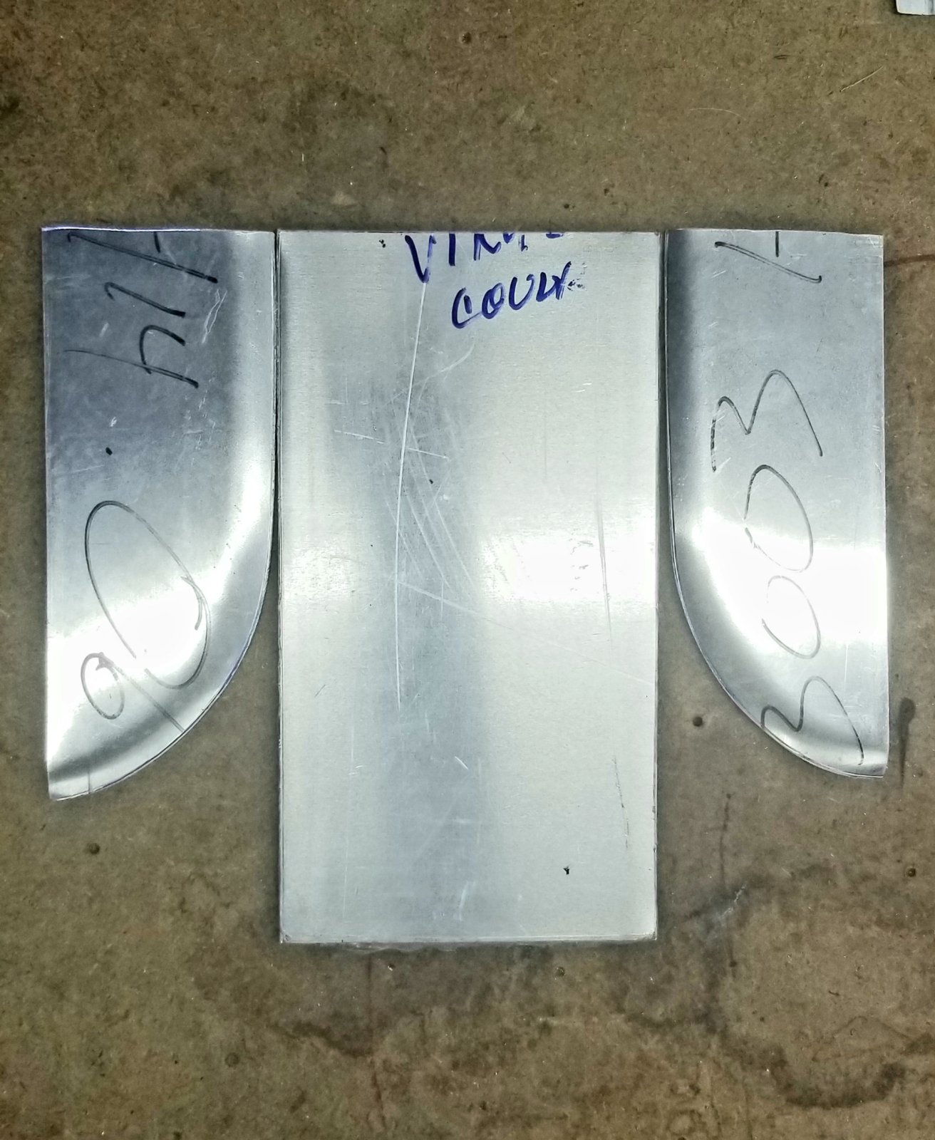

  14. I had to do a little more welding, filling in the low spots. Then some finishing work to make it appear like I might know what I'm doing..

  15. Norm has been emphasizing, I need to reduce the size of my tacks. I find it easier, not using filler rod, when doing so.
    You can see where the tacks are, when I use filler rod. No bueno for gas tanks, etc.. 20230211_082835.jpg

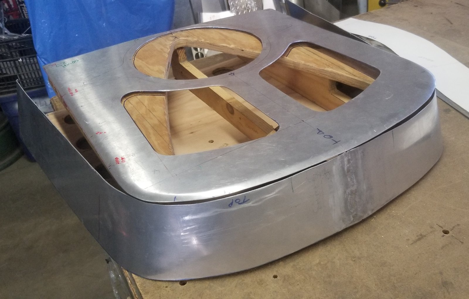

  19. Originally, the grille surround was to be made from two separate pieces. I wanted to finish the weld on the practice piece
    20230308_132804.jpg Screenshot_20230308-132842_Gallery.jpg 20230308_122531.jpg
    guthriesmith likes this.

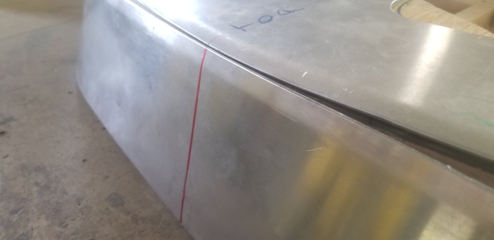

  21. Back to the grille, again..
    20230419_092216.jpg 20230420_104247.jpg 20230420_111639.jpg 20230420_104416.jpg
    Tman, guthriesmith, brEad and 2 others like this.

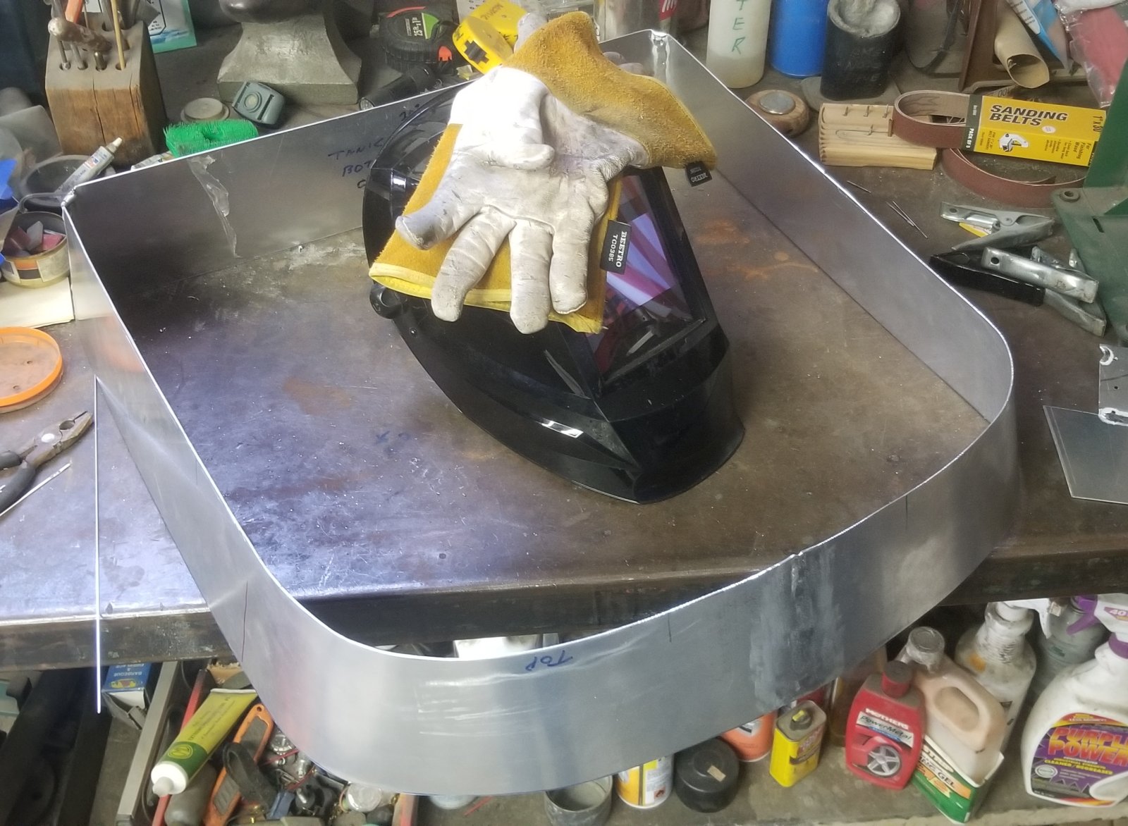

  23. Making the bottom piece, for Norm's grille..
    brEad and guthriesmith like this.

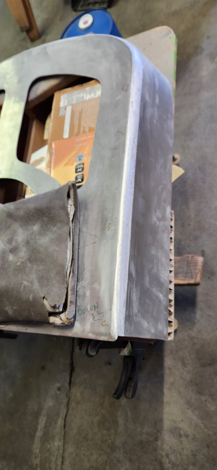

    brEad, Tman and guthriesmith like this.
