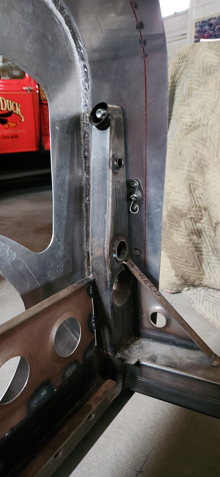

  8. Removed everything off the ch***is, once again, for better access to the areas still needing to be welded. Working with the different thicknesses has been a great learning experience

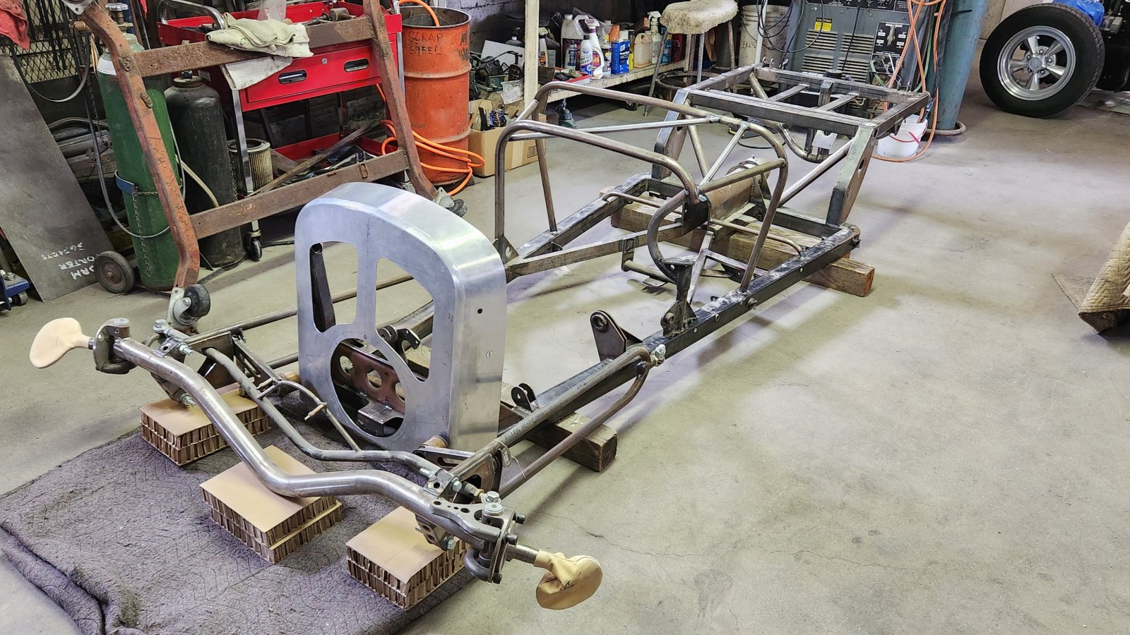

  9. I've been hitting this from all angles, tig'ing everything that needed finishing. Once right side up again, Norm wanted to start focusing on the grille, and figuring where the rockers are going to be peeking out, through the grill sides..

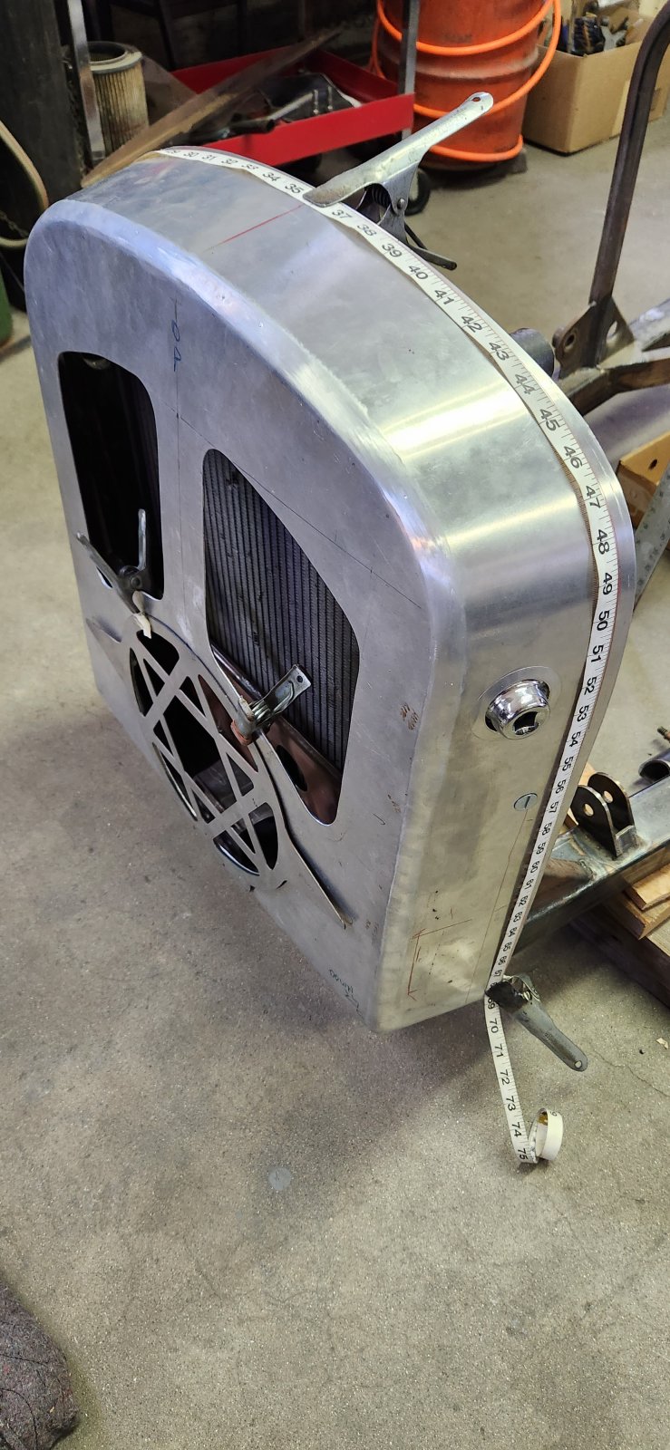

  11. Still working on the grille shell and welding up the loose ends on the frame.

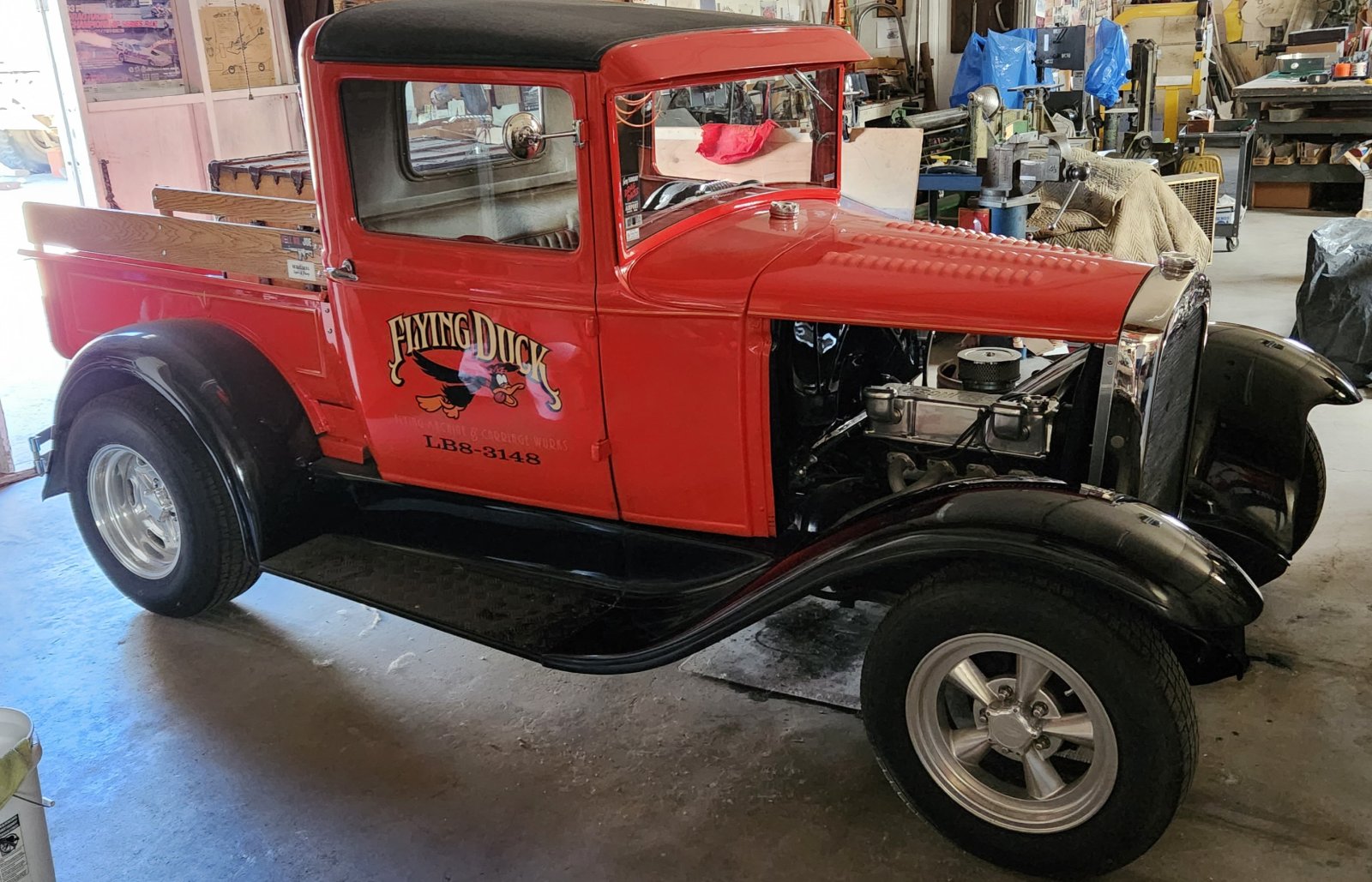

  12. I've taken the grill on & off, multiple times. Marked it and filed it, until the torsion rockers have enough 'clarance'. So now all the dzuz fasteners fit and I can fine tune the final shape. 20230627_123444.jpg
    Color sanding off the orange peel for the 30A truck.
    brEad, loudbang and Stan Back like this.

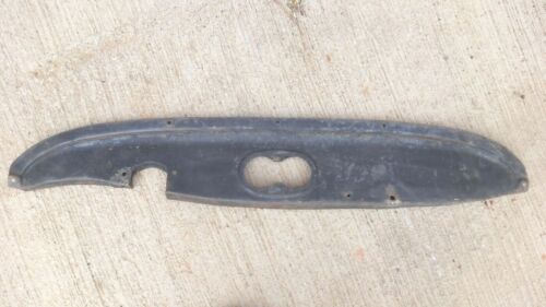

    Here's a pattern similar to the dash I made for my rdstr.
    Tman likes this.
  17. Now to tip up a flange on the bottom edge..
  18. That looks eggzactly like a dash they did in a sportscar inspired T 20 some years ago in SRM
    J.Fishbeck likes this.
  19. I got the idea from the original 26-7 roadster dashes. I exaggerated everything (that's what I'm mostly known for, anyways)

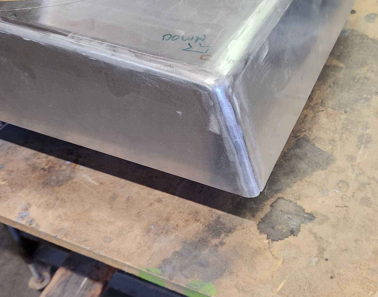

  23. I tipped a light bevel for character and then a 90° flange..

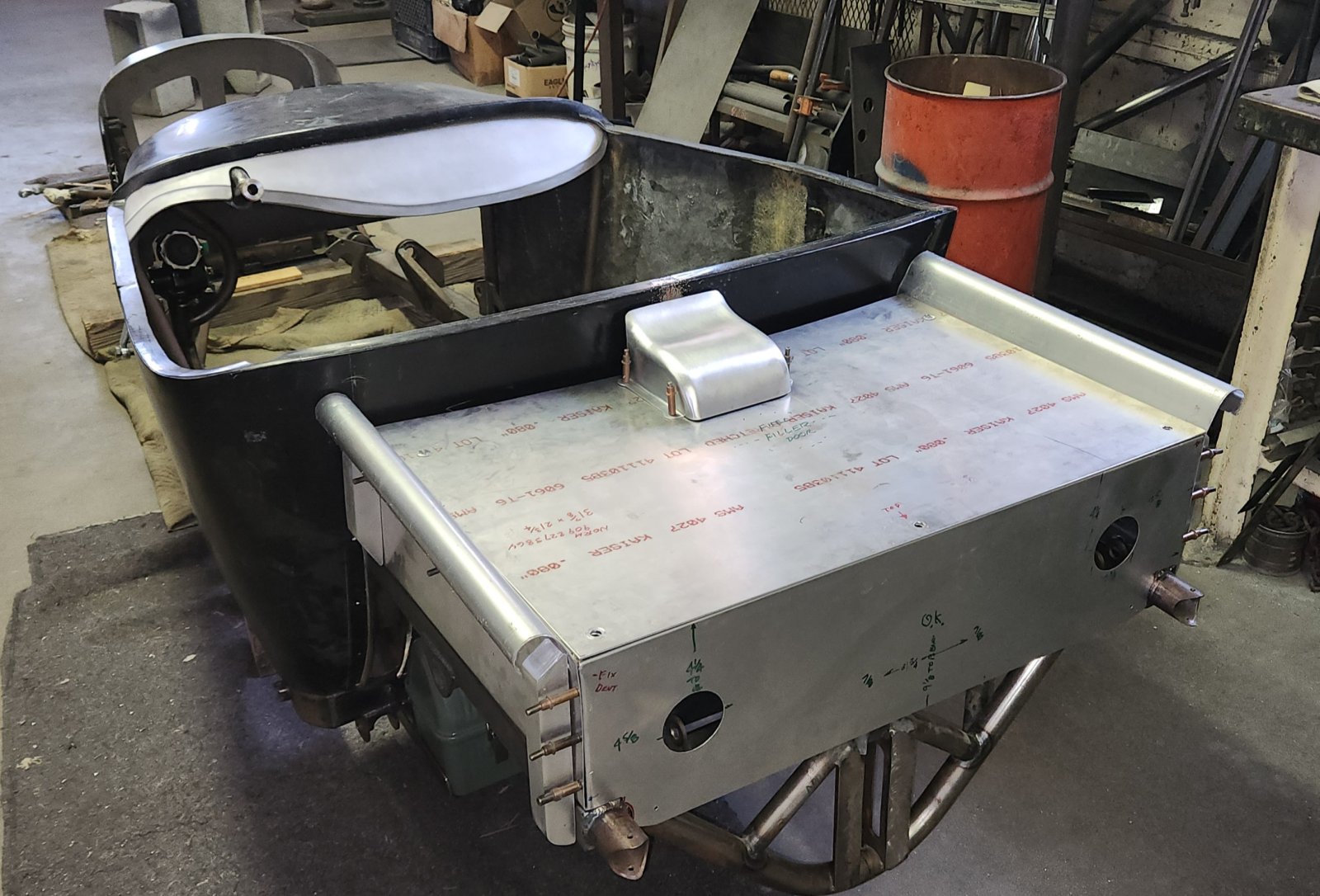

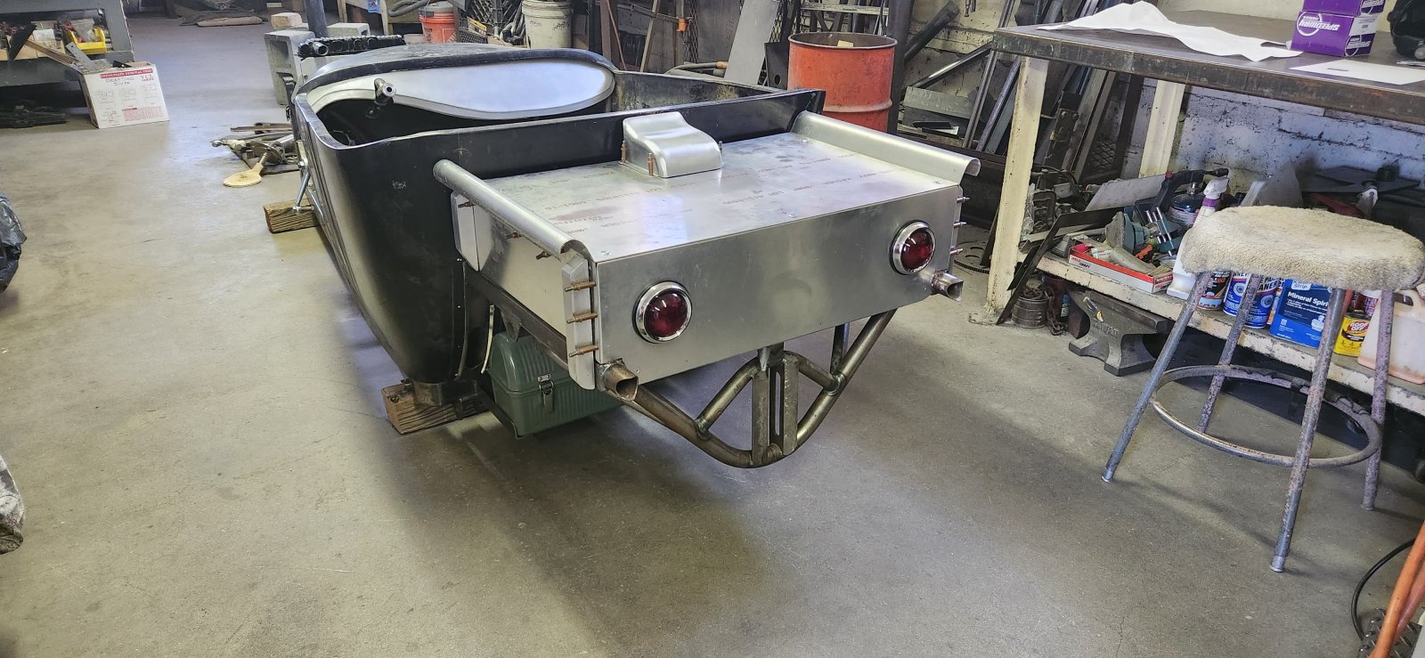

  24. I want to french (small F) the taillights into the tailgate. I think it'd be worth the time.
    loudbang, patsurf and 51 mercules like this.

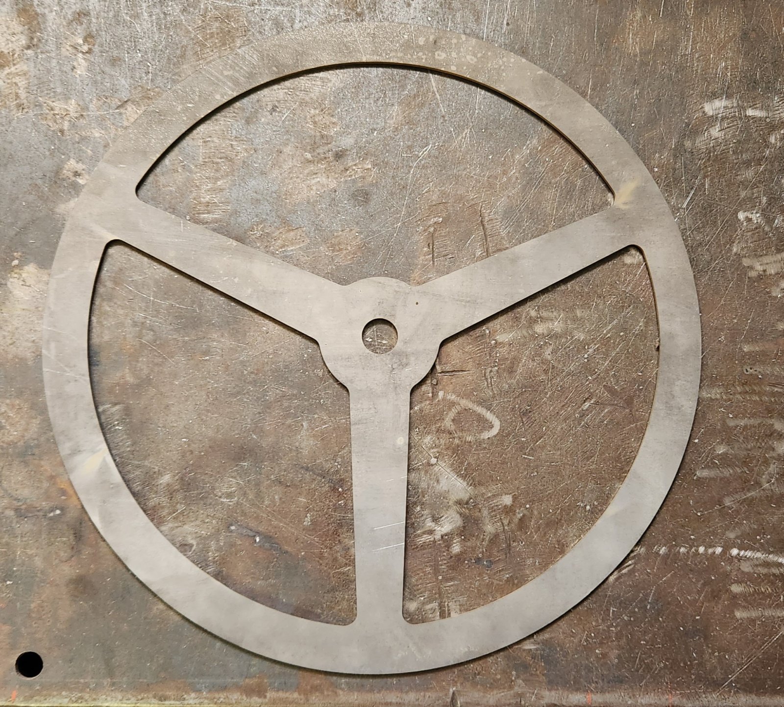

  25. Welp.. couldn't use the other taillights, as they weren't shallow enough to clear things inside the bed. So he picked up some 50 Pontiacs at my request. Frenching these in, is no bueno.
    Went and picked up the steering wheel center, after having it waterjetted (that's a word, now)
    brEad and loudbang like this.

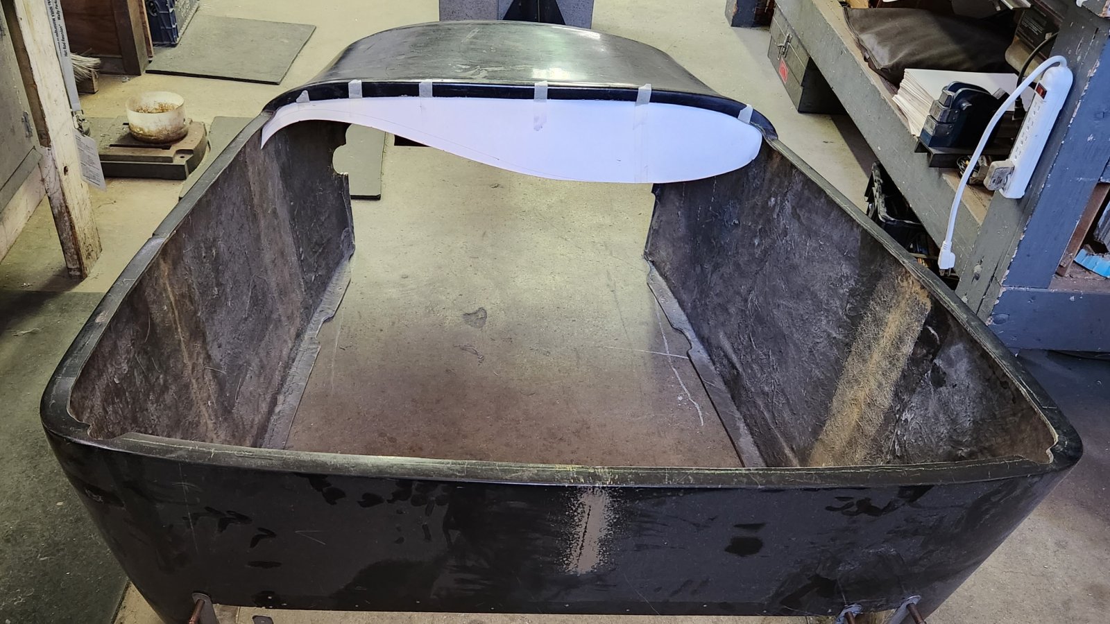

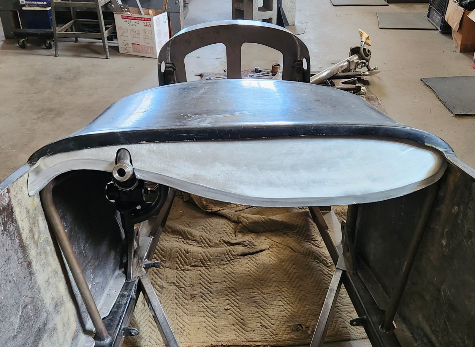

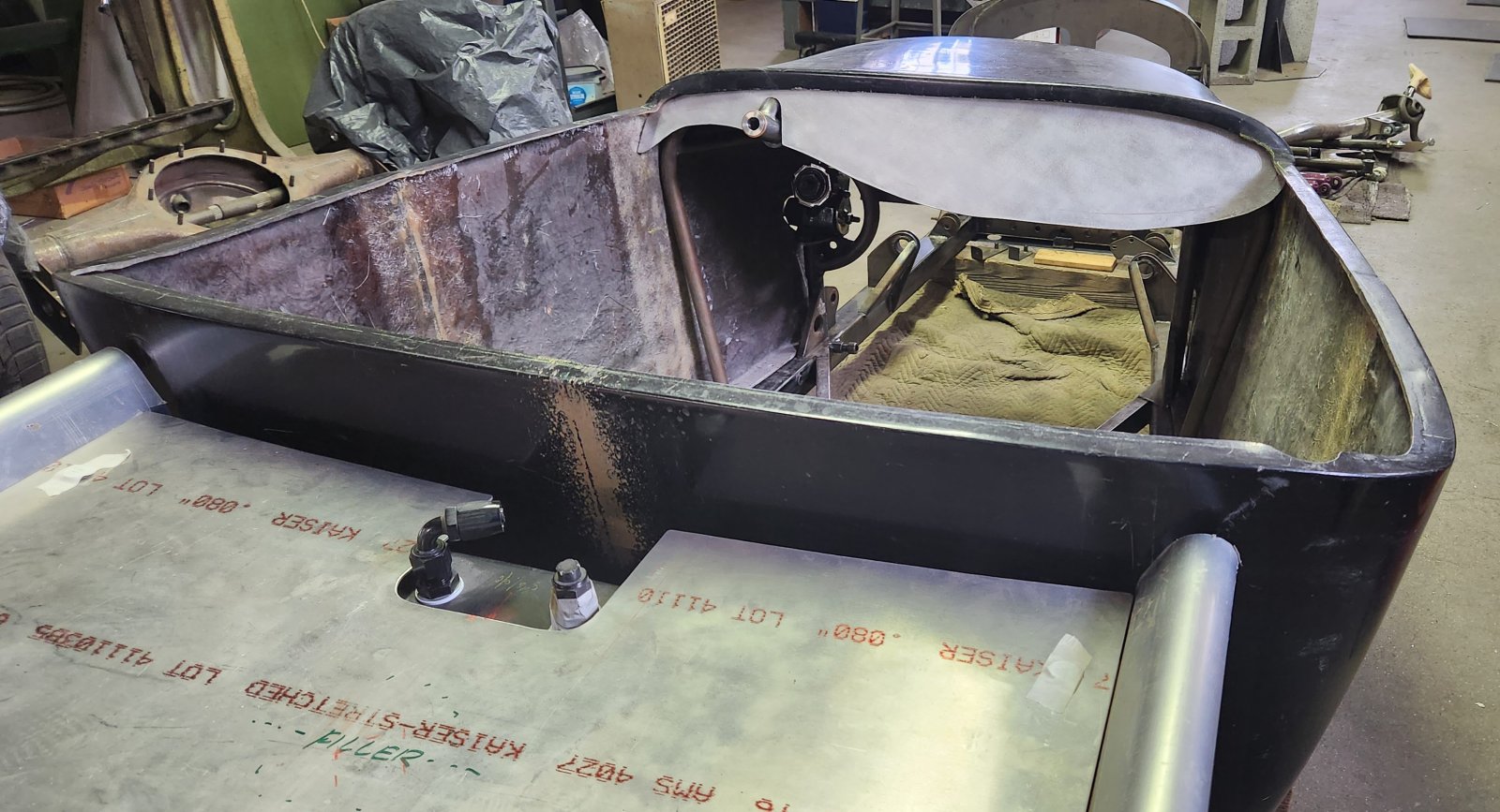

  26. A mini turtledeck
    Stan Back and J.Fishbeck like this.
  27. That's Norm's favorite part.
    I originally made the first piece, that didn't fit, without that upward transition, more like a 32 rdstr. So when I made the second one, I went with this idea, instead. It covers the breather vents, for the gas tank.
    51 mercules and Stan Back like this.

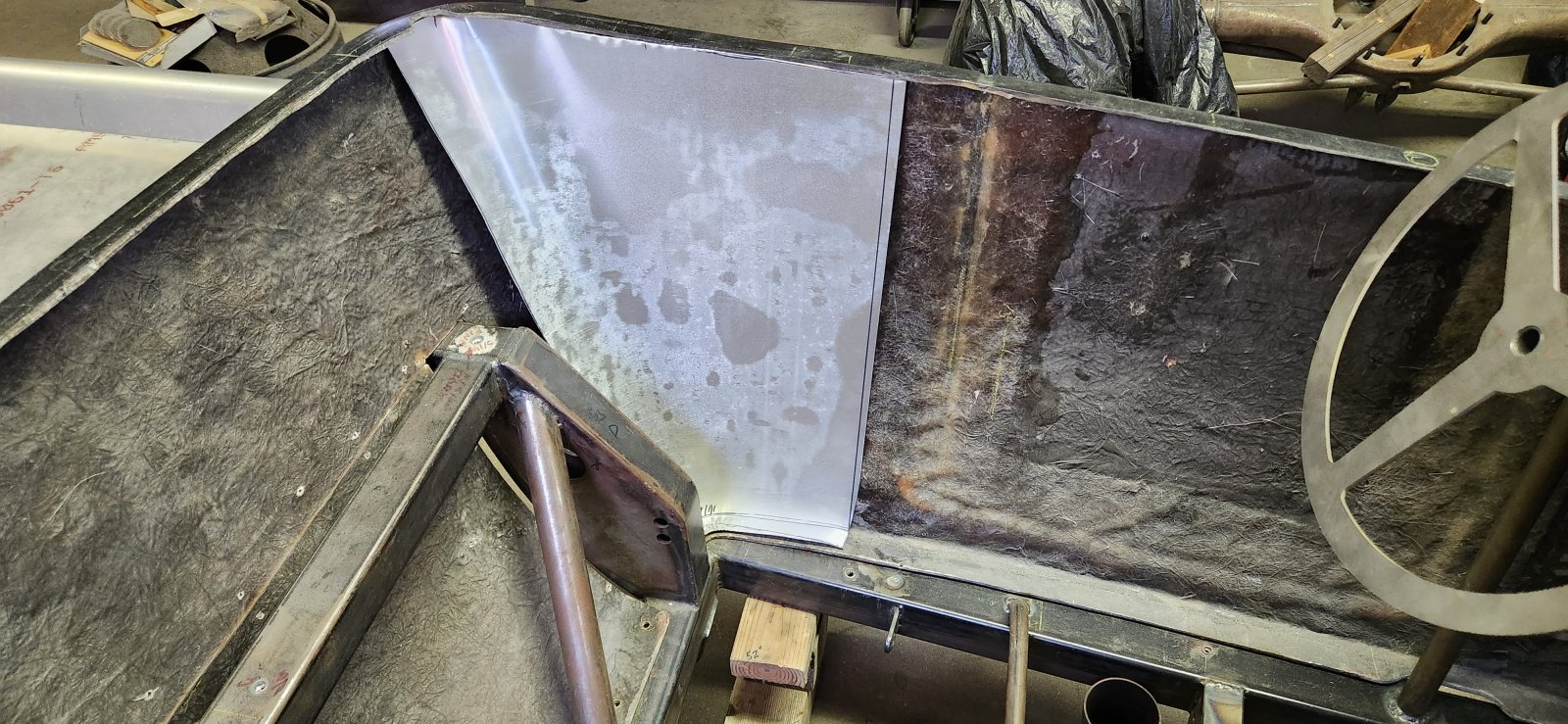

  28. Mocking up the first of the interior panels, out of some mystery, donor aluminium material
