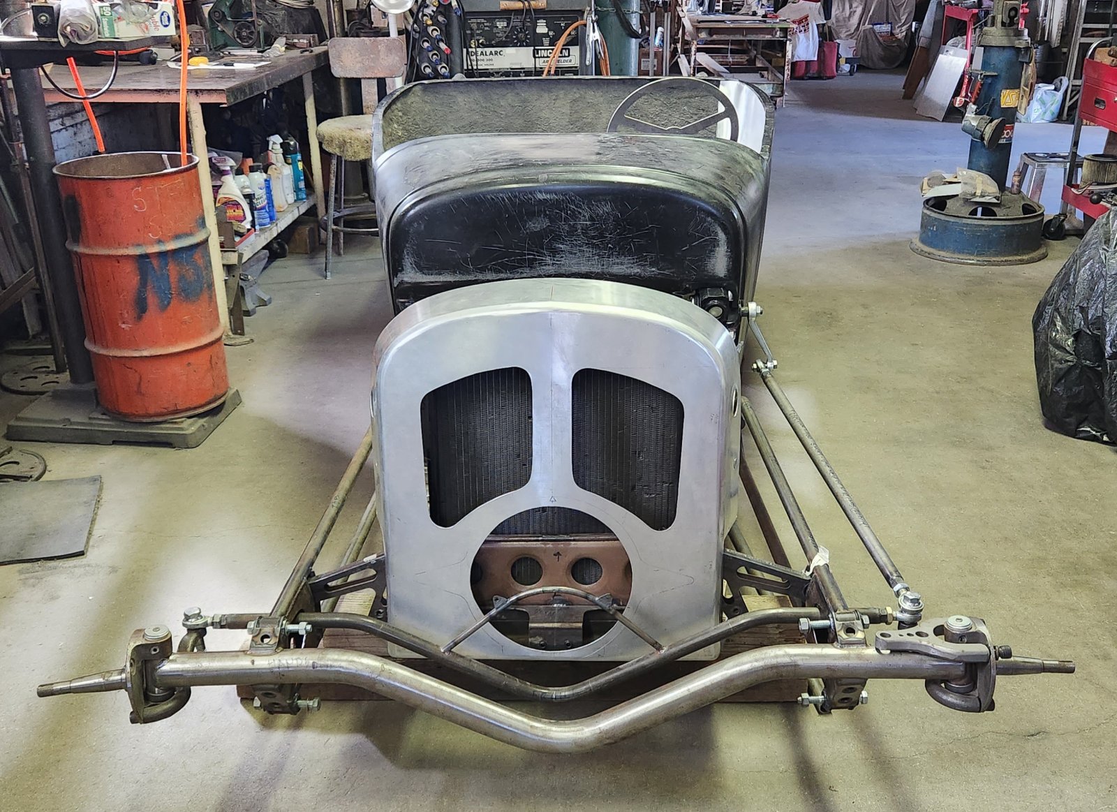

  1. I wanted to see the grill shell on, while the front suspension pieces were still on..

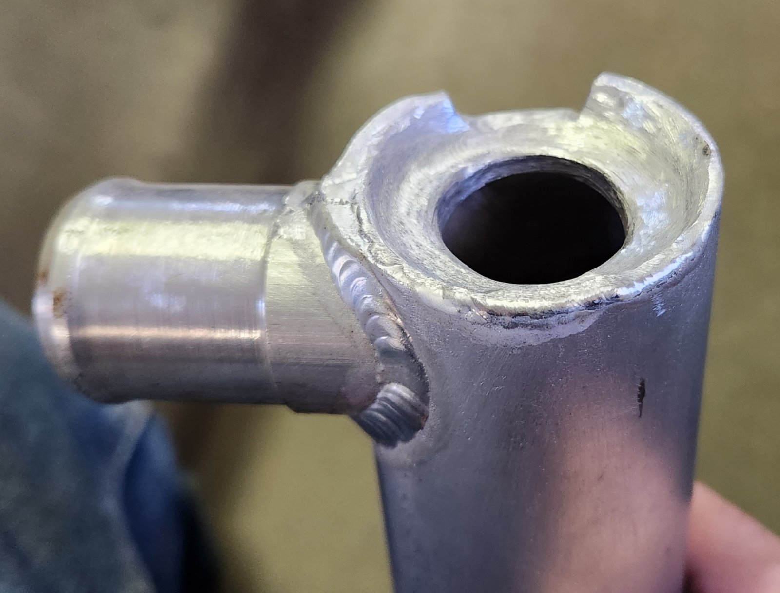

  3. After looking at the filler necks height, Norm wanted it angled and brought down as close as possible, to the top of the grille shell. It's been fun.. (Rolls eyes)
    20231113_112226_resized.jpg 20231127_100328_resized.jpg 20231201_111729_resized.jpg 20231201_112420_resized.jpg
    I still have some filing work to do, and then melt the top portion, back on. Things no one even notices. But that's the good stuff

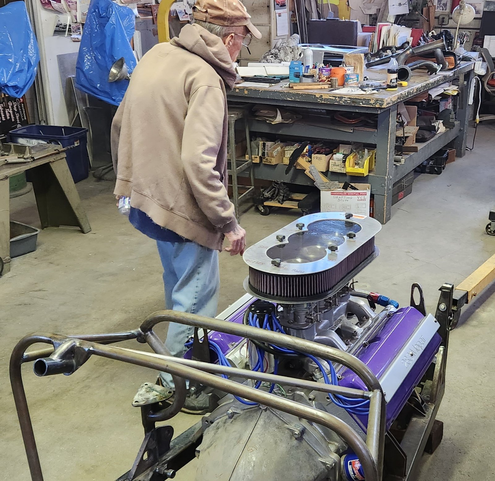

  4. Bowtie overdrive, makes a kit for the 200 4r / 2G Rochester carb, configuration. But, I have to make something work for the stromberg's. Seriously, I don't like the look of the B O's adaptor, on an open engine setup. Not looking forward to figuring this all out. Wouldn't have this issue, if this thing has a clutch

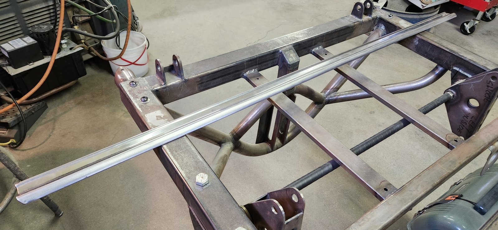

  10. The beginning of an E-brake/ trans tunnel, cover..
    loudbang, 51504bat and Stan Back like this.

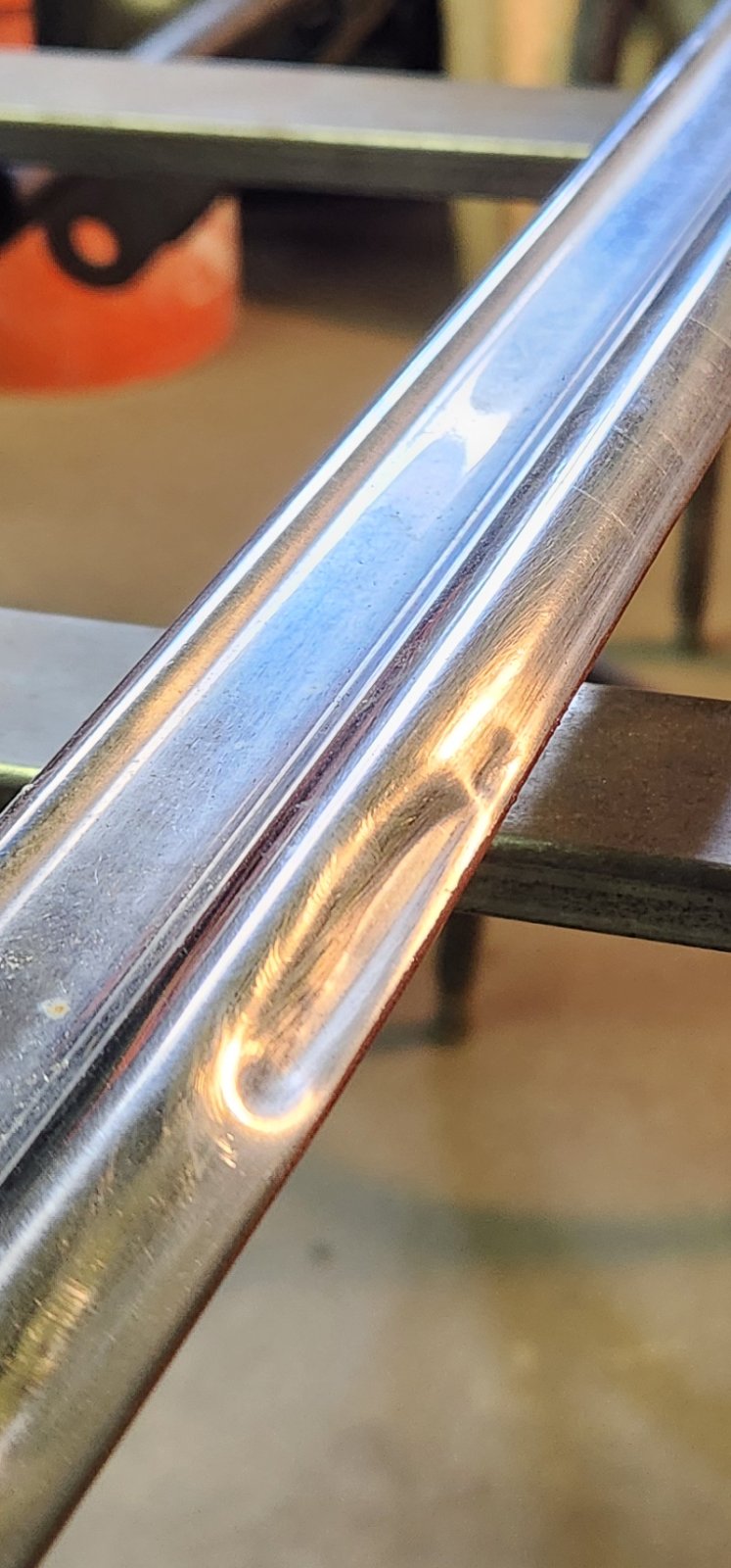

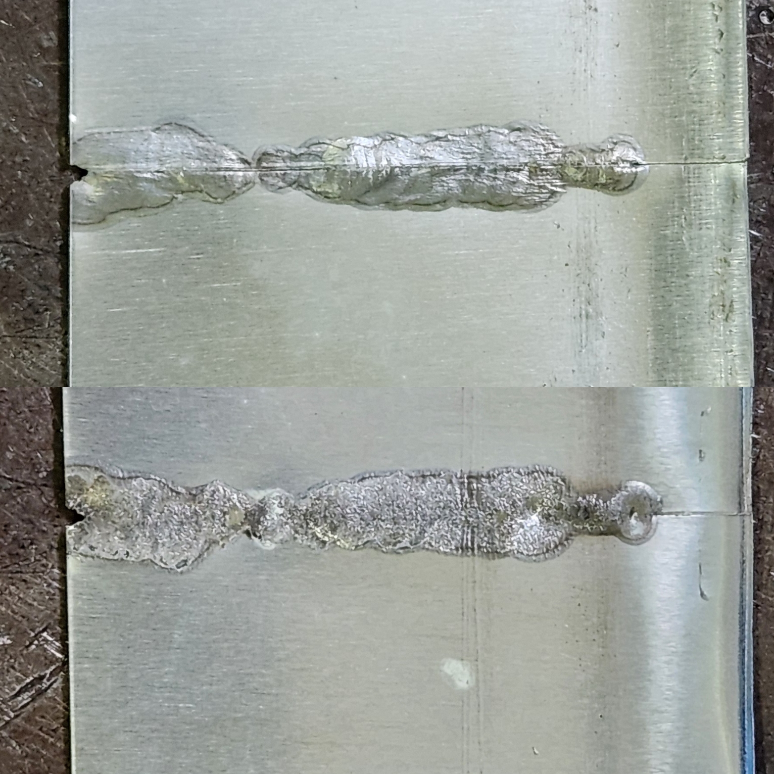

  12. Not sure of the exact alloy of this aluminium. Welds horribly. So unfortunately, I'm unable to make this cover the way I envisioned. We're going with a design Norm, has devised. Tabs, dzuz fasteners and pop rivets.

    I use a clear Pyrex Cup on my TIG and I can see the welds better, also had cataract surgery and it changed my welding as different as night and day at 82 I can still run a stack of dimes but before surgery my welds look like ****. I could not believe the difference it made
  14. I wear my reading gl***es when I weld, so I ***umed that was as good as it was going to get. But everything was still blurry. I didn't know about the magnifying lens for the helmet, itself. That changed everything, for me. So the lens, along with my gl***es, really helped. The aluminum alloy is an unknown. It was given to Norm, by junkyard Ed, decades ago. It's nothing like the 3003 I've been working with.
  15. Made this tab to hold the Dzuz pad, while welding it to the ch***is. In the process, I think I may have sanded off a coating on that same .032" aluminium stock, I was attempting to weld, earlier. That might could explain why it did, wut it dud..!
    brEad, fauj and dana barlow like this.
  16. I still think my original idea, would've been easier, but this was worth the experience. I know what not to do, unless I have to, with this design. Still have to design and fab a front piece

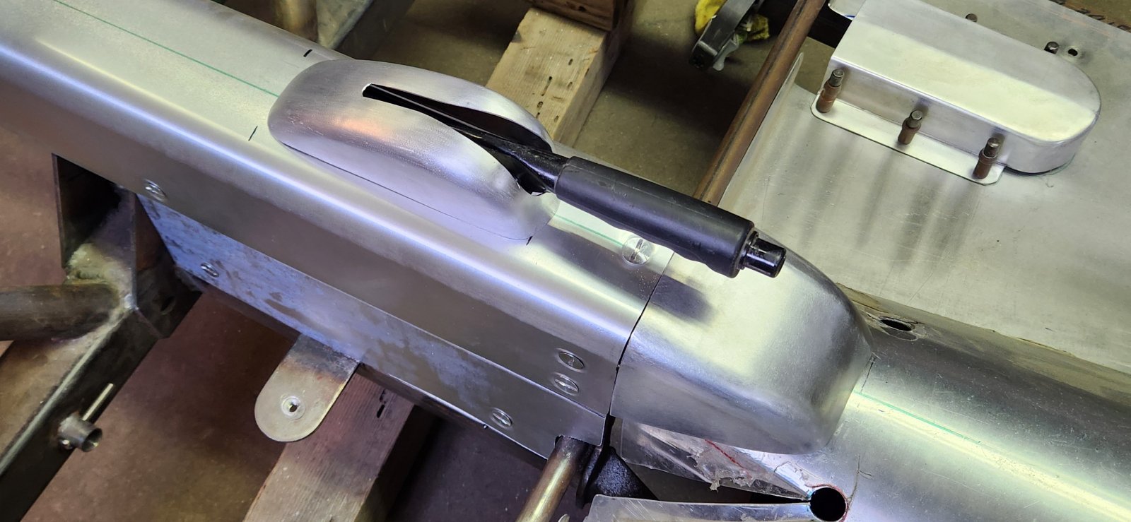

  17. The front piece..

  23. I really didn't know how this would look, once on there. I was skeptical, but I'm pleased with the outcome. Now to attach it and do the finishing work.
  24. I had to open things up a little wider with the file until everything cleared as it moved thru the full range of motion
