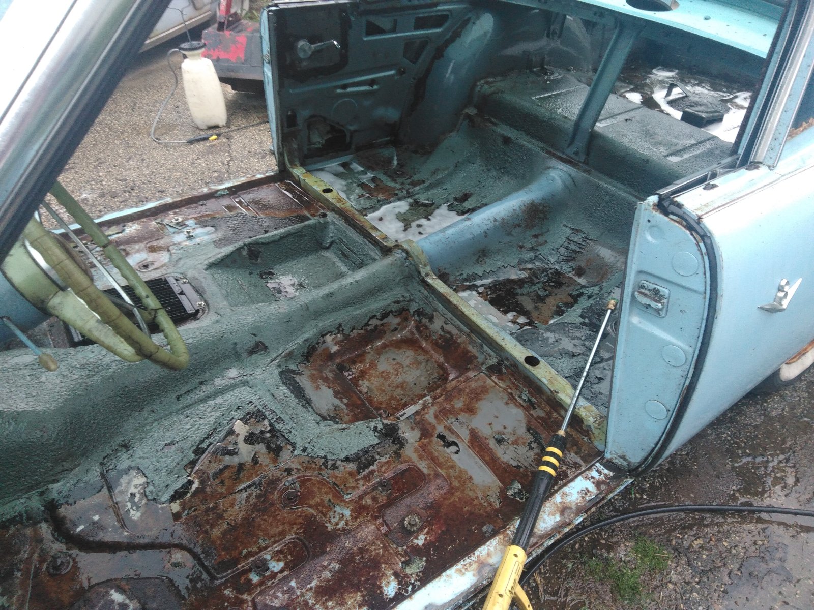

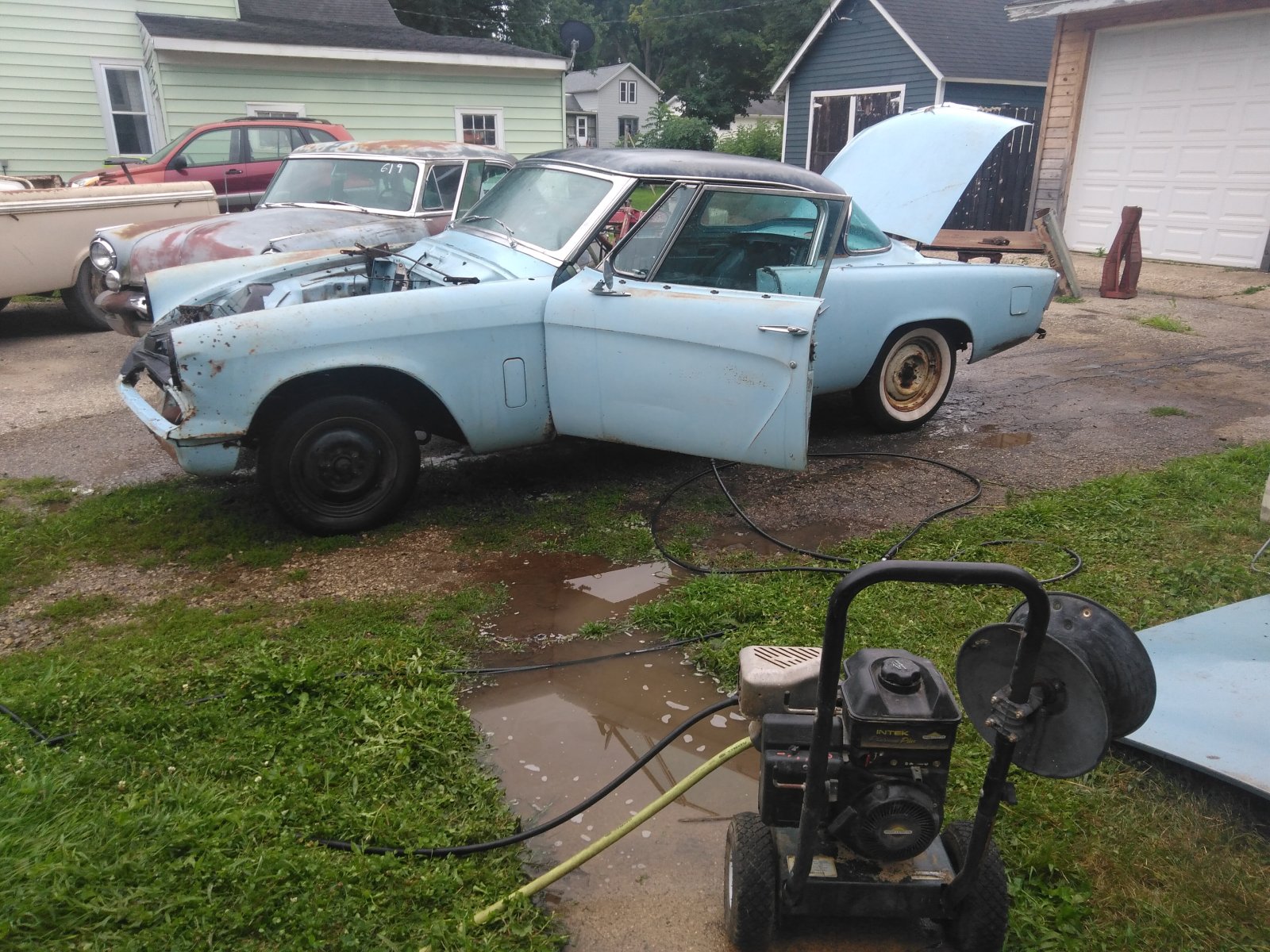

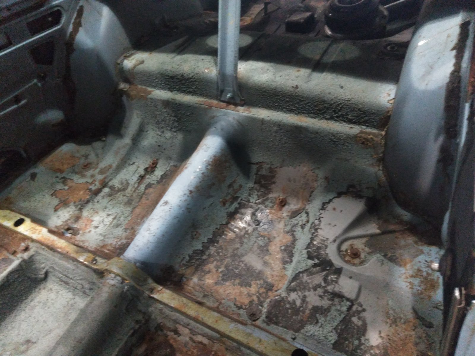

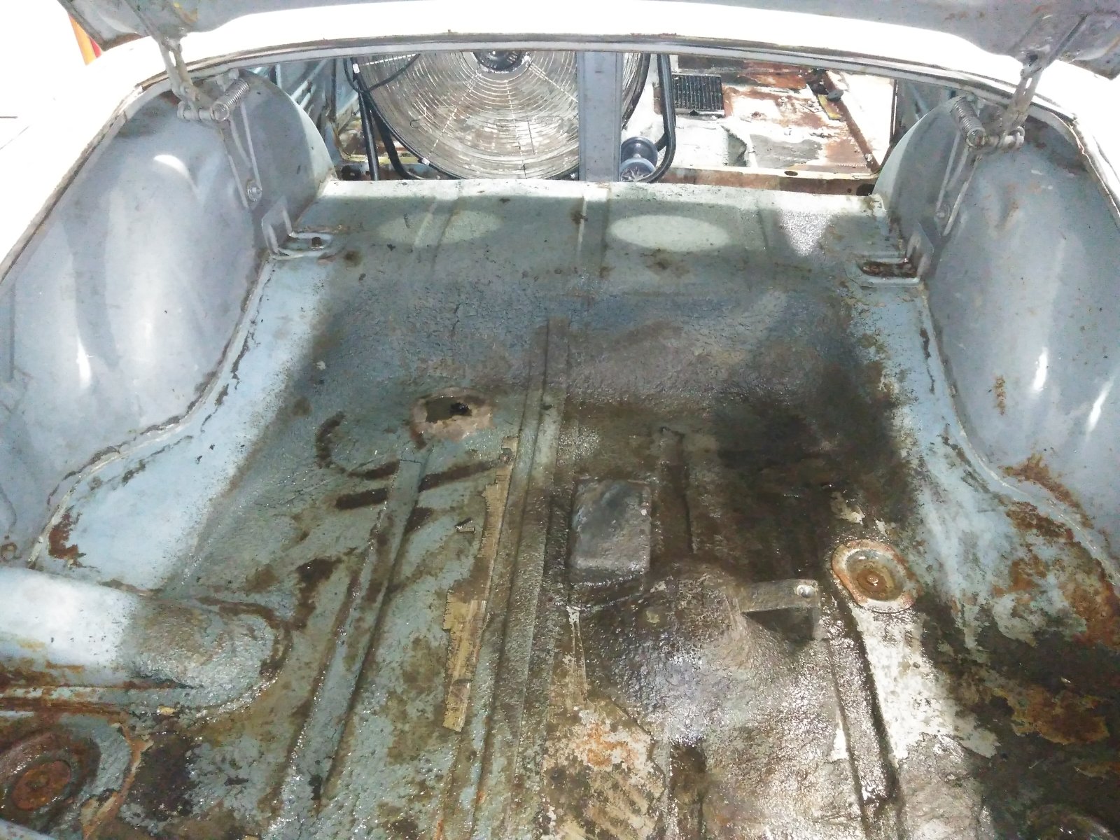

    Spent a couple days pulling the interior and then a full Saturday with a pressure washer cleaning out years of grime and rodent remnants from this thing.
    There are a couple soft spots at the base of the A pillars, plus the typical Studebaker front fender rust, but overall very solid for a Midwest car.

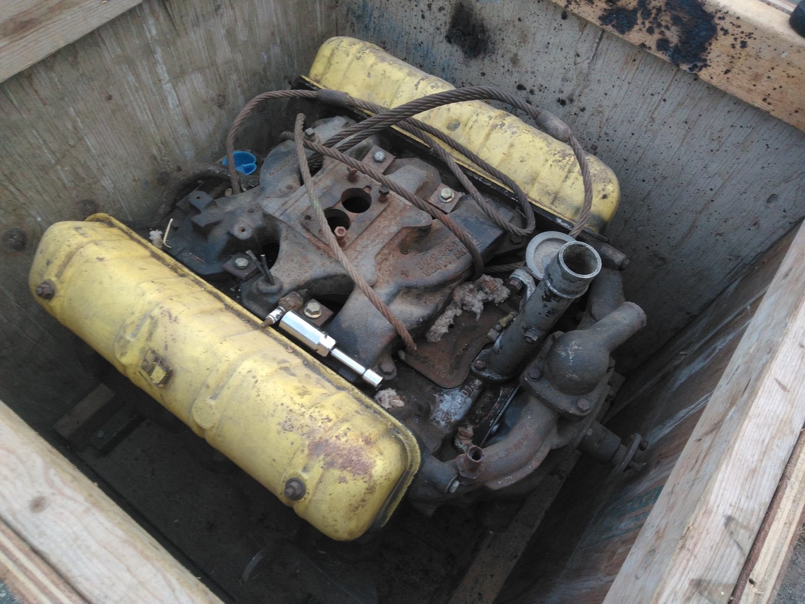

    Picked up a "crate" engine one day after going to look at a cheap Lark 2 door. The car was pretty rough, and my wife was still set on getting a convertible, but I had an empty trailer so I figured I should at least bring something home. I got the engine cheap because no one knew any history on it. It turned out to be a 259 that was missing its rods and pistons.

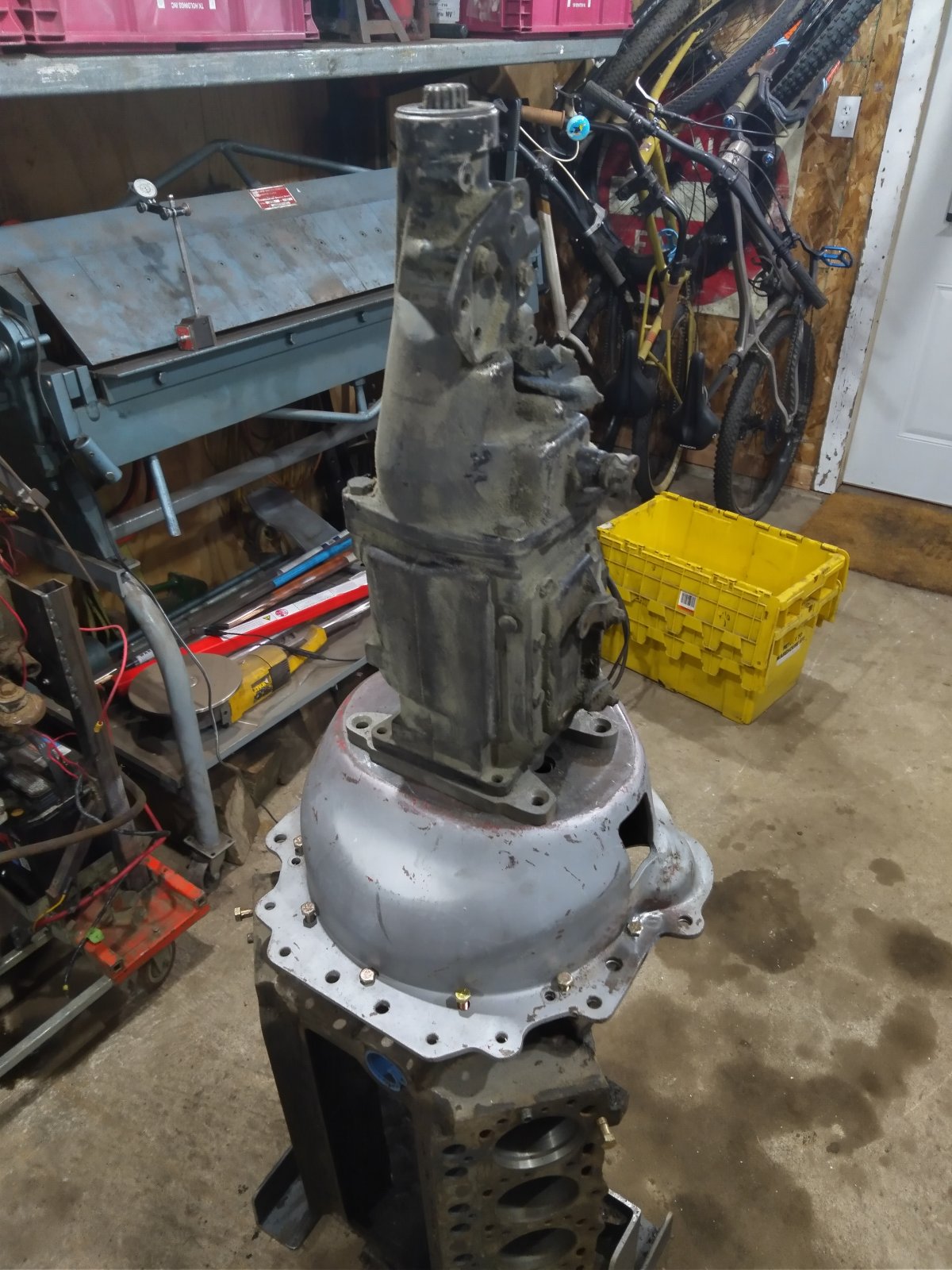

    Around this time I also drug home a couple Studebaker T10's and some other parts from a neighbor who has a 289 (Studebaker) powered 1930 Erskine Coupe hot rod.

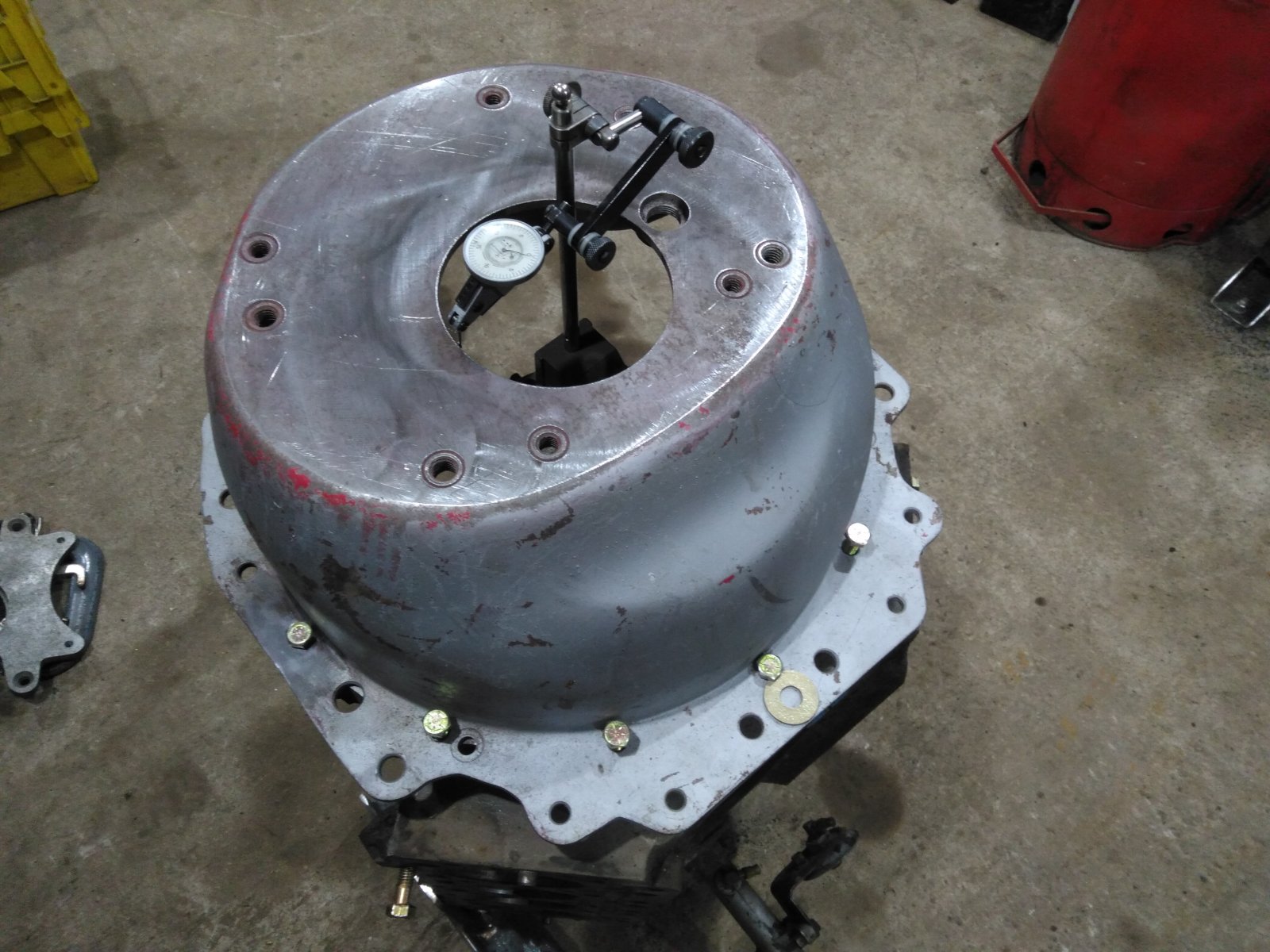

    I had also read that a B.O.P. ****ter shield can be fit to a Studebaker, so I picked one of those up too. Suddenly the Studebaker power thing was starting to creep in, even though I swore that would not happen.

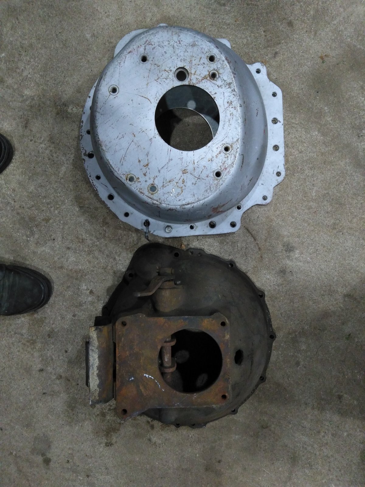

    Back in 1974 we started using Lakewood Oldsmobile ****tershields behind Stude engines.
    The starter pocket just happened to be in the same dr side spot where Stude put their starters
    I forgot the Lakewood number, but it was for late 60s early 70s Olds, prolly bop too. Occasionally we used a common Chev ****tershield, but that put the starter right where the 1962-64 Stude full-flow filter would be. The Olds ****tershields would allow use on both full-flow, plus the earlier non-full-flow-filter blocks.
    All the chevy clutch stuff fit right together on the Stude flywheel.
    The ****tershield fit almost like a cork in the Stude floor tunnel but they fit.
    When you start using heavy duty pressure plates, you will have to beef up the Stude linkages etc. I started twisting and bending stuff until I forced myself to make my own beefed up linkage parts. It's worth it.

    @dare-to-be-different It was some of your old posts that got be going the B.O.P. bellhousing direction. I don' t have it all the way figured out yet but we are getting closer.

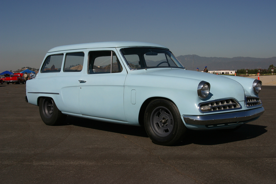

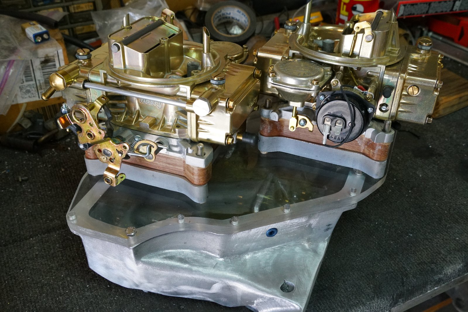

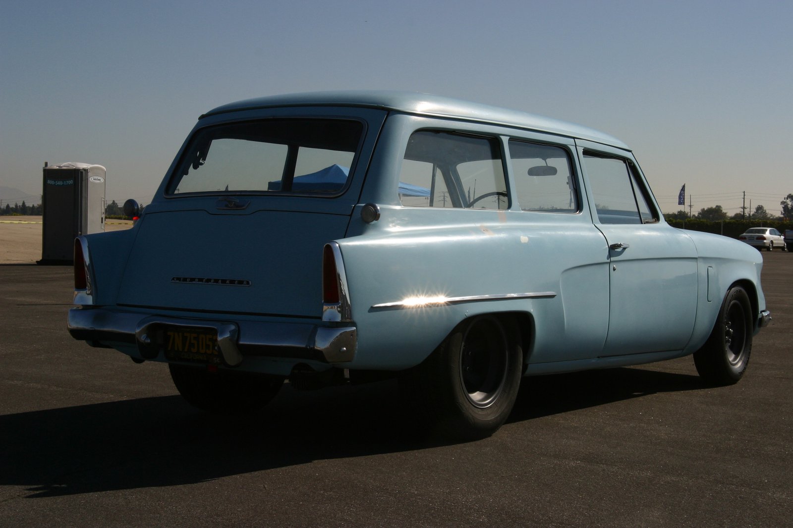

    My long term project.
    The Quick Change axle is in, brakes made and in place and wheels chosen, the transmission is sitting and waiting...for me to finish the engine.
    The intake manifold -
    A chopped up Chevrolet manifold, with some spacers, will now work on the Stude engine.

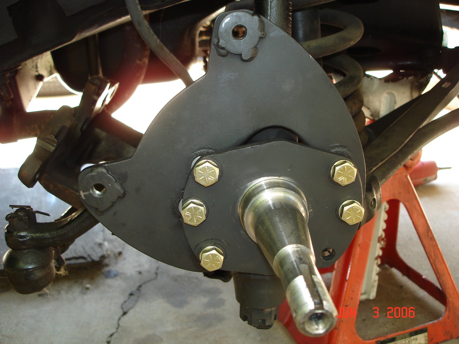

    My intentions for my car are to use it as a hot rod, not to let it sit around and stare at it. Take it drag racing, autocrossing, cage it and do La Carrera, take it out to Bonneville, even if it is just to run it in the USFRA 130 club. I don't care if it is actually good at any of the above, but I want to have something of my own just to go actually do all of the stuff I dream about. There are probably a many better platforms to do lots of these activities in, but it's just not going to have the style and cl*** of the Studebaker. Segments of the hobby have gotten so specialized that a guy probably needs a car built for each discipline. I live in town, and work out of a small shop, so I just can't have a bunch of specialized cars. The car will evolve and change over the years depending on what I want to do with it. Having the Lark around as a family cruiser will hopefully make this process easier just in case mine ends up not being a great street car.

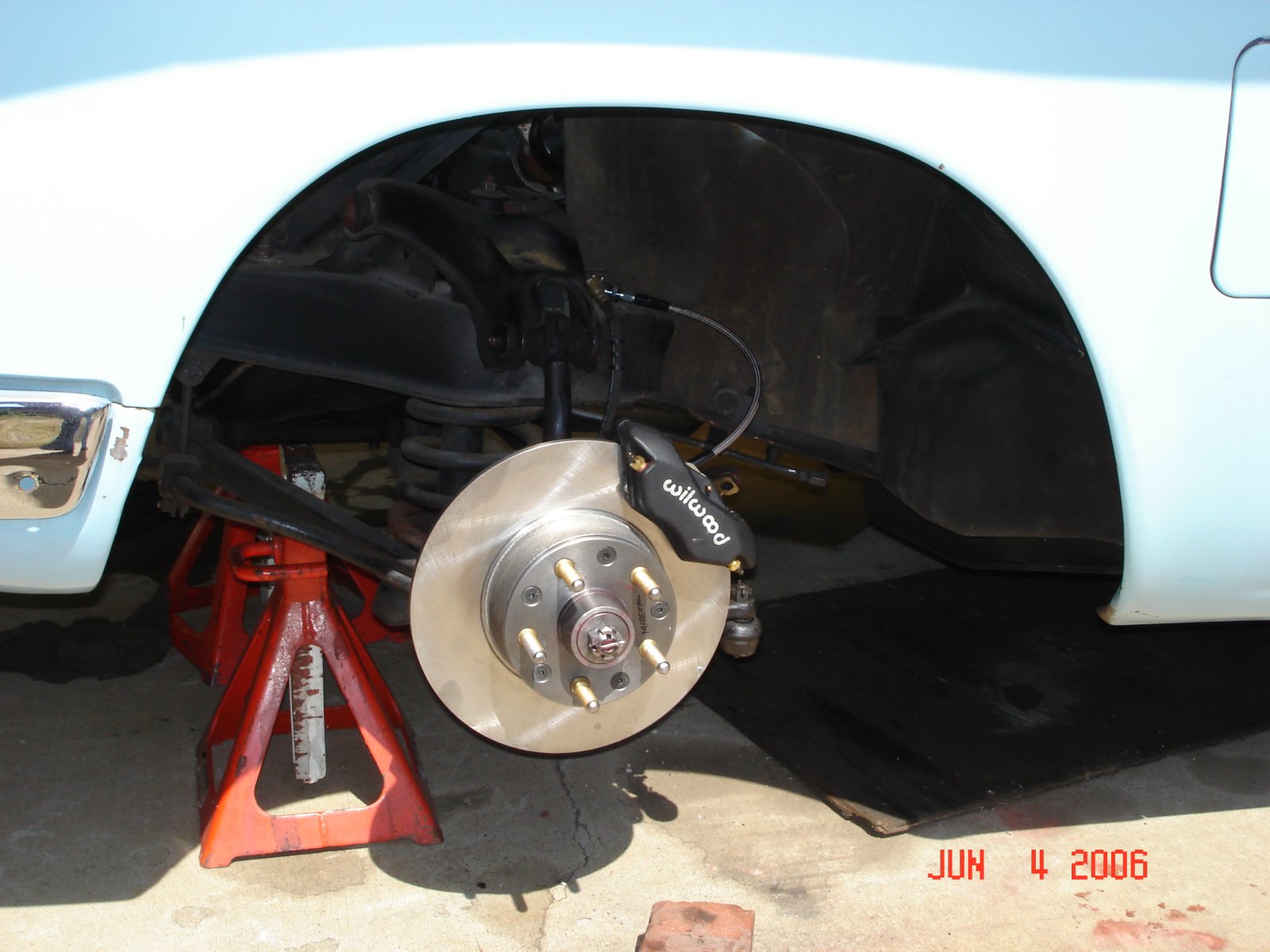

    In either case, my hot rod or our cruiser, I want the cars to have good brakes. Even though I am fairly young, I have driven enough sketch old trucks and jeeps with bad brakes for a lifetime. My wife however has always had somewhat modern disc brakes. I don't want her to have to fight a sticking drum brake to keep the car on the road, or blow though a stoplight when a brake line blows out on a single master system. Good modern disc brakes. Something I can go down to that parts store and likely find parts on the shelf. I also decided pretty early on that I wanted to keep the floor mounted pedals. It just seems to fit the character of the cars. Yes, I could brace up the firewall and convert to hanging pedals, and then actually fit a power booster, but I don't want to. I could also order up a very nice kit from a couple of different companies that make parts for these cars. I also could have bought a tri-five Chevy and built the whole car out of a catalog. But that is not the direction I want to go.
    I wanted to fit as as large of a rotor as I could, while still fitting it below an average 15" wheel. Again, manual brakes and I am setting one of these cars up for my wife. I spent quite a bit of time tying to find a 12" or so rotor that had a deep hat height to push it as close to the kingpin as possible to maximize wheel clearance. Lots of trips to the parts store looking at my options. We even had to use a real paper parts book in the quest. Lots of options were considered including all aftermarket stuff, but I wanted to be able to get parts fairly easily. Eventually I landed on mid 2000's Ford Ranger / Explorer Rotors and Calipers. These are Ø12" and 1" thick and available in lots of different grades at pretty much any parts store.
    They get at close as I dare to the kingpin and just need the I.D. slightly opened up to fit over an Avanti disc brake hub. I wanted to stay away from having to customize components, but it did not work out that way. The 1956 and newer castings are all the same from what I have researched, but the disc brake cars had the back surface machined to get the rotor to run straight. So essentially I am making an Avanti disc brakes with modern parts. My original 1954 hubs are machined on the back, but have a much bigger inner bearing so the rotors need a lot more machined out. I also have also not figured out what wheel studs I need to put this combination together, but I'm sure there is a solution.
    I designed up a 2 piece caliper bracket in SolidWorks and used paper templates to prove the idea out with a caliper I borrowed from the parts store since I want not sure on the caliper at this point. I had already modified the rotor, so I owned it either way at this point. It was fun figuring out the pattern on the back of spindle. It turns out Studebaker liked to use simple bold circles for stuff. The real trick is figuring out the bolt circle, and what segments were skipped. What looks like a simple 6 bolt pattern with 2 holes moved down is actually a 24 bolt circle with a bunch of segments skipped to make the pattern. Or something like that. Nothing ever ends up being a good clean angle, but it is a good multiple of something. Lots of trips were taken between the computer and the shop, cutting out paper templates trying to get in the head of a designer 70+ years ago. It was a frustrating process, but eventually the light bulb goes off and you get it.
    Once I had a pretty good idea of what I wanted, I sent the files out to a local fabrication shop to have the parts laser cut. Laser (or waterjet) cut parts are shockingly cheap if you can find the right place to do them. This place had no problem doing quan***ies of 1 for me, and can usually turn the parts around in a day or two fitting them into a job they are already cutting anyways. Pictured are my first prototypes. The washers and drilled out nuts between the adapter and spindle will be replaced with a machined part on the real version. The 2 pieces will ultimately be welded together. I decided to bridge around the kingpin to grab a 4th bolt on the spindle, as opposed to the 3 used on the Avanti setup. As I designed this I purposely did not look at the commercially available setups. I did not want to be copying someone else's work. Once I had my prototypes in hand and proven out I decided it was safe to look. I found that I did essentially done the same thing that the other kits were doing, which was a good confirmation.
    So far I have had a variety of 5-7" wide steel and aluminum wheels over the brakes. OEM and aftermarket and have not seen anything com close to hitting the caliper. I still need to sort out the brake hose, but I think I have a solution on the way. Wheel bearings and seals were in stock at the parts store. So far I am very happy with the way this part of the system is turning out. Hopefully real life testing goes well once the snow and salt are gone from the roads here.

    Nice work on those brakes. FYI: Jim Turner in South Carolina makes kits that'll fit your cars, I have one on my 62 Lark. www.turnerbrake.com

    Yeah, but well overweight for their purpose. I bought a set...and sold them before mounting.
    My second wagon uses a modified Hotrods & Brakes bracket, with Wilwood / GM aluminum calipers.
    Again, light weight, but plenty to do the job in excellent fashion.
    Mine are similar to the above and work VERY well.

    Drivetrain wise the Lark has an ok running 259. The block says its a 259 and I confirmed the stroke while inspecting it. It had a part throttle lean bog, but once you got part that it was ok for the couple miles I drove it. I suspect a bad accelerator pump. The fix will be a 4 barrel. Probably a 500 CFM Edelbrock AVS2 based on what I have read over on the SDC forums. Tying to stay within the spirit of the original Carter, but with some modern updates. I am traditionally a Holley guy, but for a driver this will be great. Give the distributor (a Prestolite for now) some love or swap it out, put a few gaskets in it and we should be good. It has a 3 on the tree with O.D. and the current plan is to keep it that way.
    In my quest to get my car on the road road ASAP and on a budget I found a running 259 out of a truck on marketplace. It had been swapped in, and I have not bothered to look up the numbers to see when it was made. I was told it ran and was pretty cheap and came with a bunch of parts and a truck 4 speed, so I brought it home.
    These little Tacoma's thrive on abuse BTW. The human body? Not so much. About 3 minutes after taking this picture I managed to slip a disc in my lower back fighting with the engine hoist. I am on the mend now an taking corrective lifestyle actions to prevent this from happening again.
    I borrowed a run in stand from my neighbor with the Erskine. Conveniently it was already set up for use with a Studebaker. Hooked up a couple of wires, sprayed some gas down the carb and we had a runner.
    Oil pressure at a very low unsteady idle running off a spray bottle. It idles a bit higher now that I have hooked it up to a small gas tank and can run on its own. Of course it leaks everywhere, but that goes with the territory I am told. The dry cranking compression is around 150 psi on 6 cylinders, 145 on 1, and 140 on another non-adjacent cylinder. That's a 7% spread, so I am ok with that considering that this thing has been sitting a while. I think I can make out 040 stamped in the top of a piston, so I think this had been gone through before. No smoke to speak of either.

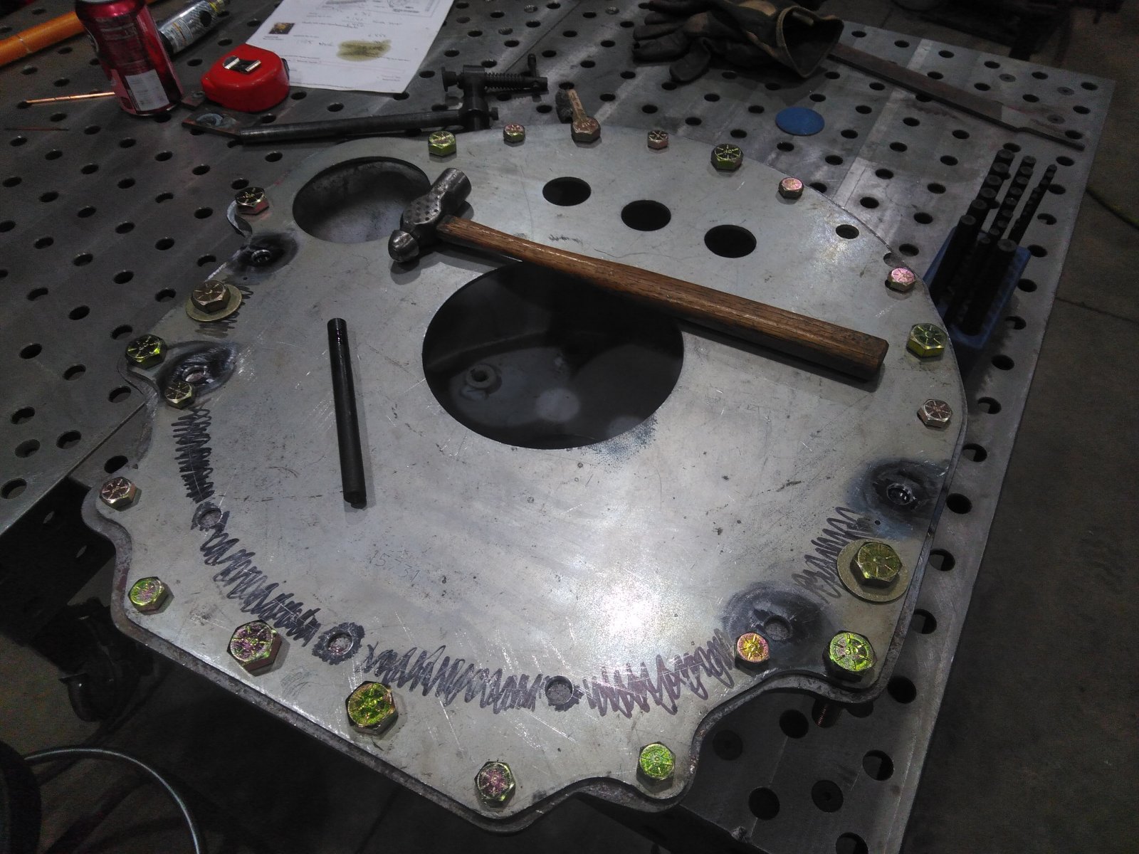

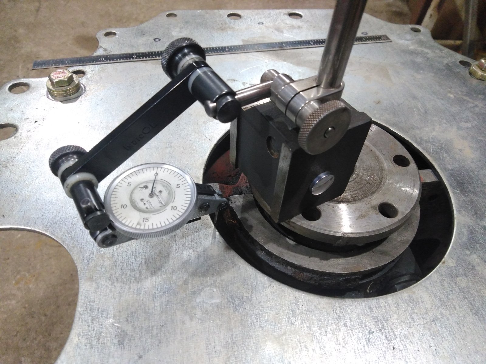

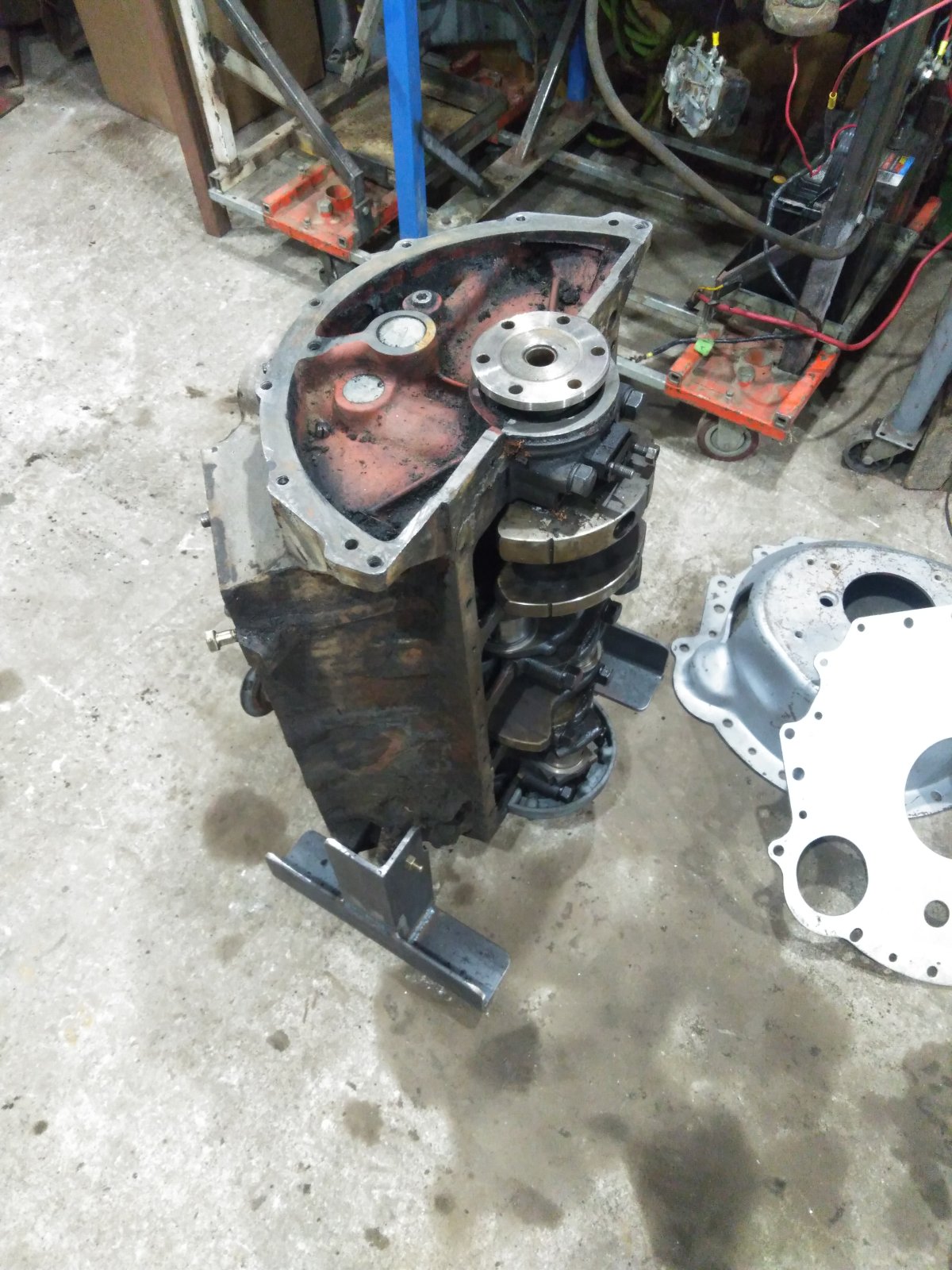

    I partially stripped down my "crate" engine to use it for my bellhousing conversion that @dare-to-be-different had talked about. By this point I had also had conversations with @PackardV8 and @Mike VV, as well as numerous other people and hours of reading on forums about Studebaker performance. I was going down the rabbit hole. There was no turning back now. I had said I was looking for something to sink my teeth into, and I had found it.
    I started with the block plate, dialing it in and transfer punching holes. Lots of horsing around, careful checking, some TIG welding later I was ready to transfer the holes into the bellhousing.
    Thankfully it fit on the first try. I still need to deal with the dowel holes, but have not decided how I want to approach that yet. I will need to run socket head cap screws on the real version.
    Studebaker to modified B.O.P. to Ford / Chevy adapter to Studebaker T10. The aluminum adapter is acting as a spacer since the Studebaker bellhousing is about 5/8" deeper than the Brand X stuff. I pulled it out and was surprised to find that the input shaft seems to clear the crank just fine. I will need to do some careful measuring to see if I can run it that way or not. I am definitely not running a stock cast flywheel, so I am sorting that out currently. I hope to outgrow the T10 power wise some day, but for now it should work great. I also have a dis***embled one, but am not sure what is broken or missing. I am hoping this one is good and complete inside, but have not opened it up yet.
    I am currently making plans to buy some parts for what should end up being a pretty cool 289 as a stage 2 engine for my car. I'm also doing some daydreaming about the engine after that too. With the availability of high octane ethanol gas at every gas station (like it or not) we have some interesting opportunities for Studebaker performance.
    As others have said these things were built tough around the theory of readily available high octane post-war gas. Studebaker might have been a few decades off on the timing, but eventually it worked out. Combine that with some forced induction to overcome the poor flowing heads and I should be able to have some fun following in the footsteps of Studebaker and many enthusiasts over the years.
  29. Screenshot_20220107-185751_Gallery.jpg Screenshot_20230217_163327_Pencil Sketch.jpg Screenshot_20221118-081312_Gallery.jpg Screenshot_20220219-155416_Chrome.jpg
    Keep up the good work!
    To get past the "poor flowing heads" you will need to cut away the factory built in restrictor rings called Factory Valve Seats, and reject everyone who insists on cutting for hardened seats.
    Using a 60° Neway cutter, you can remove the biggest power waster bottleneck, and convince your Stude engine it is much bigger than it thinks it is.
    You can bring the seats WAYYY out to actual bowl size, and cut bigger valves slightly to match your new bigger seats.
    If you ever have any shop cut for seat inserts, you have killed any chances of big flow, and need to start with another set of heads to start over.
    I have been running street cars, and daily drivers since 1971 like this, and really run them hard.
    Cutting away those factory choke-rings out to bowl size makes a huge difference.
    Ignore the p***ionate appeals that tell you to pay them to install Hardened choke rings.
    On valve size- bigger is better only to a point. Stop short of creating your own shrouding, no matter how tempting it is to copy someone's slightly bigger bragging number.
    Make your valves match your best bowl work, not the other way around.
    What you see in the pics are heads done in the 70s, 80s, 90s
    This was when a flow bench was almost never available to anyone. Today the planning might be different somewhat, but this was what gave the biggest bang for the buck if you had a workbench and not a laboratory.
