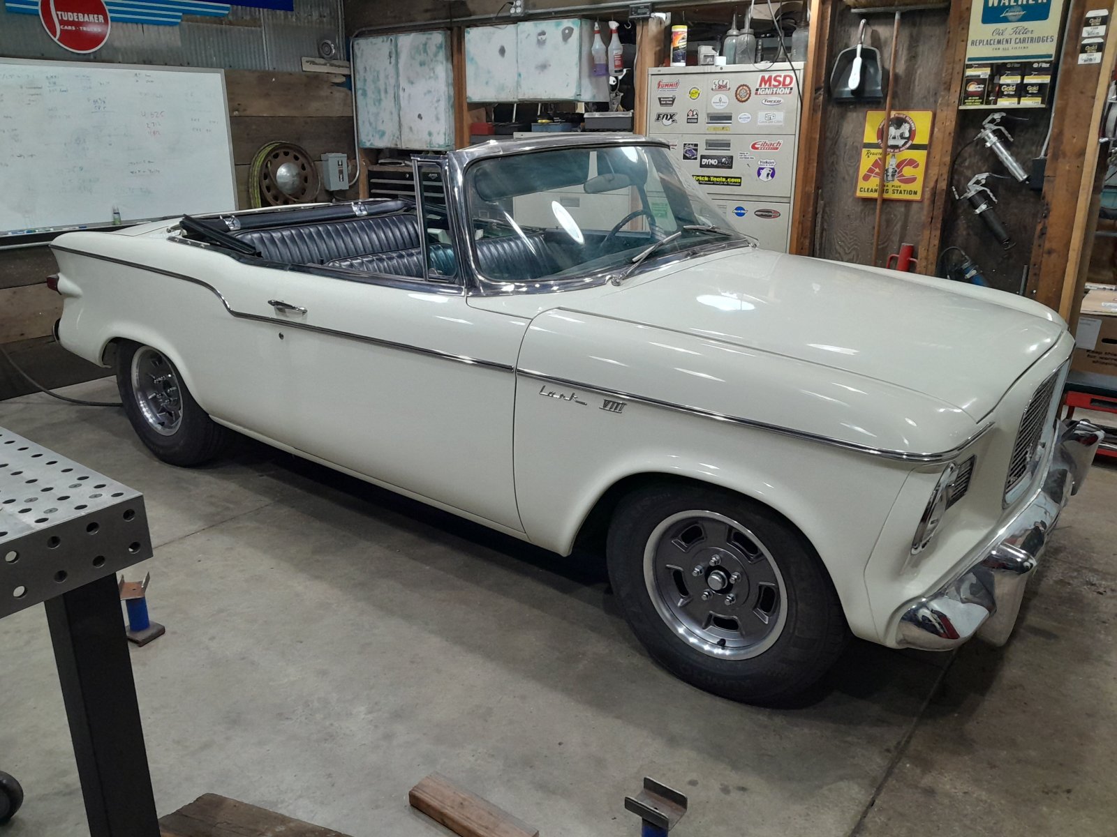

  4. Rynothealbino
    Joined: Mar 23, 2009
    Posts: 439
    Rynothealbino

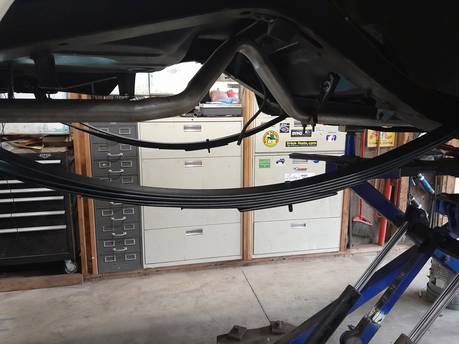

    We have been plucking away at this thing. Got the rear axle installed, and we have the brakes in the back almost plumbed. My wife has never flared limes before, so it was a bit of a learning curve.
    Also started working on the master cylinder and brake pedal. I was going to use the Jeep CJ5 master cylinder everyone else uses, but I'm not really happy with how far below the frame it sticks. Still exploring my options.
    We also got hoses in for the top, so started gathering all the parts back up. The drivers side bracket was broken off from the floor, so I started working on that tonight. I have it more or less prepped for welding. Interior is also pulled so we can paint the floor while it's apart.

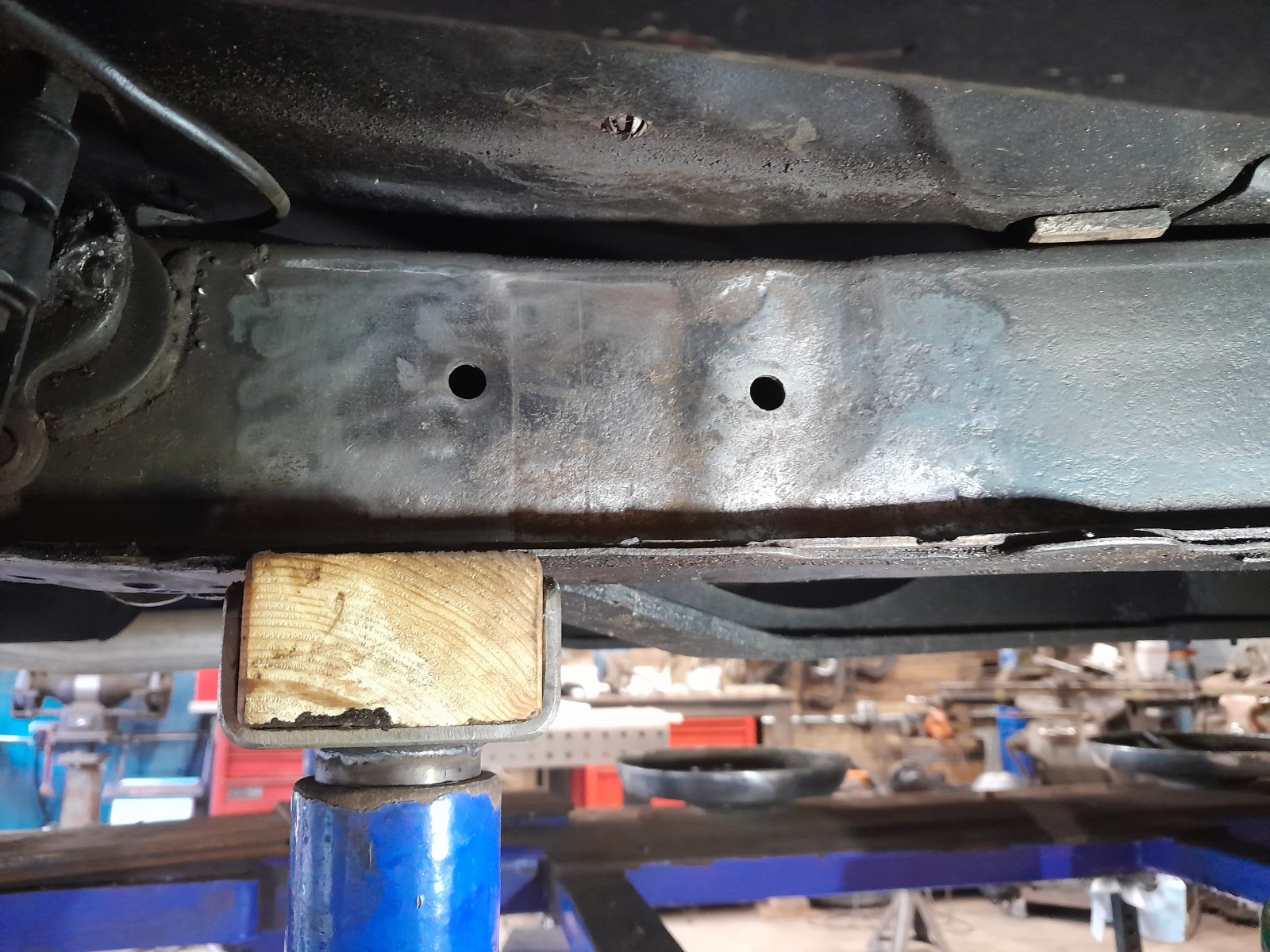

    Got the broken off bracket cleaned up and welded back in. It turned into a marriage building exercise when I had to have my wife run the pedal on the TIG to get into a couple tight corners. Could have MIG'ed it in, but I need more welding blankets before I do welding anywhere near this car.
    I gave both sides a multi color paint / undercoating job to make it look a little more original. Not that it matters since it will be covered up.

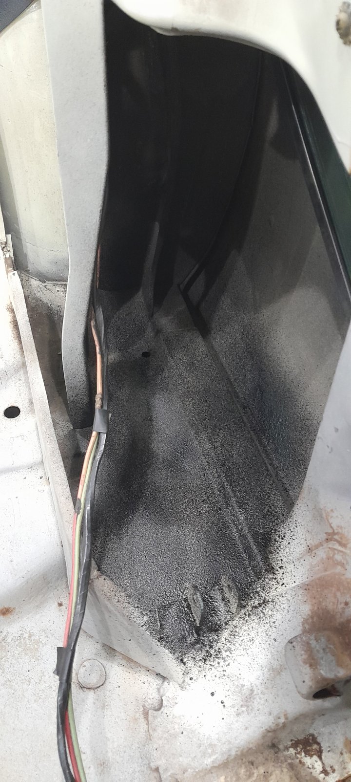

    Decided to go ahead and put the Napa POR15 equivalent in the "affected" areas and all tye low spots in the floor. I plan on top coating it with tan paint for now while we figure out a long term plan.
    bchctybob and Jacksmith like this.
  17. Rynothealbino
    Posts: 439
    Rynothealbino
    Well this went poorly already. Some of the product bubbled like crazy. It's stuck to the floor, but turned into expanding foam on the inside in these spots. I possibly put it on too thick, but this stuff is like tar compared to por15 and you have to work pretty fast. The fact the can was expired by 1.5 months probably did not help either.
    So my account is being credited, but now I have to at least partially strip this floor and decide how to proceed. Hoping to get something figured out before we fly out for Speed Week (fingers crossed) Saturday morning.

    Got back from our trip the other day. Didn't even make it out to Bonneville at all. I think the closest we came to seeing any action was watching the trains at Golden Spike National Historic park.
    Wire brushes and a needle scaler made relatively easy work of getting this stuff off of the floor. Made a huge mess though.
    Decided to go back to the basics and use Rustolium clean metal primer applied with a brush.
    Today after making a parts run for an OT project I masked everything off and got to painting. It took 4 different colors blended in, somewhat emulating the darker tan below the current off white, finishing up with some Ace hardware paint that came really close to matching the car. By the time seats go in, and a floor covering of some sort goes in I think it will took good.

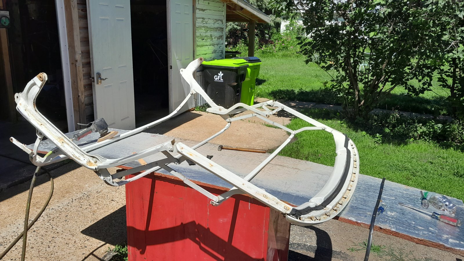

    We are also prepping the top frame for a coat of black paint. Not sure if this is correct or not, but we think it will look better. Especially if we ever spray the car a different color.

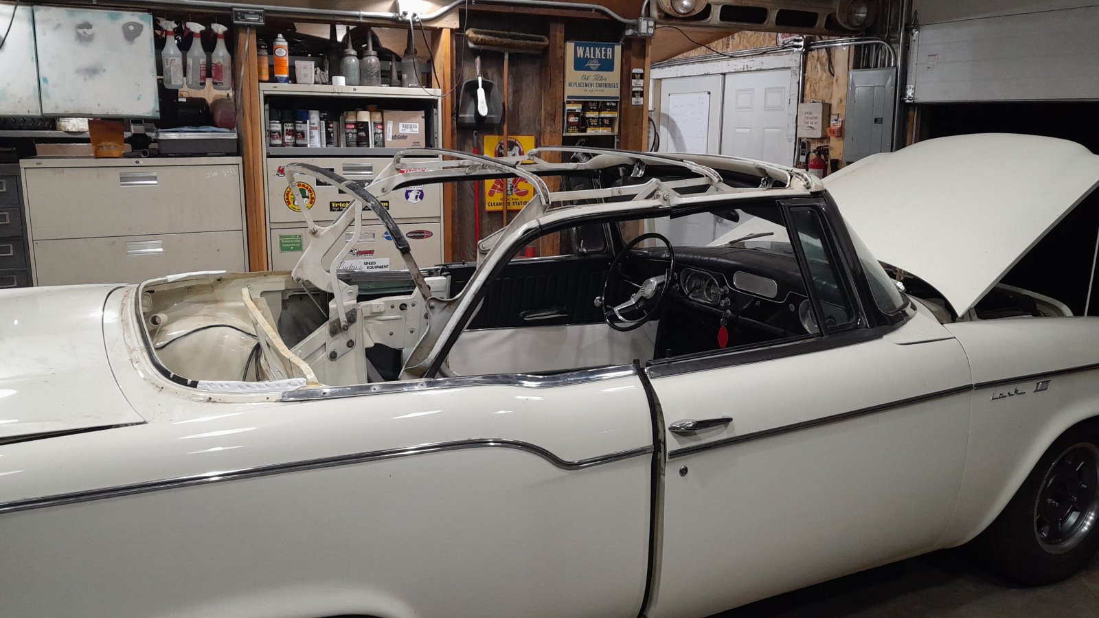

    Top frame has been painted and reinstalled onto the car.
    I need to do a 'final' door, top, and window adjustment but its basically ready for the new fabric.
    I also threw a temporary driveshaft in the car so at least I can load and unload the car using the clutch as a brake.

    Time for a long overdue update on the Lark. August was busy with the trip to Utah, but a trip to Indiana where we went to the Studebaker Museum made up for it a bit.
    September we went to Wisconsin for the 2023 Studebaker Drivers Club meet, so plenty of distractions, but we still made lots of progress.

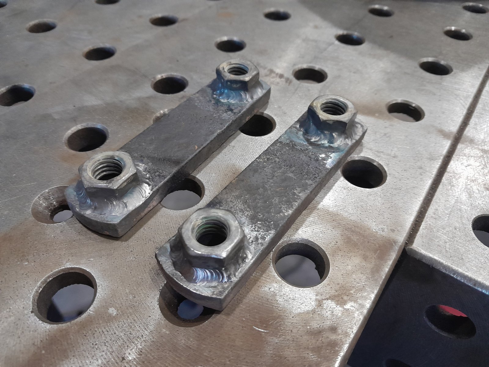

    Made my prototype brake master cylinder mount. I will probably make some changes on the next version, but it came out well overall.
    Note I tried to get the mount as low as possible to get the linkage running straightish (with the proper pedal ratio), but wanted to protect it, hence the skid plate-ish design that bolts to the bottom frame flange. Version 2 of this mount will have some refinements including bracing back to the pedal pivot ***embly like the factory one does.
