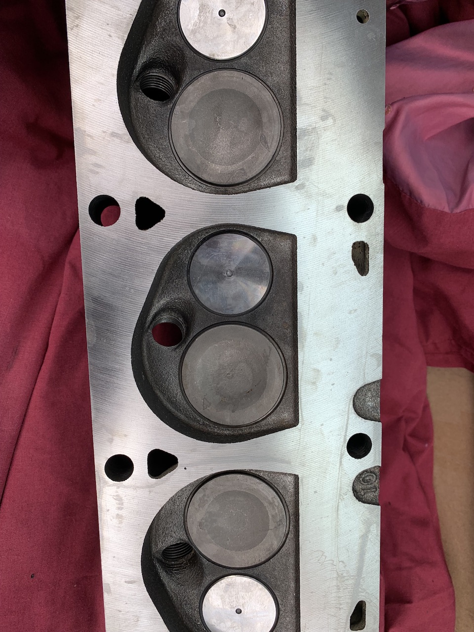

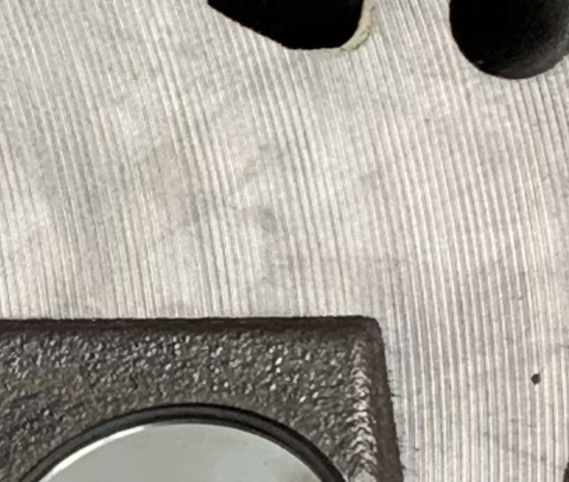

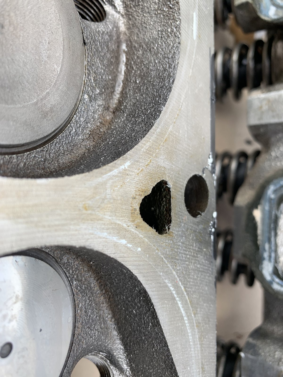

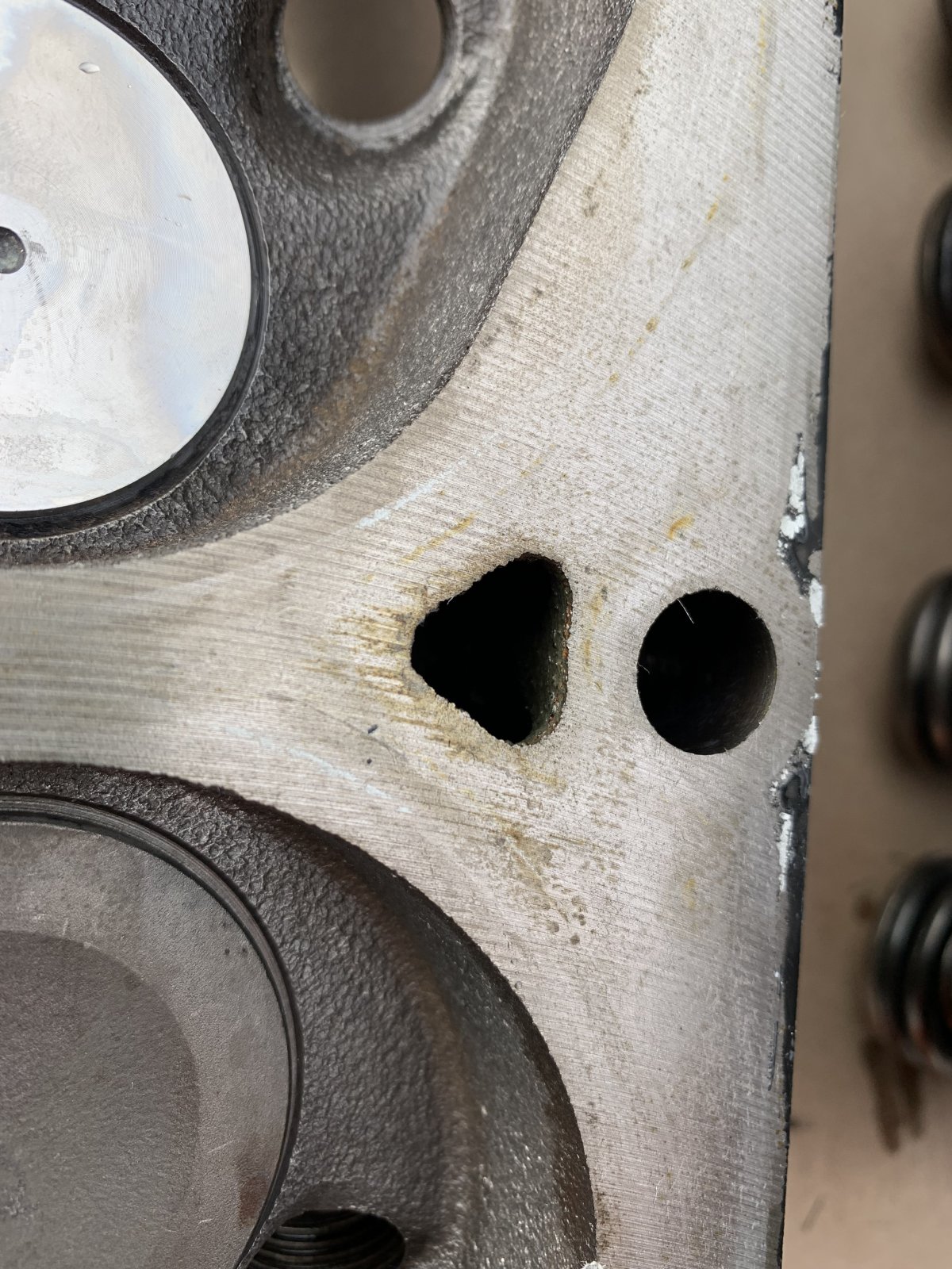

    I think the problem is those grooves are not only deep but have a very sharp point so can’t make a seal.
    I’ve dropped the heads back, the guy who did them isn’t in till Friday
  4. On a slightly positive take, at least it's only the head surface and not the block too.

    I guess so. I didn’t actually ask for the heads to be skimmed. They didn’t need it
  6. Well, that's not good then.

    They were done. That was the real reason I took the heads off. But when I took the valves out it needed guides so I asked for new guides and to skim the exhaust.
    The surface finish on the exhaust face is fine, so **** knows what they were doing with the head to block face. They’ve not actually agreed that anything is wrong yet though.

    If im not totally wrong informet, you need 60 or finer surface ra.
    Roughness average..
    With stamped steel gasket.
  11. Oneball
    Joined: Jul 30, 2023
    Posts: 1,631
    Oneball
    It’s nowhere near what you need for any sort of gasket. In 30 years of building engines I’ve never seen a mating face like that. The valleys are thousandths deep. You can’t run your fingernail over it.
  12. bobss396
    Joined: Aug 27, 2008
    Posts: 18,732
    bobss396
    That should be a lot smoother than that. Any head I have gotten back, I just run my biggest flat file over the surface and call it done. That is a speed and feed issue.

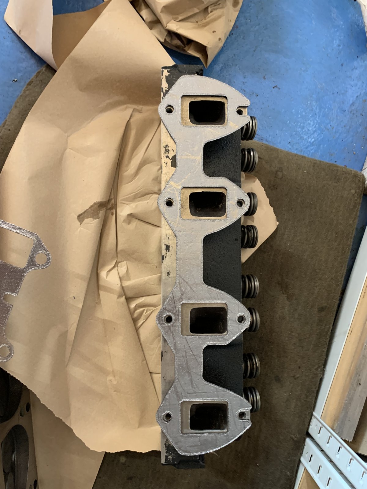

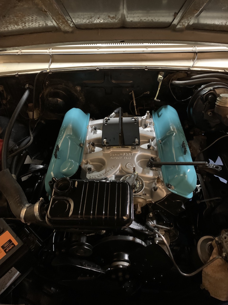

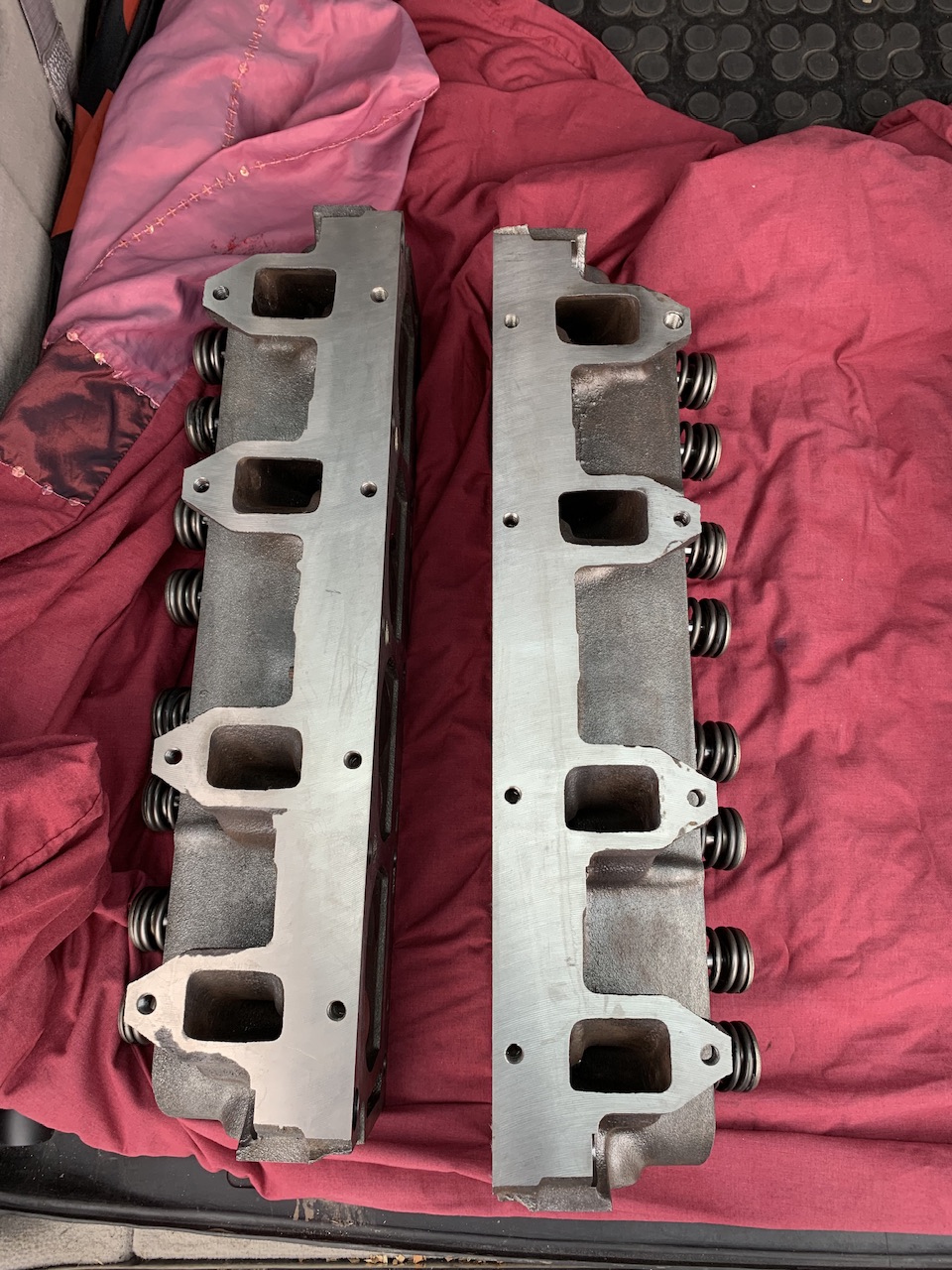

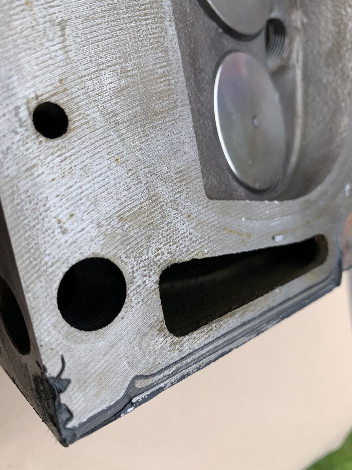

    Got the heads back from the shop and they’ve machined them again, much better.
    Heads back on and torqued
    I got some different exhaust gaskets from Remflex but they’re the wrong ones, so it will go back with the steel and graphite ones.

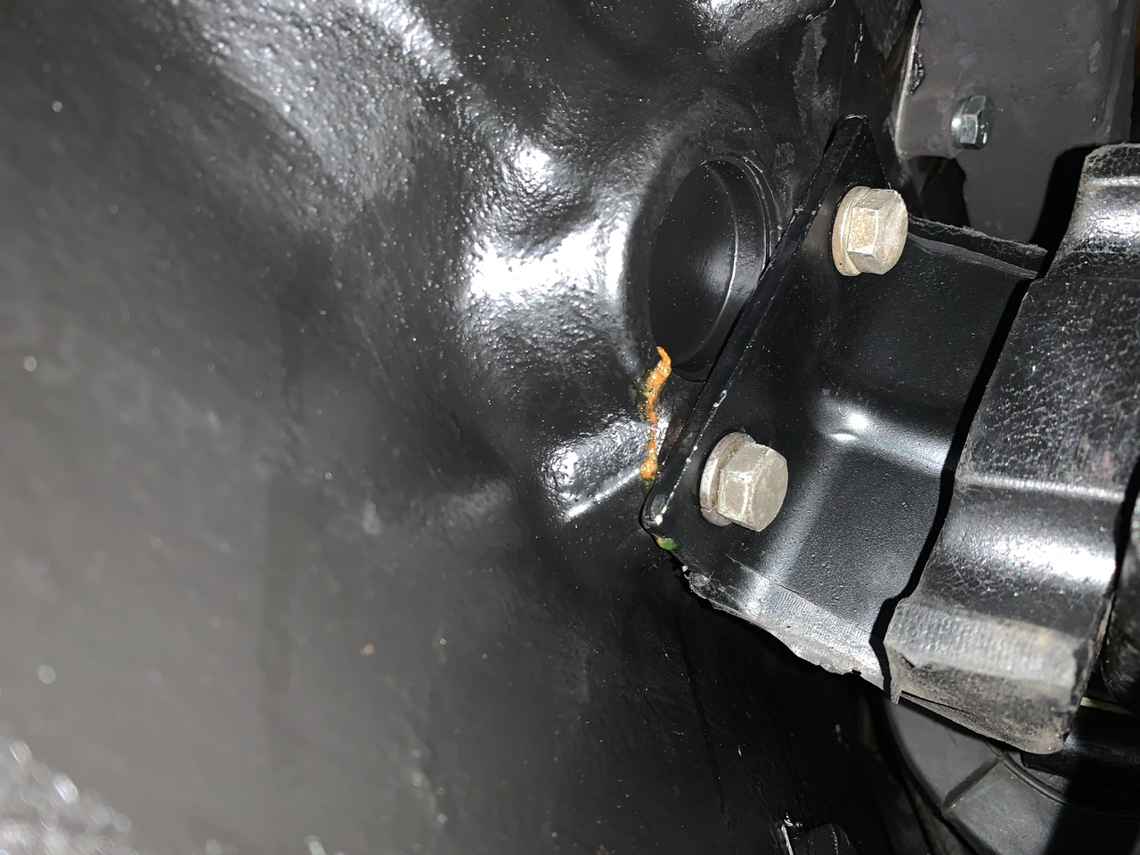

    Beer time, hope the China wall seal at the back is ok!

    I’m not 100% happy with the wall gasket at the rear so hopefully not going to be 3 times!

    Tim..I always use the Permatex material called the "Right Stuff" on the rear china wall... never using a Gasket.... I just let it seal up well for 24 hours.... I know this point is mute.. but Learned this the hard way as well.
    All looks awesome.
  19. bobss396
    Posts: 18,732
    bobss396
    The Right Stuff is the bomb. Word to the wiser than myself... mask off anything that will be visible after the fact. It is only slightly less offensive than POR15 in the wrong place... :eek:
    Oneball likes this.
  20. Oneball
    Posts: 1,631
    Oneball
    That’s how I’ve done it before, but went with sealant and a gasket this time. We’ll see.

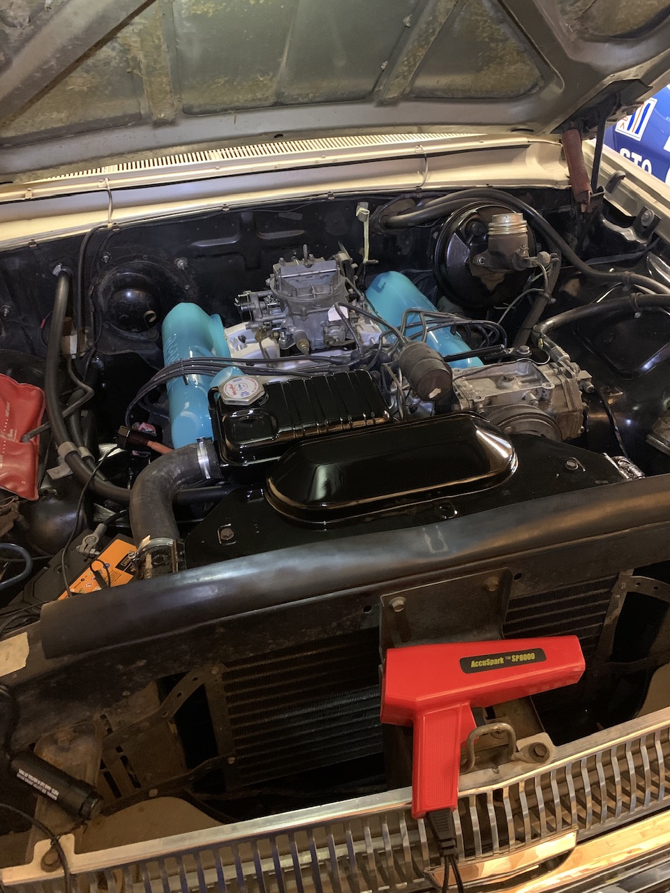

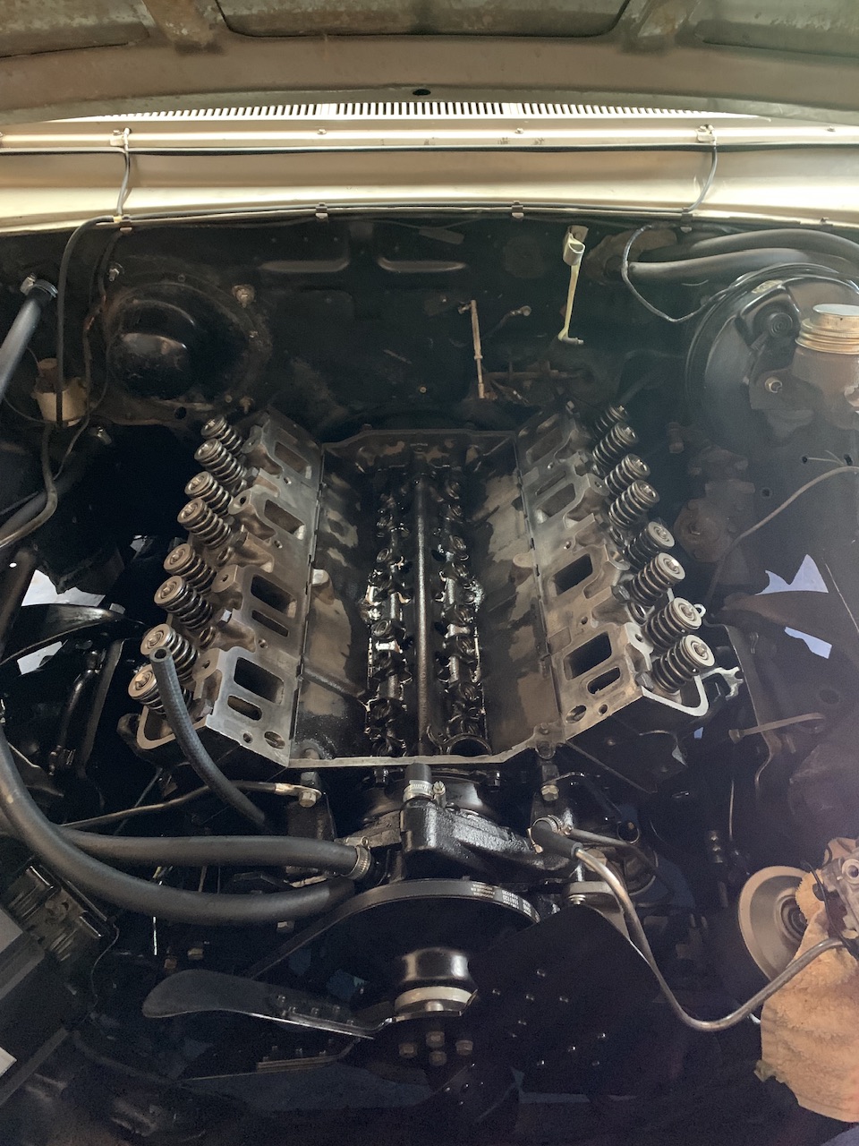

    It lives!
    Will try and link a vid at some point.

    Drivers side exhaust manifold gasket lasted about 10 minutes o_O

    Damn, one of those good news/bad news things. I am happy you got it running and bummed that you have repairs to make.
    Keep after it, you will be driving it soon!
    Oneball likes this.

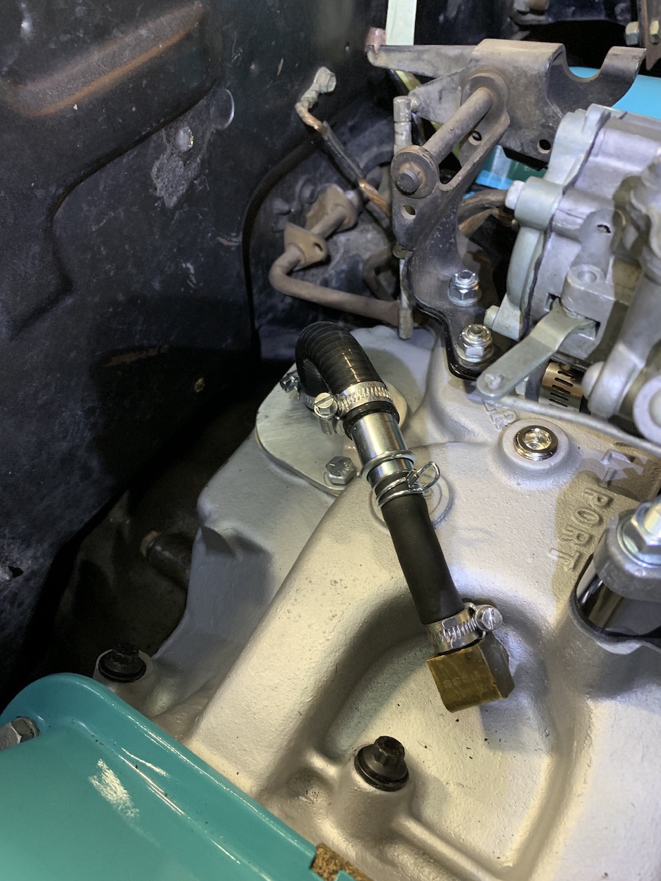

    Ordered some core plugs and got the PCV properly set up

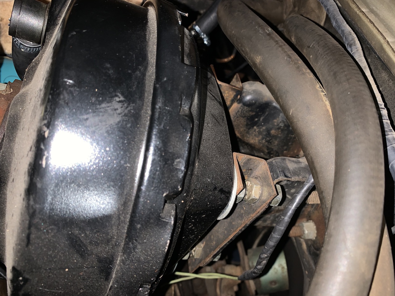

    Brake booster doesn’t work, pedal is rock hard and there’s air escaping when you press the pedal but not when it’s at rest, which I think means the byp*** valve has failed. It’s also a bit Heath Robinson. Don’t think this is how it left FoMoCo but it is a Ford booster, will have to dig into the parts book.
