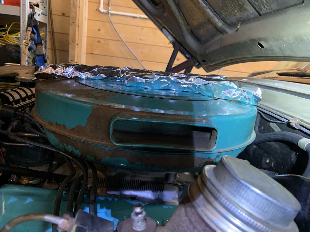

    Bonnet clears the air cleaner so can look at painting that.
    Brakes are still driving me nuts!
    Trying to work out a way to fix the grille badge. The tangs that hold the emblem in have broken. Maybe some epoxy putty

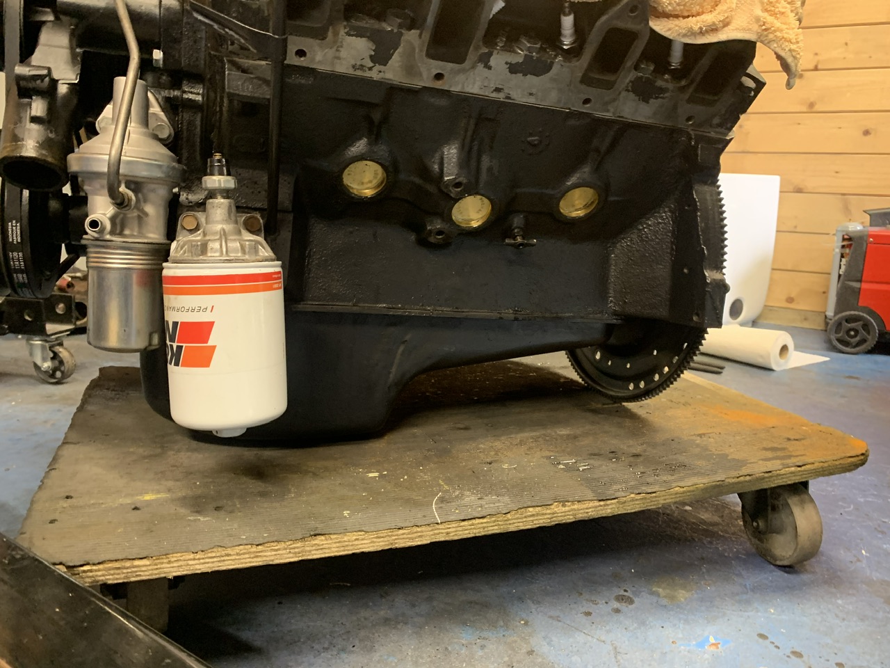

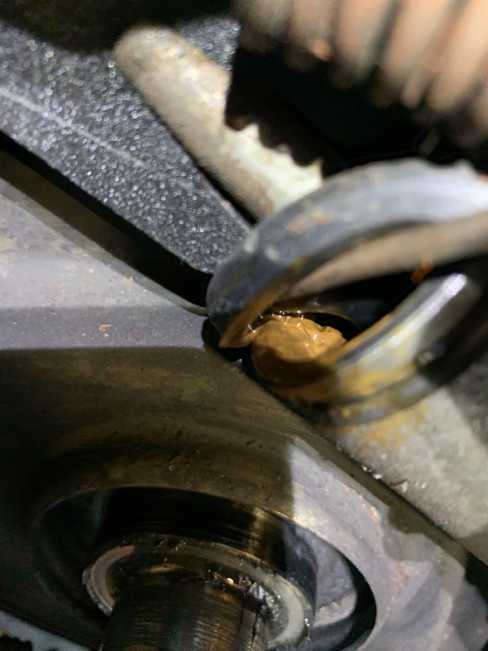

  6. Oneball
    Joined: Jul 30, 2023
    Posts: 1,631
    Oneball
    Double ********! I just can’t get the core plugs in with the engine in the car.

    I feel your pain, been there....
    If you pull the engine again, make sure you flush out the block while all the plugs are out. I got about 2 lbs of casting sand out of my FE coolant p***ages when I tore it down.

    Oneball
    I flushed out the block with a jet wash, that’s probably why it wasn’t leaking before but is now!
  10. Oneball
    Posts: 1,631
    Oneball
    Don’t think that’ll seal 1 39/64” hole where the core plug I’ve removed was. ;)

    bobss396
    Dorman makes expandable rubber plugs. I have used them in the past where pulling the engine was not an option.

    Oneball
    That’s a bit of a bodge. I’m going to pull the engine and do all six. Then they’re done.

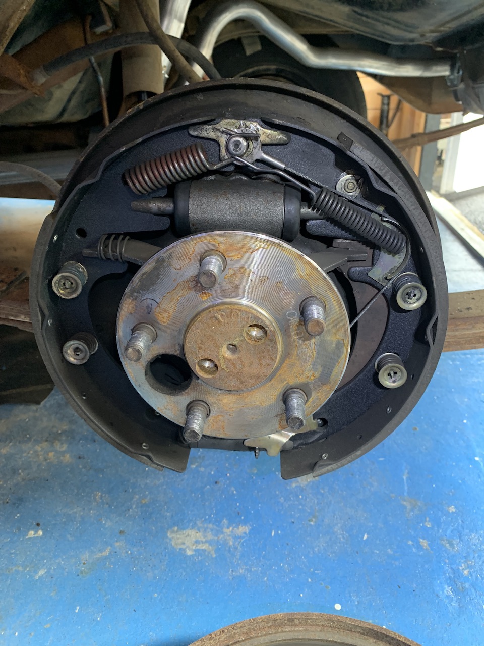

    Took a MIG to the manifold that leaks and got no 5 the same height as the rest. Bit of a bodge but not really got anything to lose.
    Brakes are all pretty new looking
    But the MC is a bit weepy and the front I looked at was full of rusty goo, so I think I’ll just order a full set and flexi and get it done.

    bobss396
    It never hurts to put a new master on an old car especially if you see something funky with it. Peek behind the WC cups if it is still apart.

    Oneball
    I’ve ordered a MC along with the slaves, didn’t seem much point not doing it for £40, I’m probably going to have to disconnect it anyway to change the booster.

    bobss396
    IIRC, the front wheel cylinder bores on those were something like 1 3/32" (1.093"). The rears were more standard. If you can find the kits, they are a breeze to rebuild.

    Oneball
    A new wheel cylinder was 2 quid more than a repair kit. Didn’t seem worth the effort in rebuilding them.

    bobss396
    I had a ton of leftover cups and springs from my brake days, I'm down to very few of them left and finally tossed them all out. The Fords of the era were unique, as is the front WC attachment, you'll see.
    I bought rear cylinders from Rock Auto, the kits were around $3 more. Made in China of course. I took them apart, looked them over and re***embled them.
    Oneball likes this.
