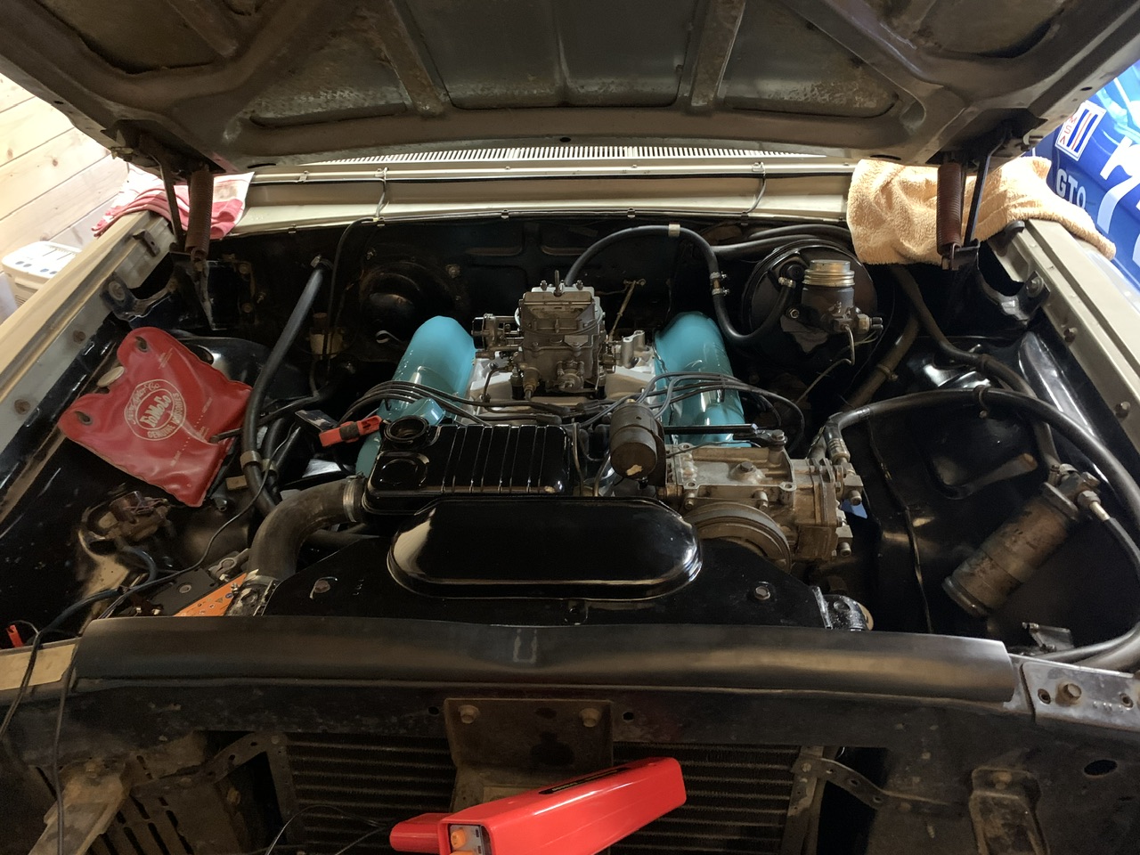

    Got it back up and running today. P***enger size exhaust down pipe flange is leaking unfortunately so might have to get that off.
    Idles reasonably well at 500rpm, but the mixture screws are a bit too far in for my liking and it’ll back fire through the carb if you aggressively blip the throttle. It’s wet round the top cover gasket so maybe the floats aren’t right. I’ll have a look at that when it’s cold. Drives backwards and forwards though!

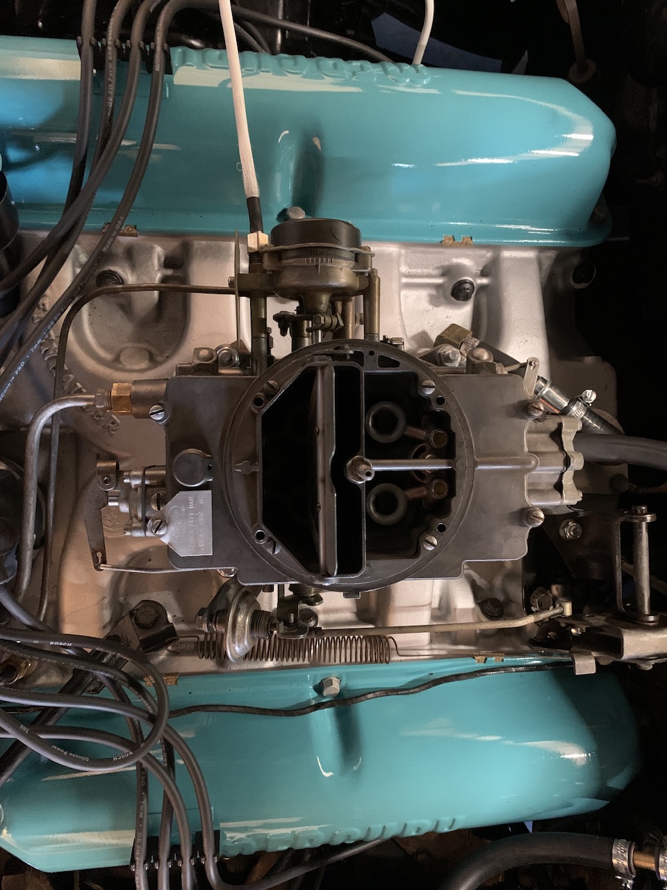

    Got it running reasonably well now, little adjustment to floats, mixture and timing, got it set at 36 max mech advance which goes to 11 at idle. No more popping when you blip the throttle. Guess it was just the sum of everything bring slightly off.

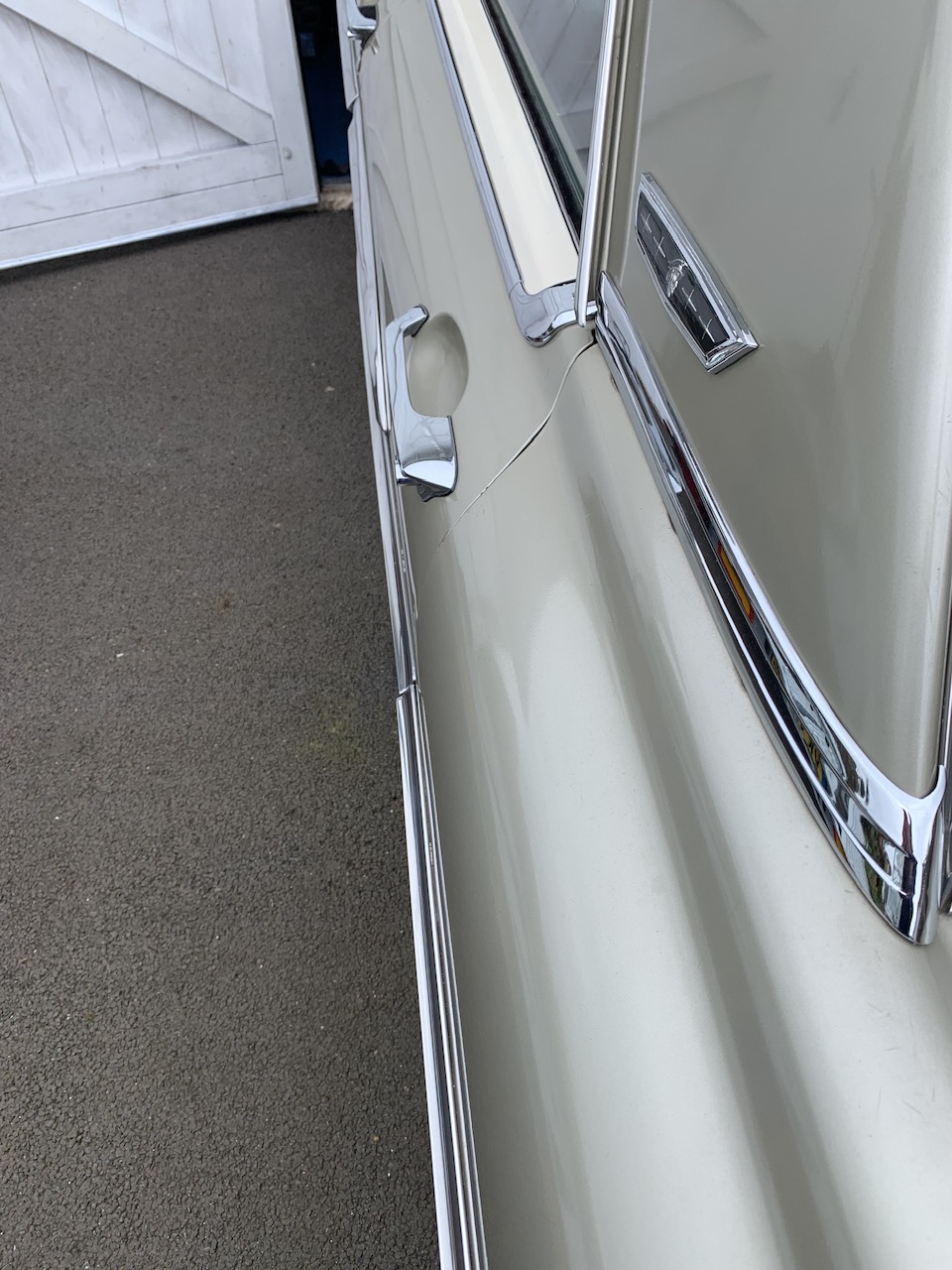

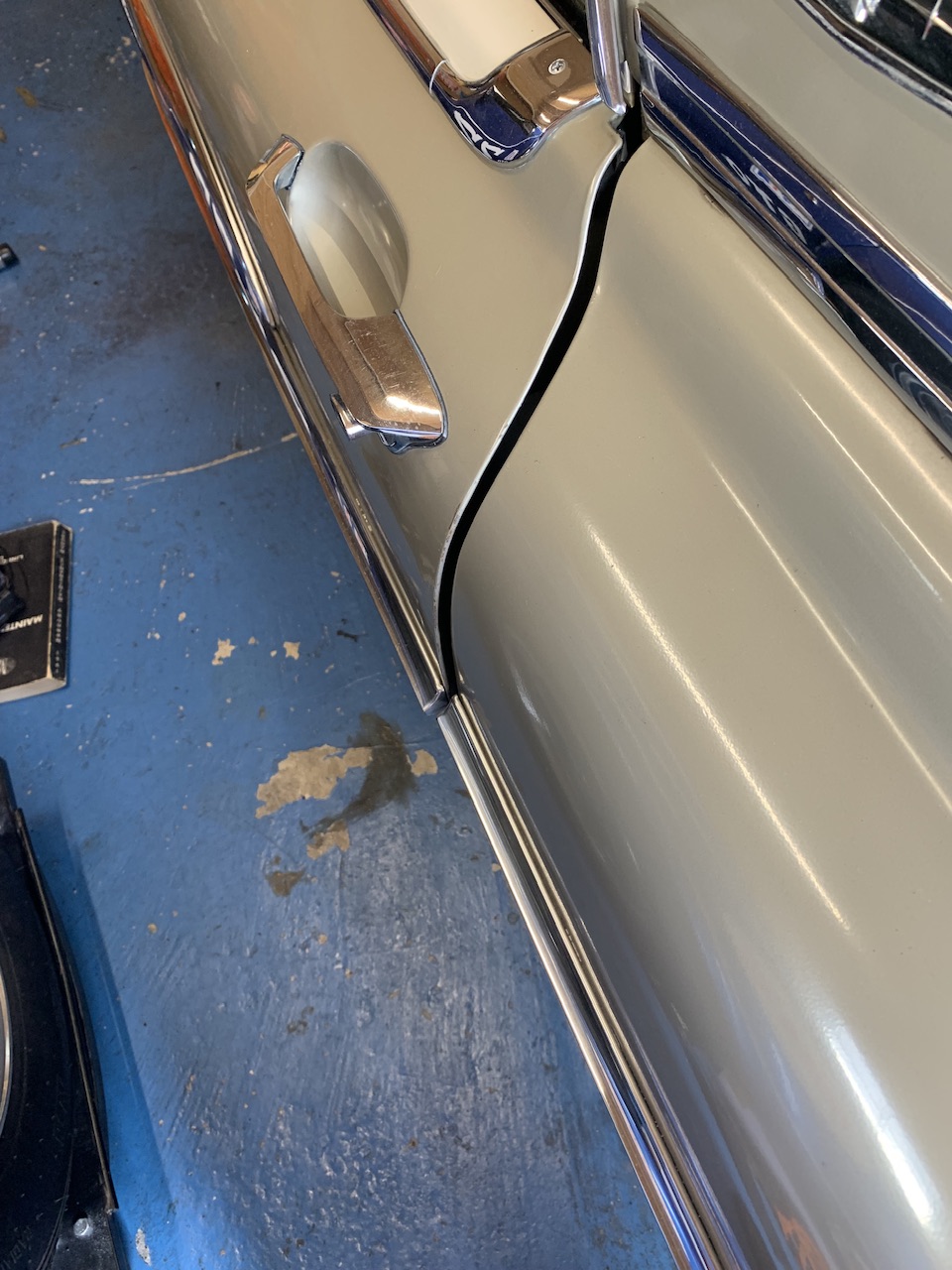

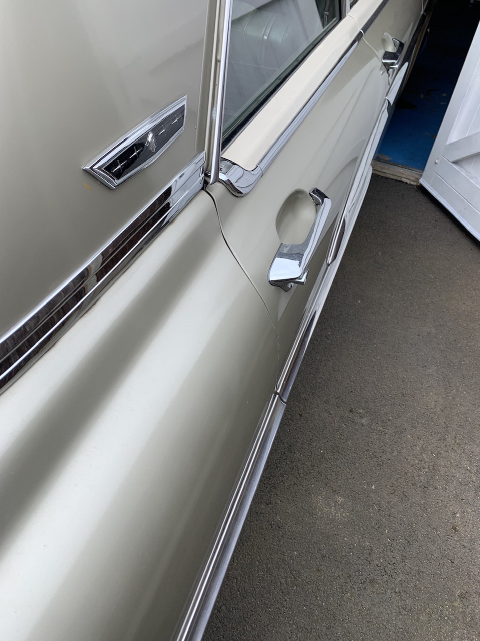

    For some reason both rear doors don’t close into the second latch, seems odd that it’s the two but hopefully just needs the striker plate adjusting.

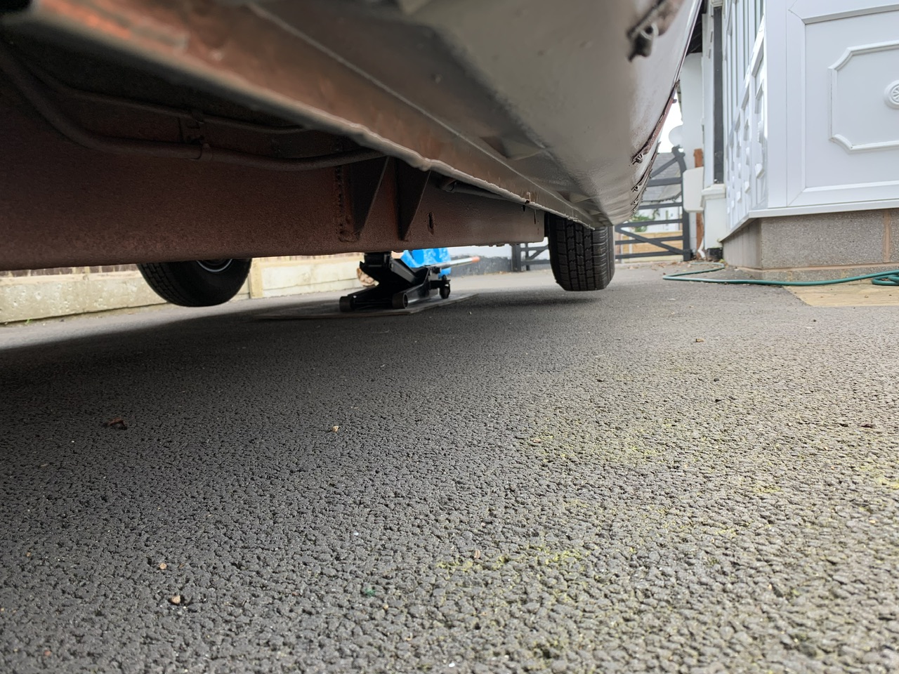

    Thanks Steve. It’s the extra space in the wheel well I’m trying to hide, it’s kinda got that Jag E-type riding on stilts look at the moment. I’ve got some 15x7 slot mags for it

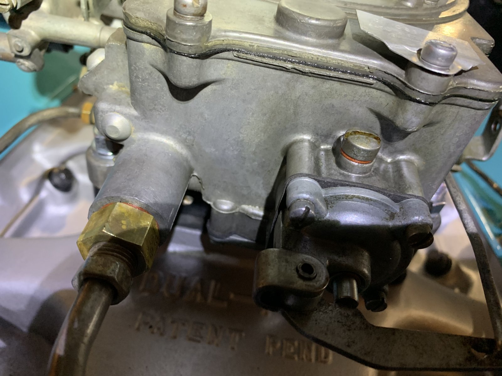

    I might try the original type choke, I think from the two carbs I’ve got I can put together a complete mechanism, just need the tube to the manifold.
    Truckdoctor Andy likes this.
  16. Pontmerc
    Joined: Jul 13, 2013
    Posts: 447
    Pontmerc
    from Finland
    There are two tubes.one takes fresh filtered air from air cleaner.

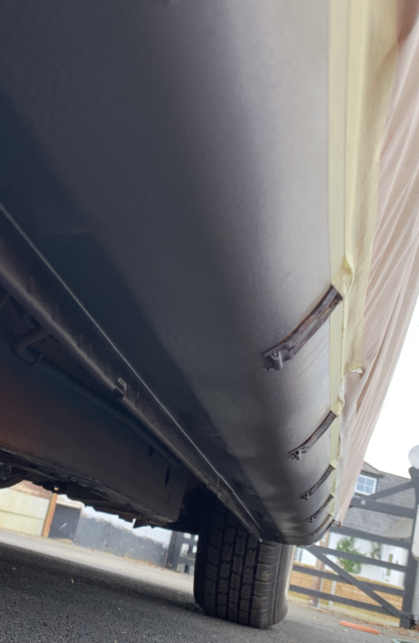

    Rear door strikers adjusted and they now close properly, cleaned up the sills ready to put some stone chip on when it stops raining, they’re not rusty as such but dirt roads have taken their toll on the paint.

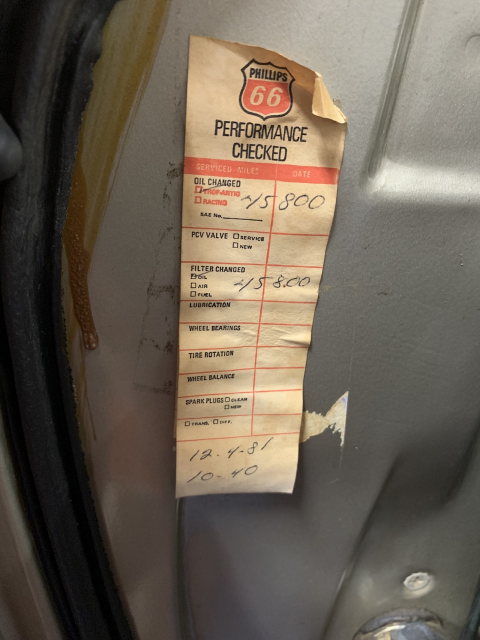

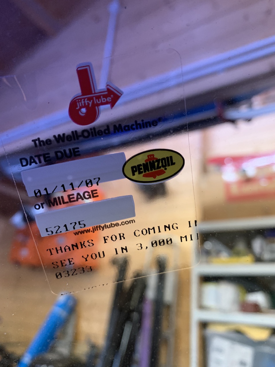

    Noticed this oil change sticker in the door
    So in 1981 it’d done 45k
    2007 it’d done 49k and now it’s on 50k

    Could the choke heat tube in the exhaust manifold (where you can't see it) possibly be plugged? Especially since the short fresh air tube doesn't seem to provide any filtering. Can you tell if the choke heat p***age that is hidden in the manifold is just a "U" shaped tube, or is that p***age something that was cast into the manifold?
  22. Oneball
    Joined: Jul 30, 2023
    Posts: 1,631
    Oneball
    I believe there’s some fins cast underneath that plate, when a replacement pipe turns up I’ll get the manifold off and remove the plate and see what’s going on. The pipe had been cross threaded anyway so it was no good. It’ll also give me a chance to fix the leak between manifold and down pipe.

    Cleaned, primered and stone chipped the sills, a few decades of dirt roads had sand blasted the paint off them, just waiting for the stonechip to dry before putting some Castilian Gold on.

    Base and clear on the sills.

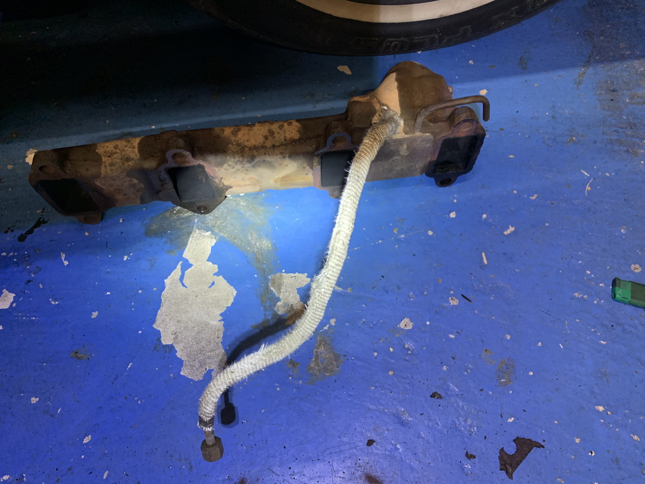

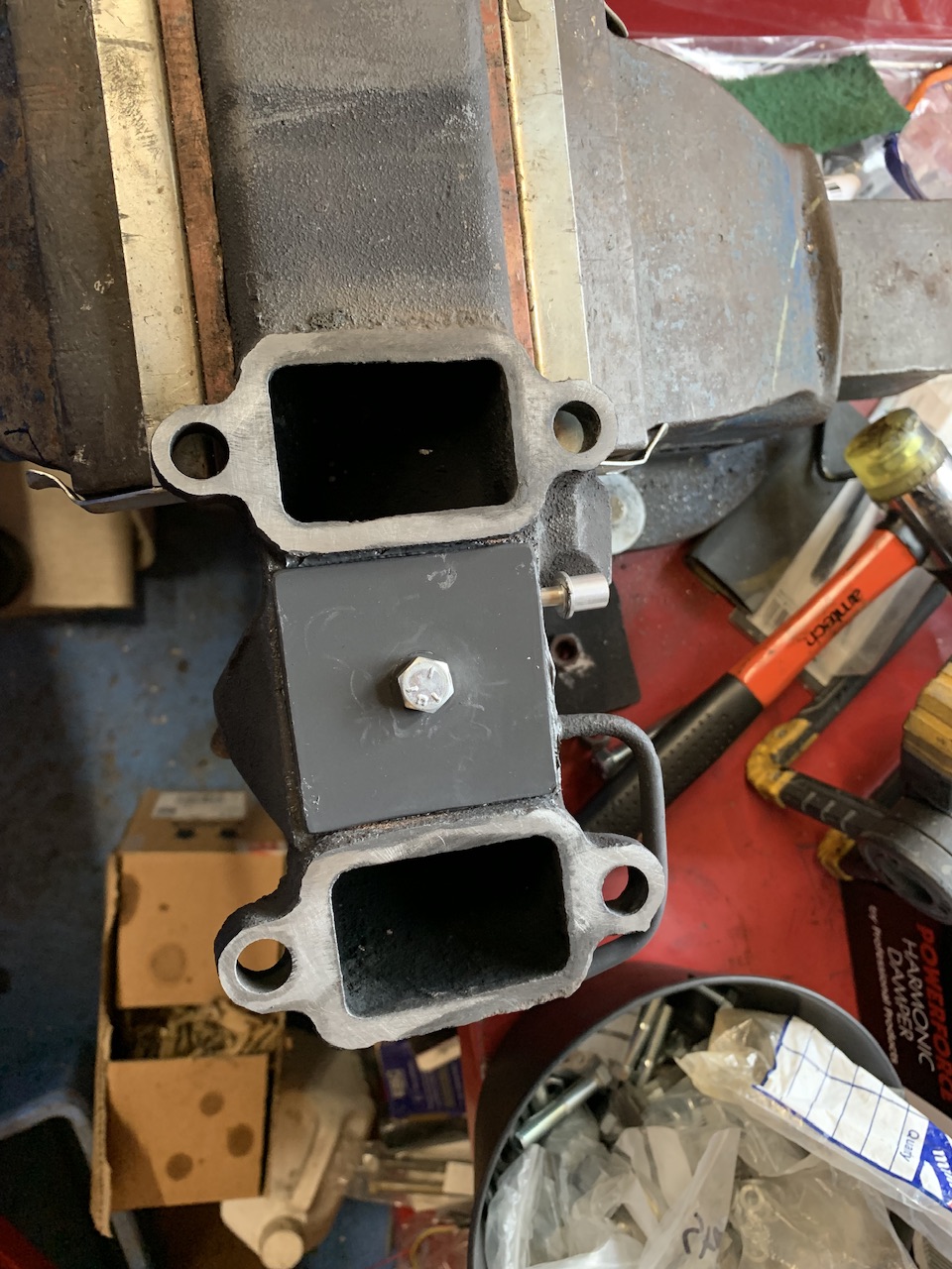

    Back from a weekends racing, one HAMB friendly pic

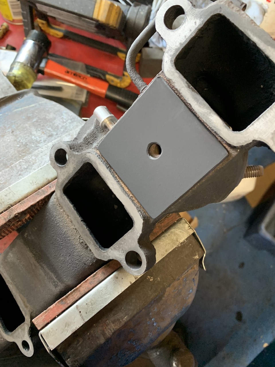

    Set about re-instating the choke heater, got the exhaust manifold off and ground the bolt of the plate, the gasket had disintegrated explains why it was blocked. IMG_7064.jpeg
    Cleaned up
    made a replacement plate

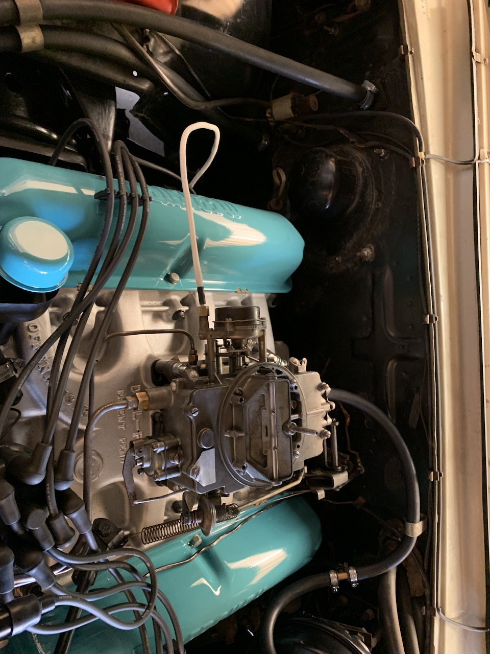

    Manifold back on and new pipe installed, not 100% happy with the routing but didn’t want to shorten the pipe to start with and find it didn’t reach.
    Will have to wait for the sealant to go off before trying it tomorrow
  27. Oneball
    Posts: 1,631
    Oneball
    Choke works! Will sort the tube out now so it’s a bit neater
