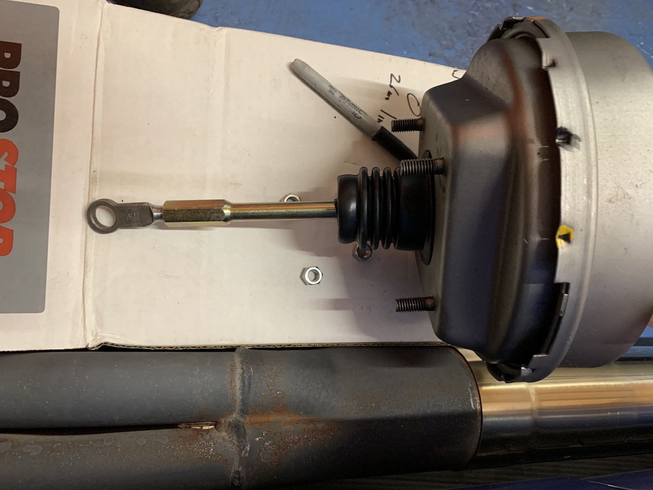

    Got the old master cylinder and servo off and the “adapter” bracketry
    New servo fixed into the factory mounts
    Think I can cut, turn down slightly and thread the fixed push rod off the old servo, so might have a go at that tomorrow if not I’ll get a Rose joint the right thread.
  5. Oneball
    Joined: Jul 30, 2023
    Posts: 1,632
    Oneball
    Unfortunately I’ve not got a 7/16-20 nut so need to get a jamb nut then I can fit the new booster and start on the brake cylinders.

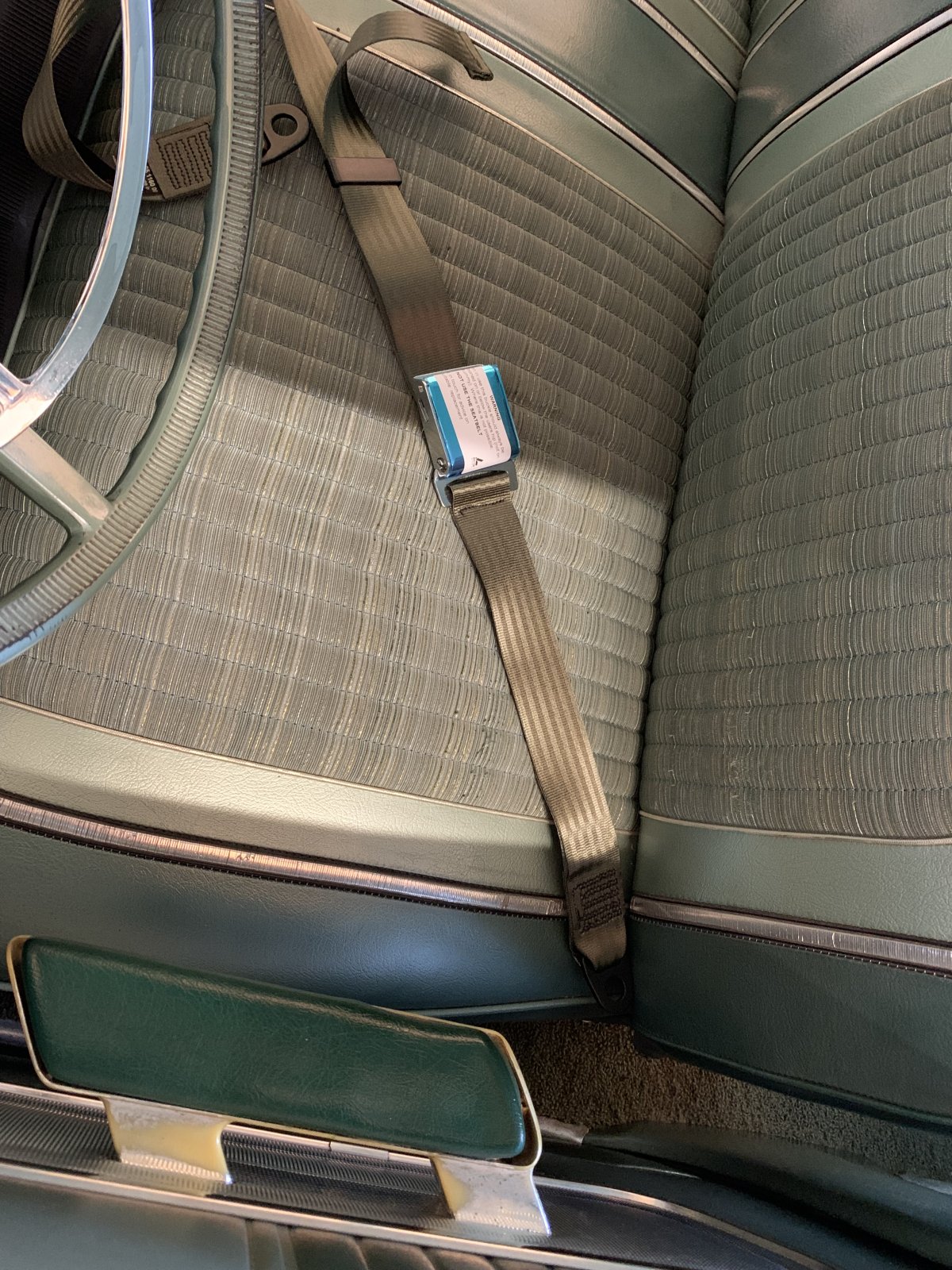

    Seatbelts arrived, think they’re a good colour.

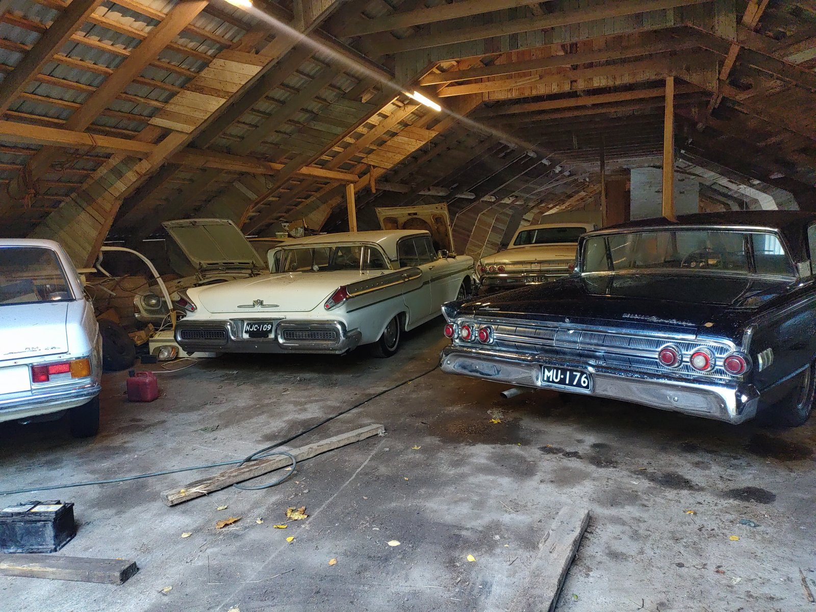

    You cant go wrong for owning a mercury. IMG_20220927_193201.jpg IMG_20221006_161537.jpg

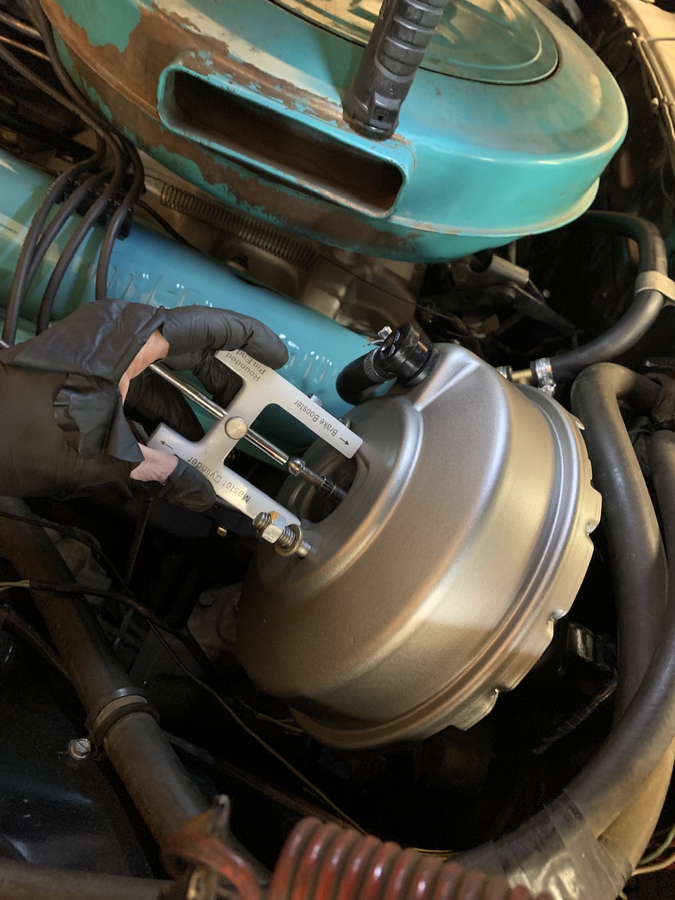

    Finished painting underneath and moved on to brakes.
    Booster in place and set up
    Attached to the pedal
    Master cylinder on, all Ford factory stuff and not a bodged bracket or half dozen washers in sight.
    Just need to find what I’ve done with the brake light switch o_O

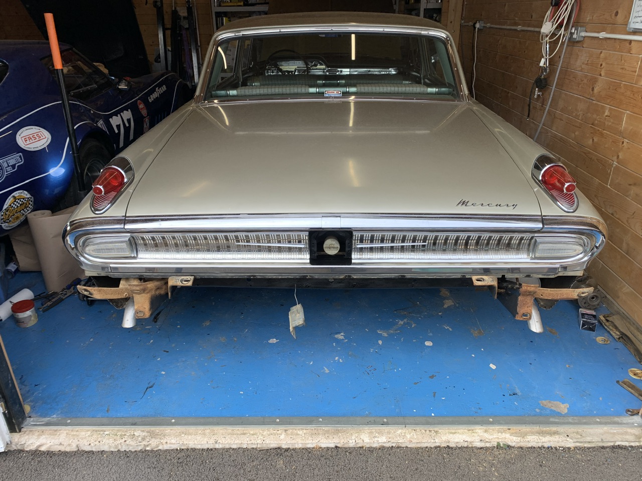

    Got the rear bumper off so I can paint the irons and inside of the bumper.

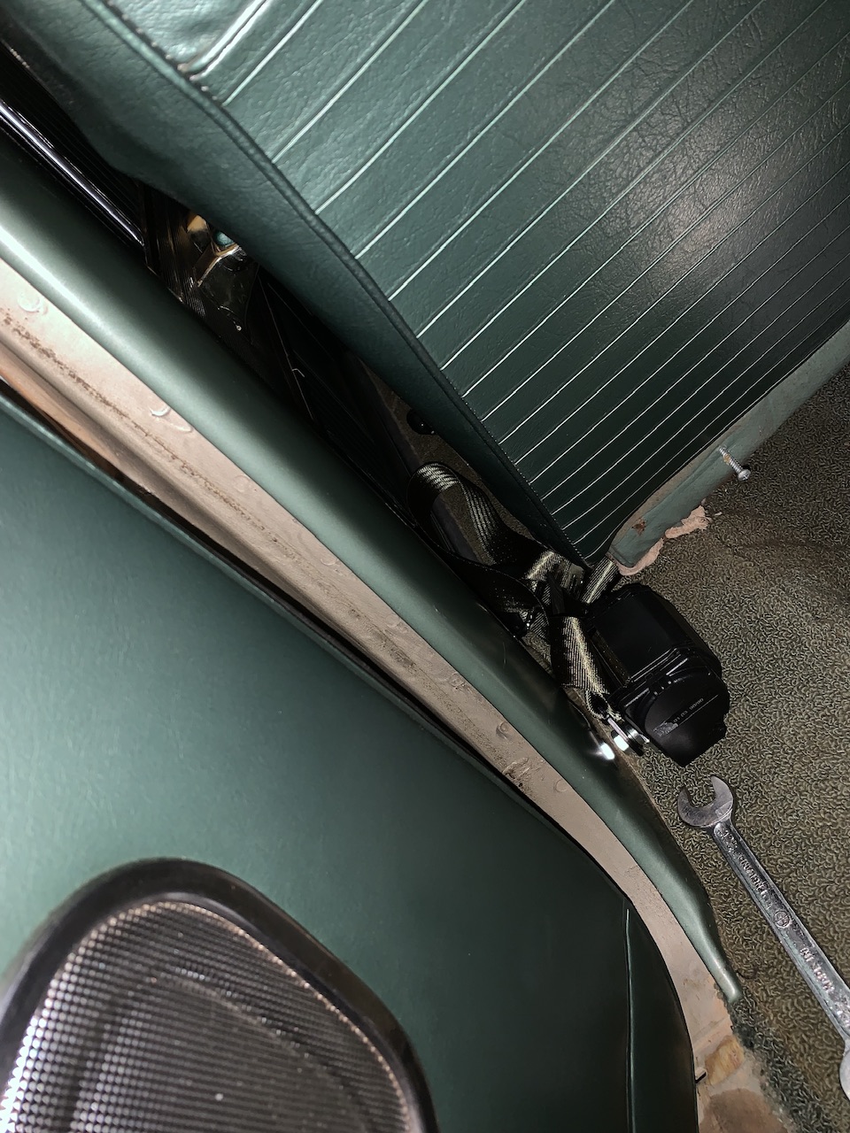

  26. Oneball
    Posts: 1,632
    Oneball
    Belts bolted in
    and one of the front retractor units.

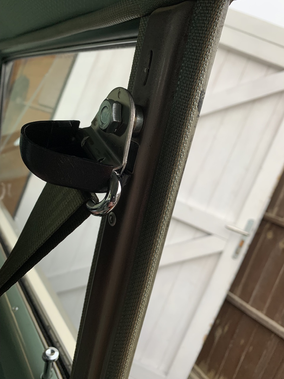

    Made up some inserts to allow me to bolt the top of the front belts into the b pillar
    Then threaded them up through the bottom of the pillar and riveted in place
    Front and rear belts now in
    Just need to do the scary bit and put a hole in the b pillar trim!!

    I had to measure my pillar garnish a bunch of times. I put a small hole in it first and eyeballed it before going full size. The plate and cover do a good job covering it up.
