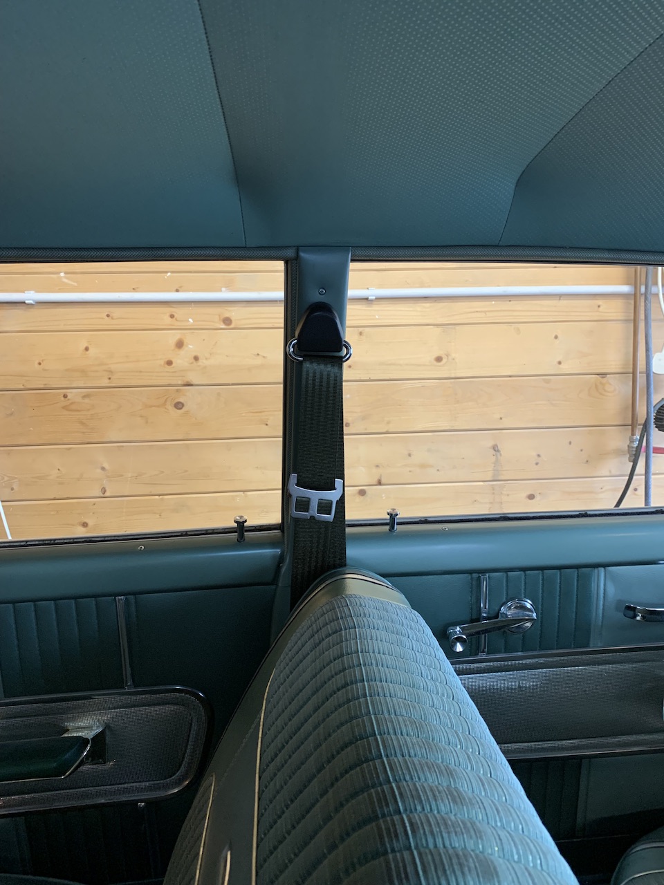

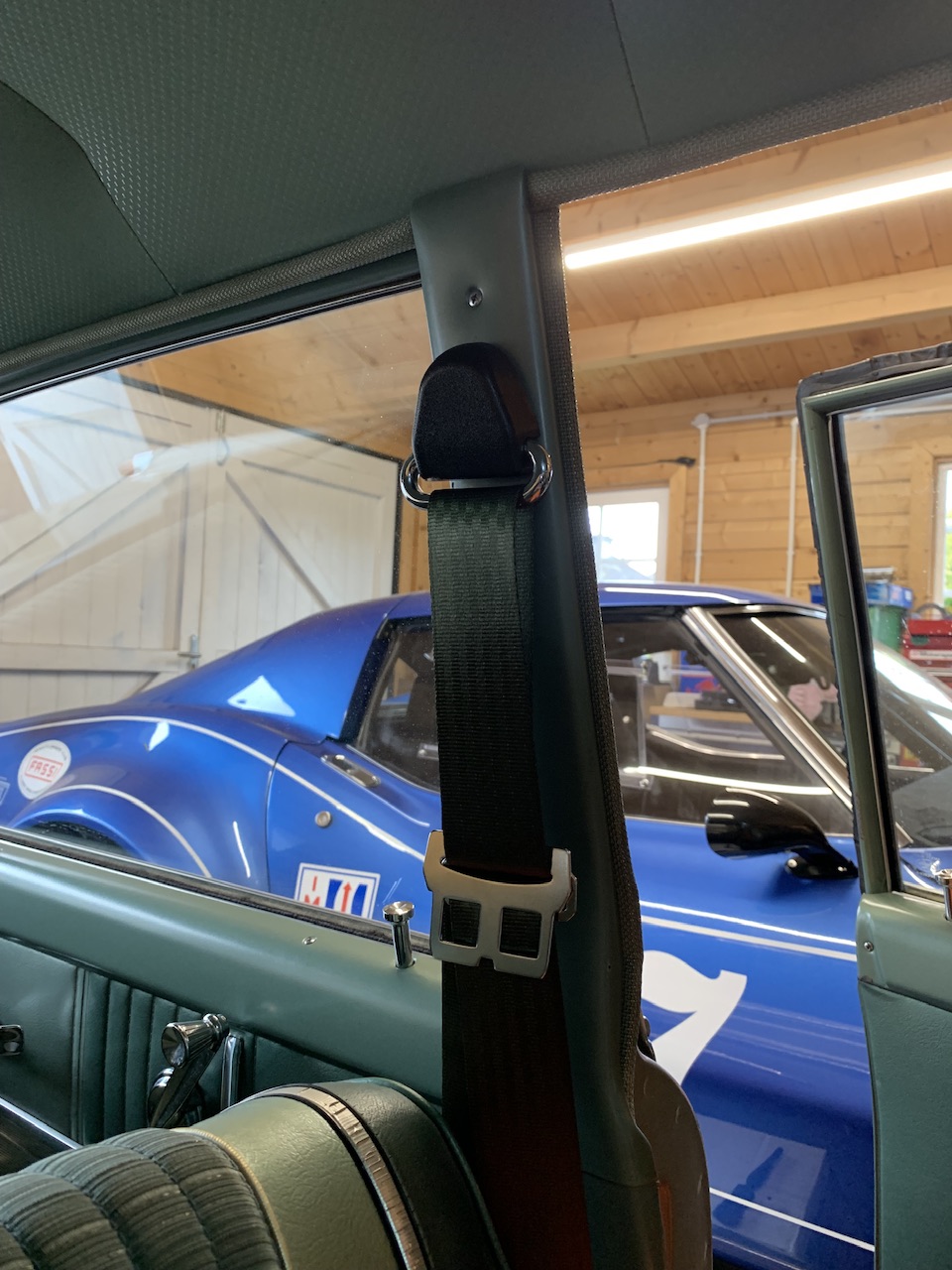

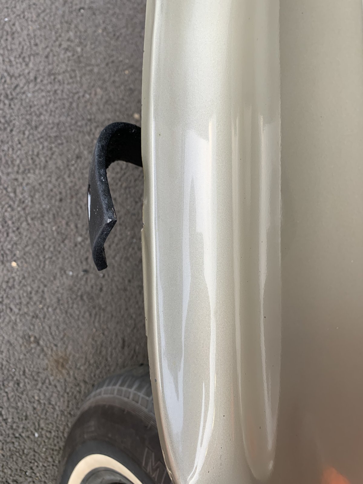

    With my pillar garnish, I took an old bolt cut off the head and turned a point on one end. Threaded it into the mounting hole with the pointed end sticking out. Laid the garnish in place, tapped it with a mallet and I had the hole location.
    Oneball and Truckdoctor Andy like this.
  4. Oneball
    Joined: Jul 30, 2023
    Posts: 1,631
    Oneball
    I put some masking tape on the pillar then screwed the trim on and marked the hole. Took the tape off and put on the front of the trim, locating it with the screws. Then drilled the hole.

    Hey if it works, it works. My pillar bolt had a large shoulder on it, so I drilled a pilot hole and had to use my mill to open the hole to the final size, it was around 5/8" or 16mm-ish.

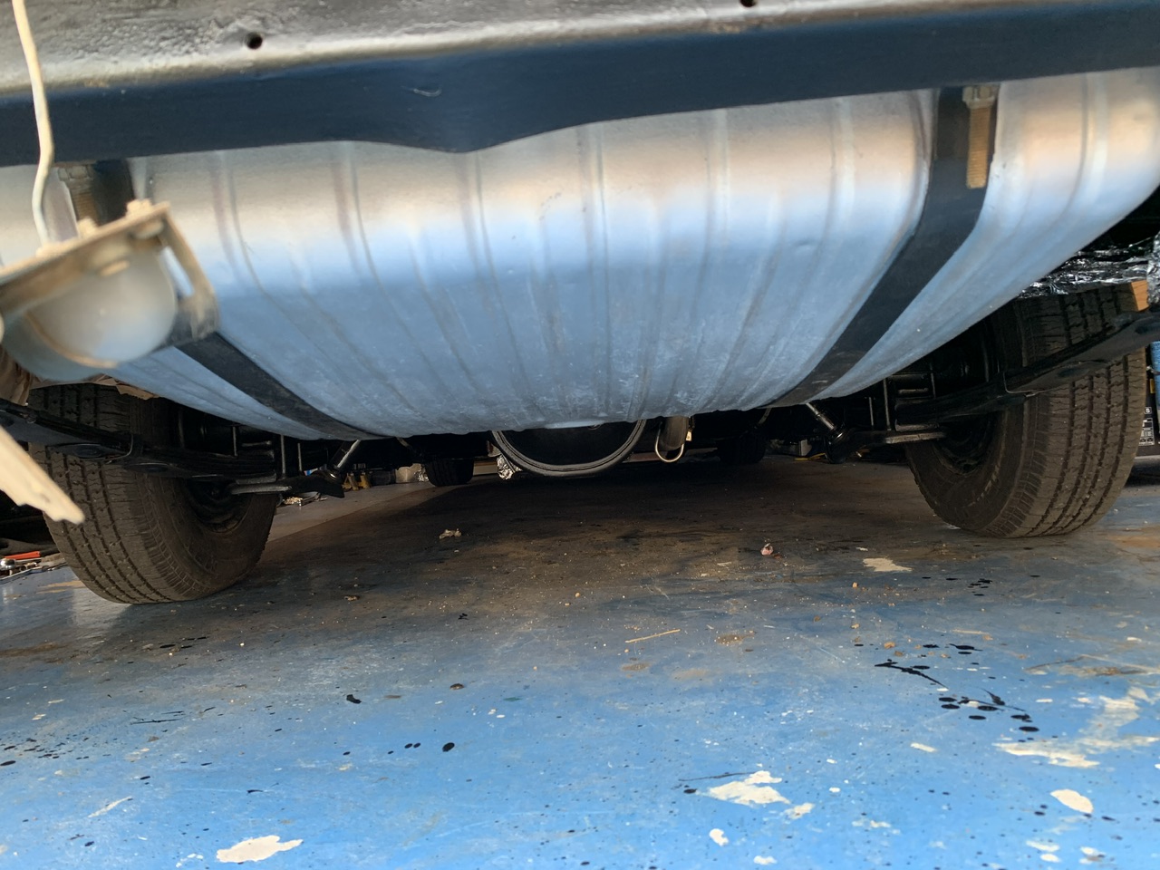

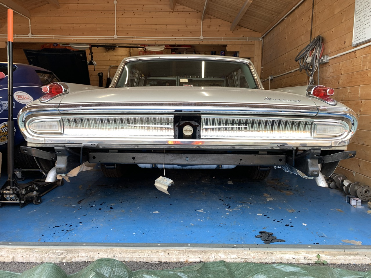

    Bumper irons and inside of the ch***is rails painted
    Painted the tank
    And made a list of things to do before I can have a proper drive. IMG_7566.jpeg
  7. Oneball
    Posts: 1,631
    Oneball
    Paint polishes up better than I expected
  8. Oneball
    Posts: 1,631
    Oneball
    Bumpers back on, needs the stainless lower trim putting back on and a good clean, then it’s just a case of sorting the carb

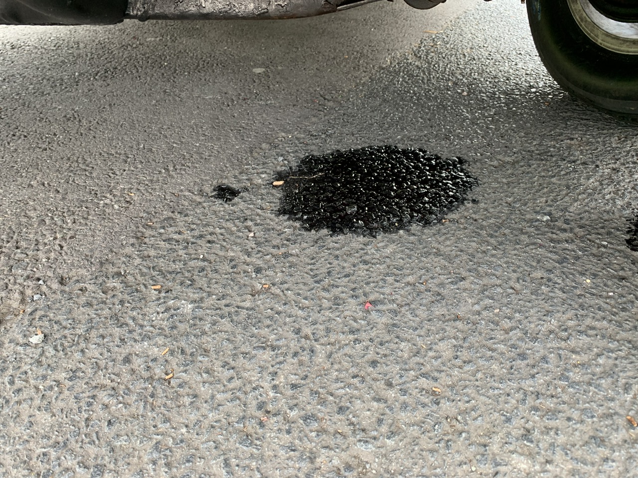

    Power steering pump went pop!
  14. ClayMart
    Joined: Oct 26, 2007
    Posts: 7,792
    ClayMart
    Was it a hose failure? Pressure side or the return hose?
    Have a fun weekend at the races. Good luck. Knock 'em stiff!
    Oneball likes this.
  15. Oneball
    Posts: 1,631
    Oneball
    No, it’s coming from the front seal, either it’s popped out or the bearing has failed completely

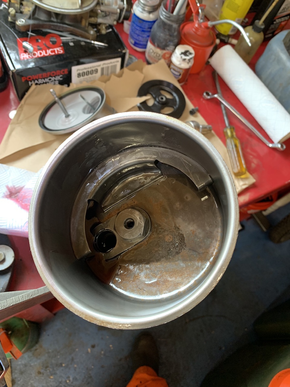

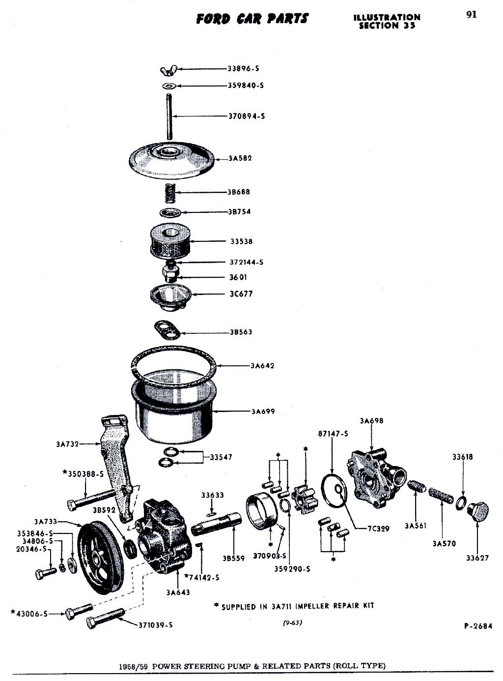

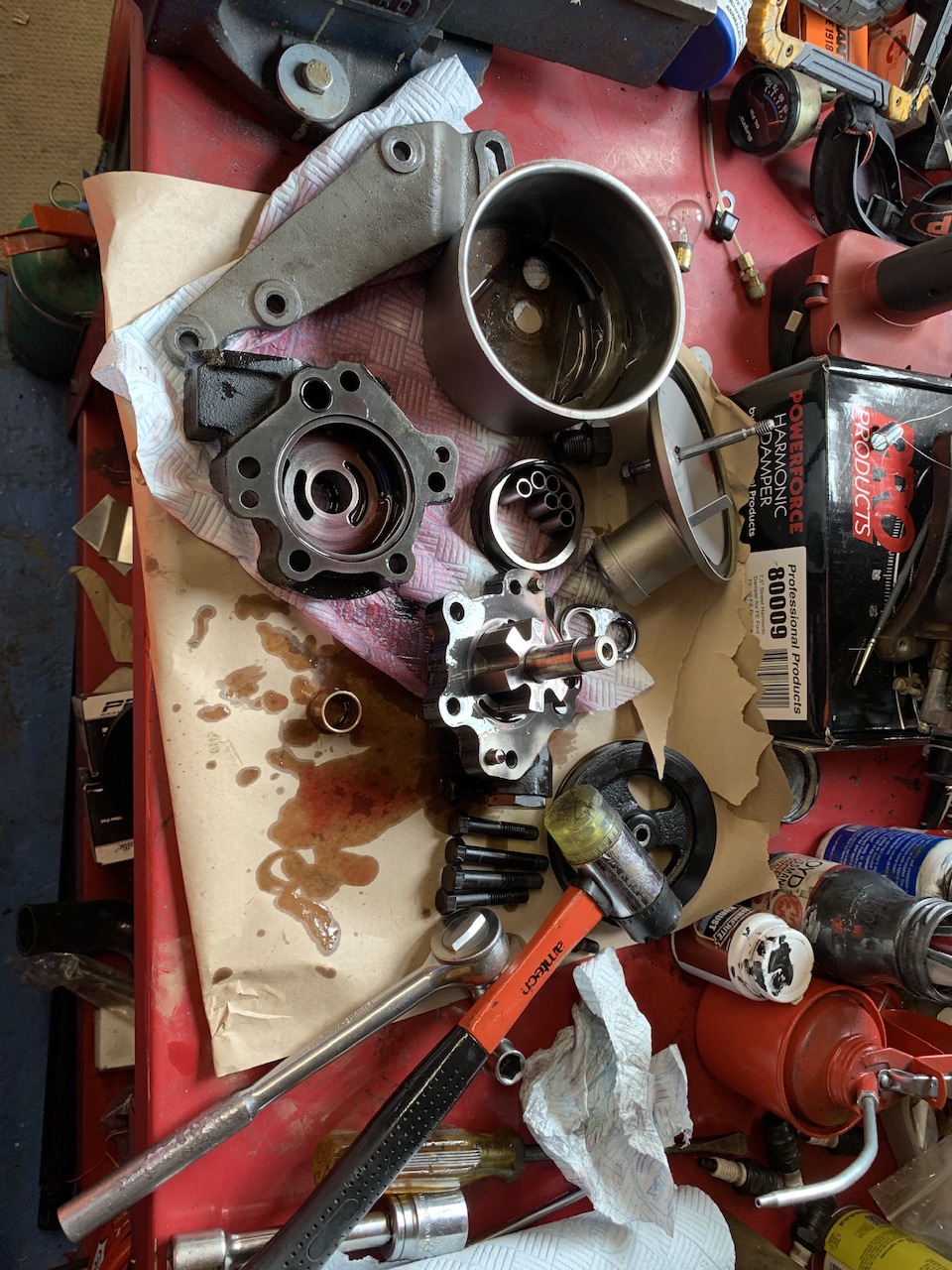

    Pump the off and the front bush is really sloppy, it was rebuilt not long ago but before my ownership. There’s a lot of debris in there too, some quite large chunks. IMG_7711.jpeg
    Isn’t there supposed to be a big round filter in here?
    guthriesmith and bobss396 like this.
  26. Oneball
    Posts: 1,631
    Oneball
    Looks like there’s a bunch of stuff missing from inside the reservoir IMG_7713.jpeg
    Algoma56 and guthriesmith like this.
  27. Most people don’t know about power steering filters, but pretty standard on Lorries. (Trucks).
    Algoma56, guthriesmith and Oneball like this.
  28. Oneball
    Posts: 1,631
    Oneball

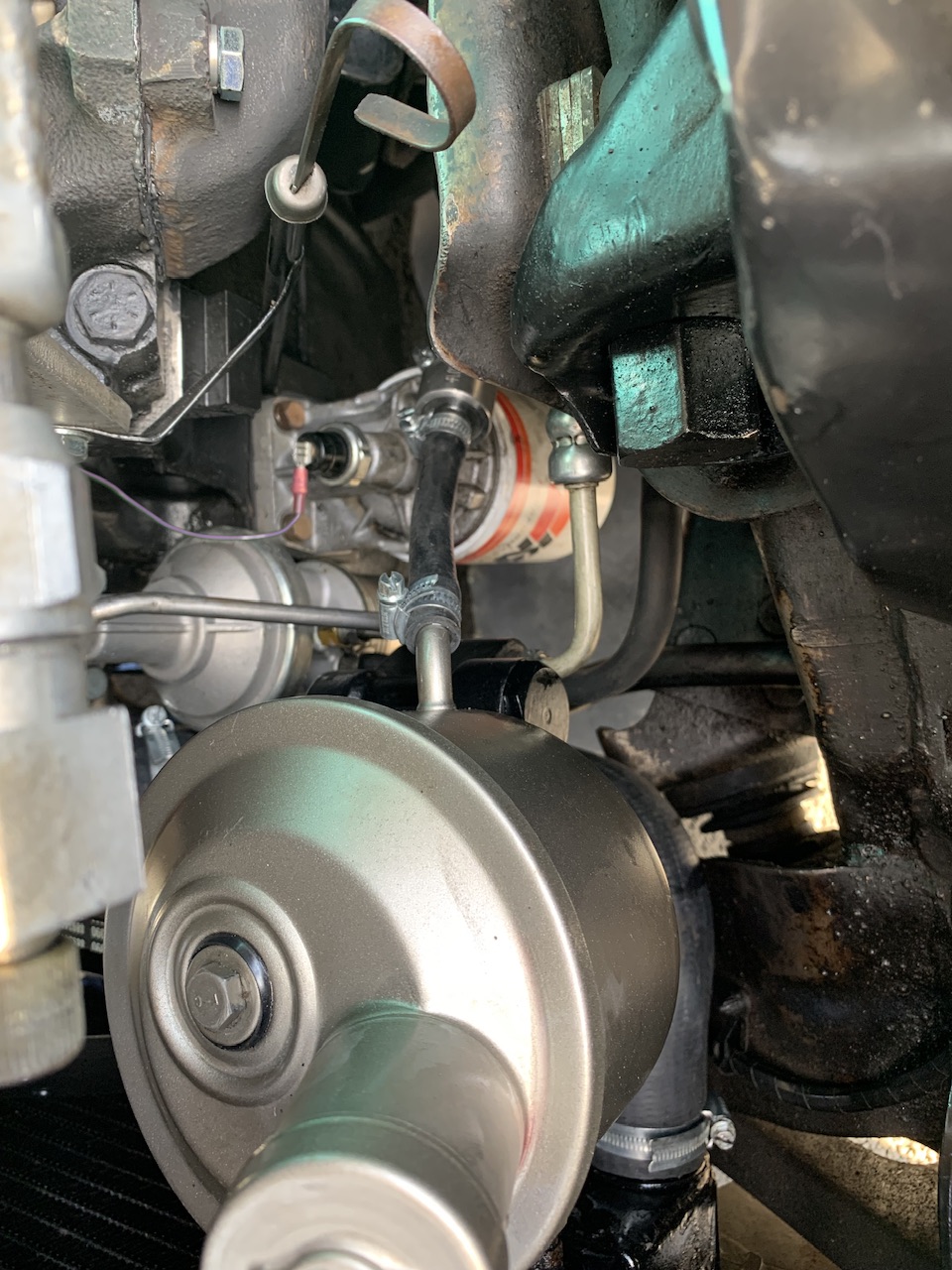

    I’ve ordered a new pump as it seemed simpler than trying to sort the front bush and I’ve got a bunch of stuff to do to the Vette before June after being punted off by a Mustang at the weekend. I’ve also ordered an in line filter for the return line. I’ll clean the leaky pump and use it to purge the system properly before putting the new pump on. I’m pretty sure this one has failed because no one cleaned the swarf after the original failed

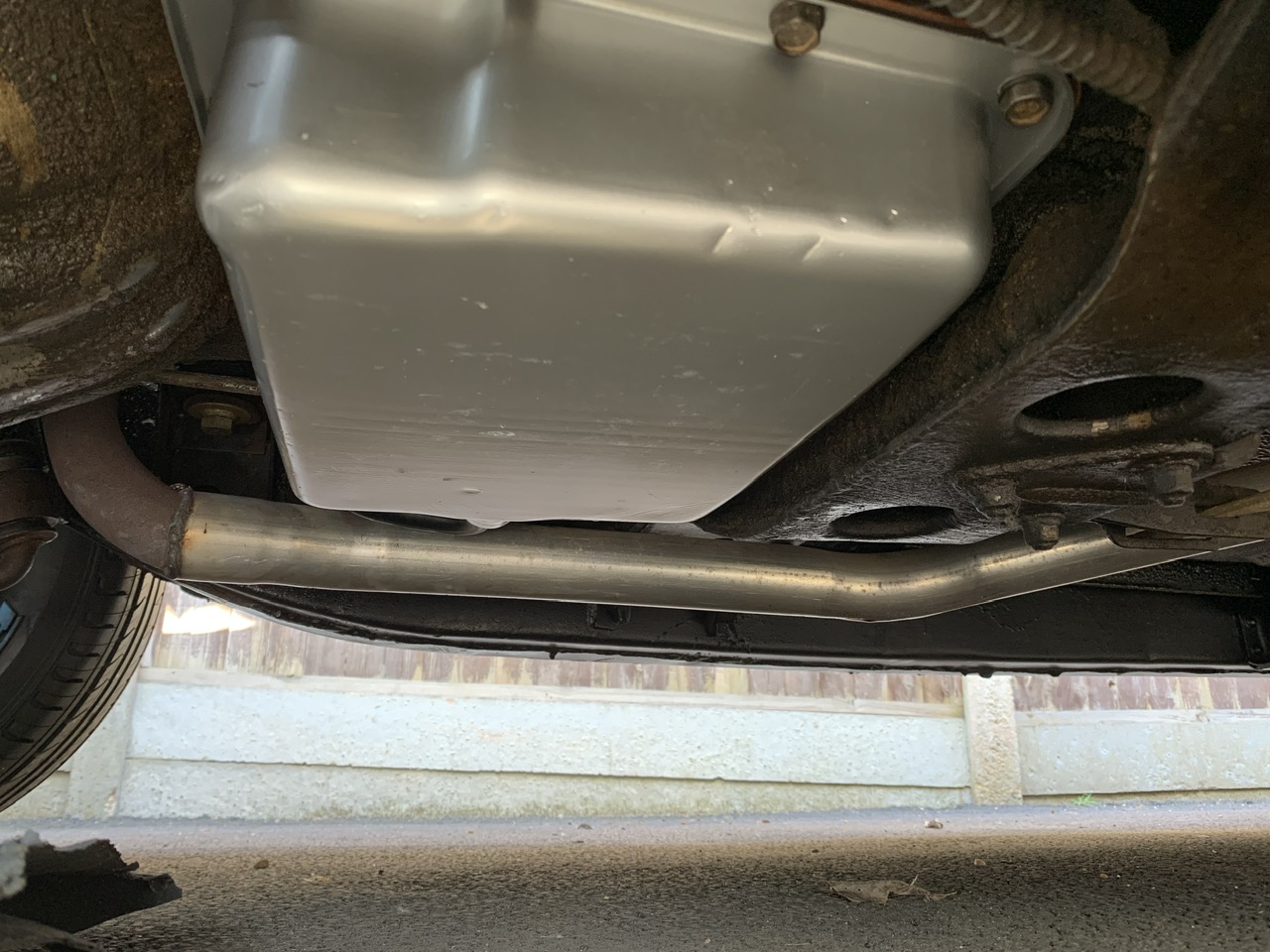

    Dropped the trans sump and changed the filter too, didn’t look like it’d ever been off, gave the sump a lock of paint before I put it back on and refilled with fresh Ford fluid. Couldn’t really work out the two o-rings the filter came with as it didn’t look like the larger tube had one on but put it on anyway.
    Also put the new pump on, along with an inline filter and flushed the system. I thought I’d put the pressure line into the ch***is bracket it’s meant to fit in as someone hadn’t when they’d changed the pump before. There was a reason why 2 1/2 hours of swearing. It’s in 3 pieces and held together and on to the ch***is with one bolt, your can only get one had in there two. It’s at least done now and I can move on to cleaning stainless trim :confused:
