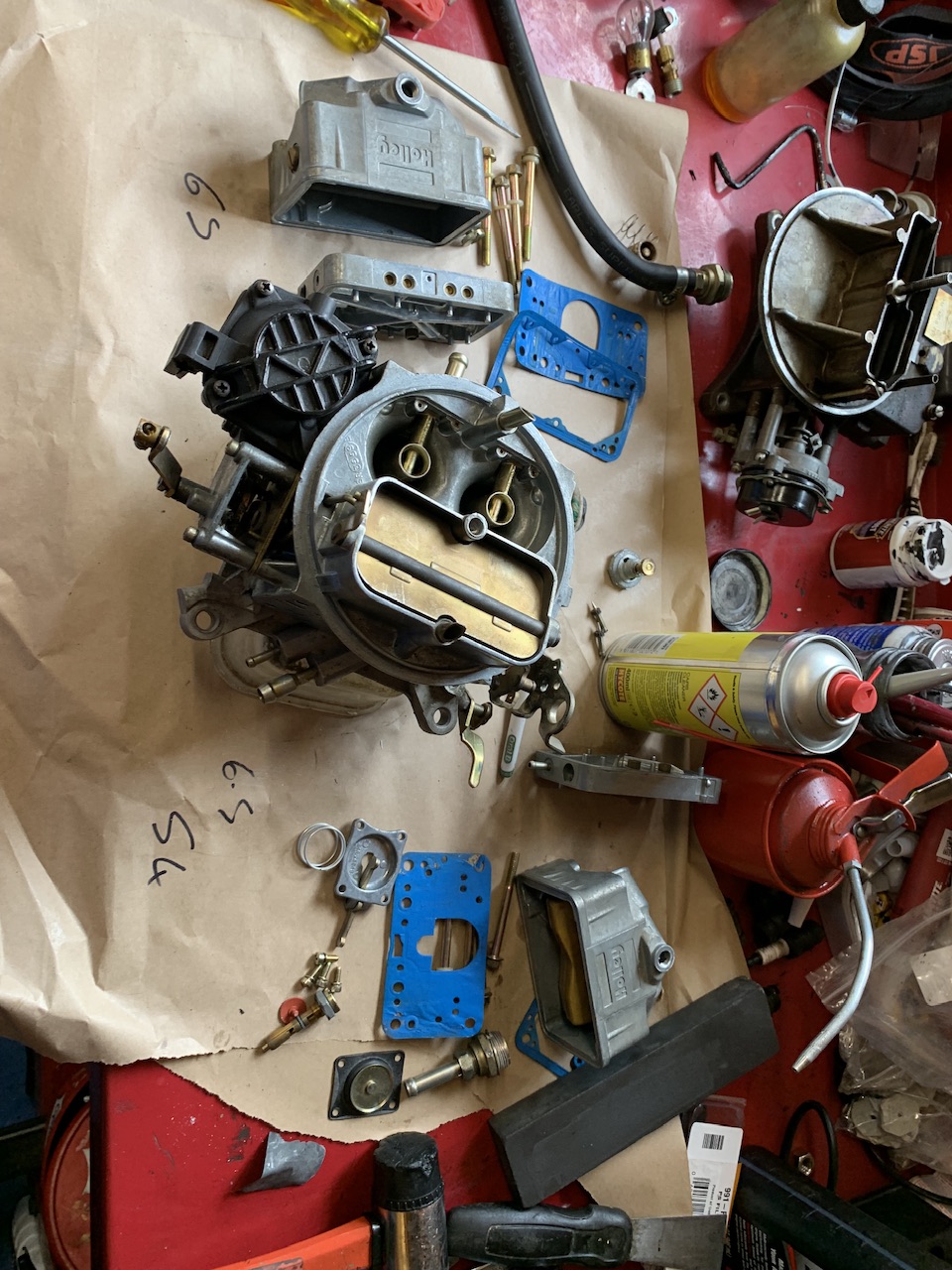

    My second hand Holley turned up, primary float bowl screw threads are stripped, should’ve just bought a new carb! Need to find a some helicoils now

    Can’t see much else has been apart. It’s got two different floats in it so I reckon they’ve had the primary float bowl off to replace that. It was also missing washer/gaskets on the stripped screws so would’ve leaked. They knew it was ******ed and probably replaced it with a new one as it came in a Holley box!

  7. You need to check the carb body where the floats attach. Those surfaces are supposed to be flat and if they're not, the carb is probably junk. Sometimes you can sand them flat, but usually not. What happens is somebody goes just a bit gorilla putting the float bowl on and it leaks. They then go full gorilla and warp the bowl and probably the carb body. Realizing their error, they replace the bowl but the bent body still won't seal.
    There is a torque spec for those screws... it's only 2.6-3.3 ft-lbs (32-40 in-lbs). That's not very much...

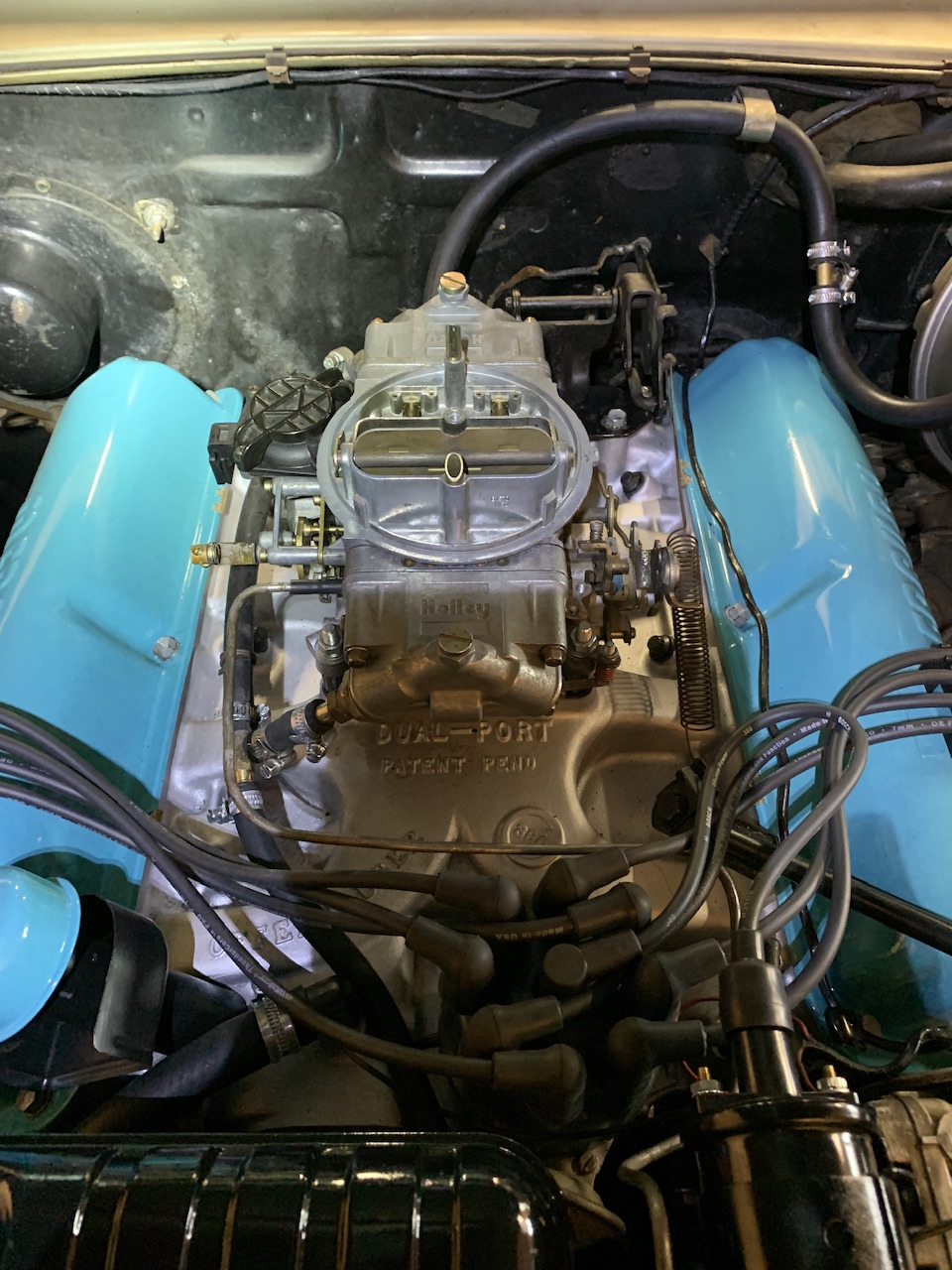

    Holley back together and fitted.
    Runs much better now, vid:
    https://oneball.smugmug.com/Cars/Merc-Original/n-5ZtcCv/i-TSDNtZn
    Need to put something proper in place for the fuel lines from the pump and my air cleaner doesn’t fit :(, because the factory book says it’s ok for the Holley equipped cars I thought it’d be ok but it won’t clear the adjusters on centre hung floats.
